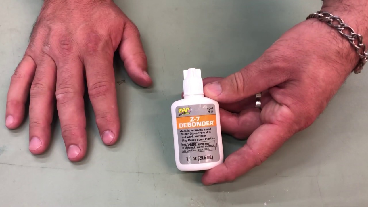

Bought a bottle of zap debonder and needed it once until now. I found it to be a red, gel like suspension, not quit workable, creating a mess of my PE. Does somebody knows if this is normal? I was expecting a liquid but this is too thick to be useful.
The bottle of ZAP Z-7 Debonder that I have contains a clear gel, it is approx. eight months old and I have used it recently with good results. HTH.
—mike
Isn’t the active ingredient in debonder just acetone?
Yes, acetone and nitromethane are the ingredients mentioned on the bottle. My bottle is about 1 month old and yesterday I used it for the first time.
Strange that my ZAP Z-7 is a red gel. Maybe it should be kept in the fridge with the ca glue?
Same stuff I have, but as mentioned, mine is clear. Something looks amiss with that bottle. Was there leakage upon initially opening your bottle? I would contact the seller and/or ZAP to determine the cause. Keep us posted.
—mike
PS: I don’t refrigerate — it just sits on my workbench… away from the CA.
He does mention: The “new” formula is clear, it isn’t red anymore. … There you have it.
So I bought an old bottle, the video is from 2019.
I guess I need to buy another one. Thanks.
