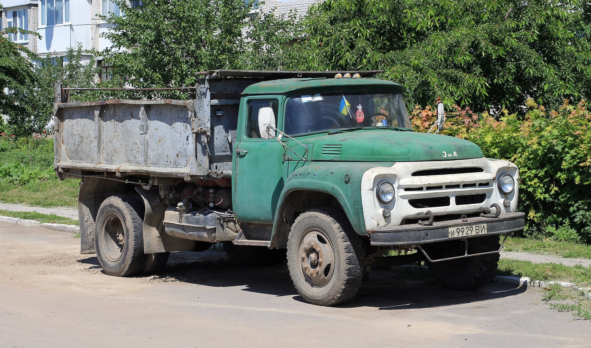

A Zil 130 (I think) made into a military vehicle.
Not always, but it looks like the most common paint scheme.

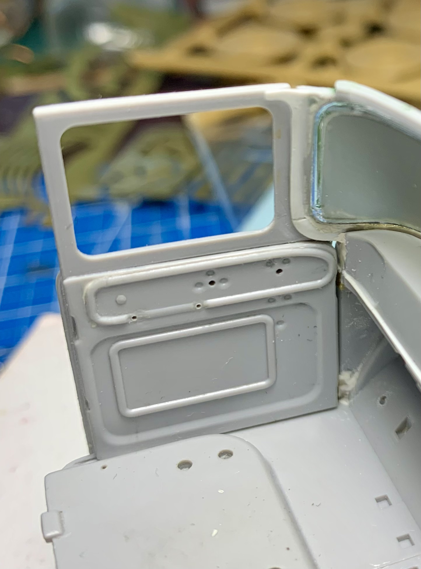

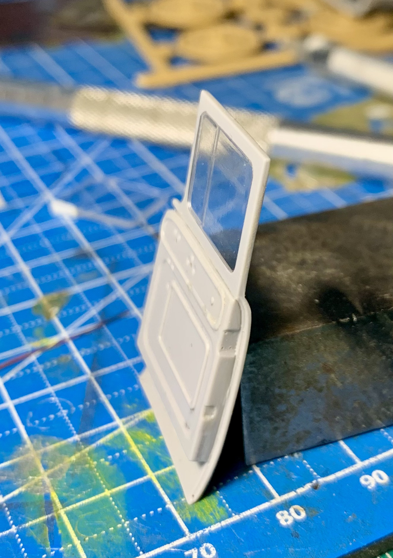

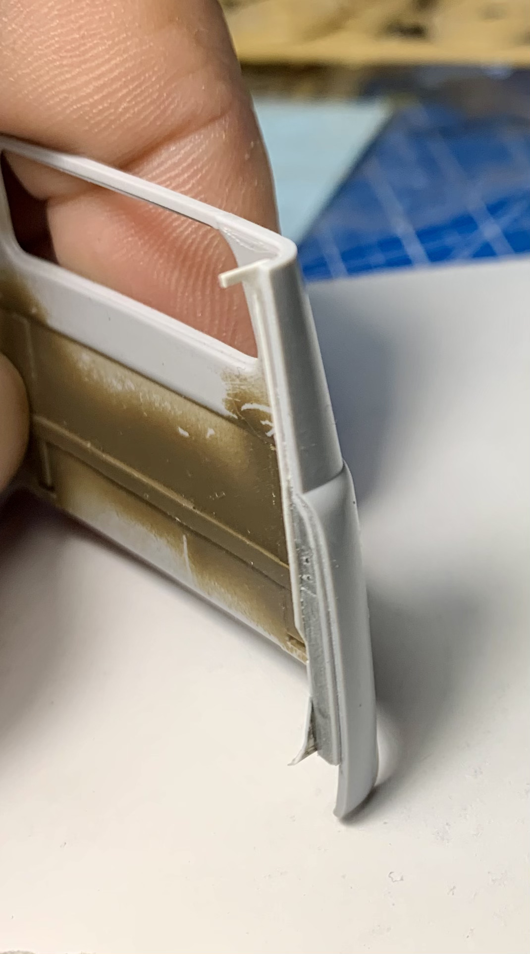

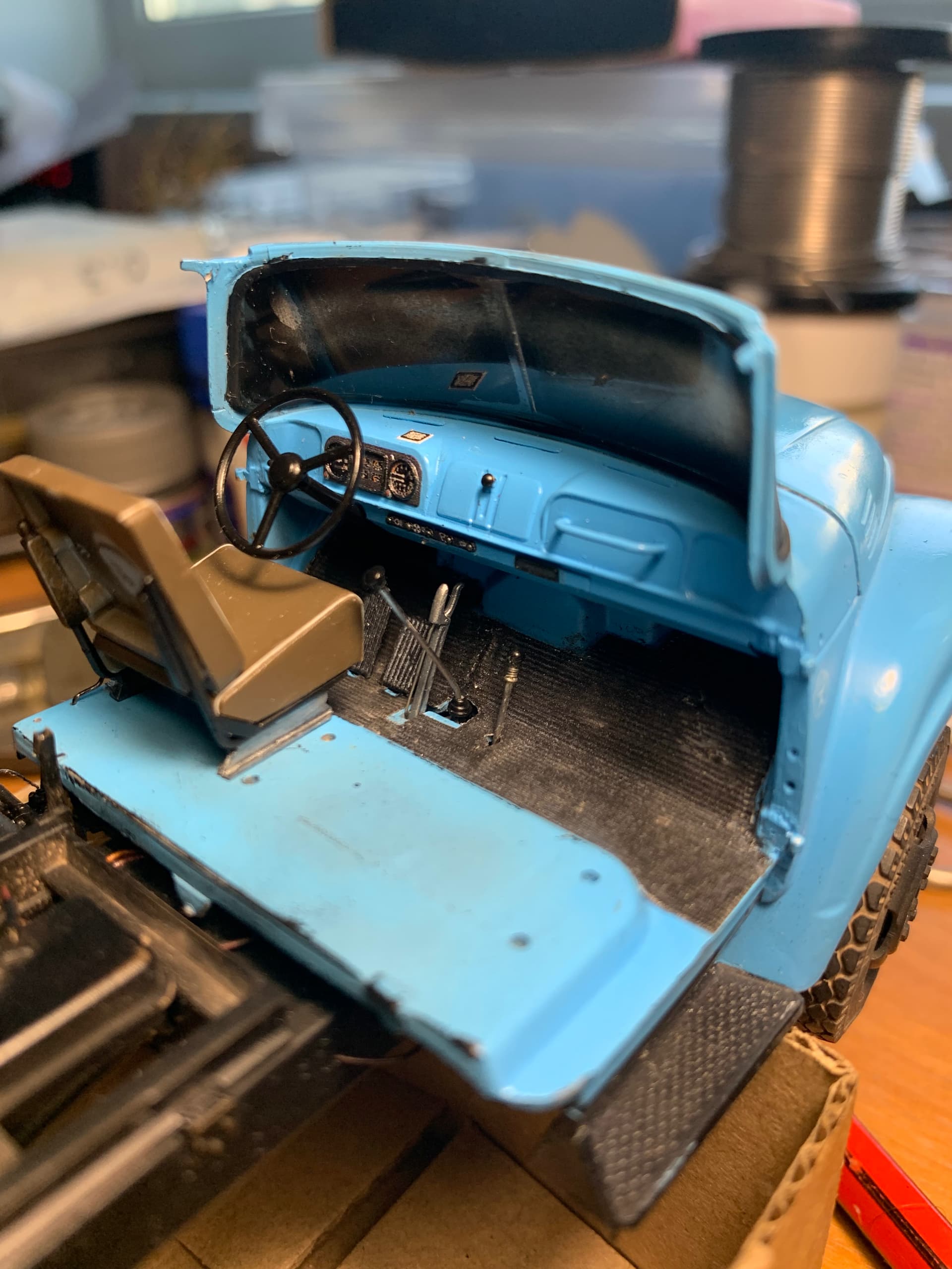

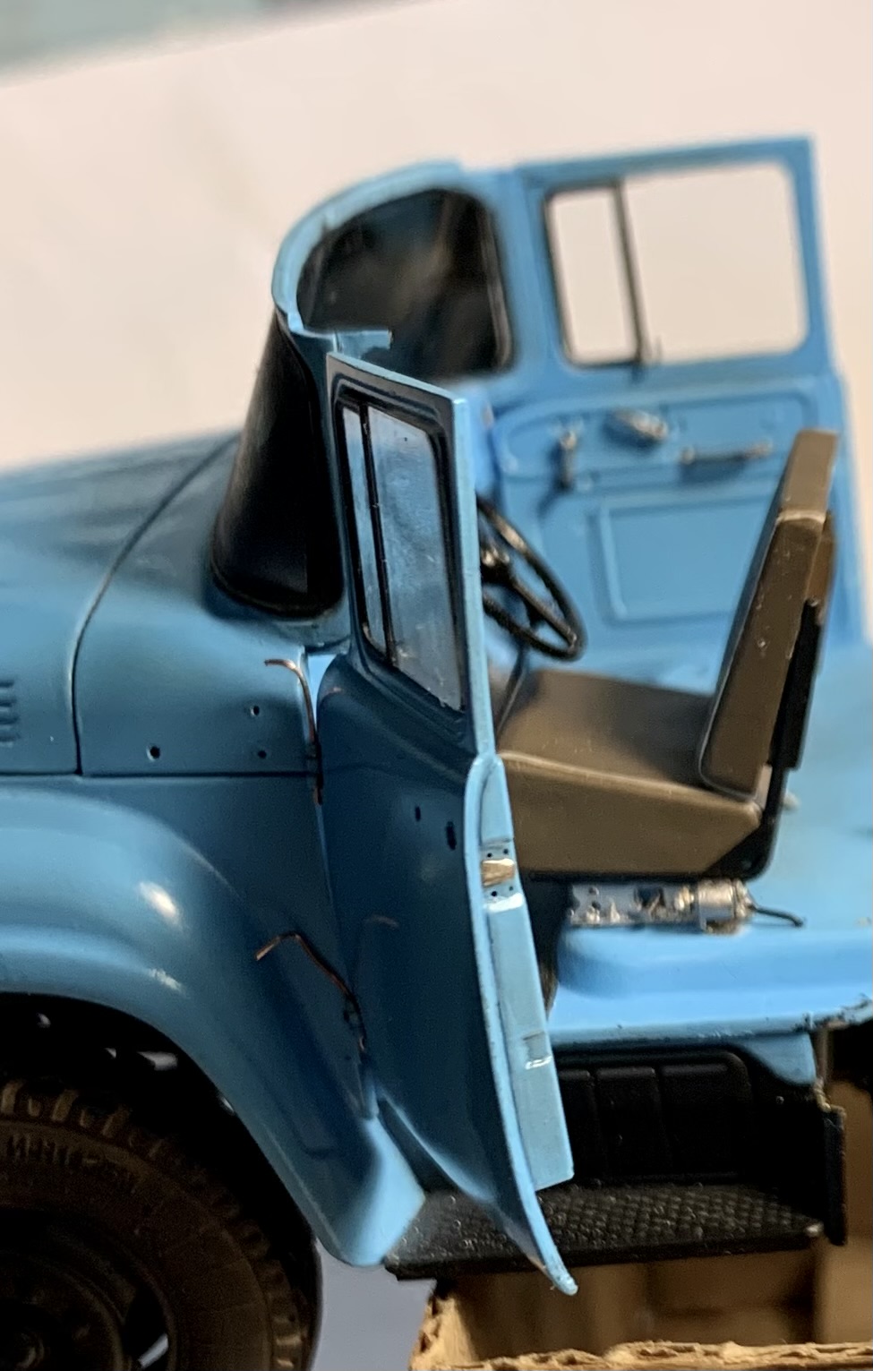

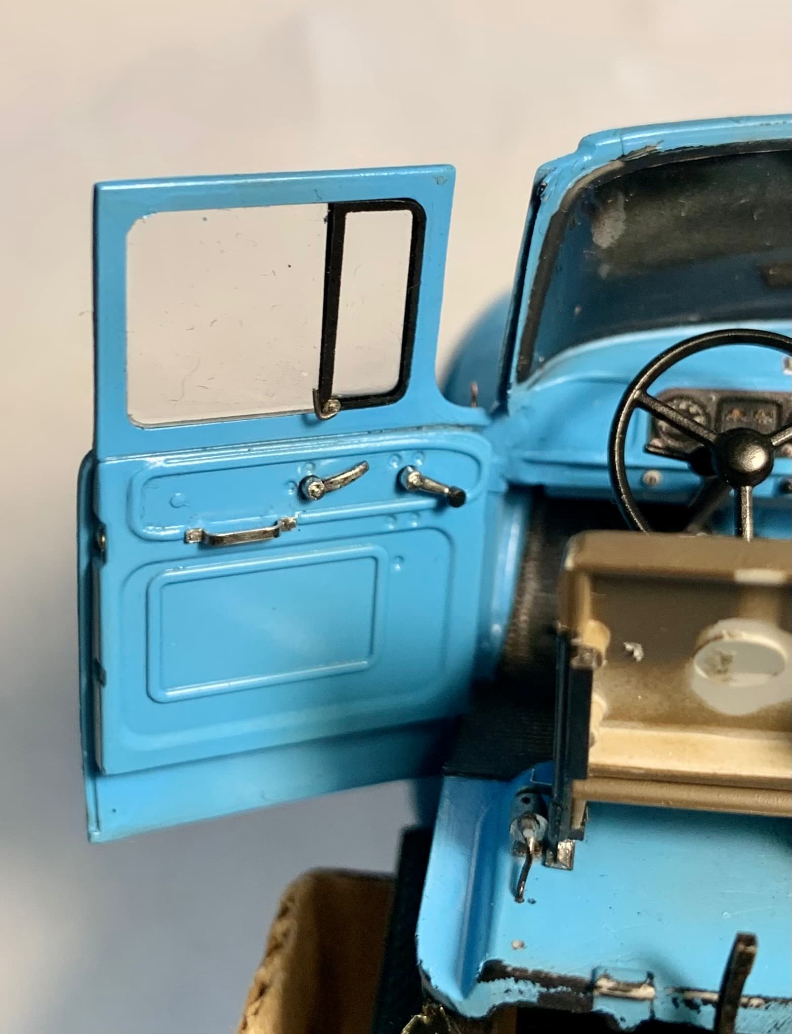

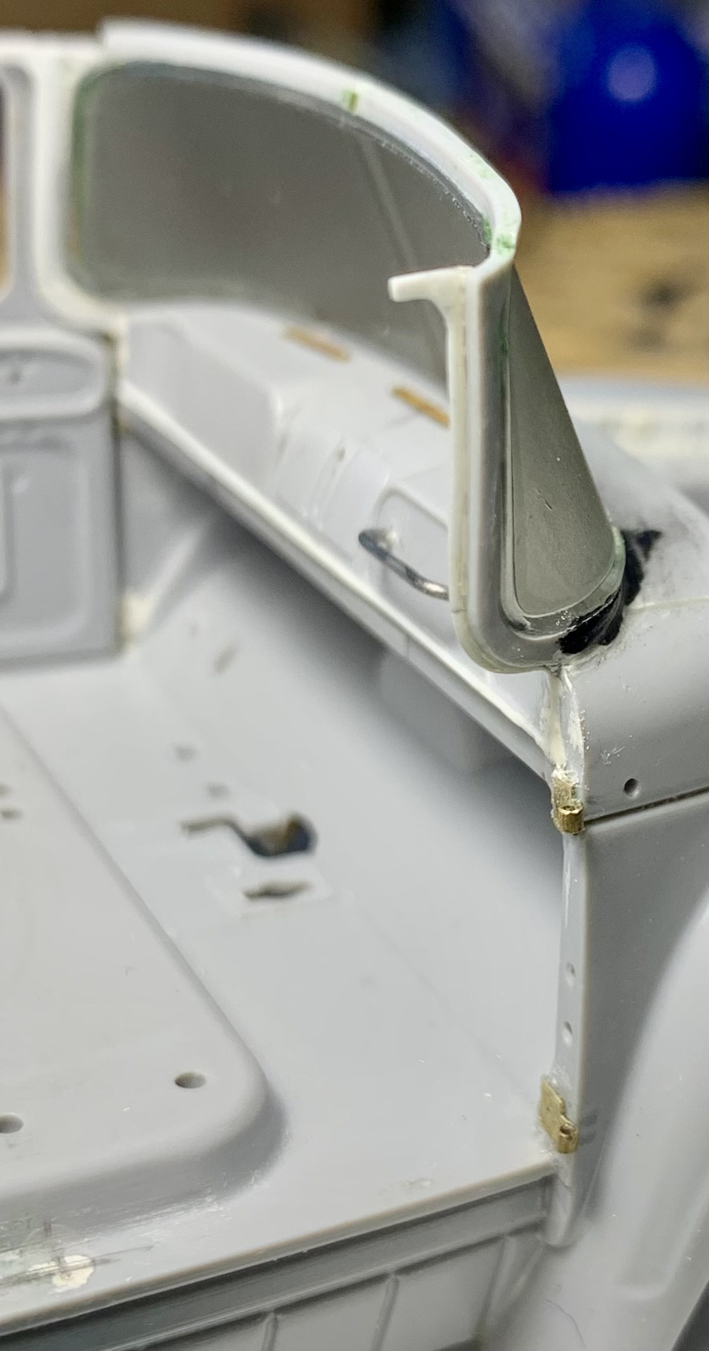

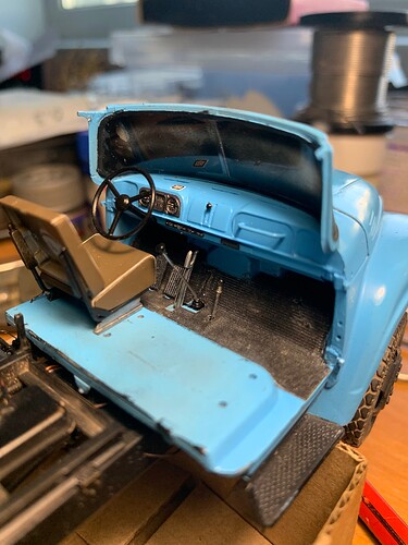

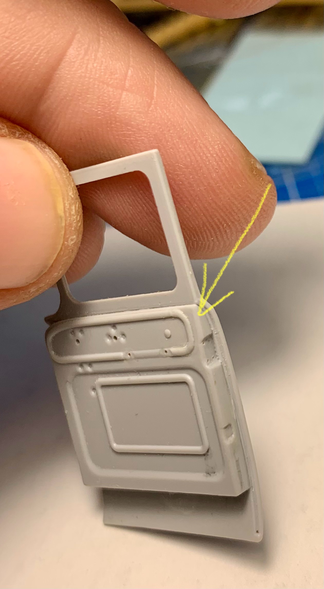

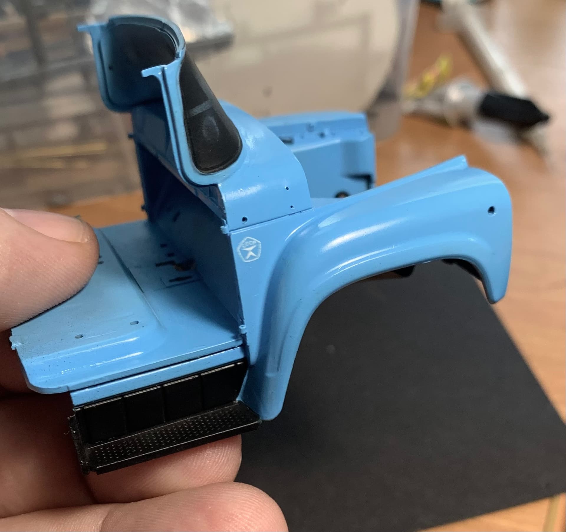

Since the doors will be opening, I added a door frame, modified the door, removed the step on the door glass so that it does not stick out from the inside of the door like on a toy, hinges on the door and glued the windshield
I am planning this for a future build.

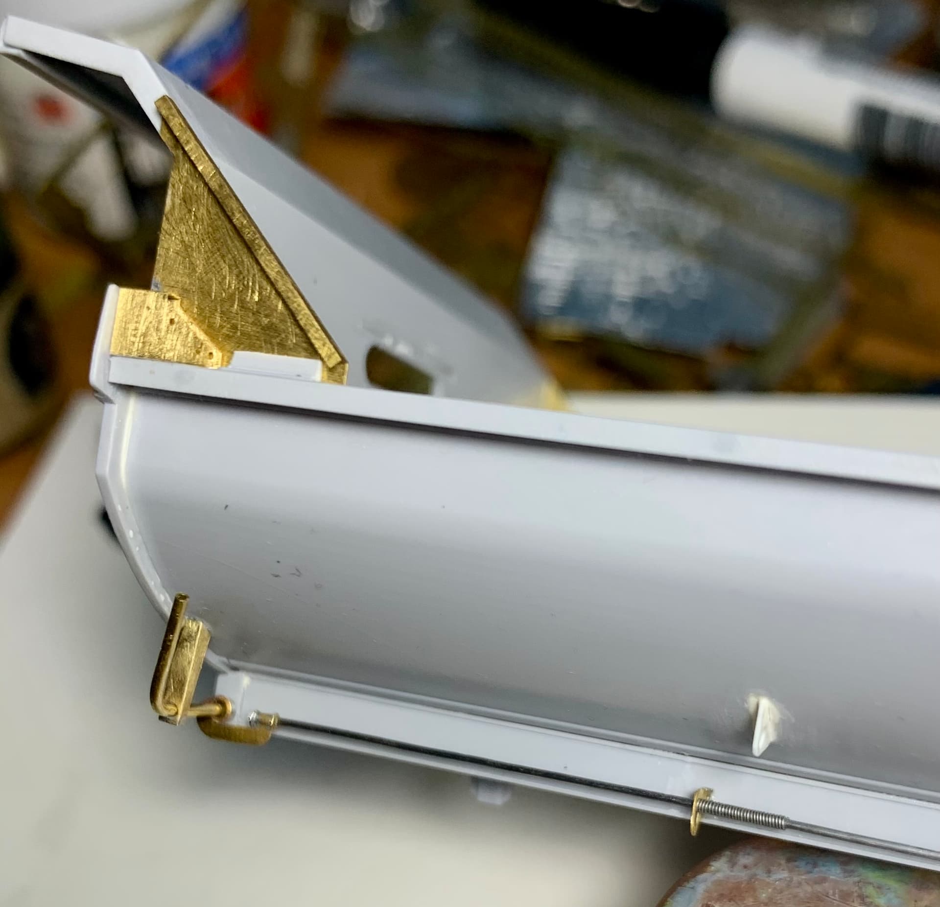

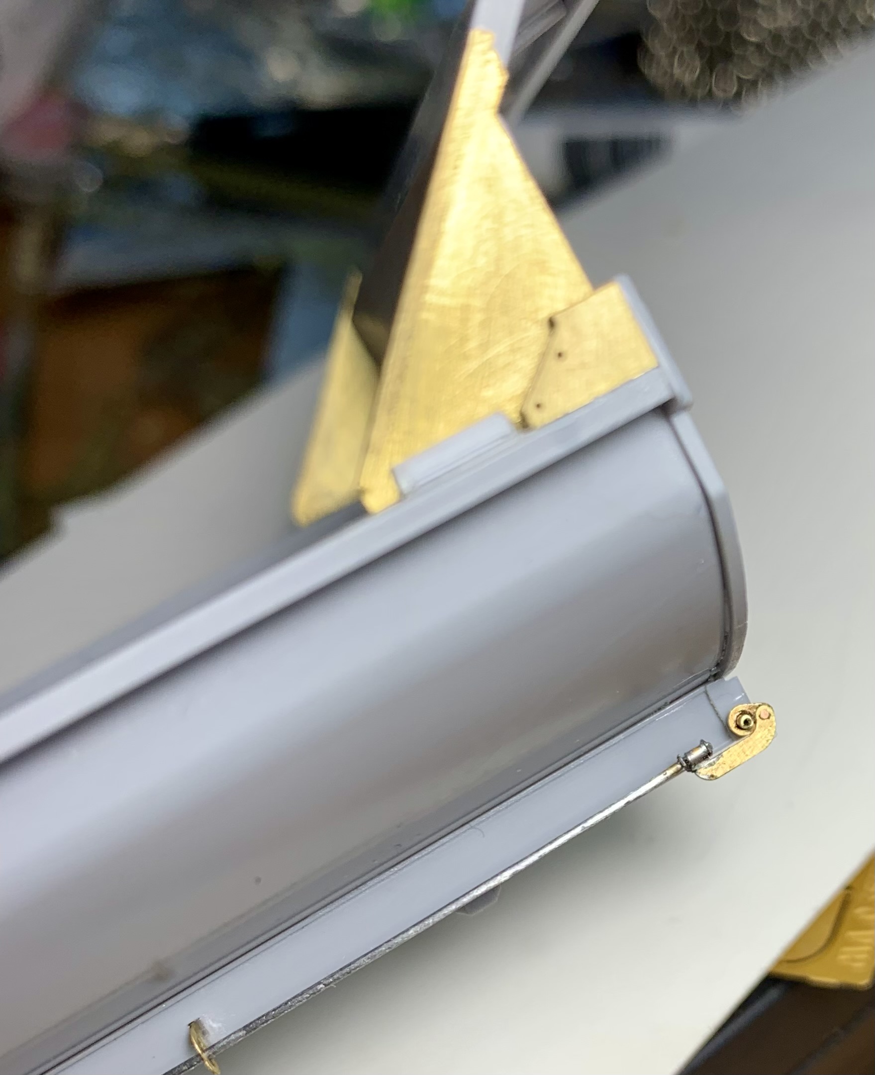

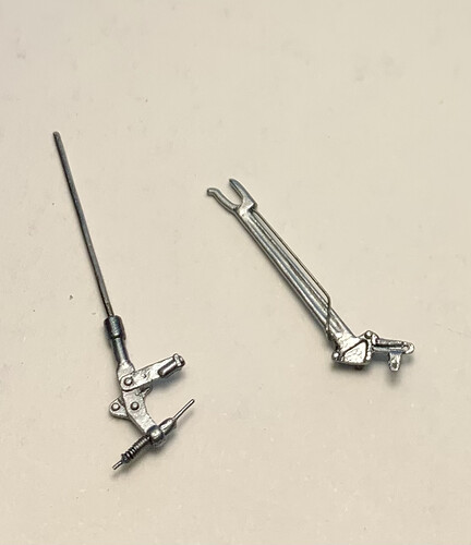

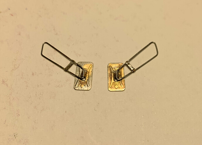

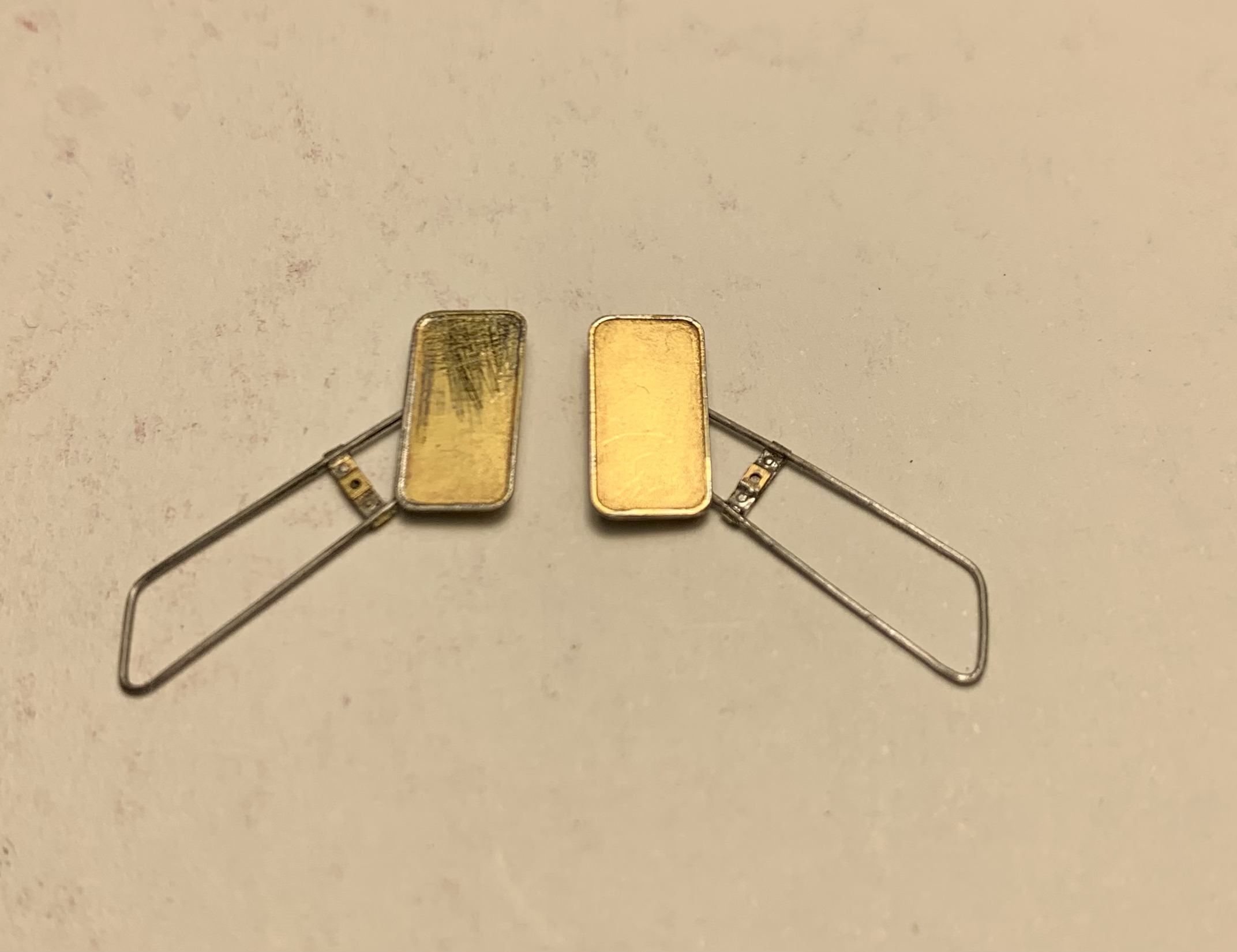

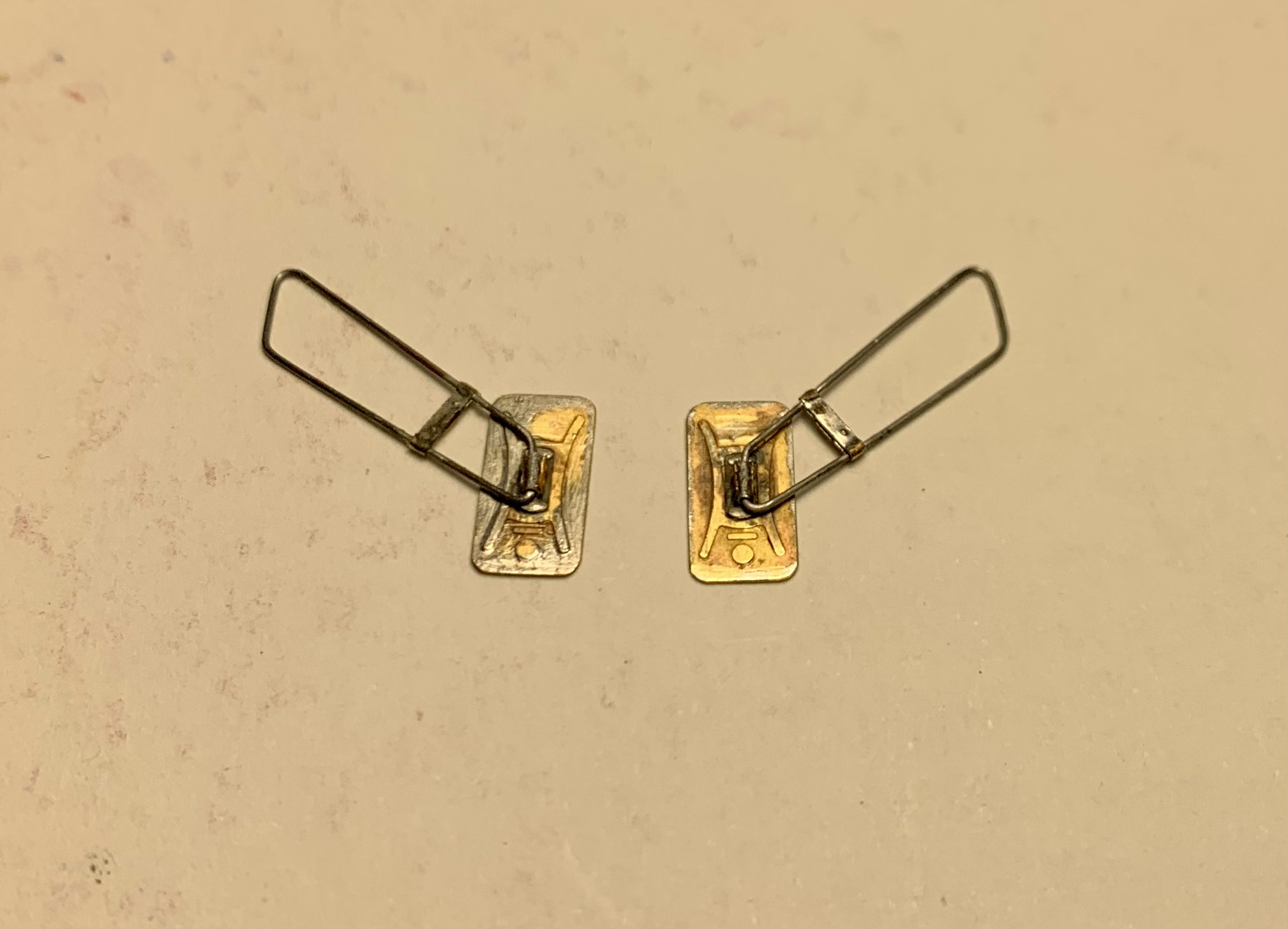

modified the handbrake lever and the body lift lever. Soldered the rear view mirror mounts
Wow, I admire your skills.

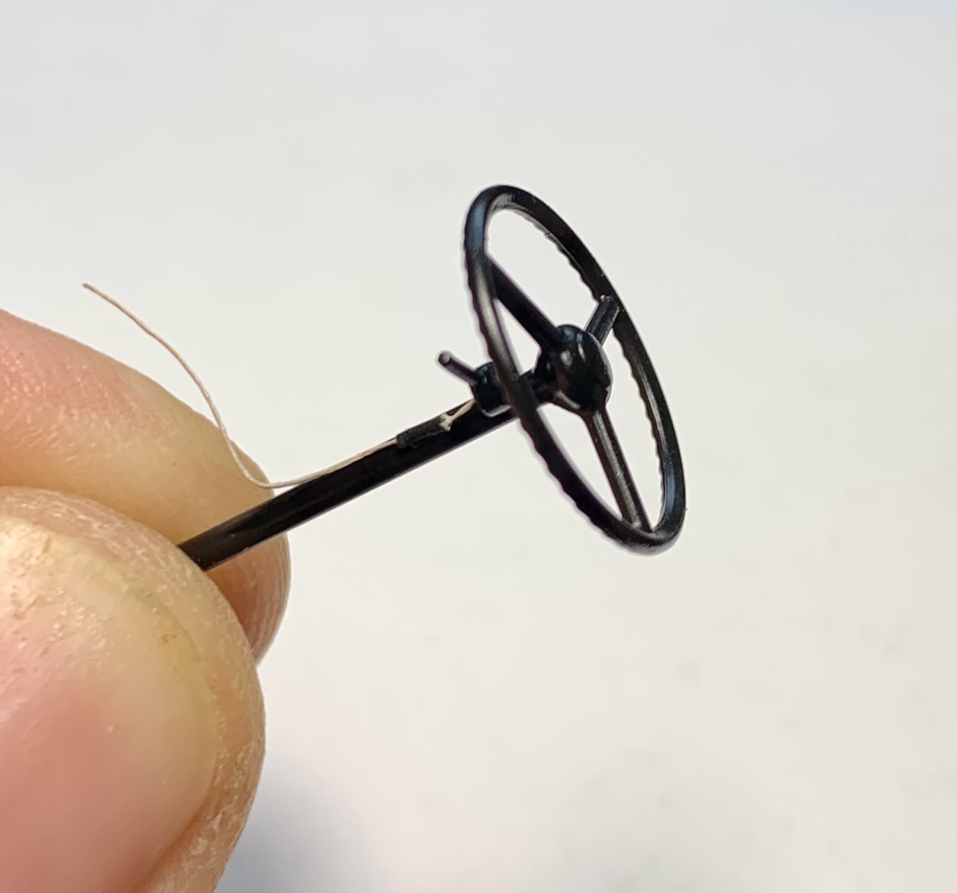

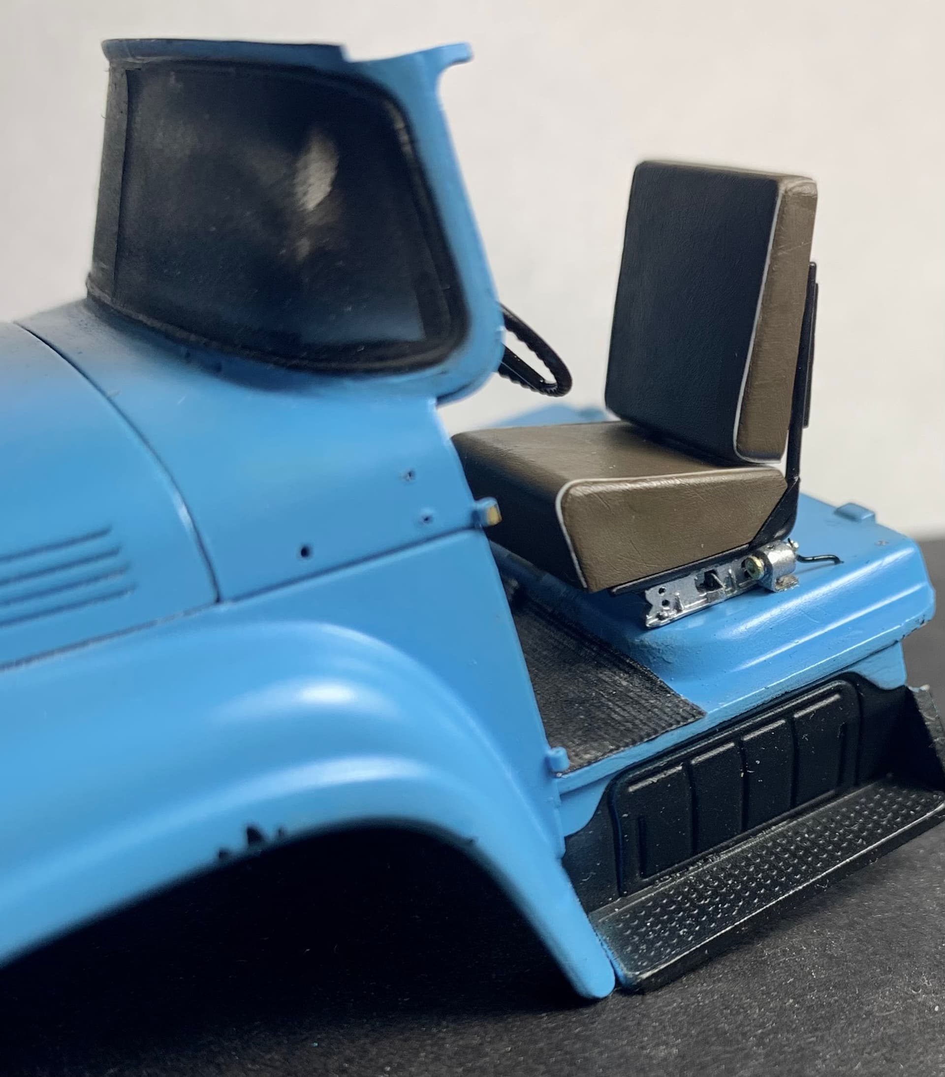

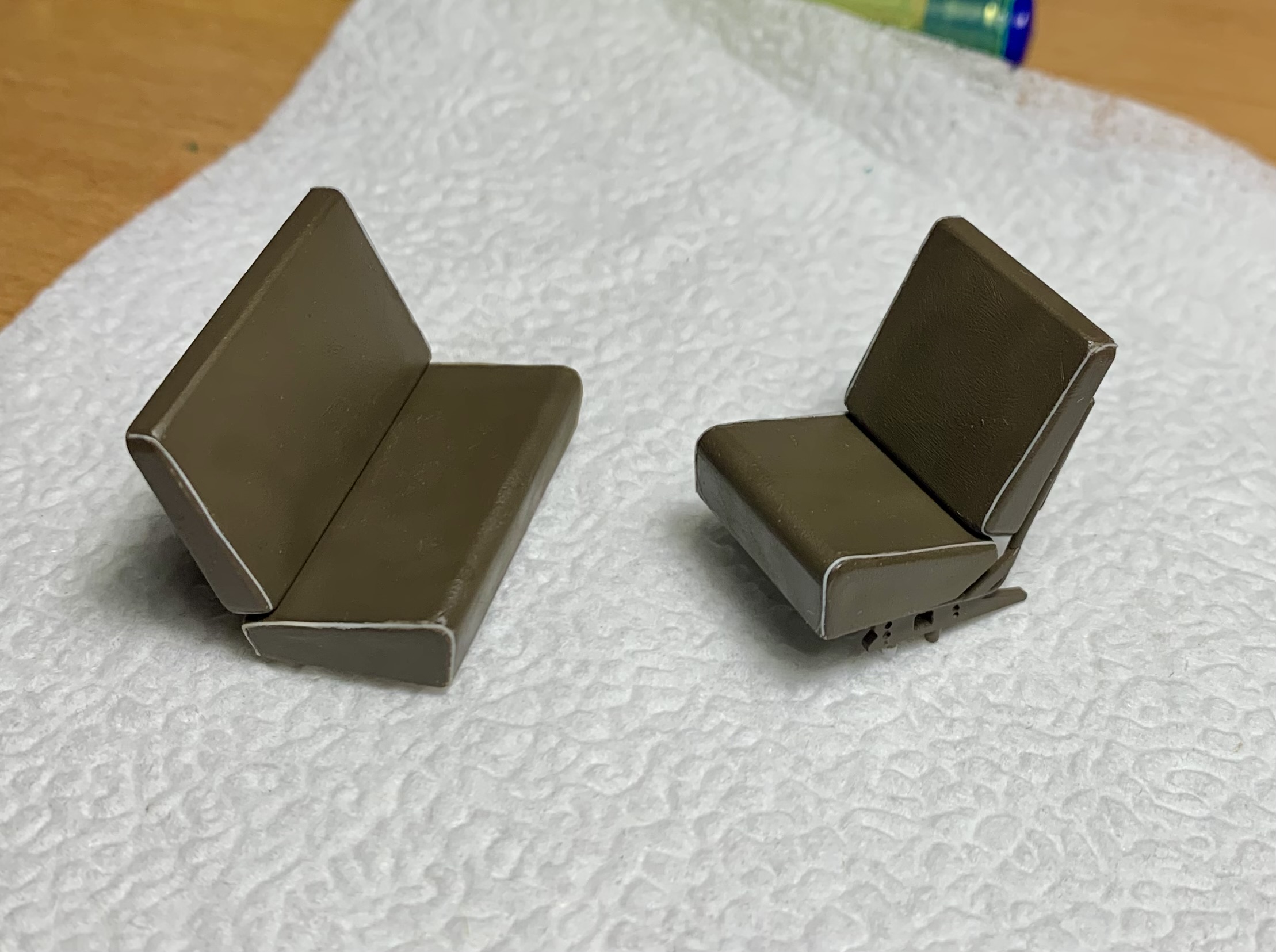

I modified the seats - added white edging and details to the lower stand, and also added wiring to the steering wheel

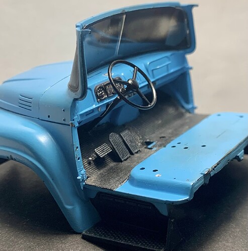

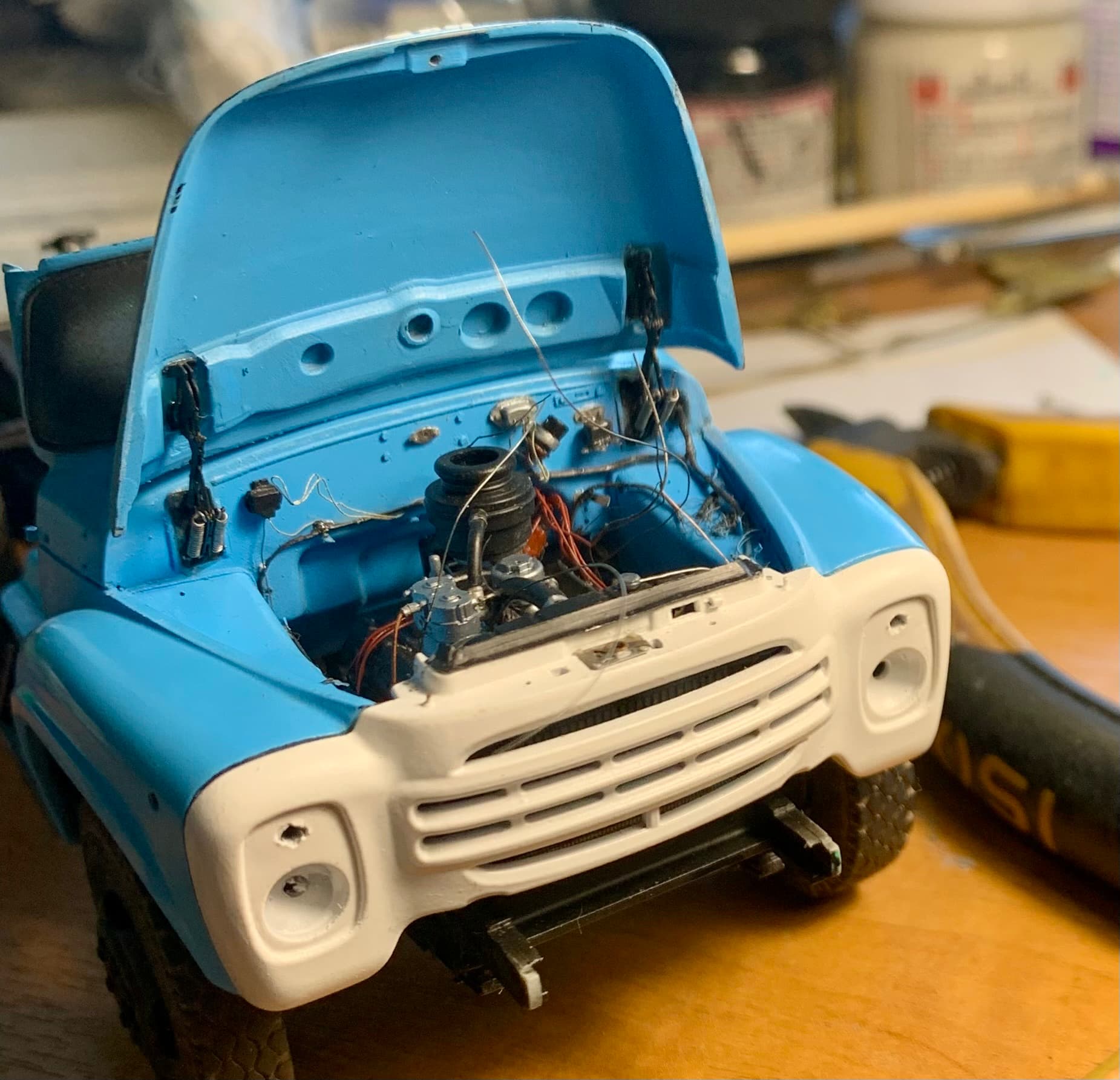

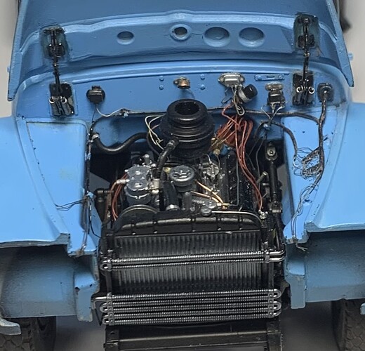

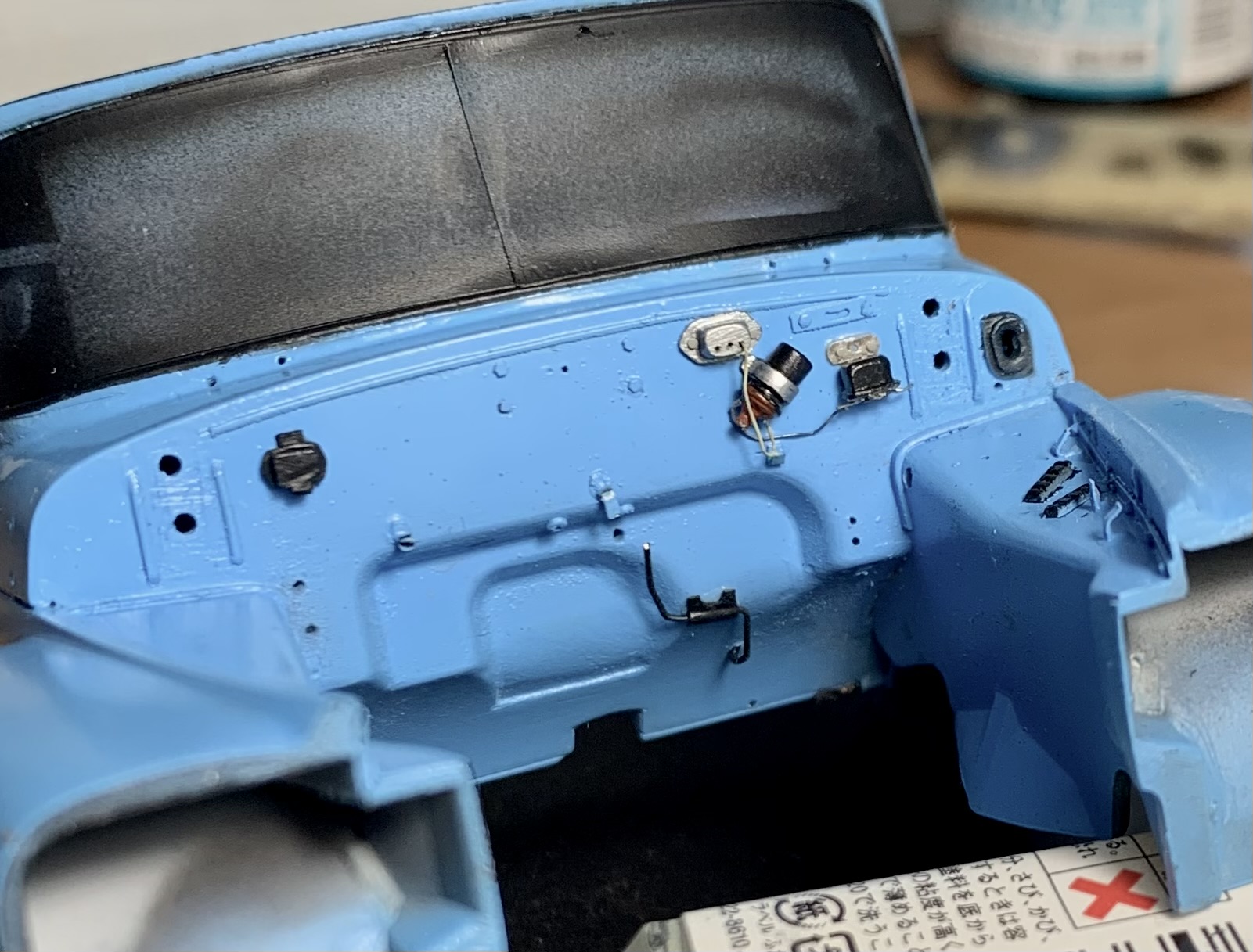

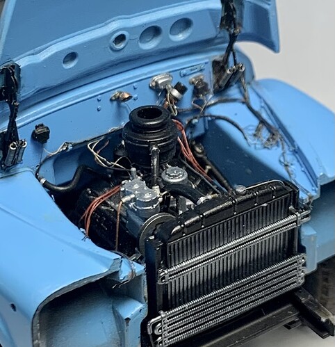

painted the cabin and started detailing the underhood space

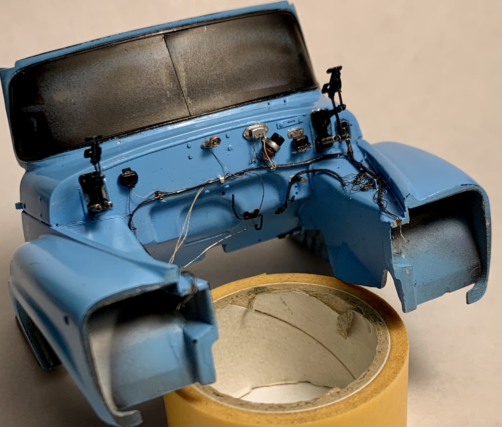

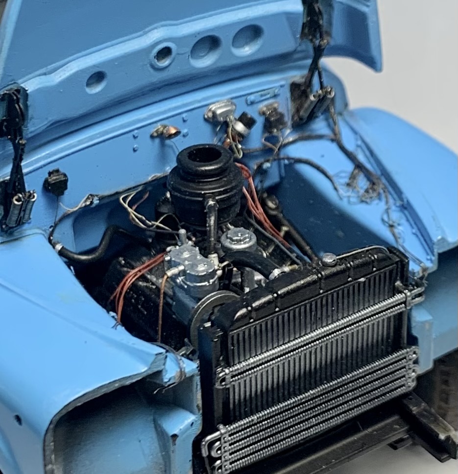

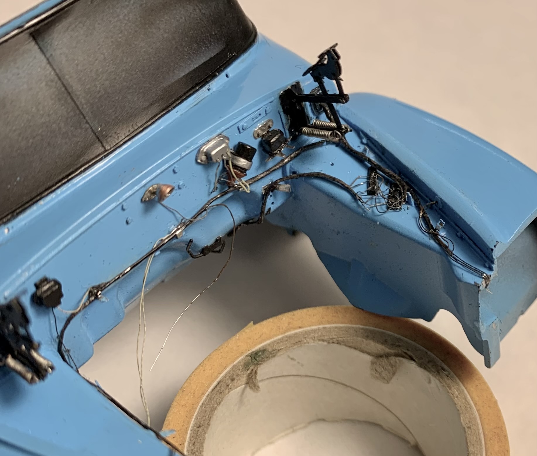

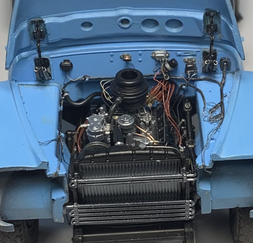

added cable routes for connecting underhood components
battery switch and other…
She is looking great, keep it up. :+1:

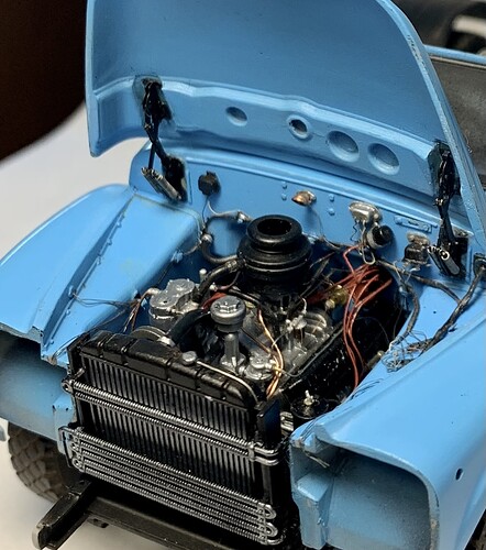

I installed the cabin on the frame and connected all the cables according to the electrical diagram.
Very nice work

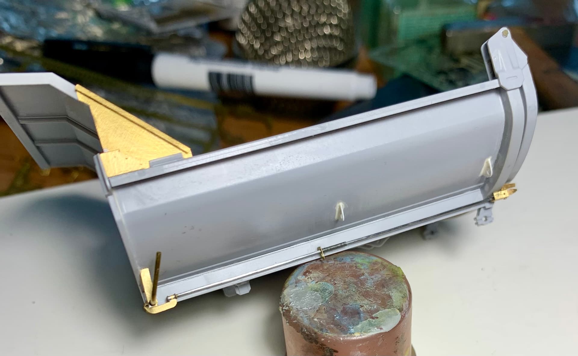

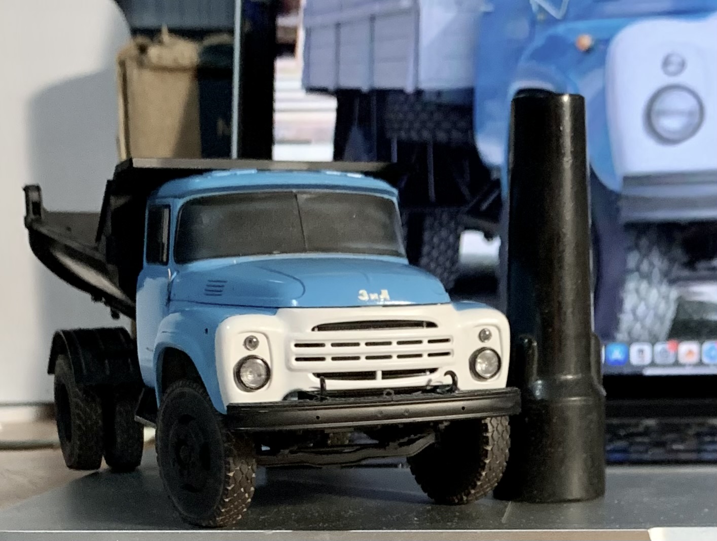

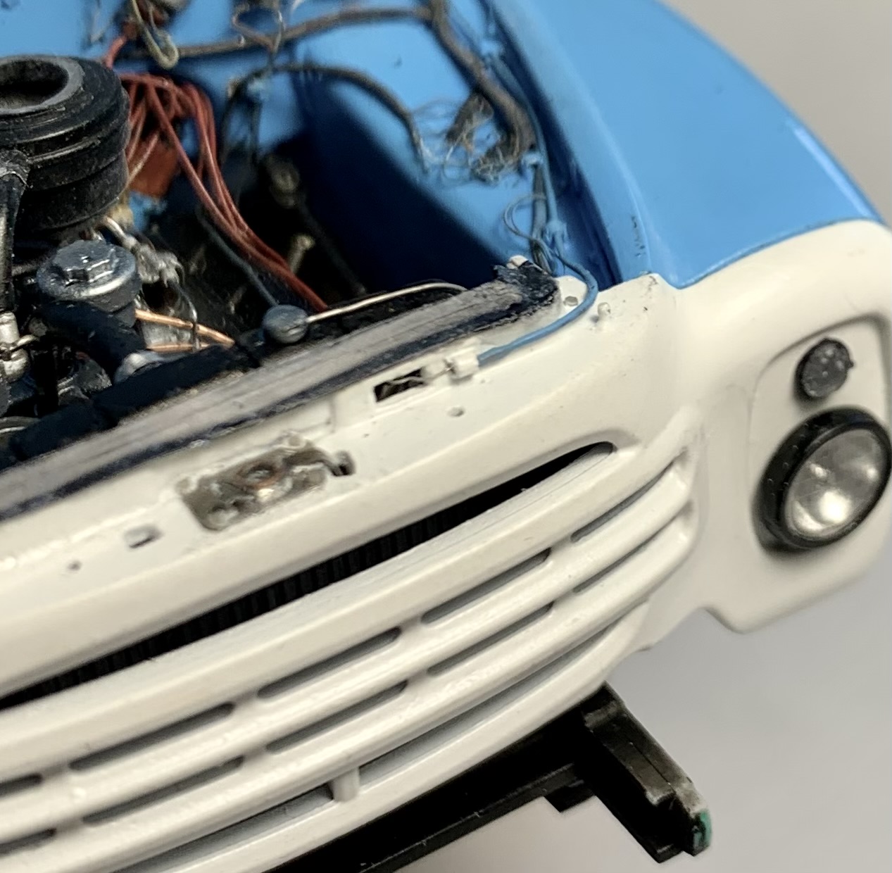

I assembled the body and installed the radiator shutter release rod. The hood can be closed.
I made a door lock, window handles, and compared the model with the original spark plug cap.
Are you planning on making functional spark plugs as well?
:grin: :wink:
Simply mind-boggling
