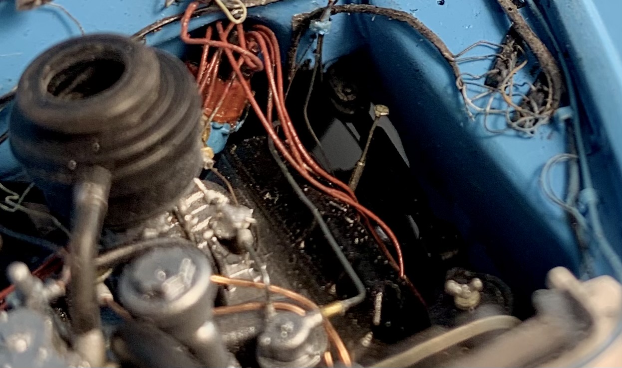

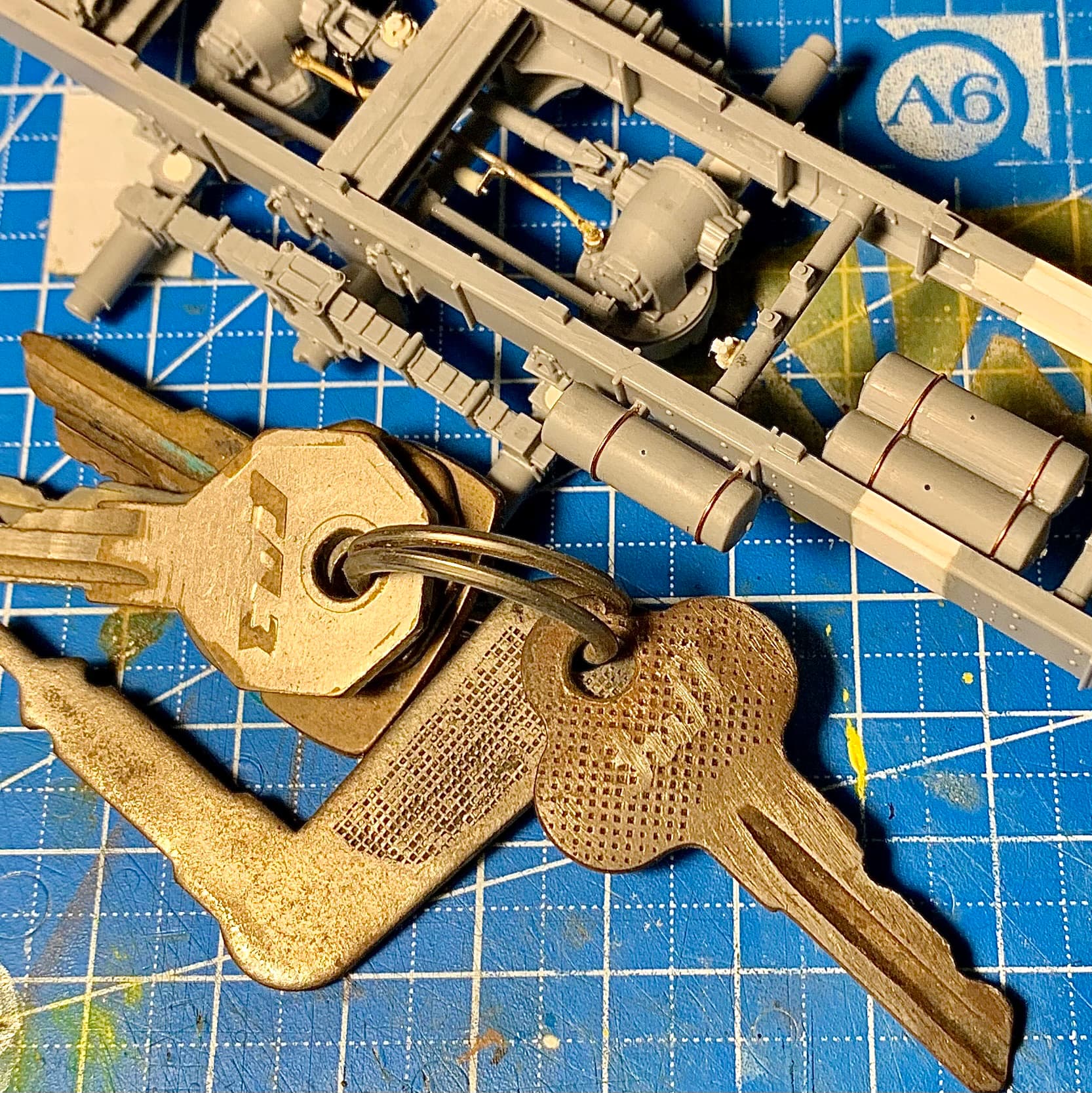

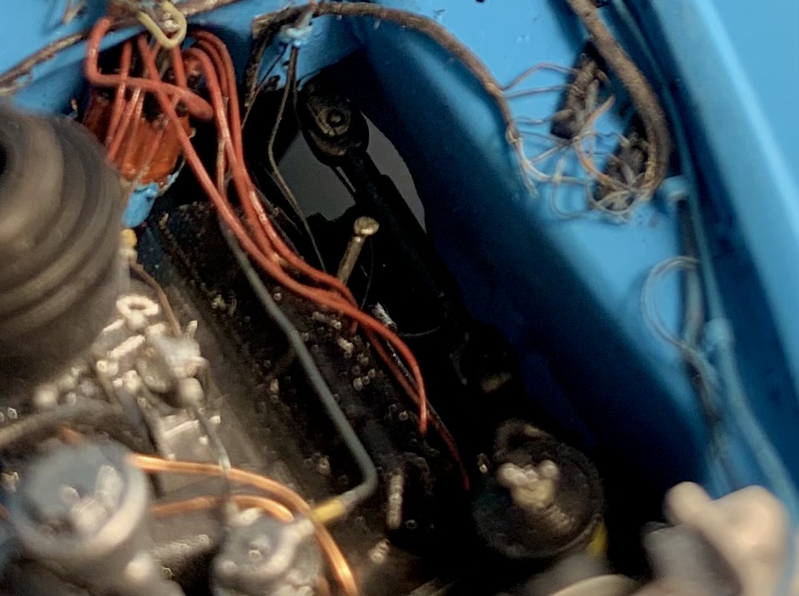

Yes, that’s a good idea, especially since the ignition key is already there and the most important component, the oil dipstick, is functioning. :laughing:
:+1: :rofl: :grin:

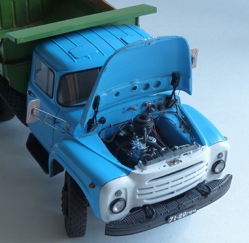

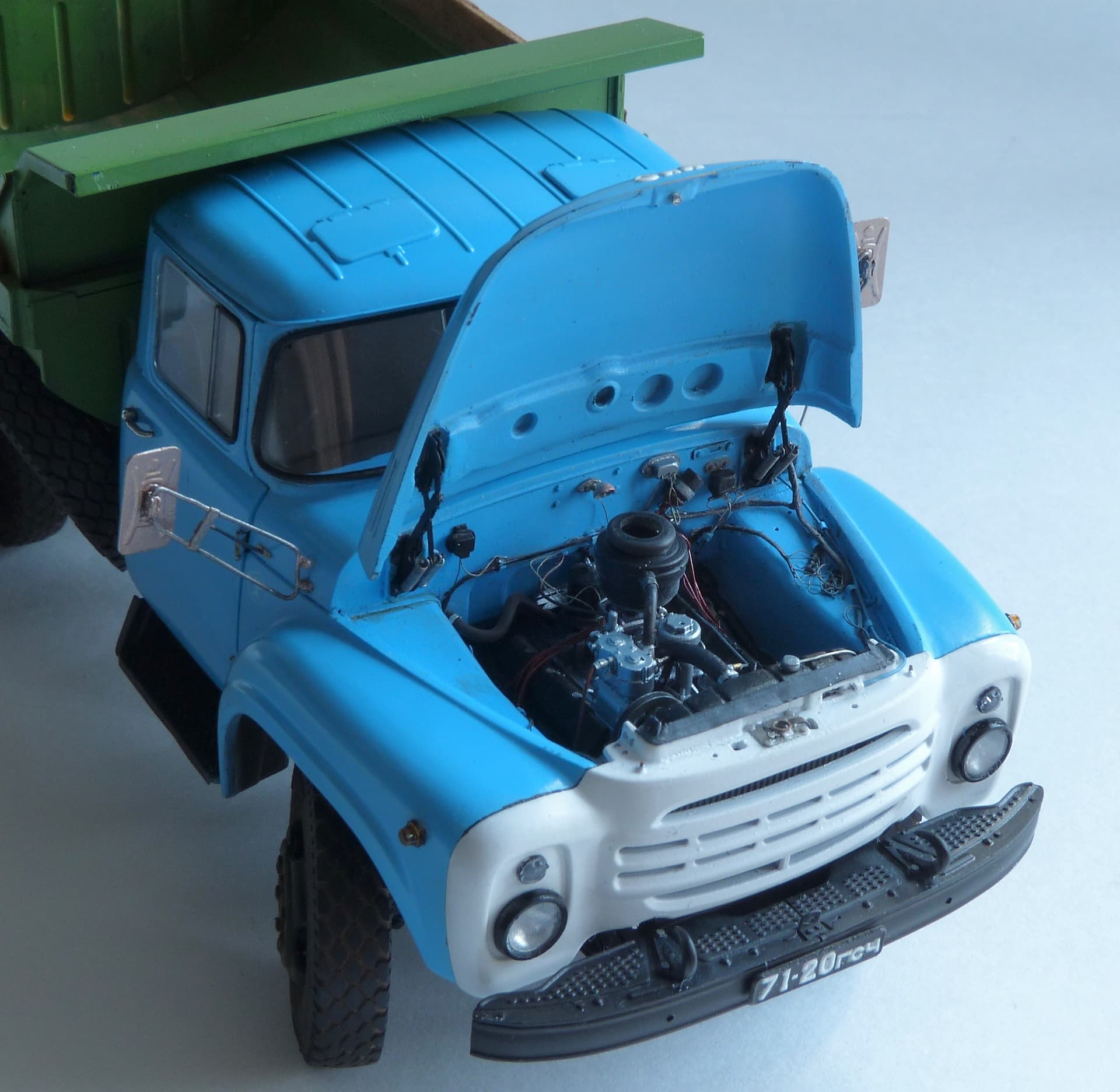

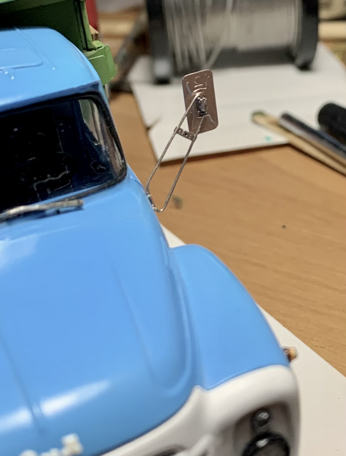

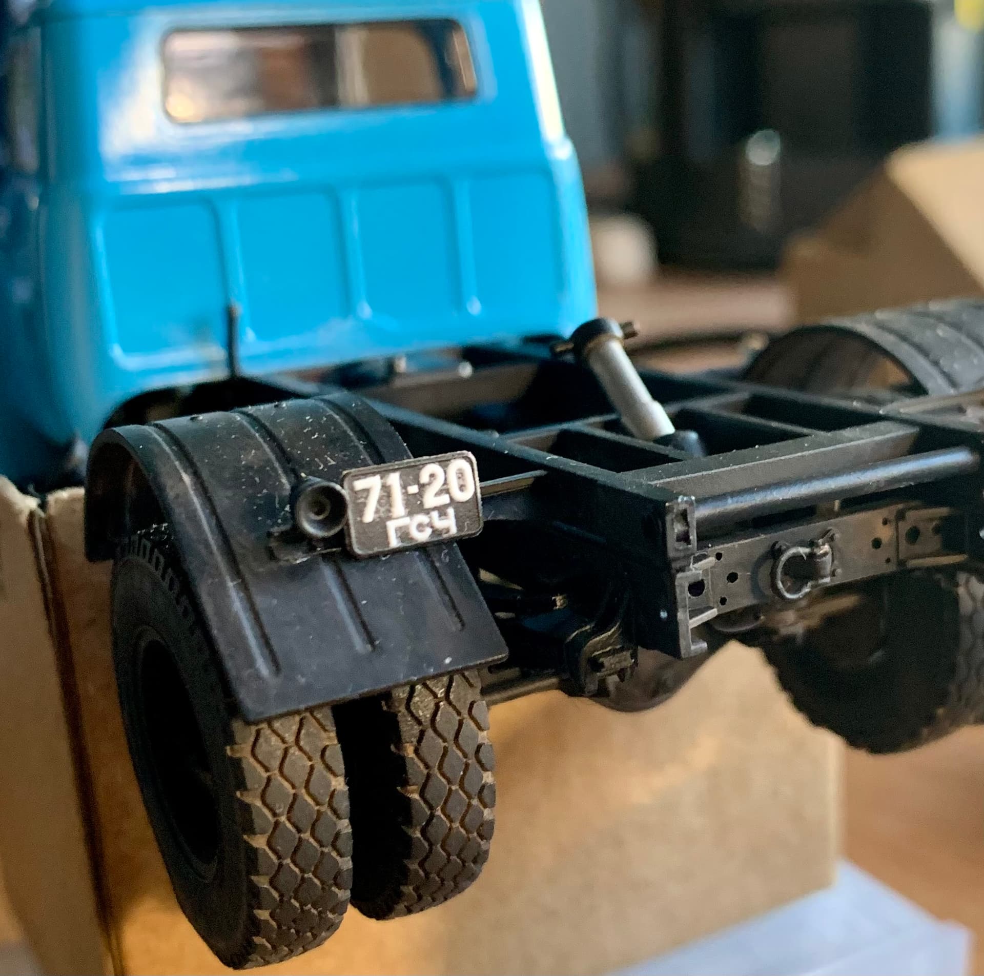

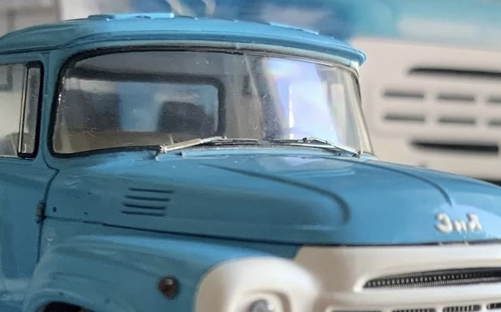

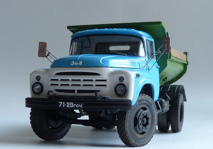

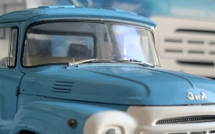

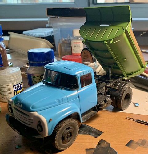

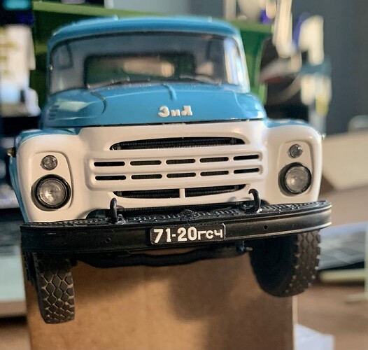

Painted the body, assigned a state registration plate(3d) (Gomel, Byelorussian SSR late 70s/early 80s), and installed windshield wipers.
One step before the finish line

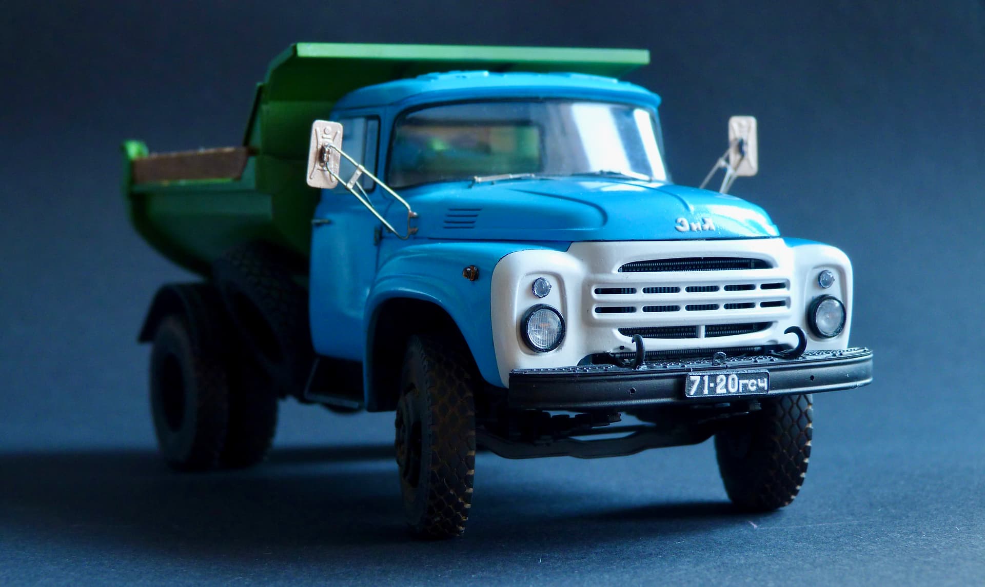

The work is complete. The model was given to my father, who worked as a mechanic for 40 years and knows this car inside and out.
It came out looking awesome. Great job.
Stunning job- it was very enjoyable to watch you build and super-detail this.
Amazing gift!
Impressive, I am sure he appreciates it.

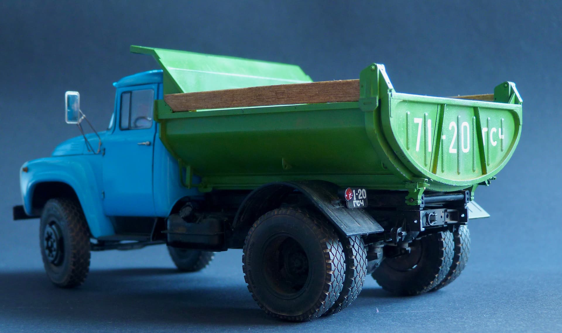

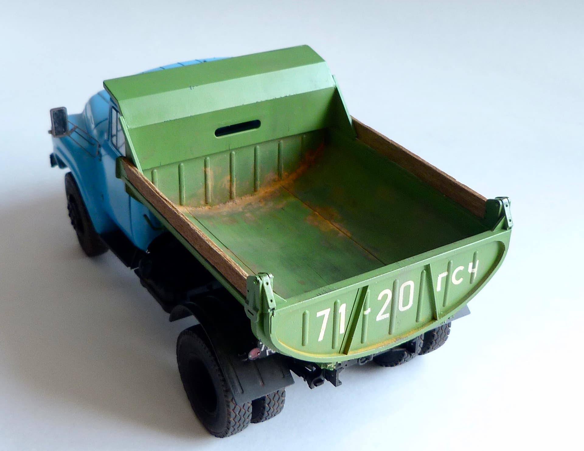

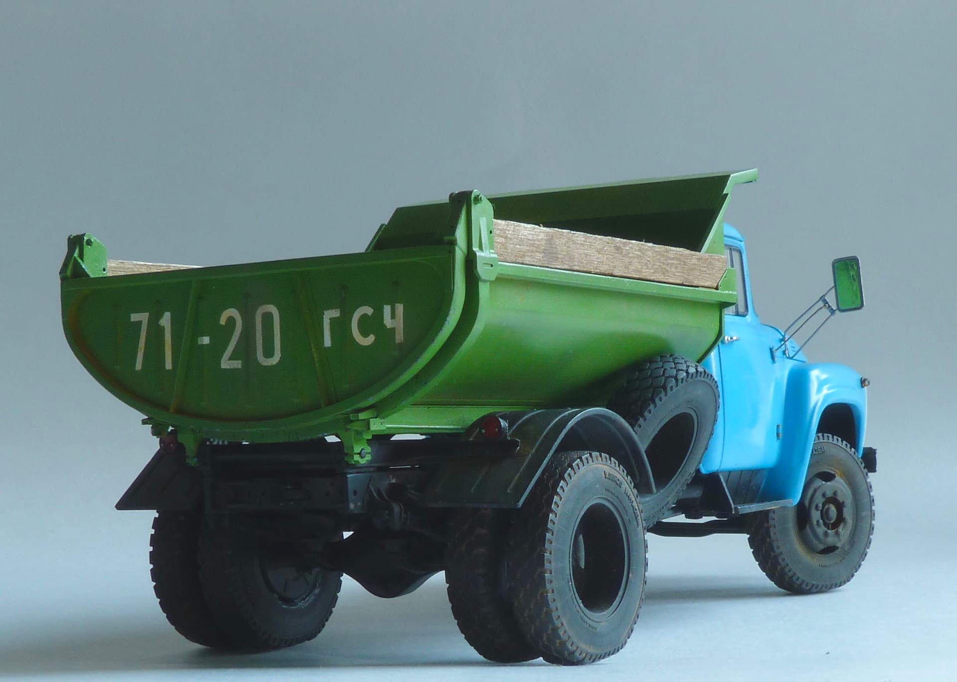

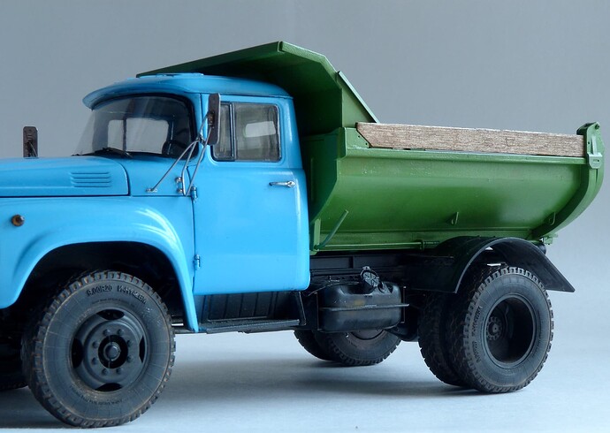

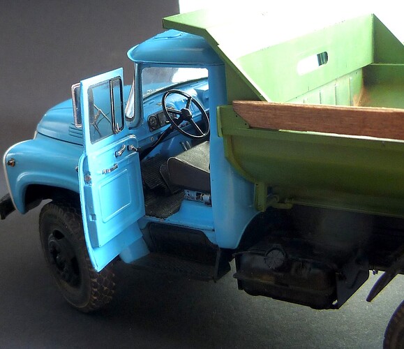

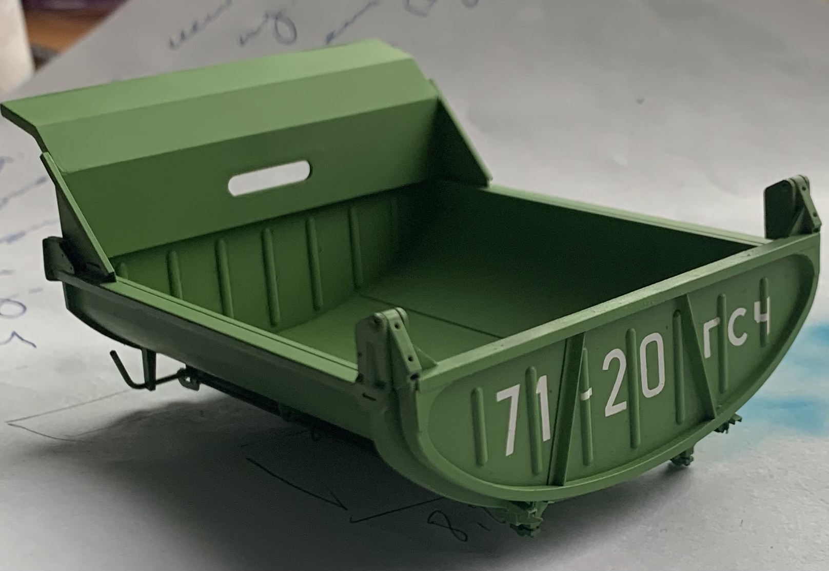

Are the wood slats in the bed plastic or wood?

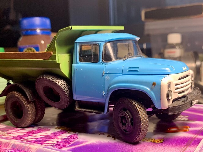

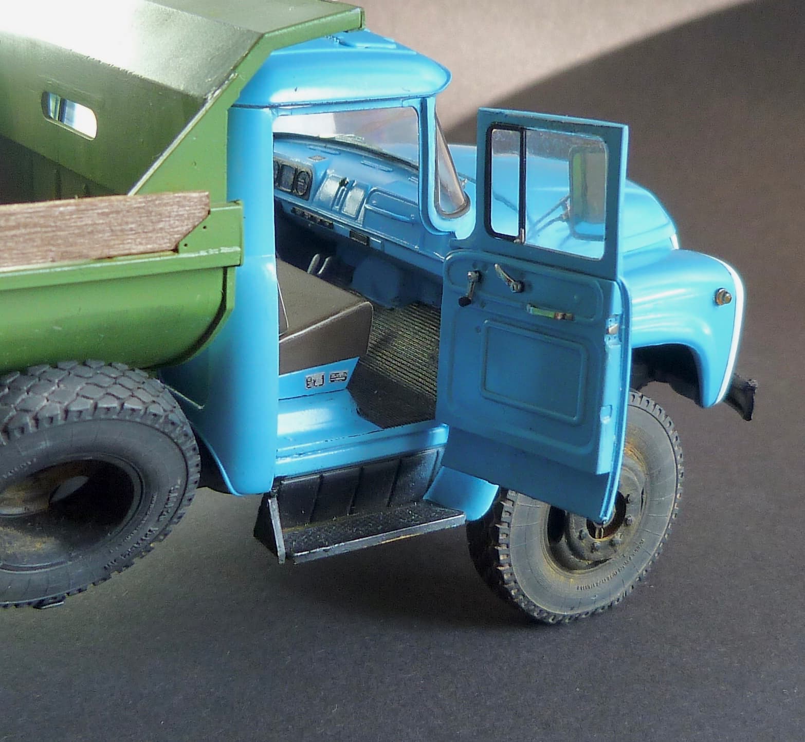

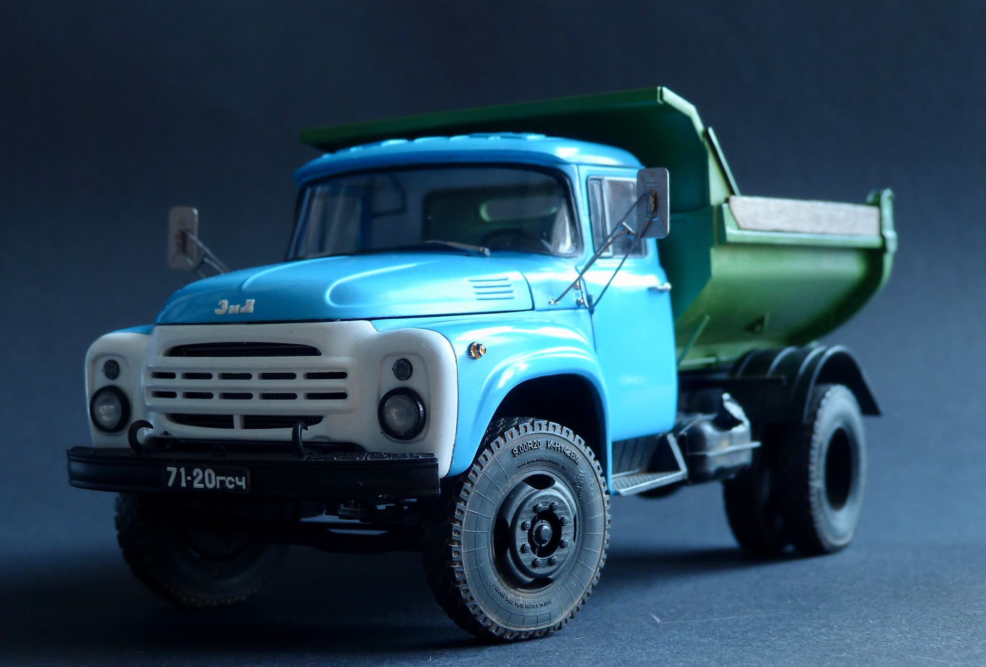

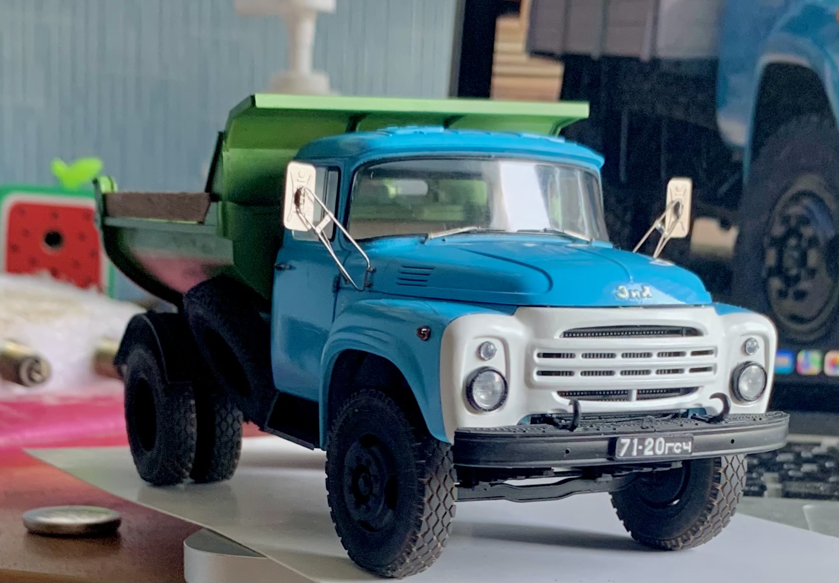

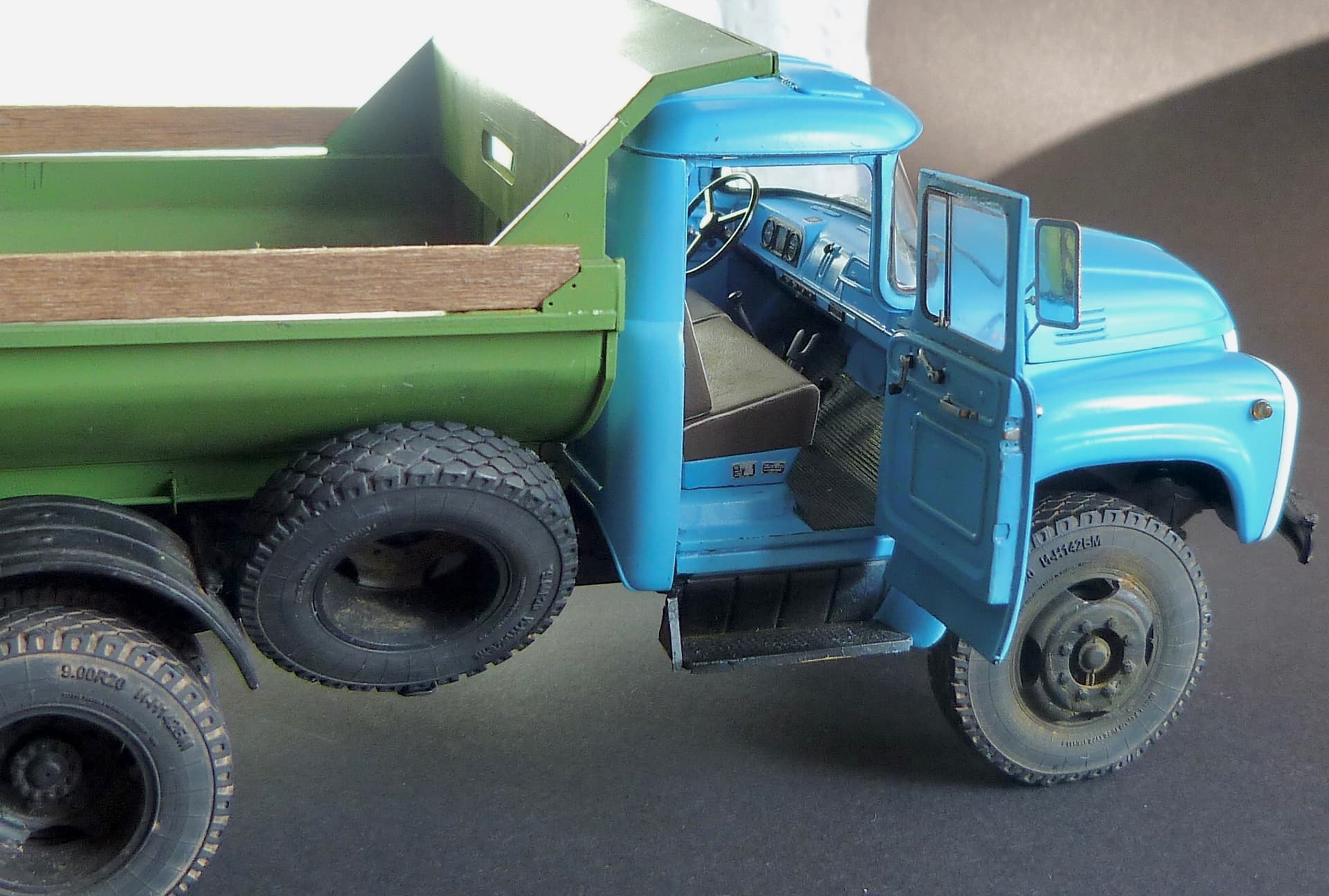

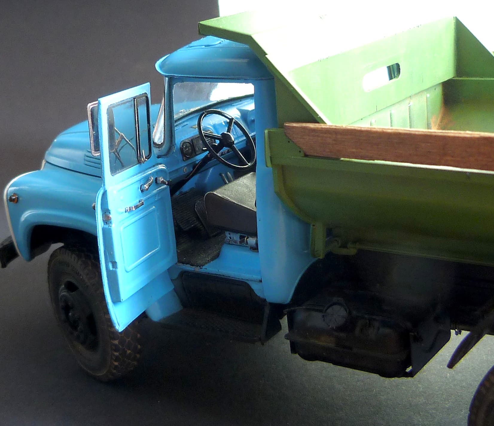

Thanks, guys! Here are a few more photos.
These are wooden inserts. They come off when you get tired of them :blush:

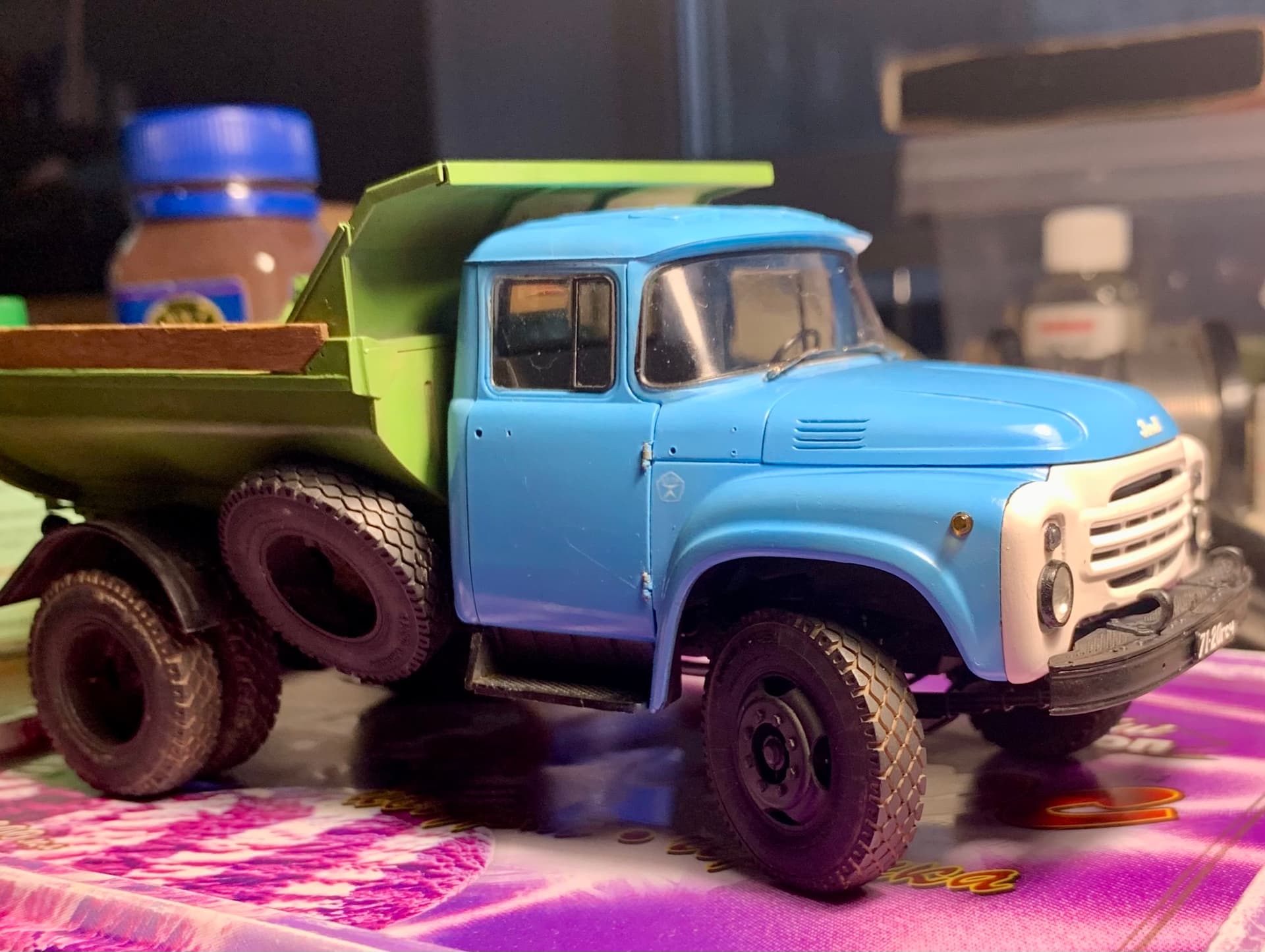

Beautiful build! I hope to someday build a Ho Chi Minh trail cargo version, and this will be a great reference. Are the AVD and the Zvezda kits the same? Wayne
AVD makes 5 different kits, both early and post 1976 versions of the Zil-130, as well as the early and late MMZ-555 (the build here is the later version) and the early version of the MMZ-4502. Zvezda’s kit is of the post 1976 version and is a completely different model from the AVD kits; they are unrelated.

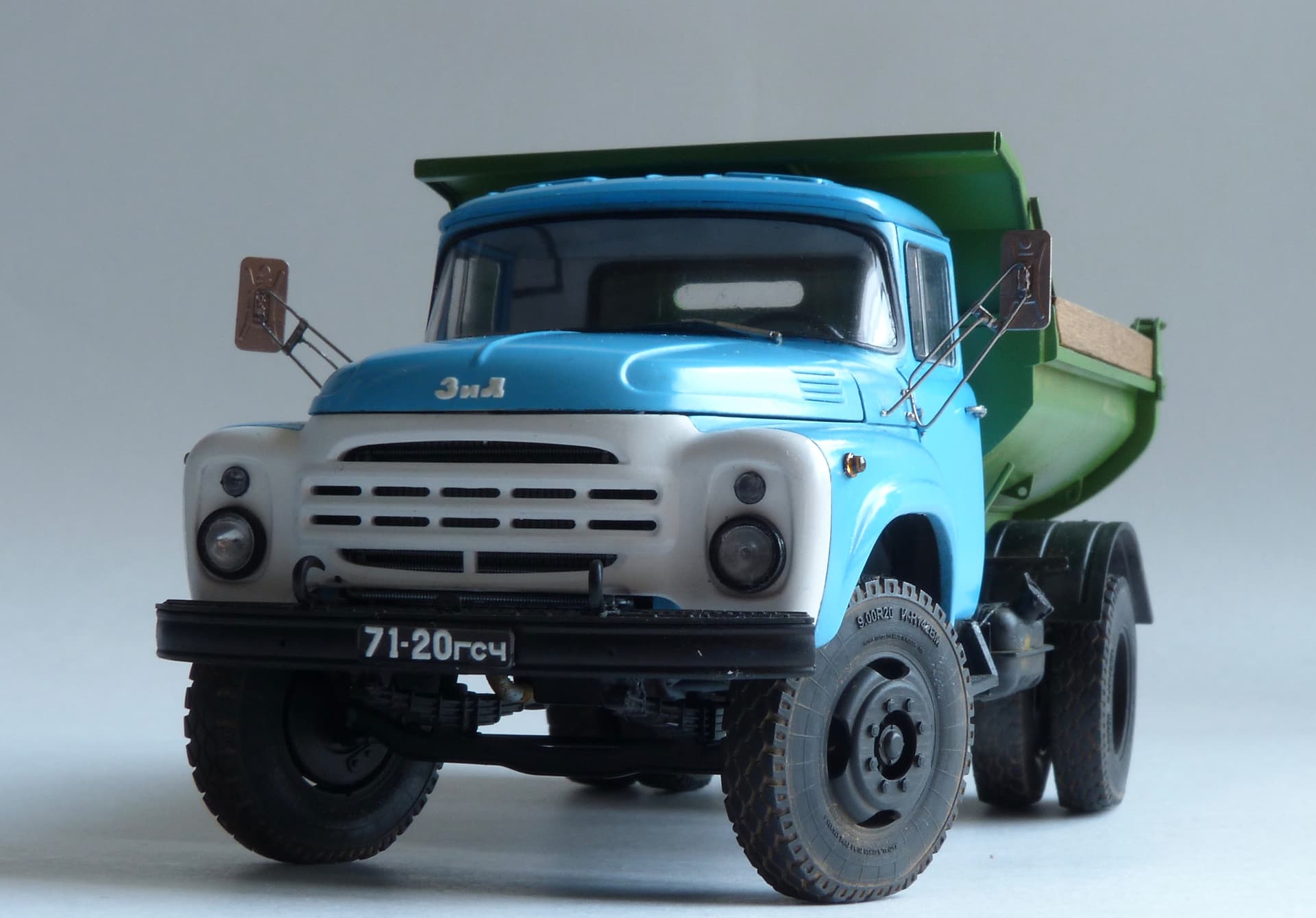

As far as I know, these models are limited to 1983, when only one hatch was left on the roof. It’s also worth remembering when the two-tone turn signals on the front grille were introduced. But variations may vary.

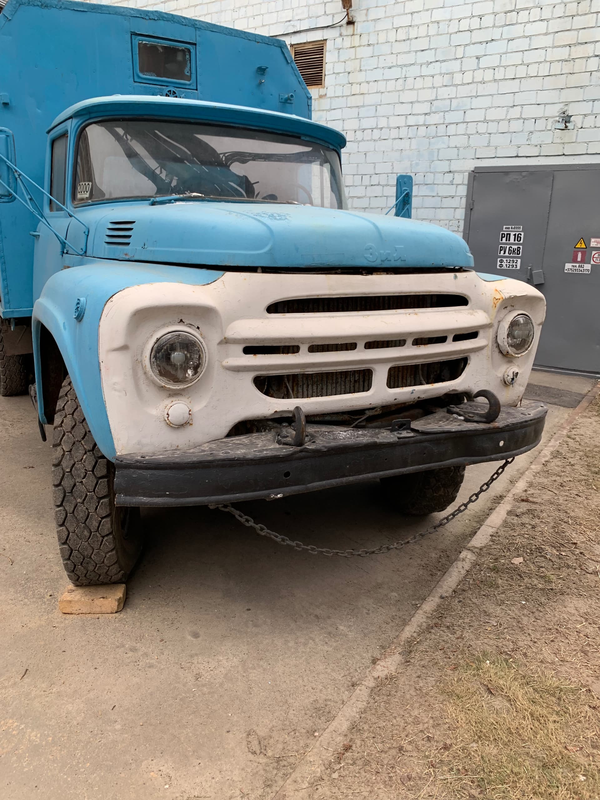

I think this one.

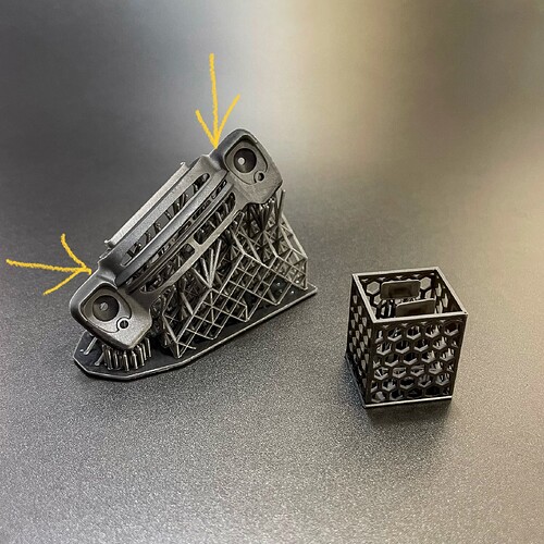

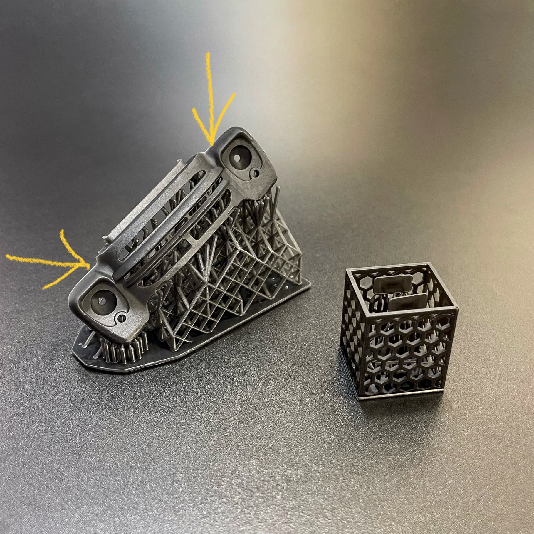

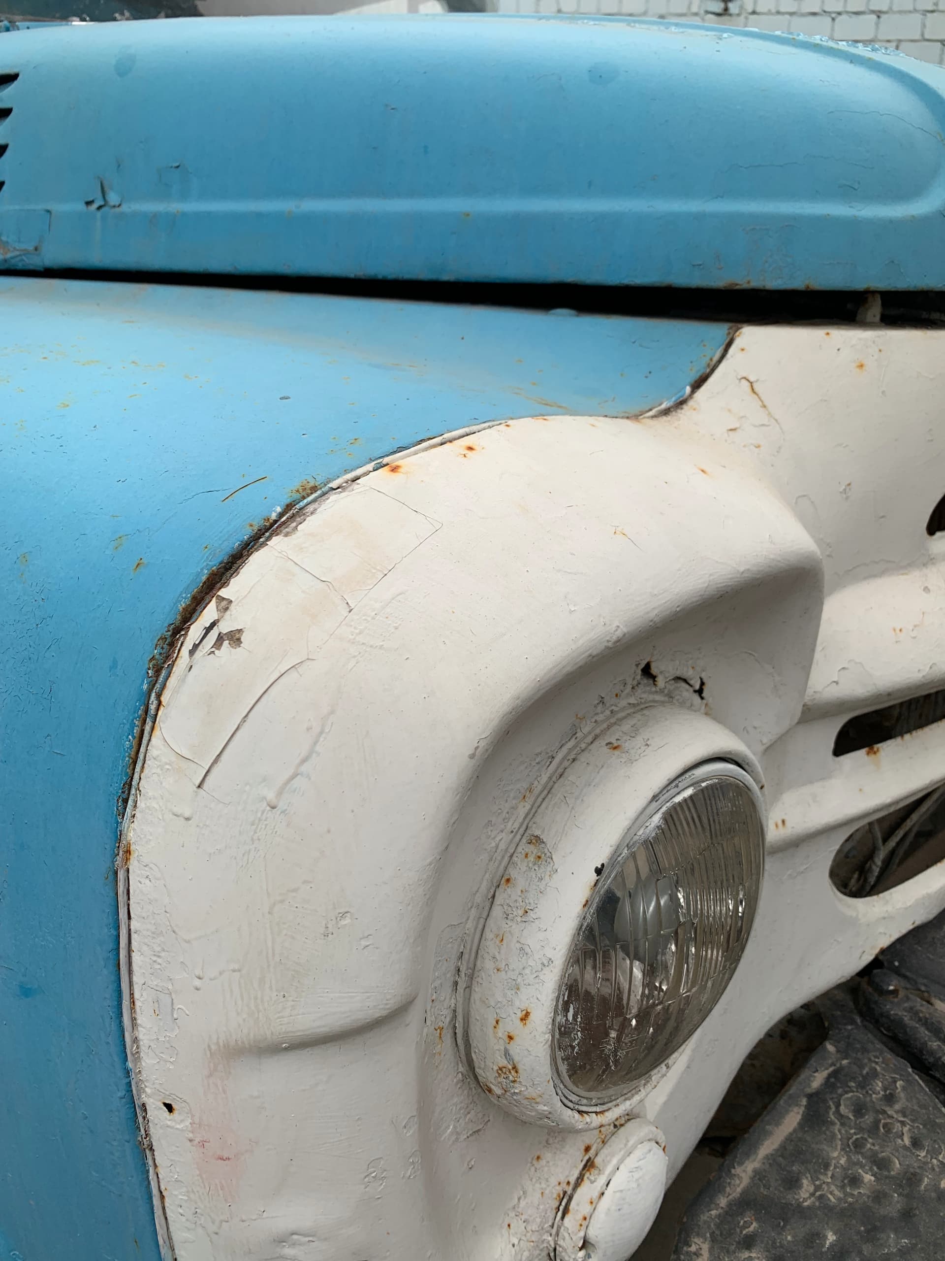

There are conversion options, such as GE Models. For a more accurate reproduction, the areas marked with the arrow need to be deepened/rounded. This is a minor issue with the AVD kit—the grille is slightly angular.
