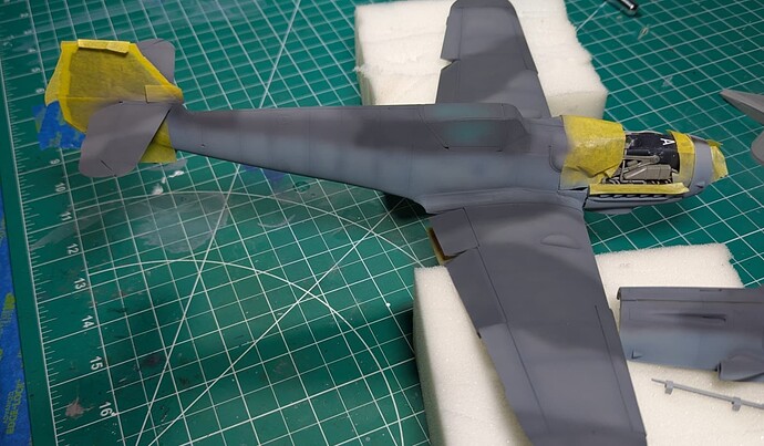

Most construction is completed, so I put down the initial color-coat.
Planning at least one more pass with each color before the mottling.
Looks good so far, Ed! :+1:
But the paint looks really dull. What brand do you use? Tamiya?
Yes that is all Tamiya XF on the exterior. I did use the Testors Model Master enamels on the engine and cockpit.
I am concerned about the clear coat making it all too dark, I’ll usually apply some highlights prior to that step, sort of like post shading but with lighter color not darker. The darker areas were pre-shaded, I used dark grey for the blue and black where the darker colors went. It looks like I’ve lost much of that so will probably do a tiny amount of shading right before the clears.
Also corrected something I misread in the ZM instructions. Words said RLM74 but the image showed a two-tone gray camo. So I’ve replaced the darker gray with the dark green.

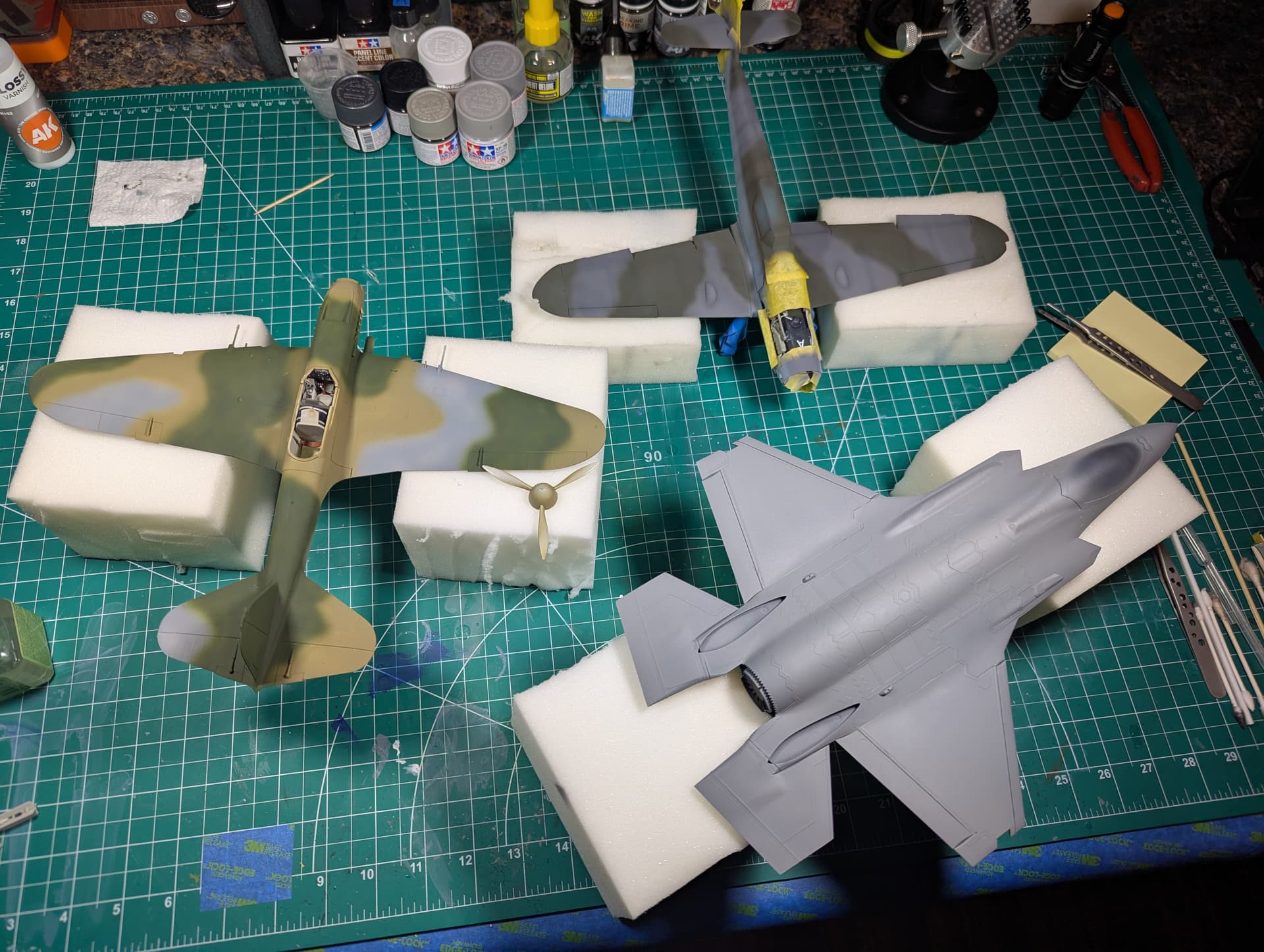

Today was a busy day at the spray booth.
But to stay on topic…
As mentioned the dark gray I had previously was overlaid with dark green. I’m afraid it is too dark, so I am just gonna chill for a bit before clear coating it…in case I change my mind.
That IL2 is from Accurate Miniatures, I got it for $10 or $15 at the Austin Model Show in November. It was nice to have a kit mostly built in a few days after the Zoukei Mura “experience”. I love the complexity, and am ready to do another, but sometimes the smaller kits are great for the positivity.
The F-35 has been on the back burner for a long time, I just took advantage of the time I had available today.
Do you think the gray or green upper paint (on the Bf109) is too dark?
Sorry, maybe I misunderstood. You changed the darker gray to a dark green but, as you said: “The words said RLM74 but the image showed a two-tone gray camo.” But RLM74 IS a gray (gray-green is the official designation) and it looks mostly gray. Why did you overlay the dark green? The previous scheme was correct in my eyes…
therwise very complex and well-constructed project. Nice work!
Dan
You did not misunderstand at all my friend.
I admit I may well be the one in the wrong here, the original color was chosen to match the Testors Model Masters version which was almost all gray (no green) and the thing that changed my mind was my research. I think it comes down to who you can or should trust. I do not know anyone who was near to an active-duty Bf109 G-14 that could settle the discussion. So I settled with what I found in the Squadron-Signal Book (“Walk Around” series) about the Gustav series. This picture might misrepresent the green as a medium green, but I chose to use much darker yet still more green than gray.

EDIT: the picture I took a picture of looks lighter there then it does here. I feel like I’m chasing a ghost some times.
Another challenge is the color between paint brands changes.
This is very true! But in the absence of an original palette to compare with (the samples we see online are never the absolute truth, also due to the different response of our monitors.
But this is another problem… :grinning:
