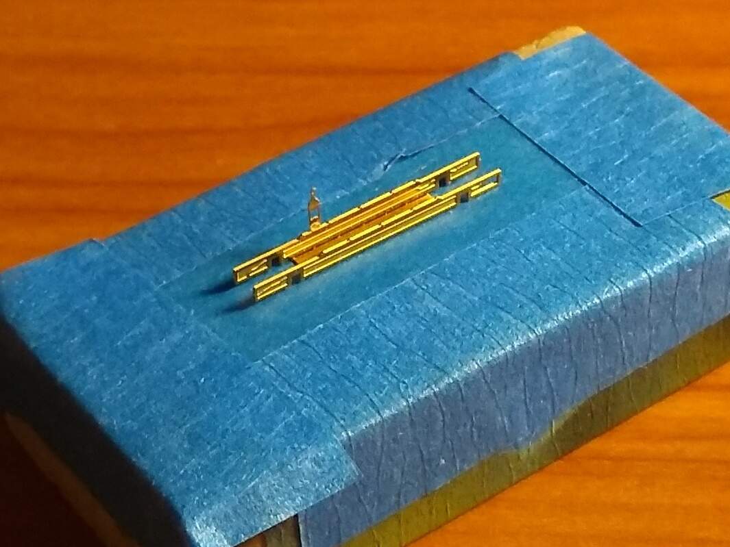

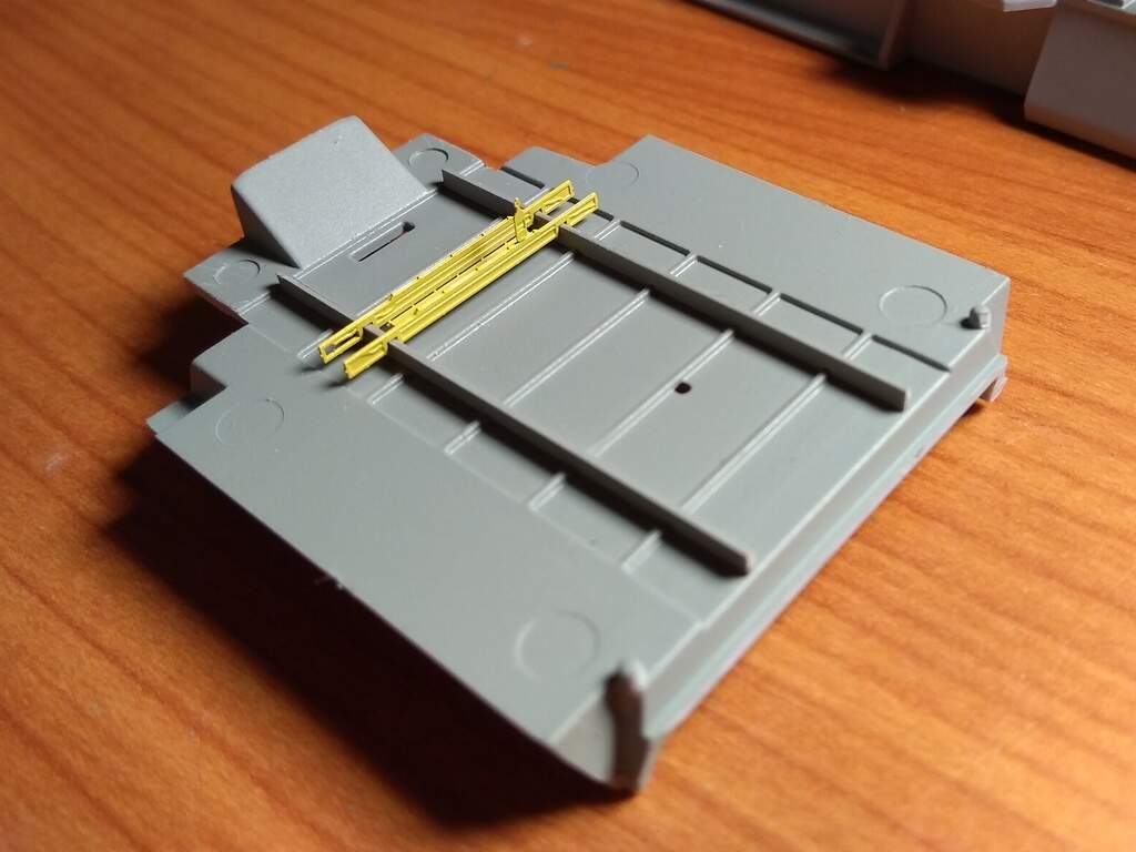

First up, the PE Boat davits.
Gantry Crane
Then I added some more details to the hangar roof to locate the gantry crane

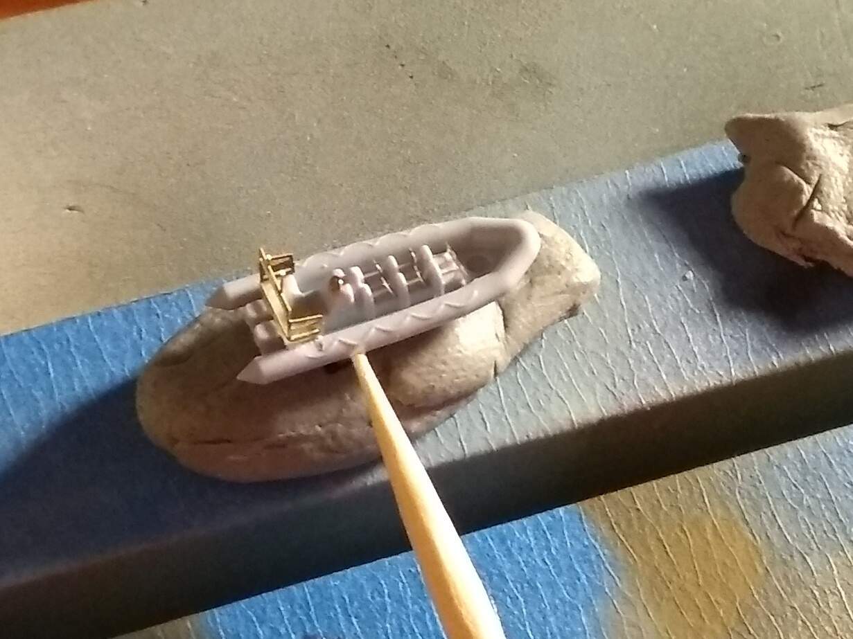

Ship’s boats assembled and the non-visible side super glued to cocktail sticks to facilitate painting

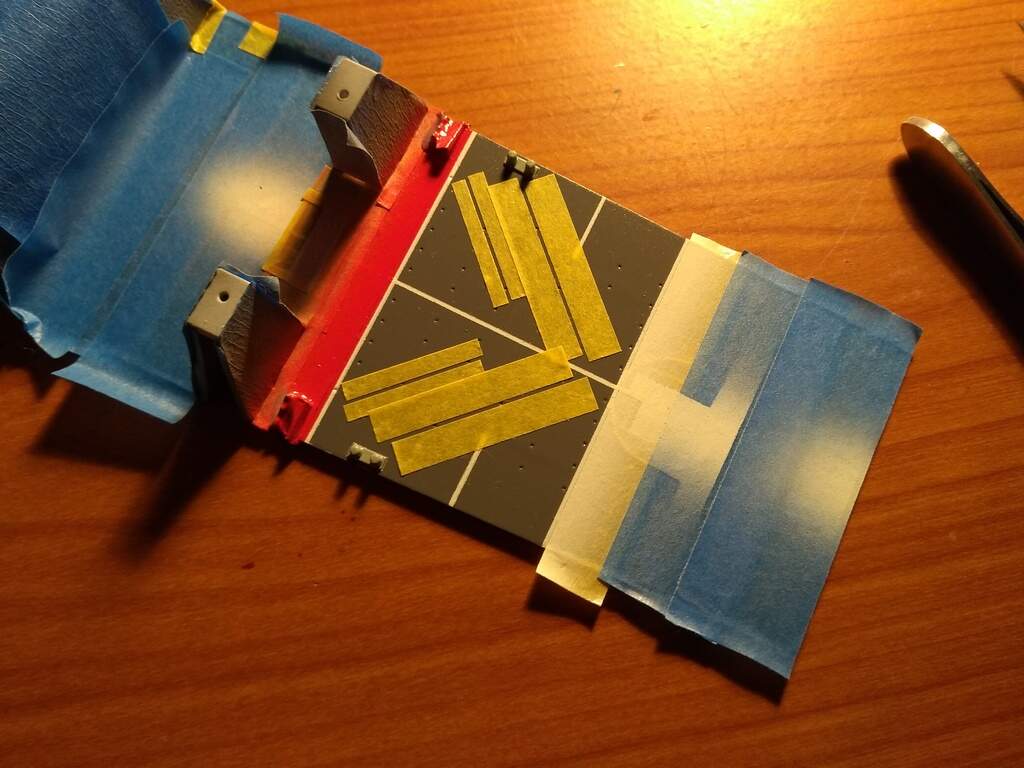

And now for the unspeakable of unspeakables

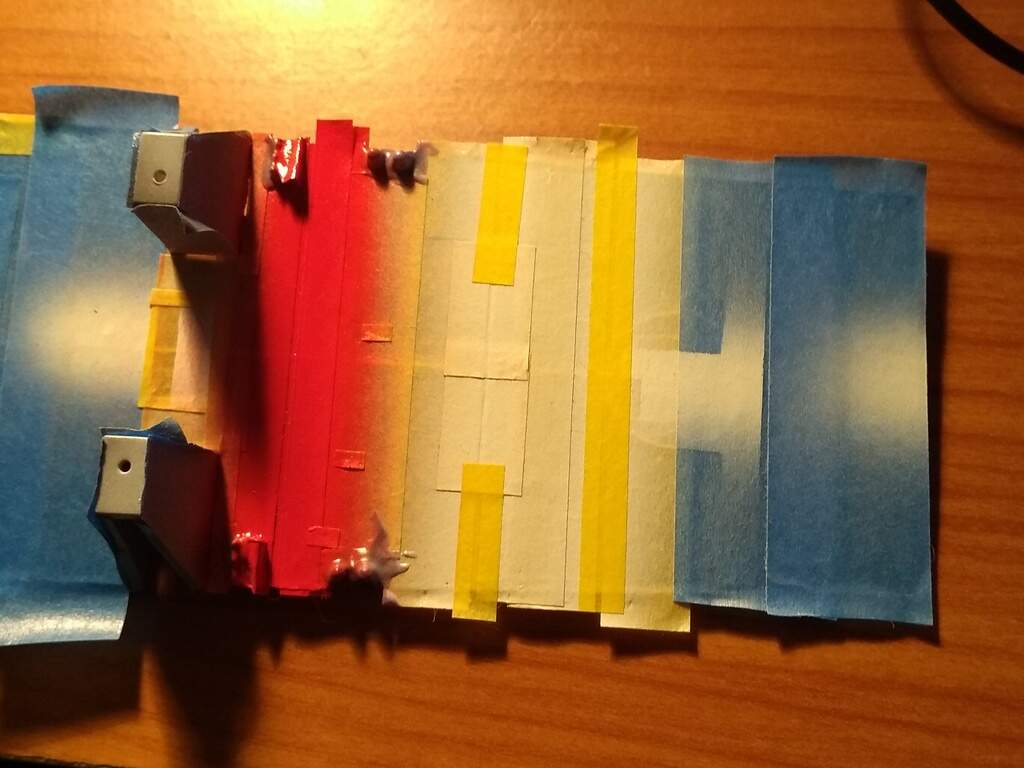

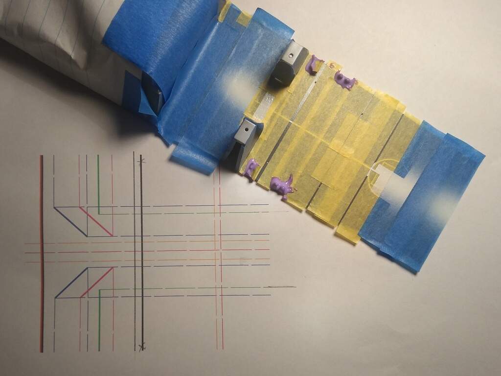

masking the deck to apply the deck markings after destroying the decal and the first shot of paint.The reveal
Then masking for the next set of lines. Measuring up the painting guide I made a template to assist the correct placement for them
Painted
The red!

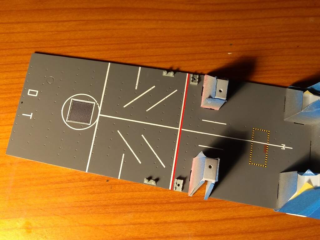

Masking the angular lines
Nearly there
Now the tricky part, adding the “M”. I printed out a set of "M"s over which I laid some Aslan S79 masking film and carefully cut out a “M”
I’ve now applied a coat of gloss clear and then a coat of mat clear to the deck to seal in all these details. I can now finally start assembly of the hull.
Also finished are the ship’s boats

That was a lot of work on the flight deck, but you did a masterful job on those markings! The RHIB looks good too.
Flight deck looks awesome. Great work on such finicky detail!
Russell,
Great job on the flight deck. Glad the template worked out as well as it did. I think it beats any decal you could have used.
Mark
Hey mate,
fantastic work! As Mark says, I’d think it looks better, sharper and smarter than any decal! Completely worth the effort, even though I can feel your pain…
RHIBs look really smart, too!

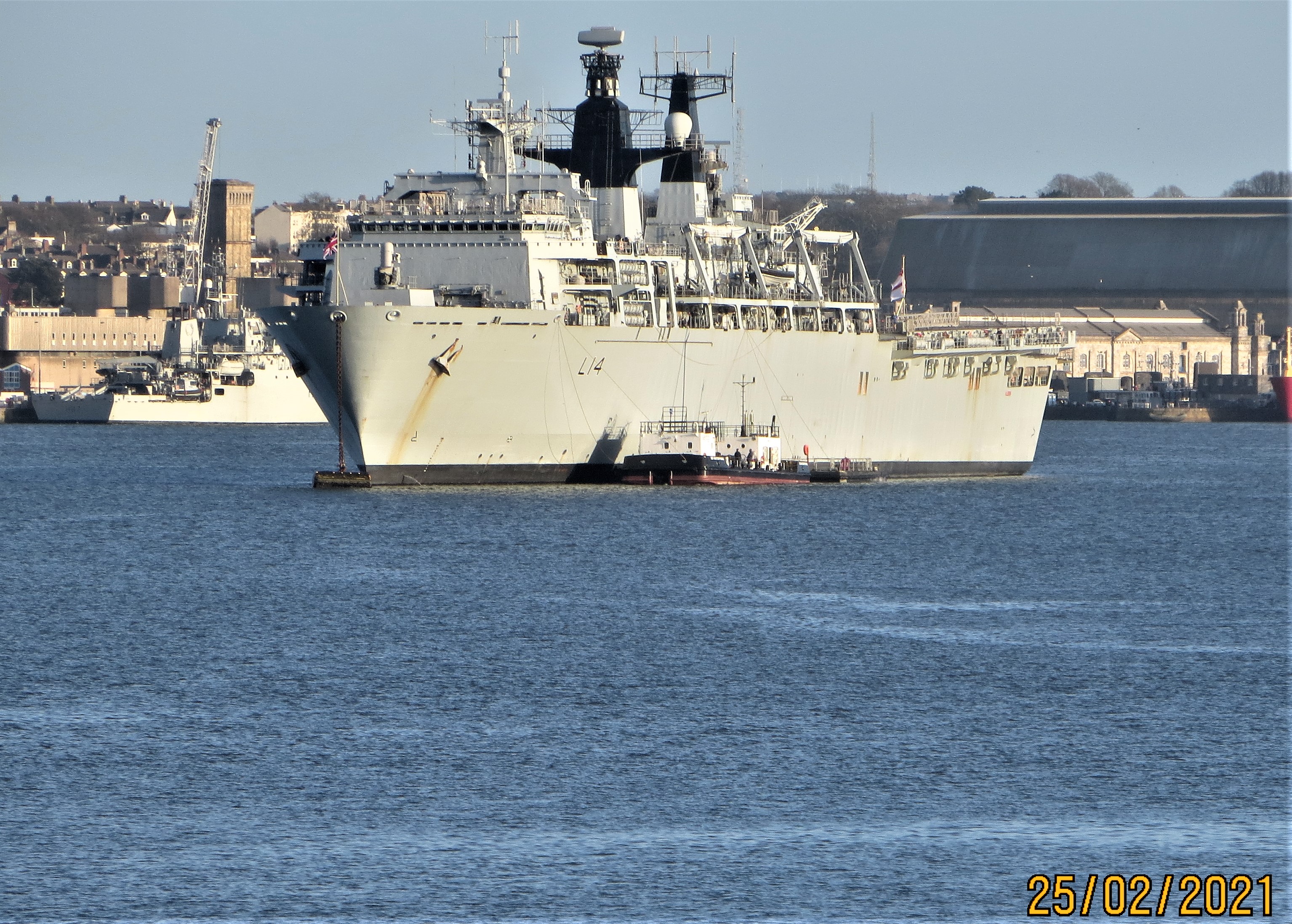

As an aside, today I’ve had HMS Albion moored off of the back garden,

The RHIBs look quite good don’t they?
Not bad for a single plastic part and some PE. Although, I’m thinking I’ll build one boat deck open and the other closed, so I’m not sure what to do with the spare???

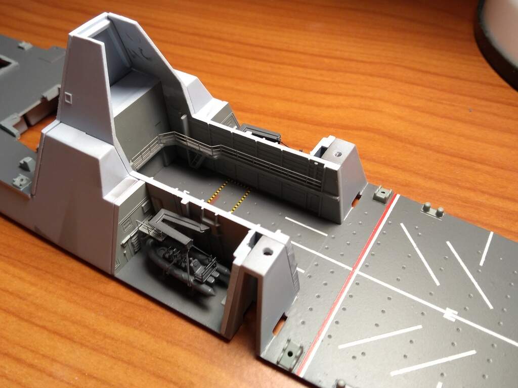

The Hangar and Boat Bays are now completed after quite a bit of fettling to get the plastic parts to the correct size (the hangar/boat bay walls were over 0.5mm too tall!).
The gantry crane fitted to the hangar roof
Close up of the boat bay. Of all the PE the “claw” holding the RHIB was surprisingly easy to fit.
The front of the mainmast fitted off
And roof of the Hangar fitted and the rear of the mainmast
So far the PE has been a real battle, as it doesn’t seem to want to fit very easily into places it’s supposed to. For example, the Hangar wall upper level railings needed some pretty heavy handedness to wrangle (mangle) into some sort of position, and the platforms in the boat bays just were a nightmare to get square, and have the railing look half decent.

Great job, Russell…this is really turning out to be an EXCELLENT build!
Lovely masking and marking for the flight deck … that really lifts it up
Hi Russ,
awesome work, mate! It’s a shame that the kit seems to suffer from bad fitting, and the PE as well, but you can’t see that on your build log, great job overcoming the issues! Dauntless is coming along really nice!
