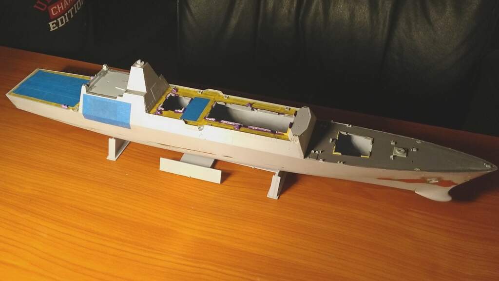

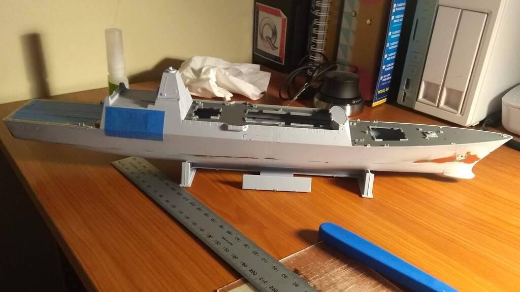

The dockyard is back to full speed ahead and the P80 has done its work.

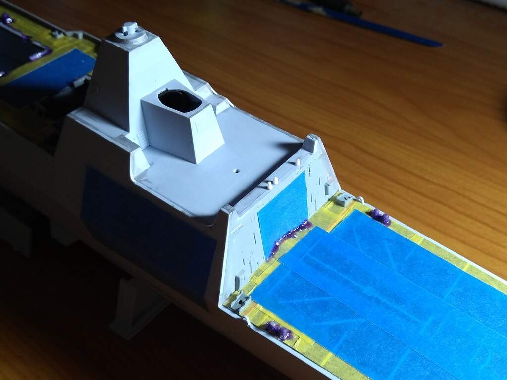

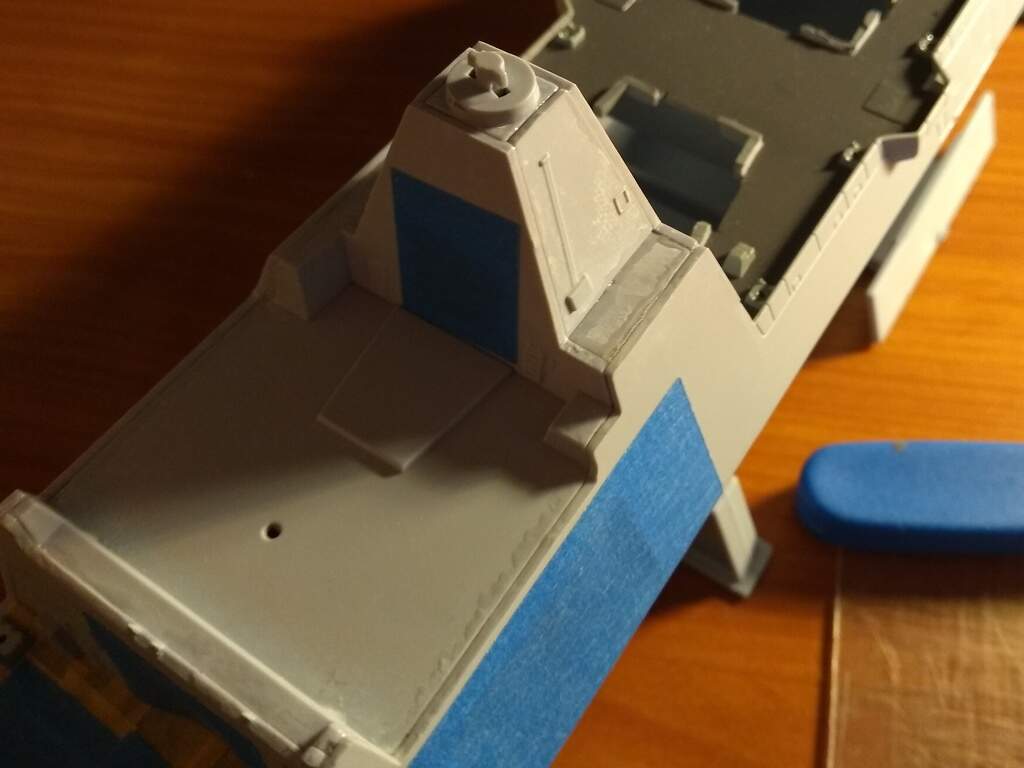

Now down to the final stages on the hull (P600) a few minor areas to finish off (around the anchor) before moving on to filling the seams on the upper structure.

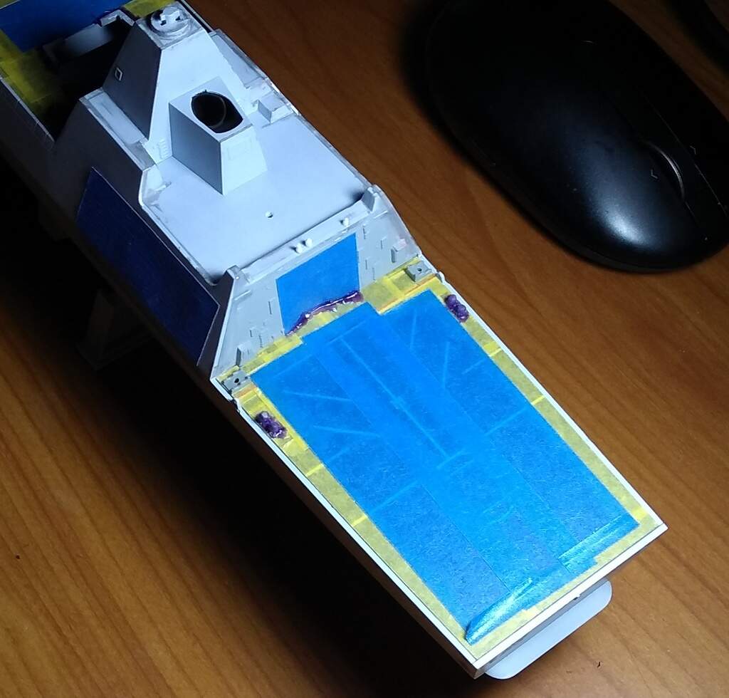

The flight deck is now taped up for protection and will stay this way throughout the build now

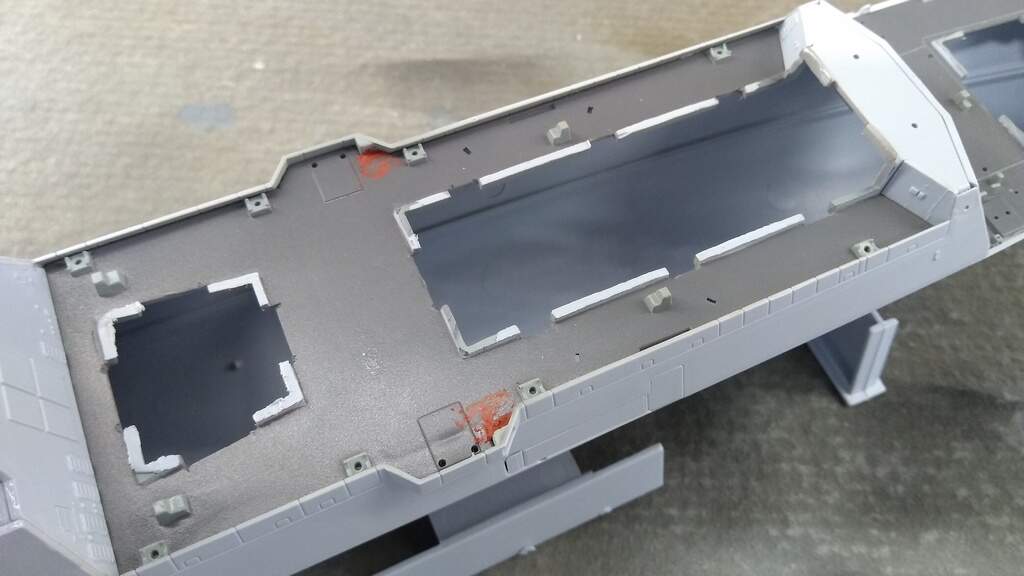

Some ratholes have shown up that need filling
The deck will need to be repainted in these areas, but that’s not a problem.

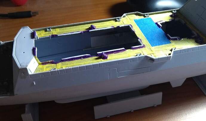

I’ve started filling the seams with medium CA applied with a toothpick.
After it cures I paint it with water based silver paint and a hairy stick to see how it looks before sanding back. I find this method works really well when you need nice crisp corners and good accuracy.
Obligatory overall shot
More soon :hugs:
Looking great. Well worth all the work.
Great progress, Russ! Good to see that you’ve tackled the - or at least one of the? - greatest problems with that kit, looks really good, mate! And she’s a big ship, even bigger than mine, I wasn’t aware of that. Especially her beam - that’s pretty impressive in your last pic! Somehow I always thought that they would be about the size of our 124-class, but in fact, they are more like an Arleigh Burke!

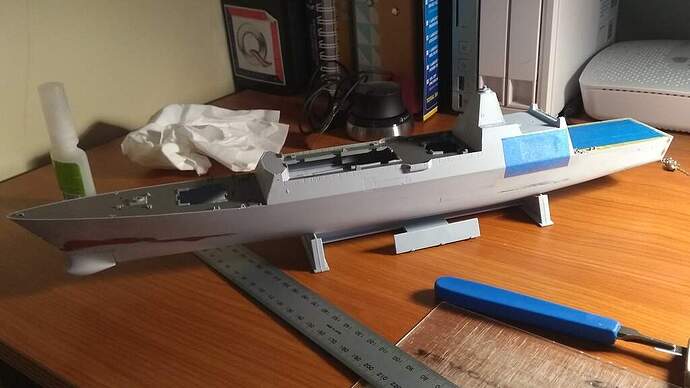

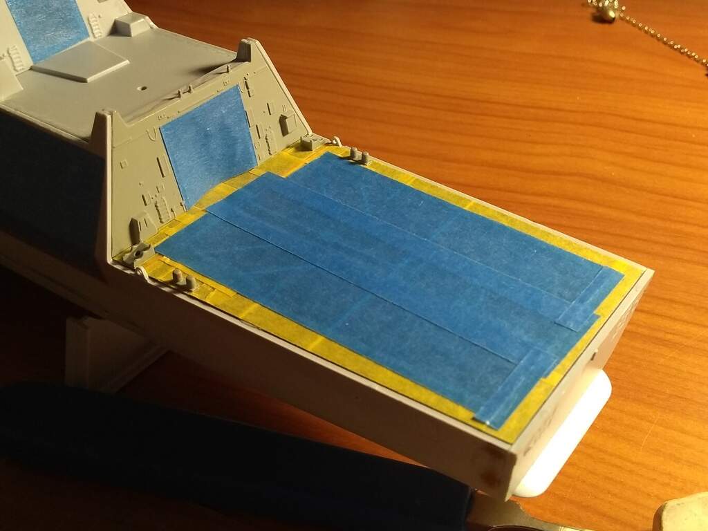

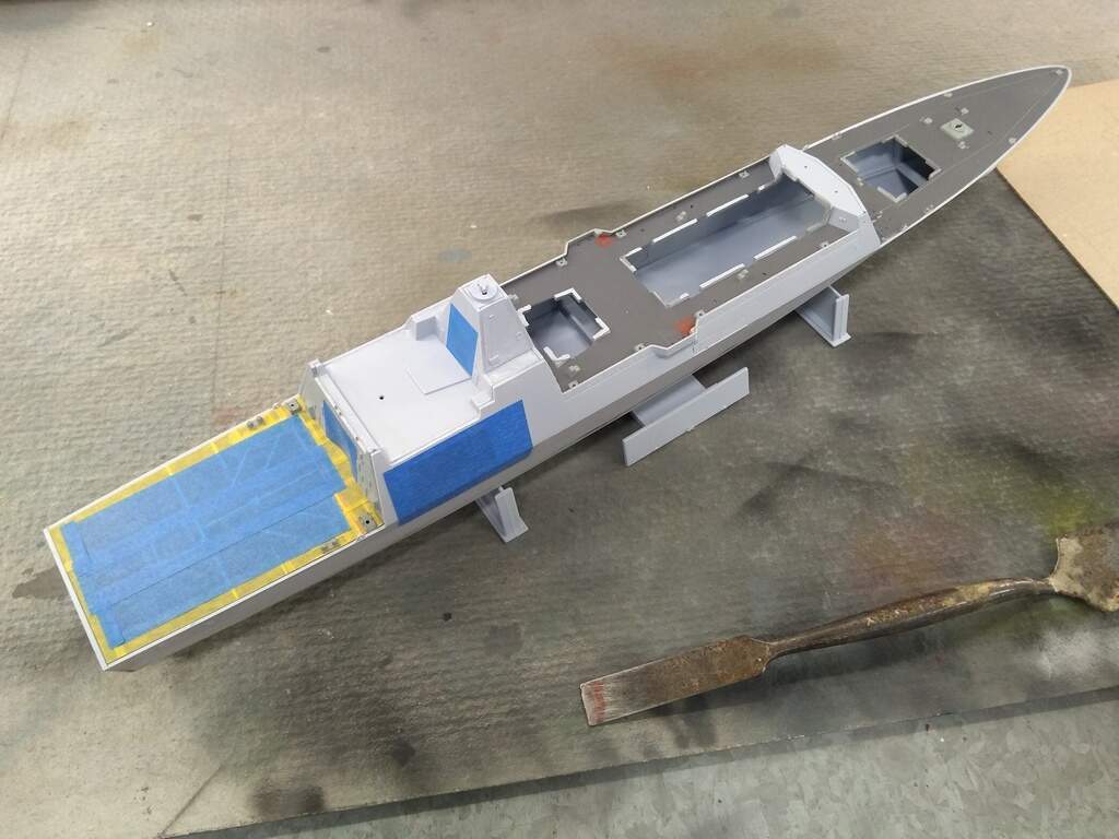

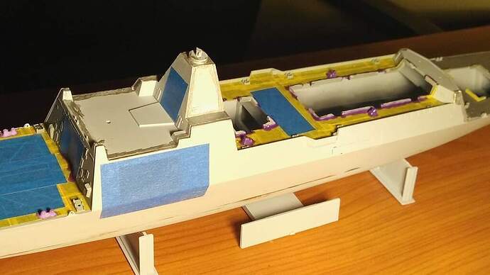

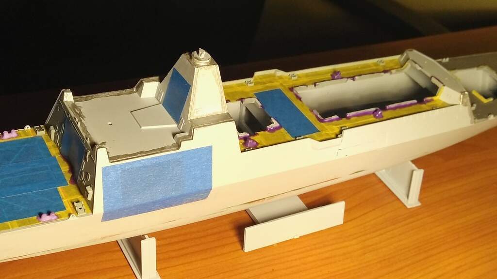

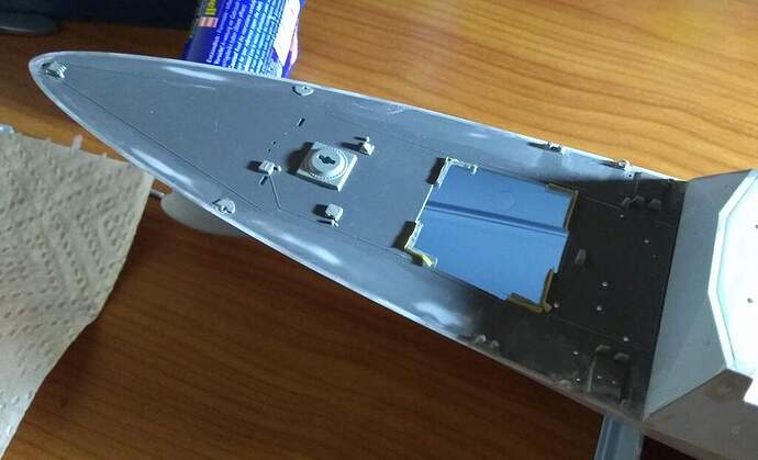

Ok, some good progress to report, although it doesn’t seem like much, but this is the all important steps to prepping the hull for paint. :hugs:
Midships deck is all masked up allowing the filling and sanding of the seams with super glue and checking with silver paint. :cowboy_hat_face:
Unfortunately I’m going to have to repaint the fore deck but that was always a possibility. :face_with_head_bandage:

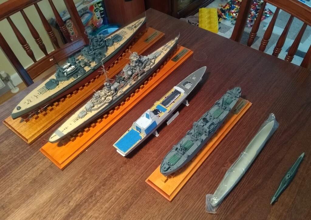

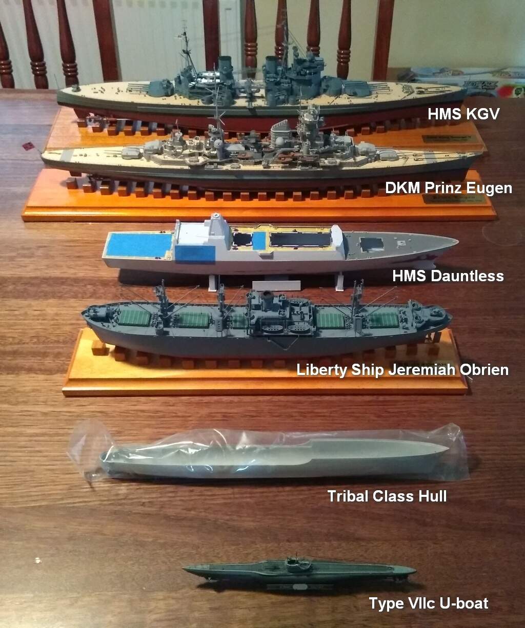

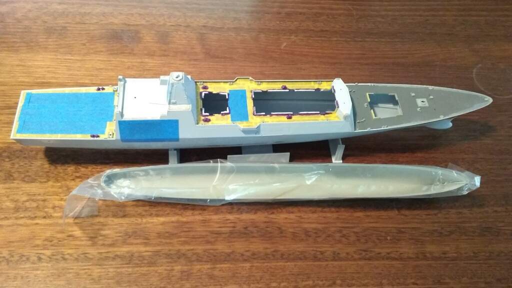

Now, for those wondering, the Type 45’s are a big class of ship at 152.4m and 7,350~8,500 tons displacement. So, I’ve put together some comparison shots with some other ships.
The lengths of KGV and Prinz Eugen are about 50% more than that of Dauntless, but KGV displaced around 35,000 tons and Prinz Eugen around 19,000 tons. I guess there’s a lot to be said for just how much armour plating went into ships back in the day. :shushing_face:
Here’s a shot with just the Tribal class hull and Dauntless together to illustrate just how much these ships have grown. The Tribal class displaced around 1,850 tons
I was going to put Lord Nelson in the shot too, but she’s tucked away in the stash and too hard to get at. But, FYI, Lord nelson is shorter than Dauntless at 135m but around twice the displacement at 16,000tons. :astonished:
Once again, thanks for looking, back off to the bench… now, where did I leave the sand paper??? :thinking:

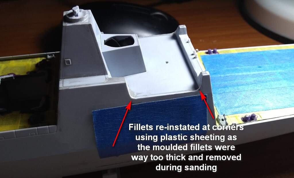

All the basic sanding is now completed and it’s onto adding in the details.

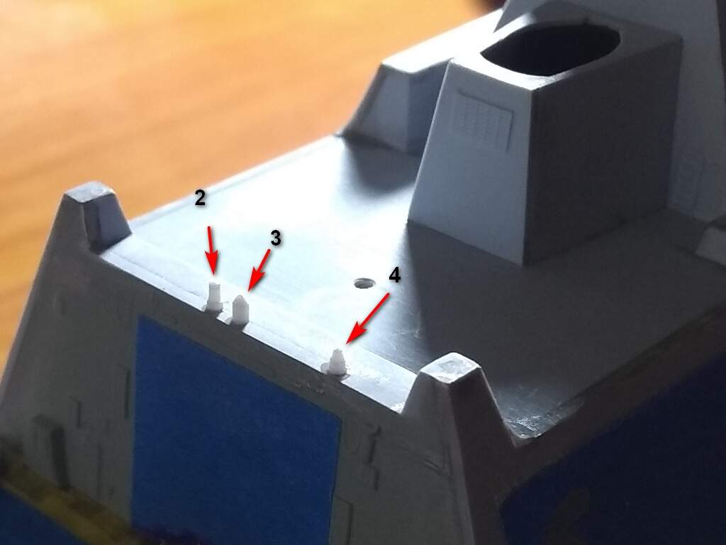

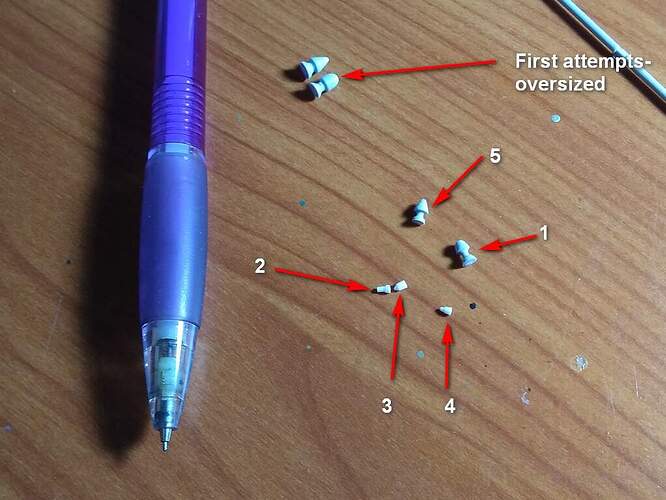

On the top of the aft wall of the hangar there are some small details that need to be added in.
D34-HMS-Diamond-011_AA

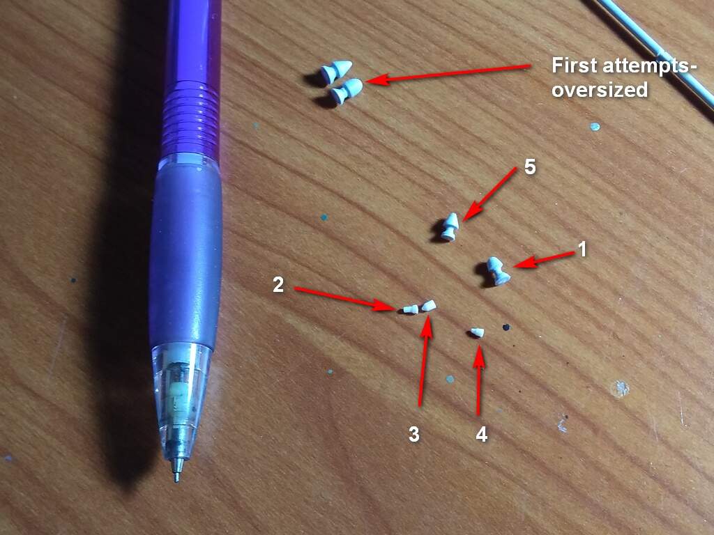

Items 1 and 5 aren’t represented at all by Airfix’s kit and items 2,3,and 4 were vaguely moulded and were promptly removed earlier on during the cleaning up process.
In order to re-create them, I took some left over sprue and was able to turn the required items by inserting the sprue into my cordless drill and running at high speed, I was able to carve the shapes required with files and sand paper.
2,3 and 4 are now attached but I’ll paint 1 and 5 separately to make sure I get good coverage

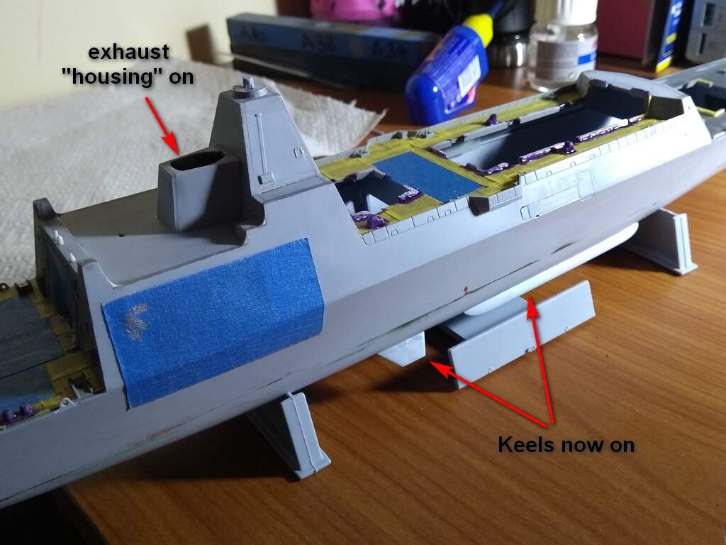

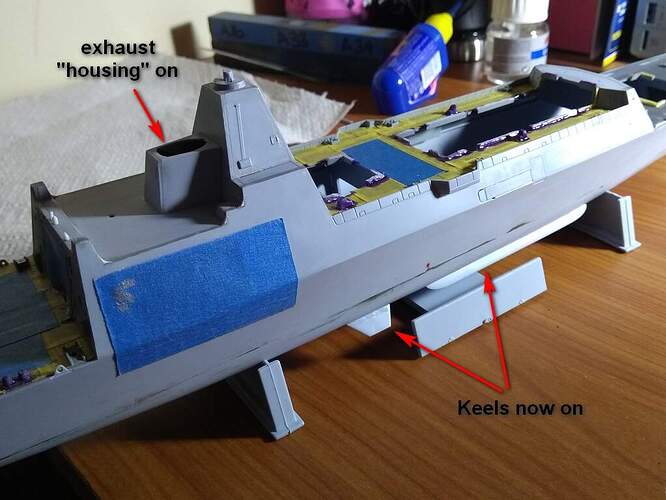

other details added as the pics show
Foredeck all finished
All in all, I think I used around a 1/3rd of a bottle of CA as filler! :shushing_face:

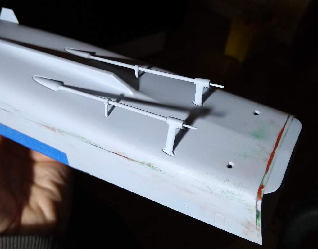

The prop shafts are also being fitted, bar one piece, which is giving me trouble: more areas requiring filling :man_facepalming: and the anchors are now in place too.

Really take shape nicely now Russ, it’s looking really nice and as you say… Pretty sleek. I was impressed by the comparison shots of the hulls. I’ve seen these 45s down in Pompey countless times and genuinely never thought about the comparative size against a WW2 battleship…it’s quite surprising see it like that :+1:
Hi John :slightly_smiling_face: it makes for an interesting comparison doesn’t it? Being able to set these different classes of vessel side by side and get an appreciation of their relative size is part of the reason I steadfastly build only in 1/350 scale :cowboy_hat_face:
I can’t help but ponder, looking again between the type 45 and the larger vessels: are the type 45s larger than we think or were WW2 capital ships smaller?
On a side note, it seems the type 45s replacement will be larger again, in fact so large that they’ll be given cruiser classification: type 83!
they certainly look bigger and have grown in size, also noticeably in the beam as well, which you can probably put down in part in things like the added helo hanger and landing pad which takes up a big chunk of area.
I wonder (without digging into ref books) how far away a type 45 could sink a WW2 BS and vice versa ?
The type 83s sound like they will be a bit of a beast…
This is all opinion but I suspect it would have an issue killing a WW2 Battleship. Damaging yes, likely severely damaging in fact but sinking one would be problematic due to missile count and the BB’s armour protection.
The type 45 uses harpoon missiles as its main anti ship armament. Depending on the Block it has a max range of 77 - 150 nautical miles with a 487lb warhead. The Type 45 is also faster than most (if not all) BB’s so could maintain the range indefinitely. Unfortunately it only carries 8 missiles and from what I understand, underway reloading is not an easy thing to do.
The only BB it would realistically be fighting is a modernized Iowa which also carries Harpoons so the range is negated. Both vessels carry Phalanx but the Iowa’s carry more (4 vs 2). Once the Type 45 is out of missiles then its down to main battery fire and I am not convinced the type 45’s 4.5 inch gun is going to make an impact :stuck_out_tongue:
The longest ranged BB gun hit is around 15 miles and that only happened twice.
So TLDR: A Type 45 can damage (maybe kill) a WW2 era BB from well outside the effective range of said BB. The BB wouldn’t even see the Type 45 so the Type 45 is effectively invulnerable. If the Type 45’s captain was an idiot it could be killed at a max of around 15 miles by a WW2 BB. Against a modern Iowa, all bets are off and I think the Type 45 is doomed.
