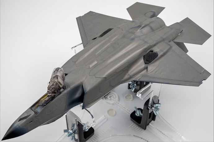

Got the post-shading on the topside done last night. I went a little heavier on the topside for two reasons, it’ll be more sun-faded than the underside, and after clear coating the test spoon in the HAVE GLASS metallic matte, the effect was somewhat muted and I want to make sure it shows through. I think this will balance out the underside nicely, which has now been gloss clear coated after letting the oils dry for two days. The timing works out well on the topside, as I’ll be away from the bench until Sunday.
After a surprisingly long decal session, the HAVE GLASS special matte metallic clear from MRP is on and the F-35A is ready to be masked up for the secondary color. I fiddled with my polarizing filter on my camera to try and capture the metallic the best I could, but it varies a little from photo to photo - might have to snag a video of it on the turntable when it’s all said and done.
I’m very pleased with the metallic clear, I think it’s got the perfect amount of purple for my eyes. Not that there’s any one good reference photo to point at, because boy does this color change based on lighting and angles!
I did a light mist coat over the decals as a precaution and then went in with one solid wet coat. I think this worked out well, but if you desire a higher level of metallic you could always build it up in layers. I’d definitely recommend practicing on a spoon before trying it on the model itself if you choose to use this clear. I think it would be perfect for an F-22 as well, but shame there isn’t a kit to the level of the F-35 out there. One can hope.

I’d really like to see this in person one day.
The highlights are very nice and subtle ![]()
Thank you! When I go to Nats eventually, I’ll definitely bring this. I don’t think I’ll be able to make it this year unfortunately.
