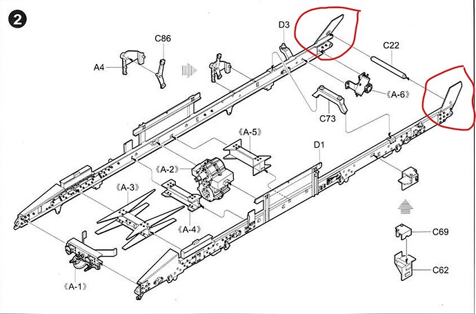

To put it in the wise words of Officer Murphy: “This is going to be a trouble.”
Top is the Italeri frame. (and yes, I’m almost there designing the entire HEMTT)
Bottom the Trumpeter frame, so some adjustment is going to be needed on the Trumpeter frame or the cabin wont fit at all, and I’m starting to think / suspect they made multiple frames for the different HEMTT.
They (Oshkosh) do/did make different frames. They are all basically the same though, just longer/shorter/different attachment points for the different versions.
How Italeri and Trumpeter portray them is basically the same as well, with the front cab attachment slightly different, as you have discovered.
I would not pay to much attention to the frame ends, you circled in red. They will not be visible, when the cab is fitted, so it is much more important your parts fit the small part on each frame, which is labeled “D3” in the Trumpeter drawing. And to me it seems, like your printed fit very precisely there.
Also, as Gino (HeavyArty) states, the frame length is often peculiar to each variant. I simply copied the frame size from the Italeri parts, when I lengthened the frame parts on my M985.
