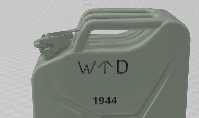

Adding WWII British jerry can to my portfolio:

James, I’m not sure about that yellow can. The star pattern does not match any I have seen.
With the spout to your left, the top of the right upper star arm should be (365mm) from the bottom of the can, which is the height of the vertical side of the can where the spout is. Yours is too long.
The arms are bevelled noticeably, but yours are too sharp - vertically out from the can. The centre rectangle is also bevelled. At the bottom of this shape, the measurements are 115mm x 90 mm and at the top 75mm x 100mm. The bottom of the Rectangle shape is 150mm from the bottom of the can and 120mm from each side.
Clockwise from top left to bottom right, the arms are 115mm, 140mm, 120mm and 135mm long from the corners of the base of the rectangle.
Overall the can is 465mm tall, 341mm wide and 165mm deep from outer face to outer face. The flat section on top of the can under the handles is 145mm long. The ‘triangular’ section at the end that the handle is welded to is 110mm long from where it starts to rise up, horizontal out to the right edge of the can.
PS, these were used well into the 1950’s - I have a 1952 stamped example - so you may have a market for Cold War era builders if you offer different dates. Here is a 1951 example, note the BMS in the rectangle, this is also on mine:
Here is an Australian pattern one, very similar just DD not WD (Defence Department not War Department)
1958 Version with the manufacturer ‘Rheem Aust’ clearer than the pic above:
Recently in the Peterborough Services (off the A1) petrol station they had for sale new metal jerrycans exactly like the historic images, but lacking the WD stamps etc. Seems a great design will always carry on!
This is really good detailed analysis, Peter. Thank you very much.
I certainly eyeballed the star shape and wasn’t going for 100% accurate. However, unless someone demands the change and places a huge order, it seems close enough to me, and it will remain as is. Unfortunatley, I see no market for the AU cold war accessories and very little market for the British.
I’ll keep the data just in case.
Kind regards,
James
