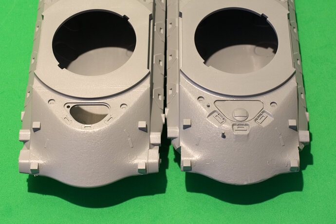

If I feel adventurous, I may CAD the funky-shaped driver’s hatch, too as a part of backdate package. We shall see if I remain sane after making the MG mount:
447301093_10229602648949084_8034439285166220392_n
The horrible Dragon T54E1 kit has a nice early M48 upper hull with flush periscopes and small drivers hatch.
Camp Douglas, Wisconsin has a flat deck '48 that has this cupola.
https://www.tripadvisor.com/Attraction_Review-g59754-d10237063-Reviews-Wisconsin_National_Guard_Museum-Camp_Douglas_Wisconsin.html
Does this help? Same 'A5-

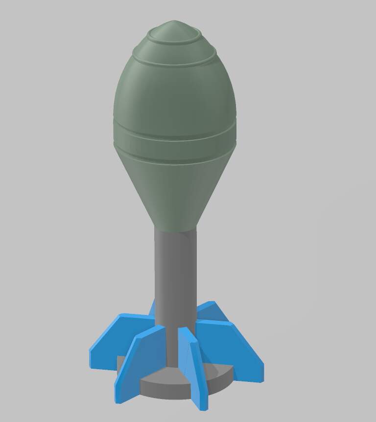

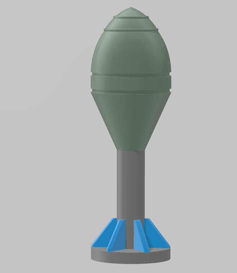

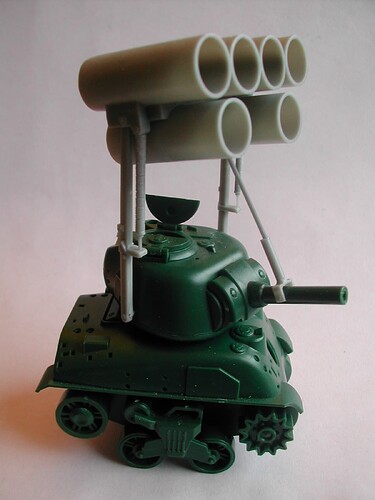

Something not so accurate. :smiley: M8 Rockets for Meng Toon T34 Calliope. Only CADded the rockets.
For
Unlaunched and launched versions
Unlaunched
Launched

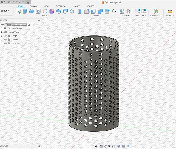

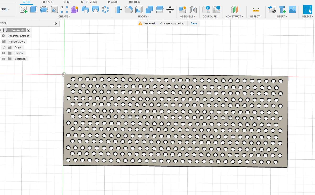

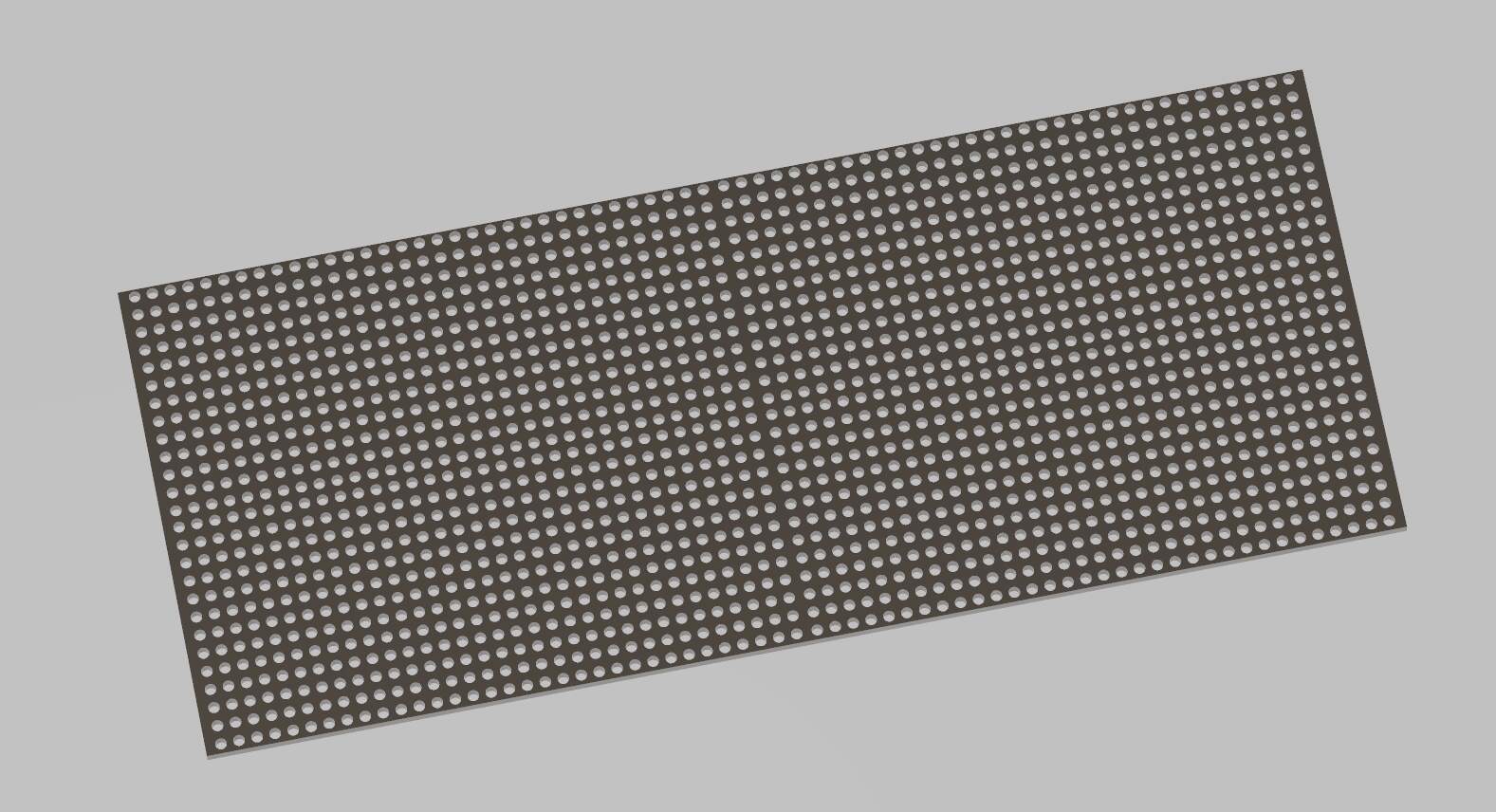

Been practicing making repeated patterns on Fusion 360:
Getting the hang of it:
Planning to use it to make this on Leopard 2A5 or 6:
Not too fancy but may be useful for dioramas.

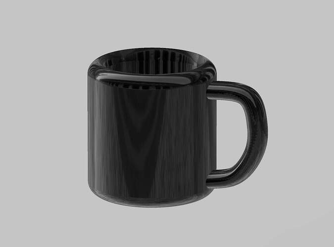

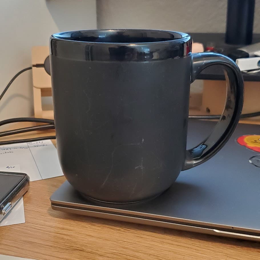

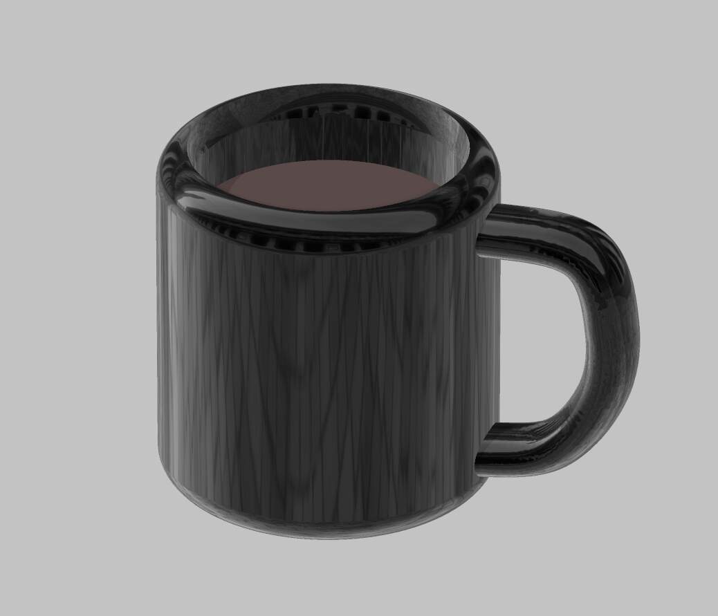

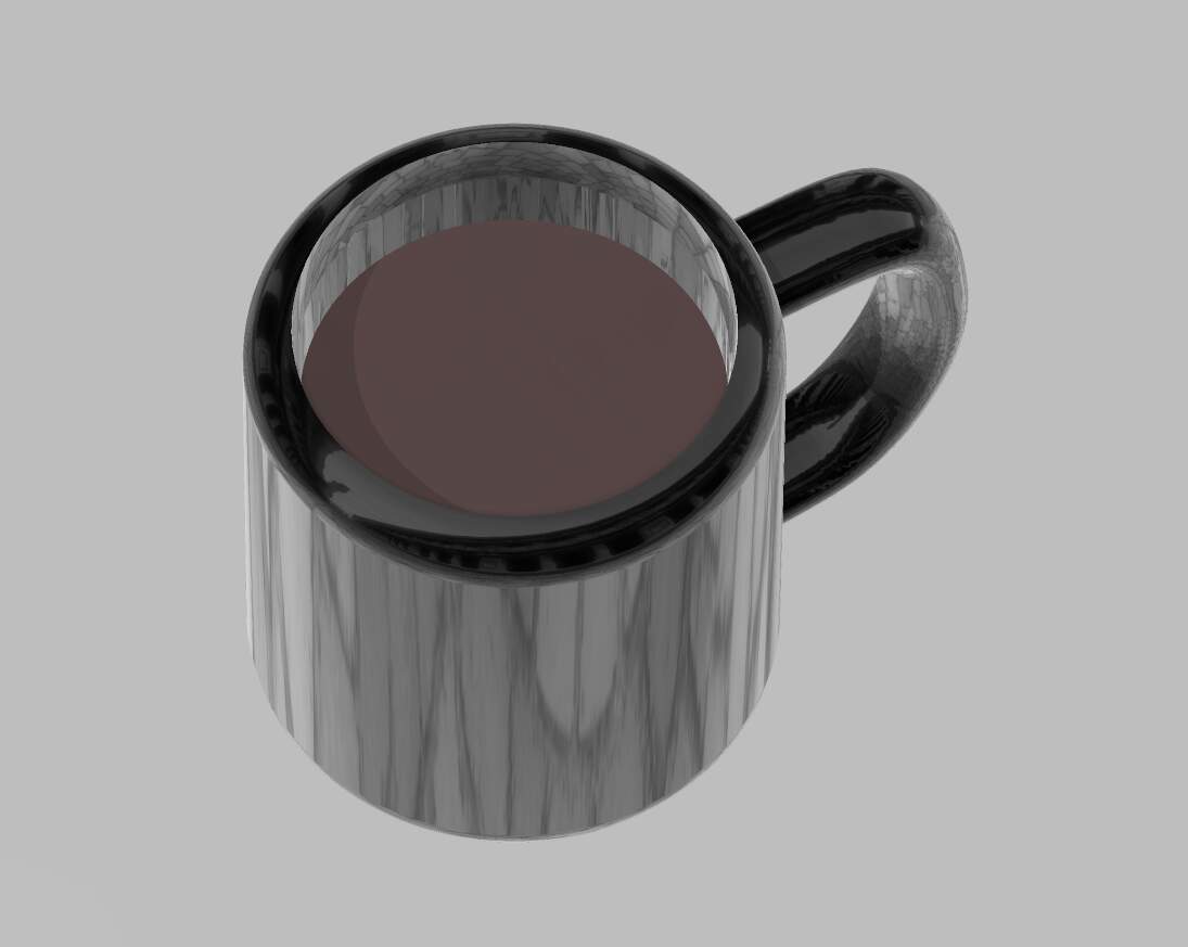

Coffee mug in 1/16 and 1/35 scales.
Reference photo used - my actual coffee mug:
4 versions made - empty x2 and with beverage x2 (2 in each scale)
Empty:
With beverage:

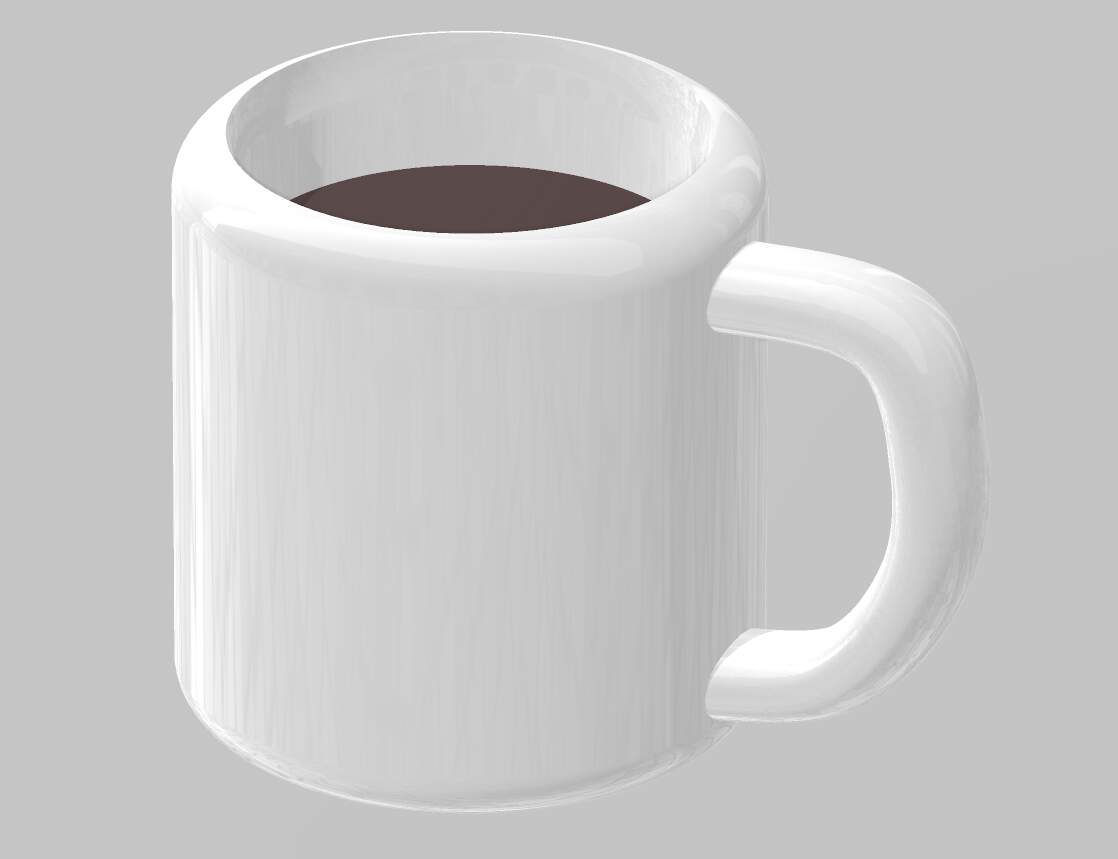

If I render in glossy white, looks like this:
Uploading the STLs to my cults3d page.

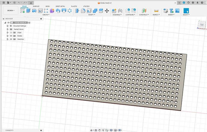

You might want to offset the holes so that they are at an angle rather than rows and columns.
It looks like the holes are angled at 30º (or 60º depending on which way you look at it).
If you don’t like drawing out all those holes you can cheat like I do and download either a 2D drawing or 3D model from McMaster-Carr. Almost all their products have CAD drawings!
I needed large scale realistic fasteners and instead of trying to draw a thread I simply downloaded 3D bolts and import them into my CAD program as solid models. My Punch ViaCAD seamed to prefer IGES but they have a variety of export options.
This is a great catch, Michael! Completely missed it. I’ll redo.

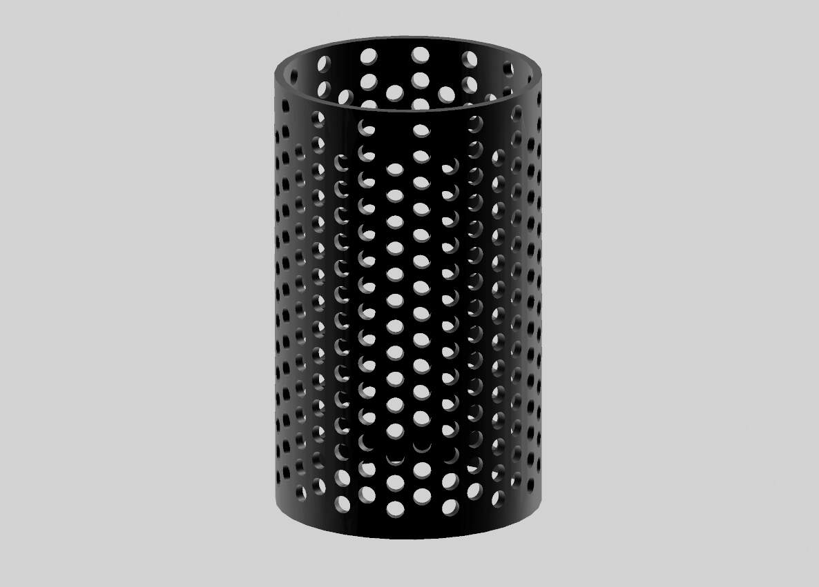

OK, redid it in Fusion 360:
Learned a powerful new tool. :smiley:

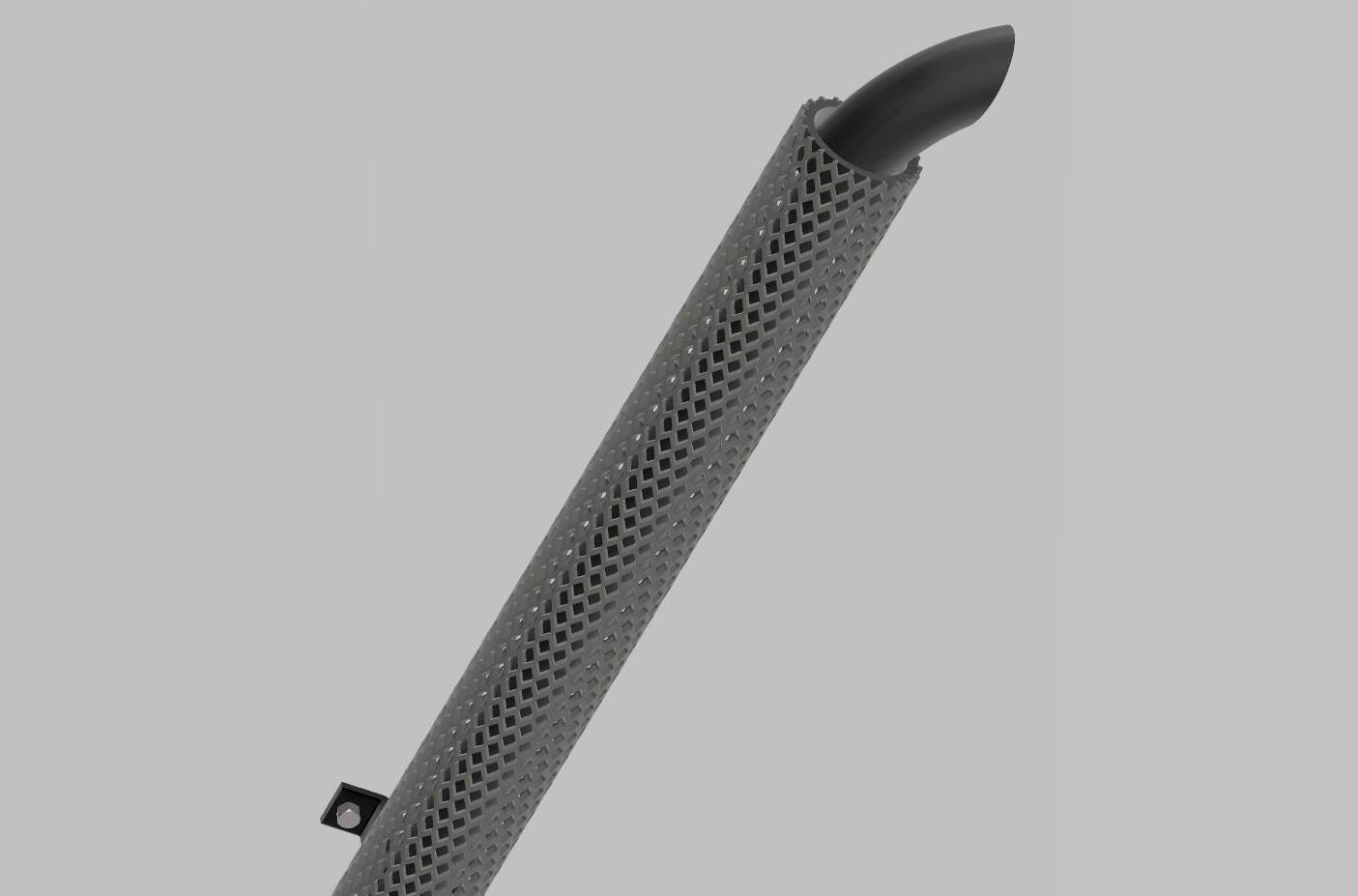

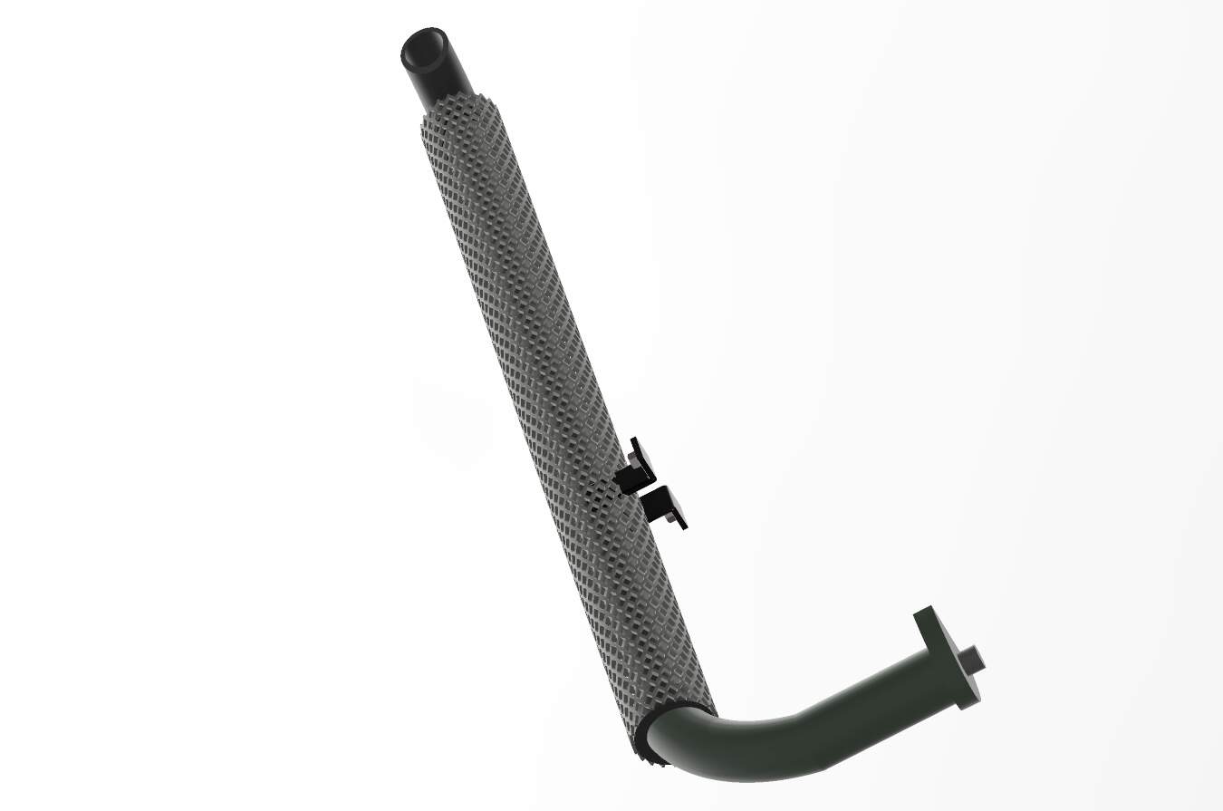

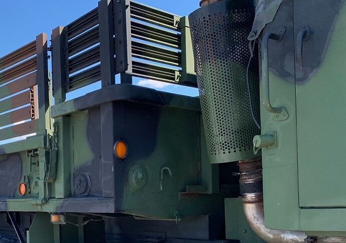

Using the same trick on a cylindrical surface!
This enables me to render something like an M900 series truck muffler guard.
I have been manually cutting these holes using individual cylinders and kept freezing the software. :smiley: Novice attempt no more.

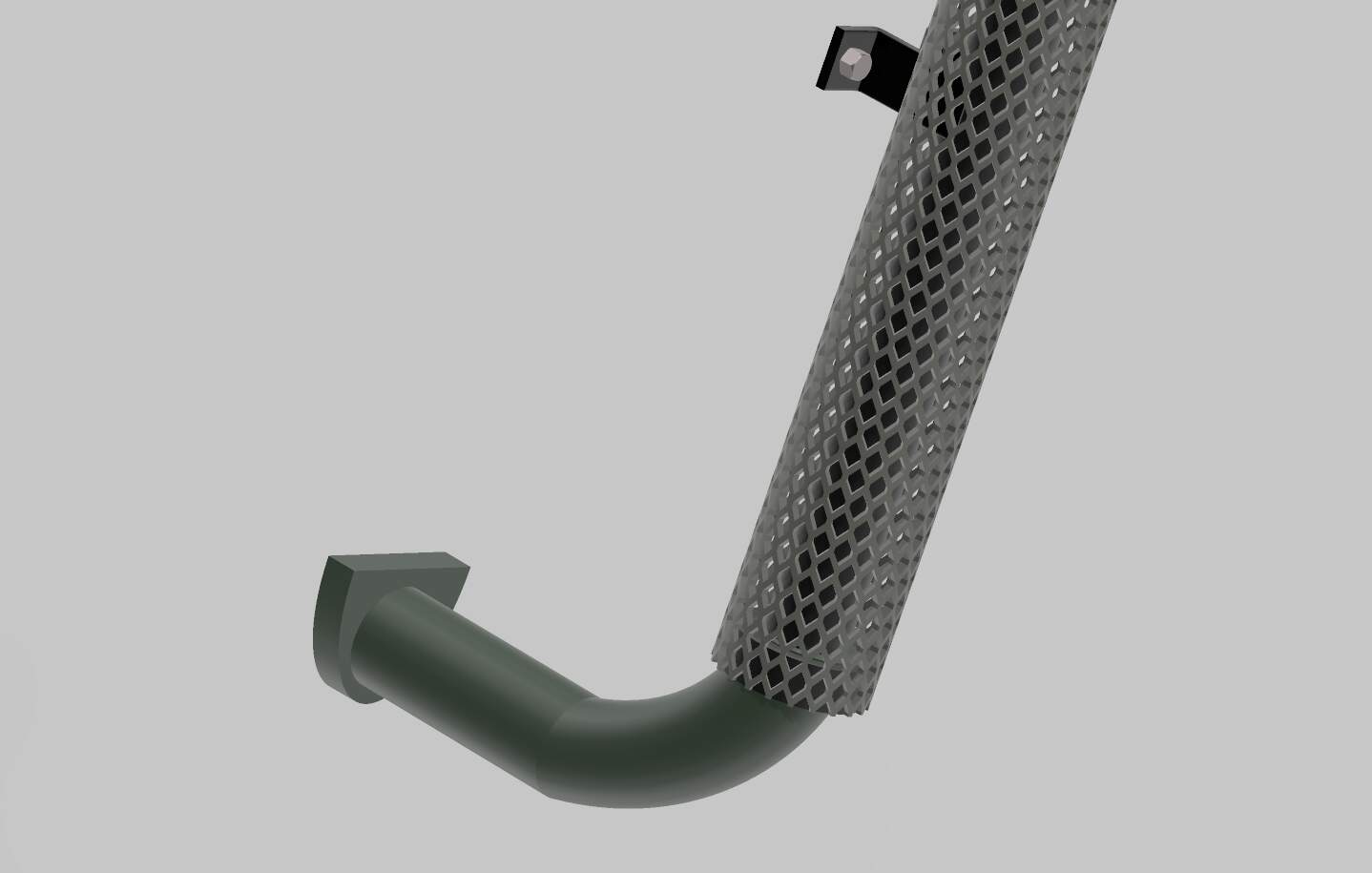

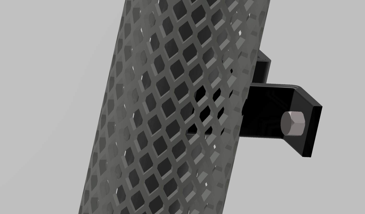

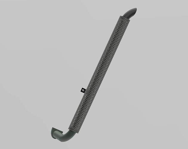

Putting my new CAD skill to use!

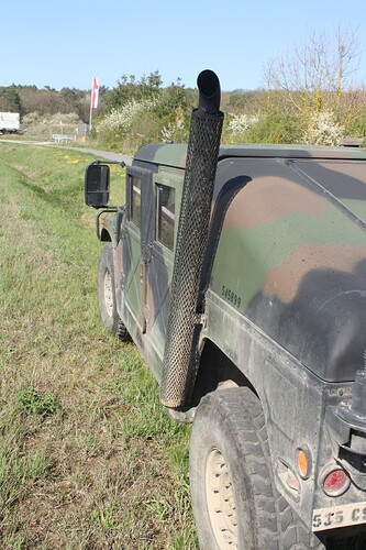

USMC Humvee muffler with mesh guard in 1/35. Used the Tamiya 35263 kit measurements.
I wanted to eliminate messing with the PE for this.
Reference photos used:
Uploading it to my Cults3D page soon.
:smiling_face_with_three_hearts: as soon as I saw you doing the exhaust guard, I was like I wonder about a Humvee exhaust.

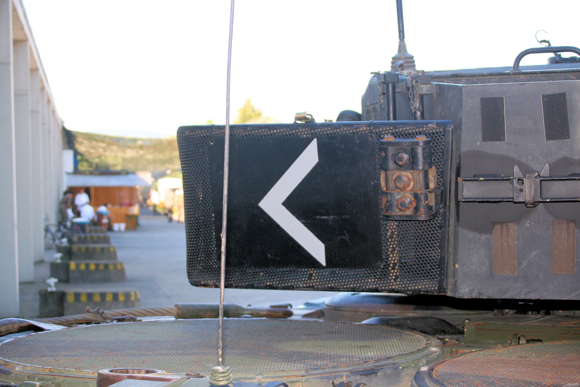

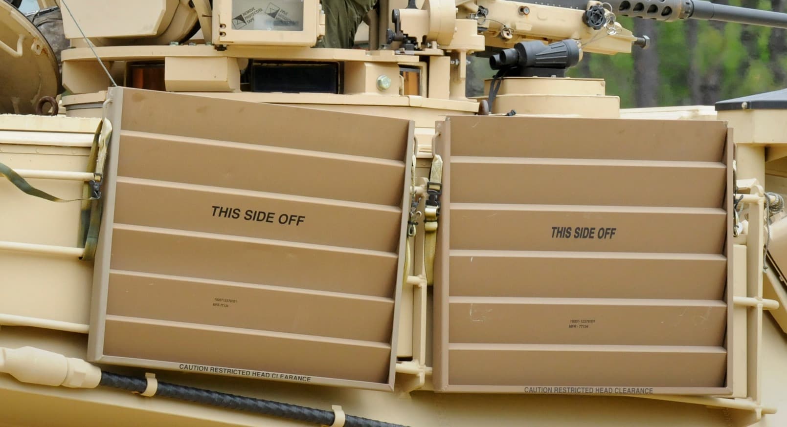

Tried my best to CAD the most detailed CIP (Combat Identification Panel) for M1A1/A2 Abrams kits in 1/35.
Not sure if these weld details will show up in 1/35 3D print but I added them:
At the bottom edges:
Back side:
Another angle:
Available on my cults3d page.
