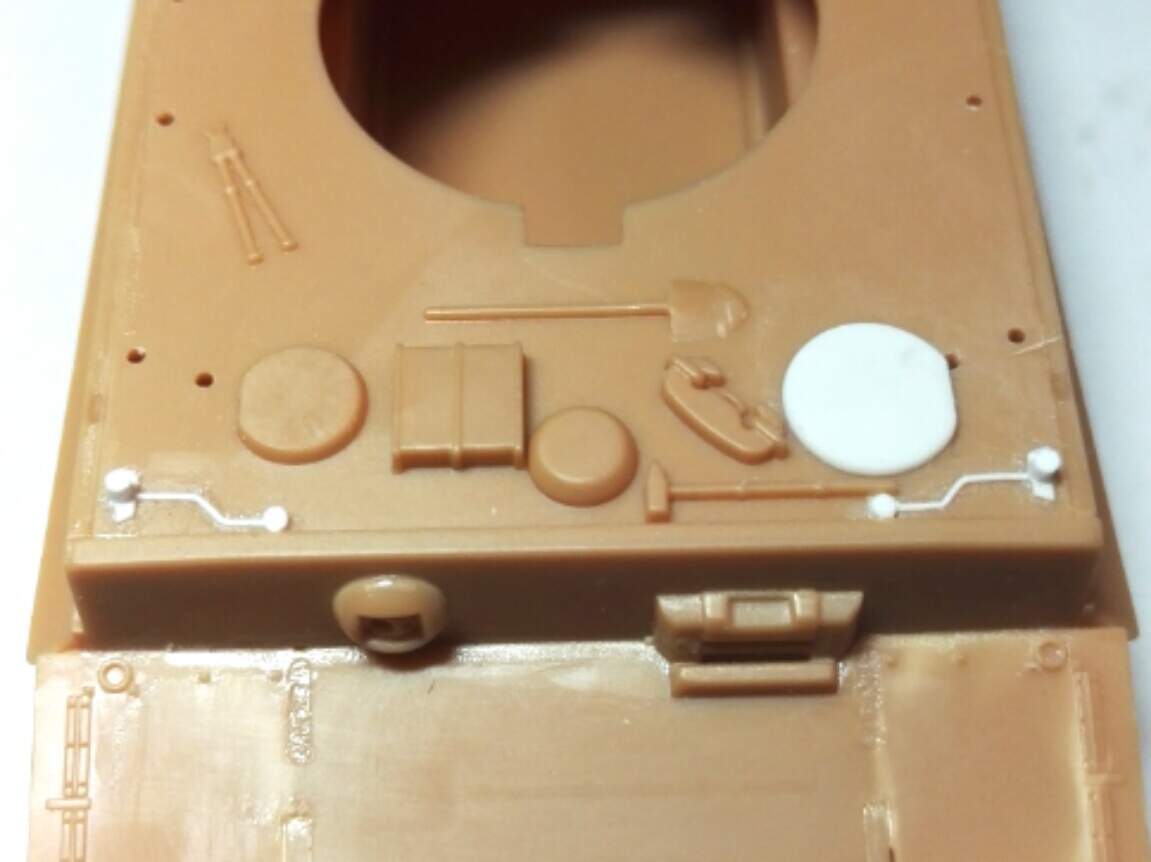

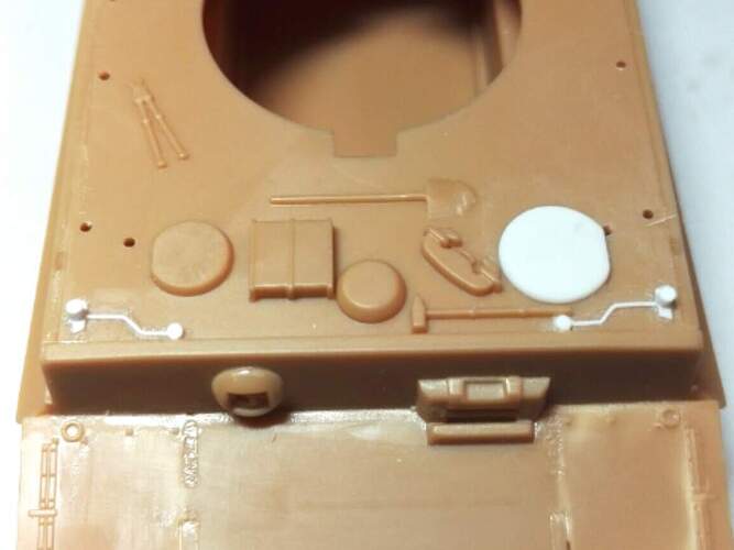

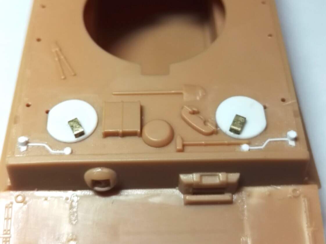

Before mounting those assemblies I thought I’d better get the tool box on its odd little rack that sticks out perpendicular to the sloping back plate. Rack:
Tool box attached, looking a little messy as the glue is still setting so it hasn’t been tidied up yet.

The pistol port plug:

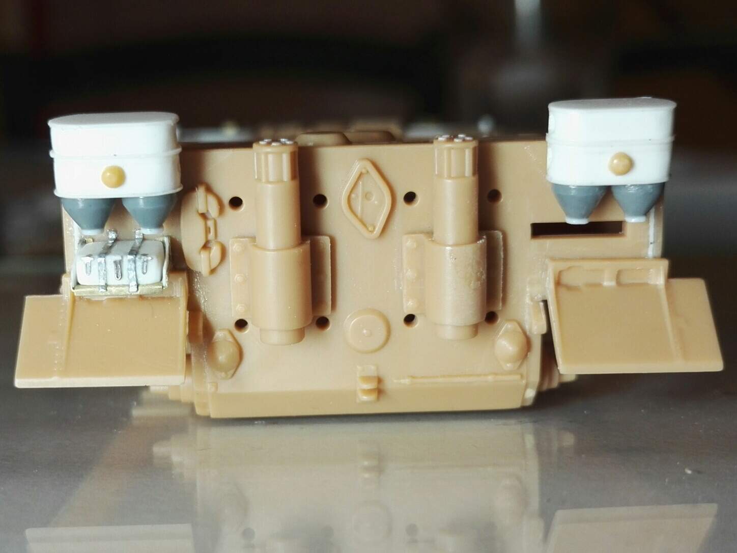

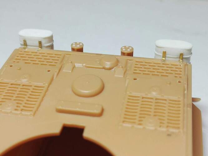

Here are the Feifel units, looking kind of OK, and I have to keep reminding myself that photos show these things to have been not particularly hardwaring pieces of equipment.
Went for the “authentic” method of mounting them on two small blocks, when a big strip would have been more practical:
I forgot to sand and shape down the plugs (the brown disks) on the back before mounting them, so they stick out way too far. I will attempt that later with great care so as to not knock them off.
So they are on the blocks with polystyrene cement and the brass brackets with ca glue. Going to leave it alone over night to fully set before touching anything else.

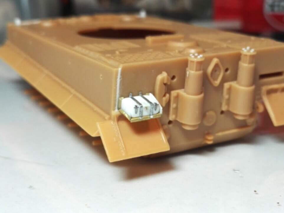

The photo of the rear shows another error in the kit design, where the rear mud flaps extend too far on the inner edge and overlap with the hull side plates. It means that they would foul the towing shackles if a cable was attached. I’ve narrowed them a little, but a bit late now to fully fix.
