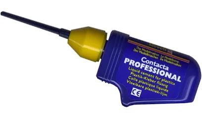

Revell’s contact cement much to my surprise is actually good.
