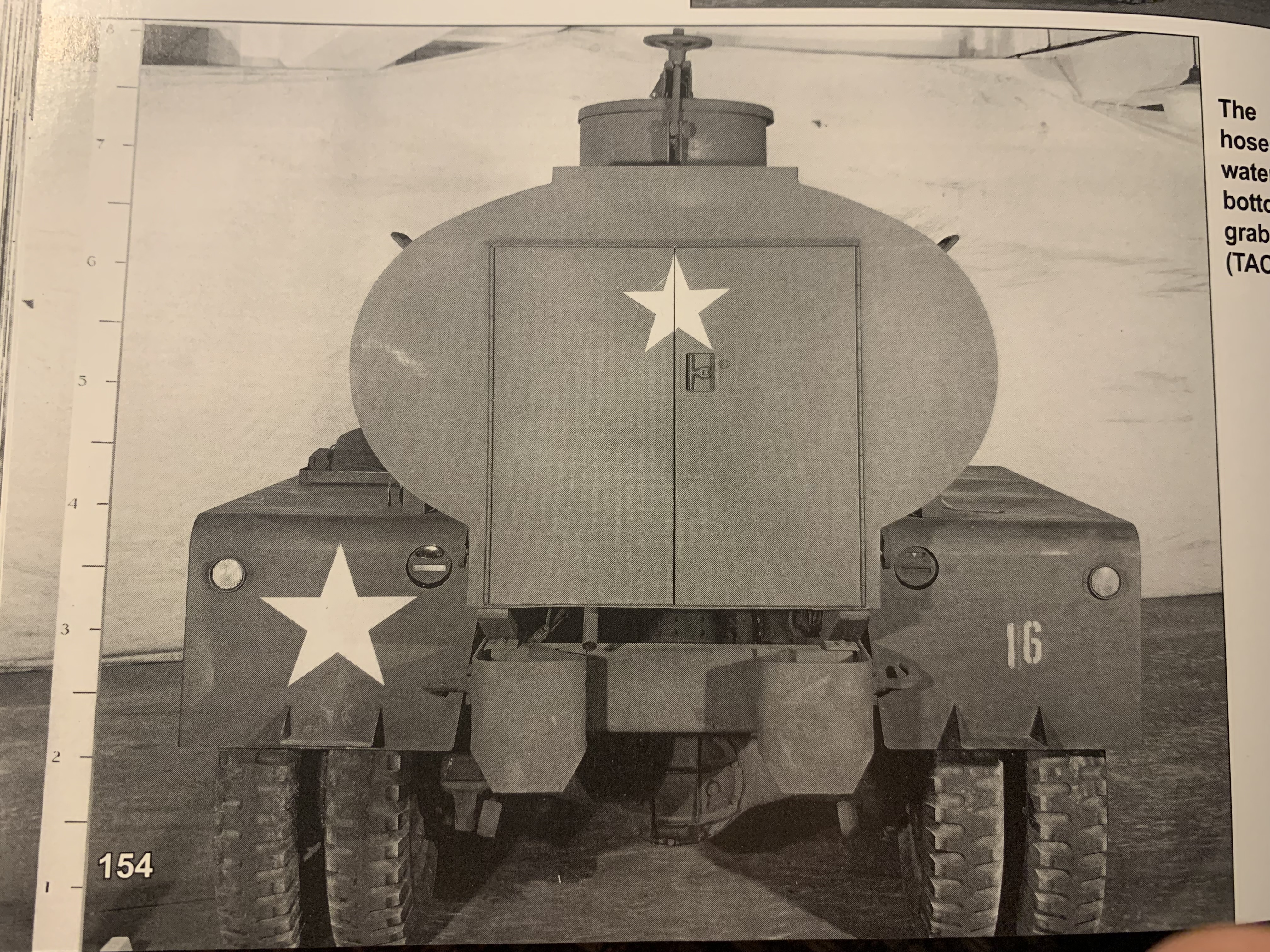

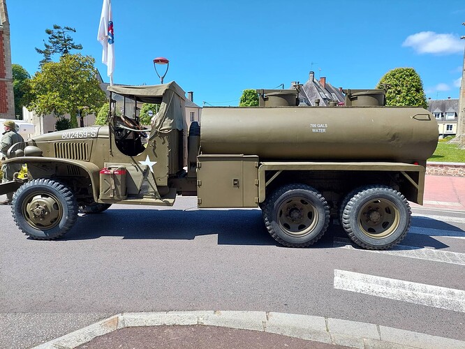

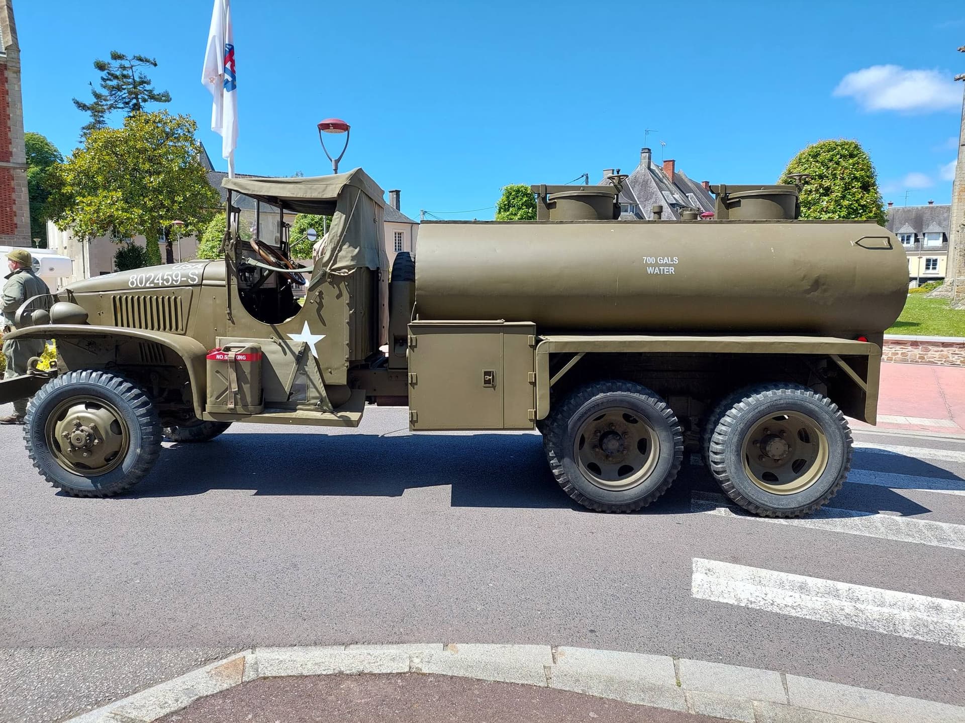

Would this help ?
Noice picture. :+1:
That seems to suggest it doesn’t touch the bottom of the tank, so it would not be flat from the fender to the tank and would have a step.

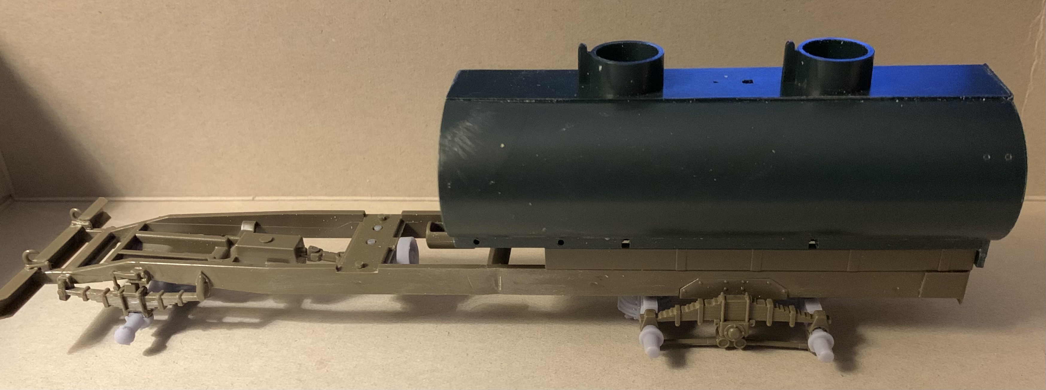

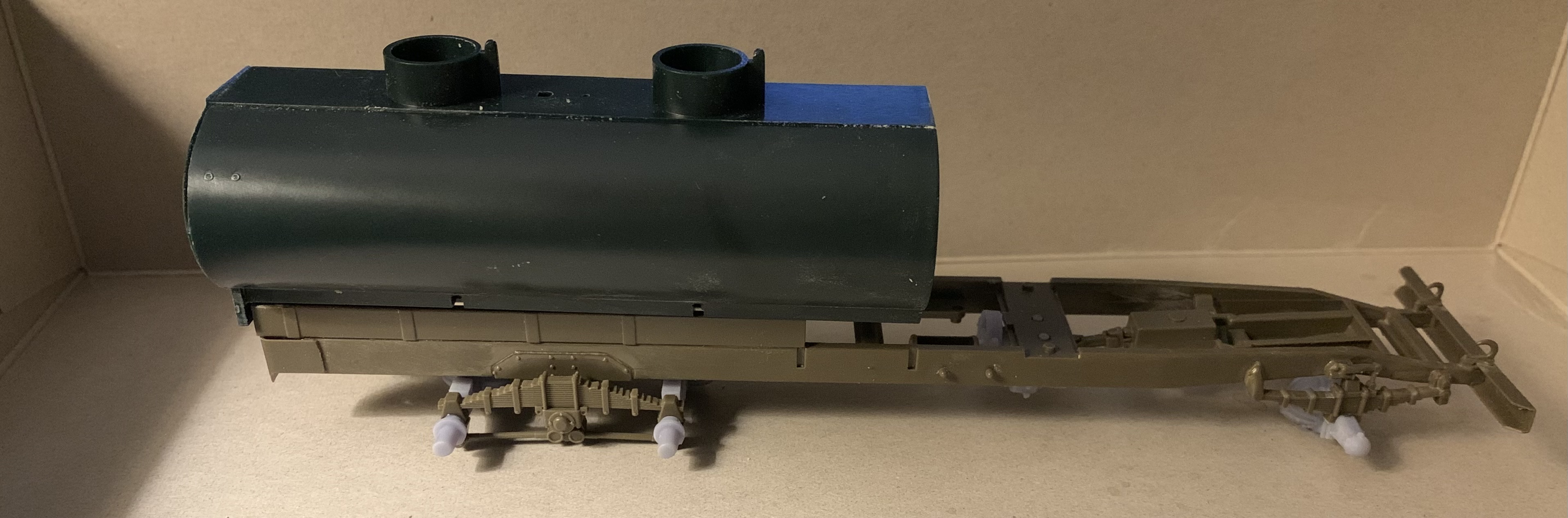

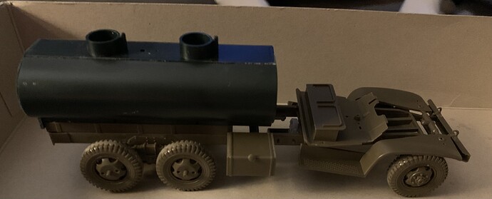

Test fitting and on wheels or at least some of them.

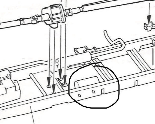

What is the cylinder opposite the muffler? It has an open top and before I take the time to fill I am wonder if it should be removed.
Also need to add a backing to the battery before attaching.
Could it be this part ? :thinking:

Thanks HP. Seems whatever it’s function is, there should be something relatively that shape in the location. So the opening will need to be covered.
Looks like the muffler has run off. I will attempt to make a new one based on another kit’s part.
That’s the hydrovac unit. Tamiya couldn’t mould it solid as big lumps like that pose real sink-hole challenges. And on the standard truck it’s hidden by the cargo bed. If you have the Italeri kit you could steal their version…

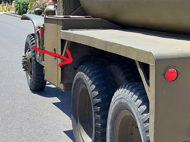

Was able to find my Doyle CCKW book. I have some back tracking to do. I think the pipe on the right under the bumper is the exhaust, what about the left above the bumper
For discussion purposes only
Not so fast - the CCKW engine had its exhaust manifold on the left, so the exhaust pipe follows the left frame rail, usually coming out just ahead of the lead rear wheel - on the tanker this is under the fender.
water-tank-exhaust
This is a restored truck from a French FB site because all the period shots are too grainy and it’s dark under there!
I’m not sure what you’re seeing in that end shot, but I suspect it might be the rear axle hangers…
I second that - maybe the name of those things is “torque rods”? The tube on the left might be an emergency tank discharge pipe, but i’m anything but sure.
What I’m sure of, however, is that instead of a towing pintle, tanker trucks (that is, those that we have kits of) had towing hooks on the sides of the rear bumperettes. If you look closely, you can see that the one on the right has its point bent up, to prevent ropes etc. from slipping off. Which is why there are two different forms of these hooks - one bending to the right, the other to the left. Here, however, there’s another “left bender” mounted on the left side, pointing down - government. work. The bottom line being that all these hooks were made after the same pattern, and I mean ALL of them, including those on the front bumper. I’m unable to show decent photo evidence for that, but apart from the venerable Heller CCKW kit’s bent hooks, the fact that on other kits the hook bases are mounted at an angle instead of in line with the chassis rails speaks for itself (and Frenchy will surely come up with dozens of pictures in no time at all).
So: won’t somebody give us bent tow hooks for all our non-Heller trucks, please?
Thanks that makes sense. Doyle doesn’t give the same angle to see. He only has a one head left side view and the angle of fender lip hides the exhaust. The photos are bright enough to show the interior of the fender also have angle braces like the outside edge.

I’m not sure about the bent hooks - I think it’s just the angle at which they are mounted. (Just as the ones on the front bumper are angled outwards, but are the same exact part.) And beware blanket statements about the tow pinltes, as there are period pics with them! I know the fuel truck (as per the Hobbyboss kit) did not have them as-built, but the water tankers could. IIRC it was about safety, and not having metal-on-metal parts causing sparks, so not an issue with water.
(You really need to zoom in, as the rear end is in shadow…)
I’ve done the zooming. The hook is clear, but the pintle is a blur in the shadows… (Still helps to save to your computer and open it locally so you can zoom right in!)
water-tank-pintle
