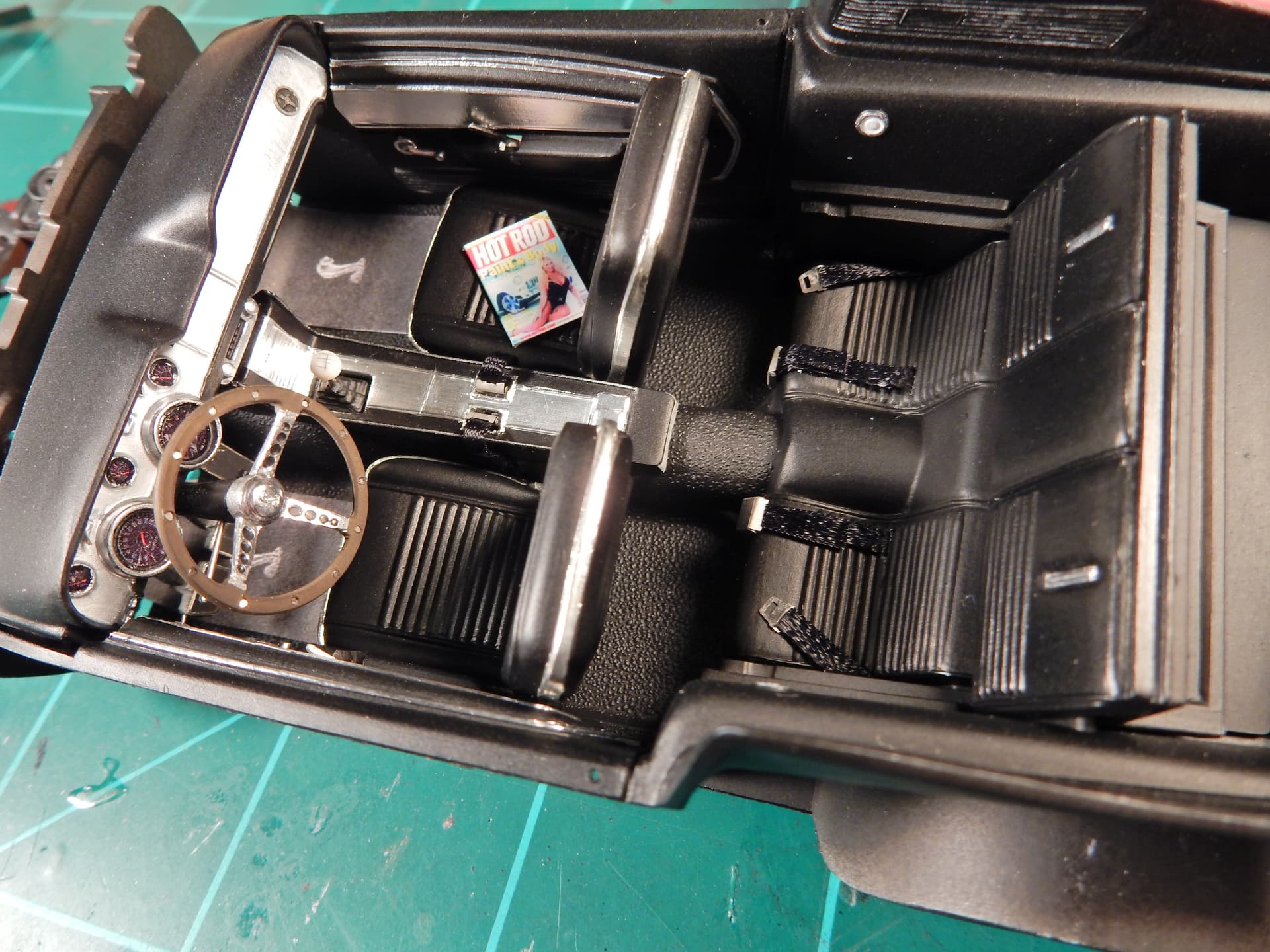

Fast forwarding the completed interior.

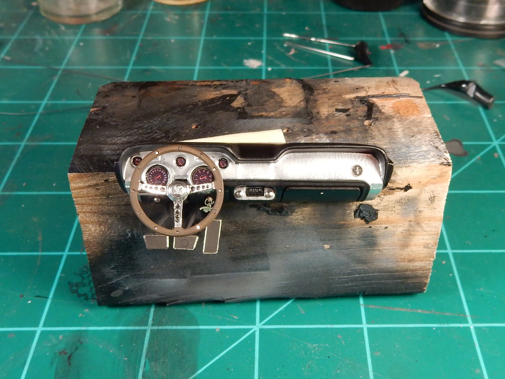

Dash panel
and the rest:

The dash with the wood wheel and then the overall shot of the interior looks just like the real deal. And I love the issue of Hot Rod magazine. Now there’s a great touch for sure.
joel
Beautiful interior there Joseph, great work!
As Joel said, the magazine adds a nice touch of realism as well.
Cheers, D
Thanks you guys. I did have alot of fun with that interior.
