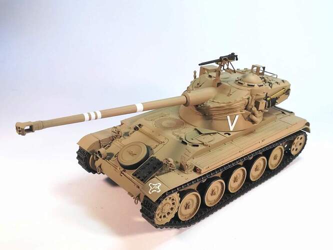

So the 13 IDF got its markings. The unit badge and the V are decals while the barrel stripes are painted. The decals were too stiff to wind around the tube and a bit too short.

I still have a Heller AMX13 for IDF version, I won’t be doing all that extra detailing you did, even though it looks really good! And I love the paint job on both the versions.
Too bad you decided after al to not build the Dutch version, but these look great as well!
The Heller is not that bad. You need to change the tracks though and modify the headlights for a IDF version.
I agree for the Dutch tank but to be honest the kit needed more extra work than for the Argentinian version.
Olivier
