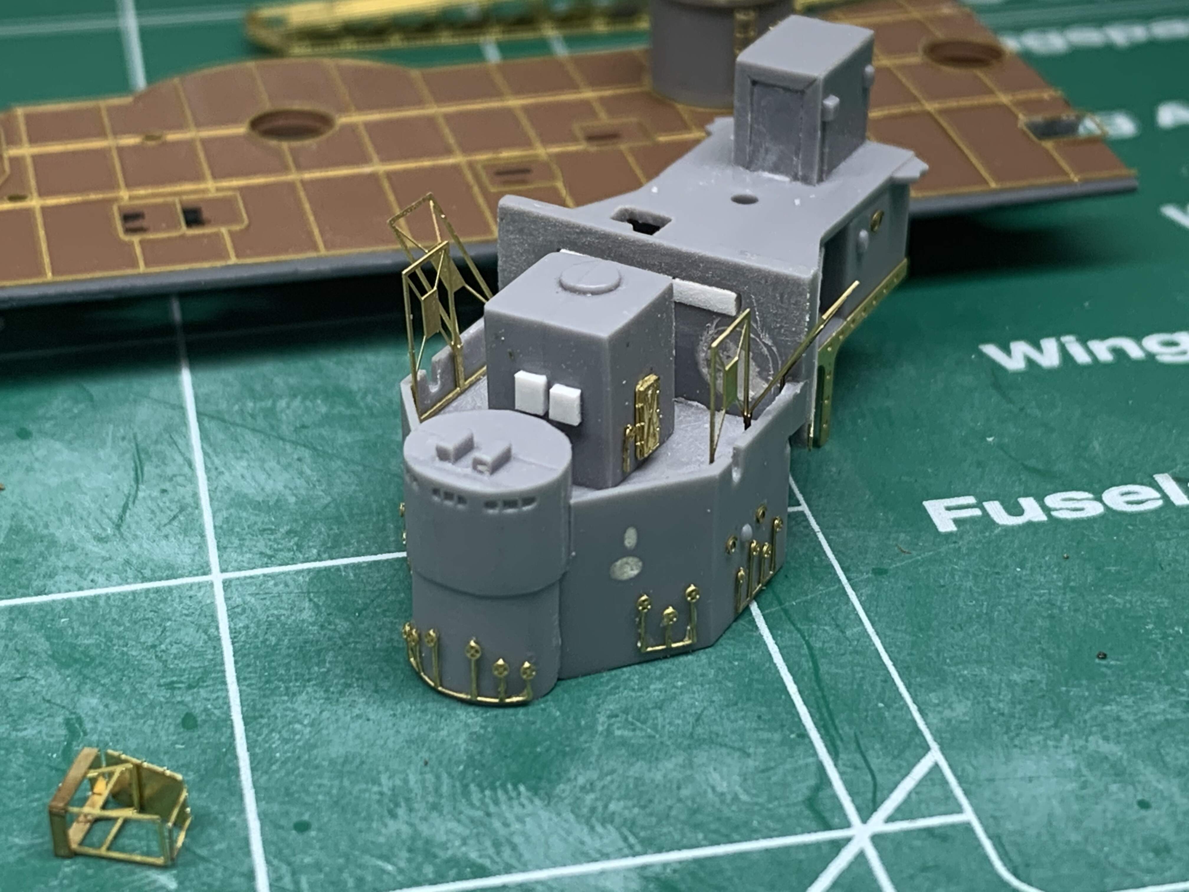

So over the past couple of days I have been able to grab some time on the bench. Small updates but with large implications when it is all said and done.
Here I added the bridge support beams

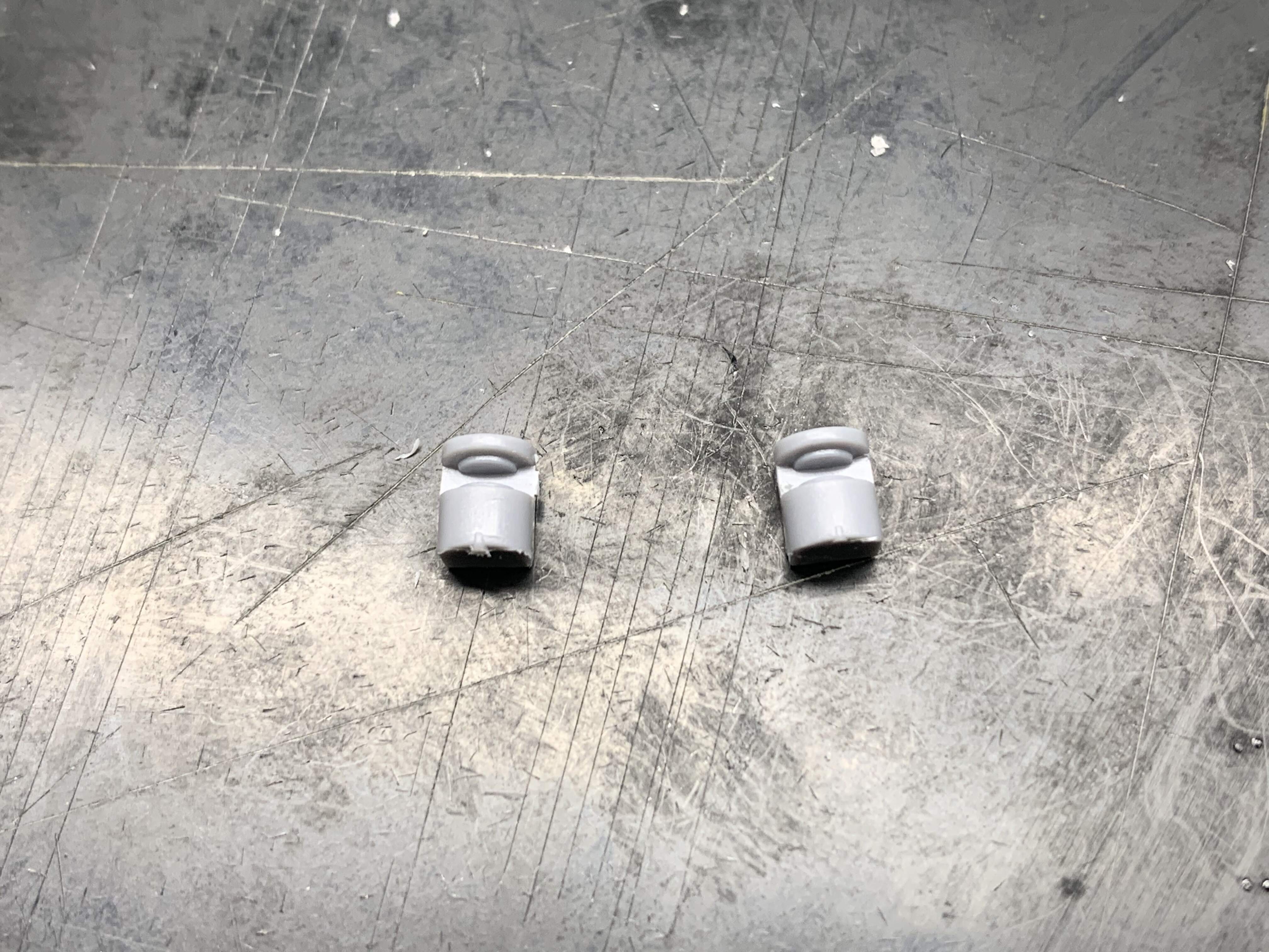

After that I started by upgrading and adding the two observations posts to the bridge.
Here is the kit part
Now with the PE window frames added
And now added to the bridge level. I need to sand down the overlapping PE but wanted to let the Tamiya Extra thin dry before I attempted that.

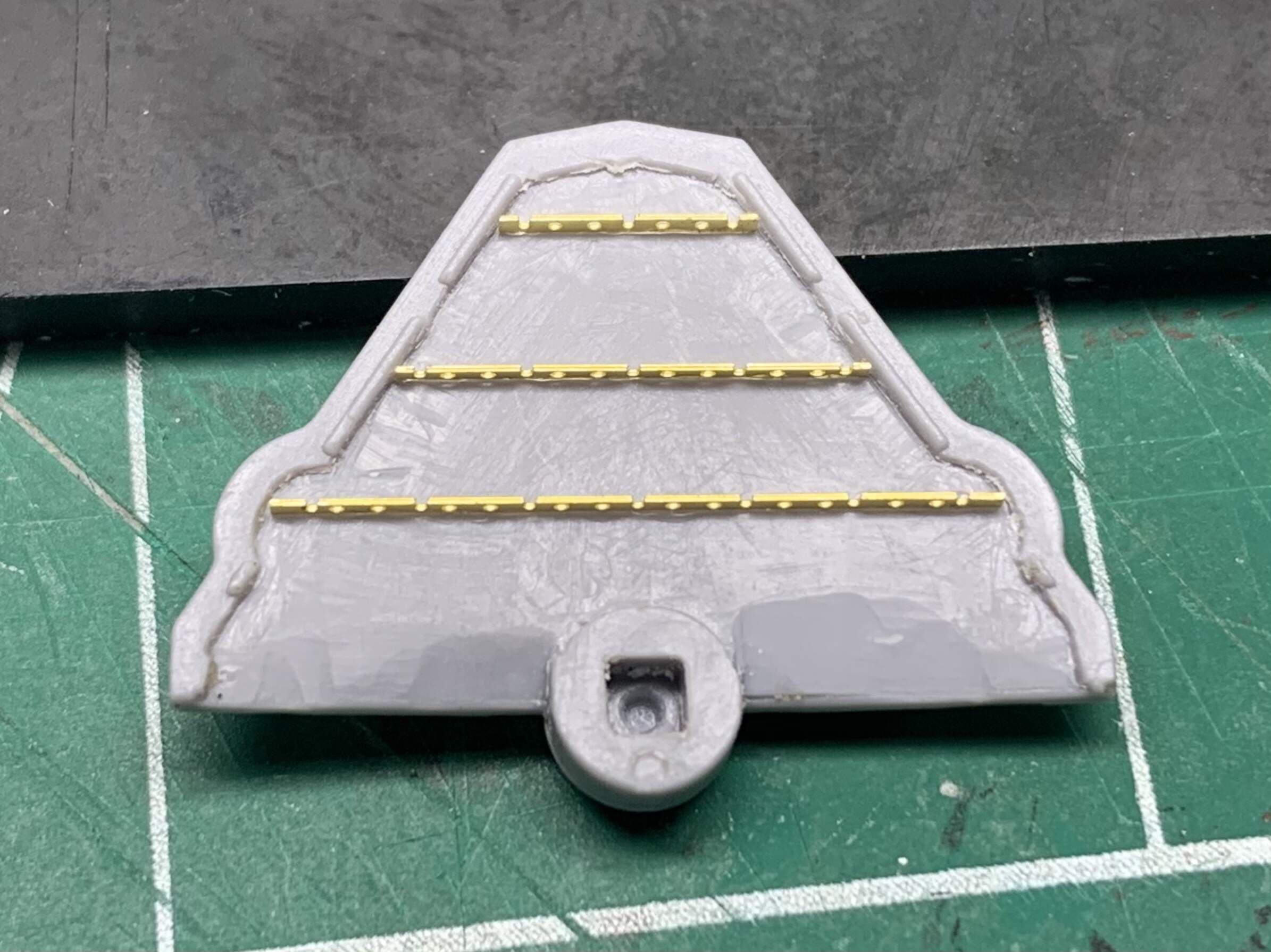

The next was working the girders on the roof of the bridge
Here is the kit part after the molded detail was removed
And here it is with the first three PE girders added. Will let the glue dry before adding the cross girders.

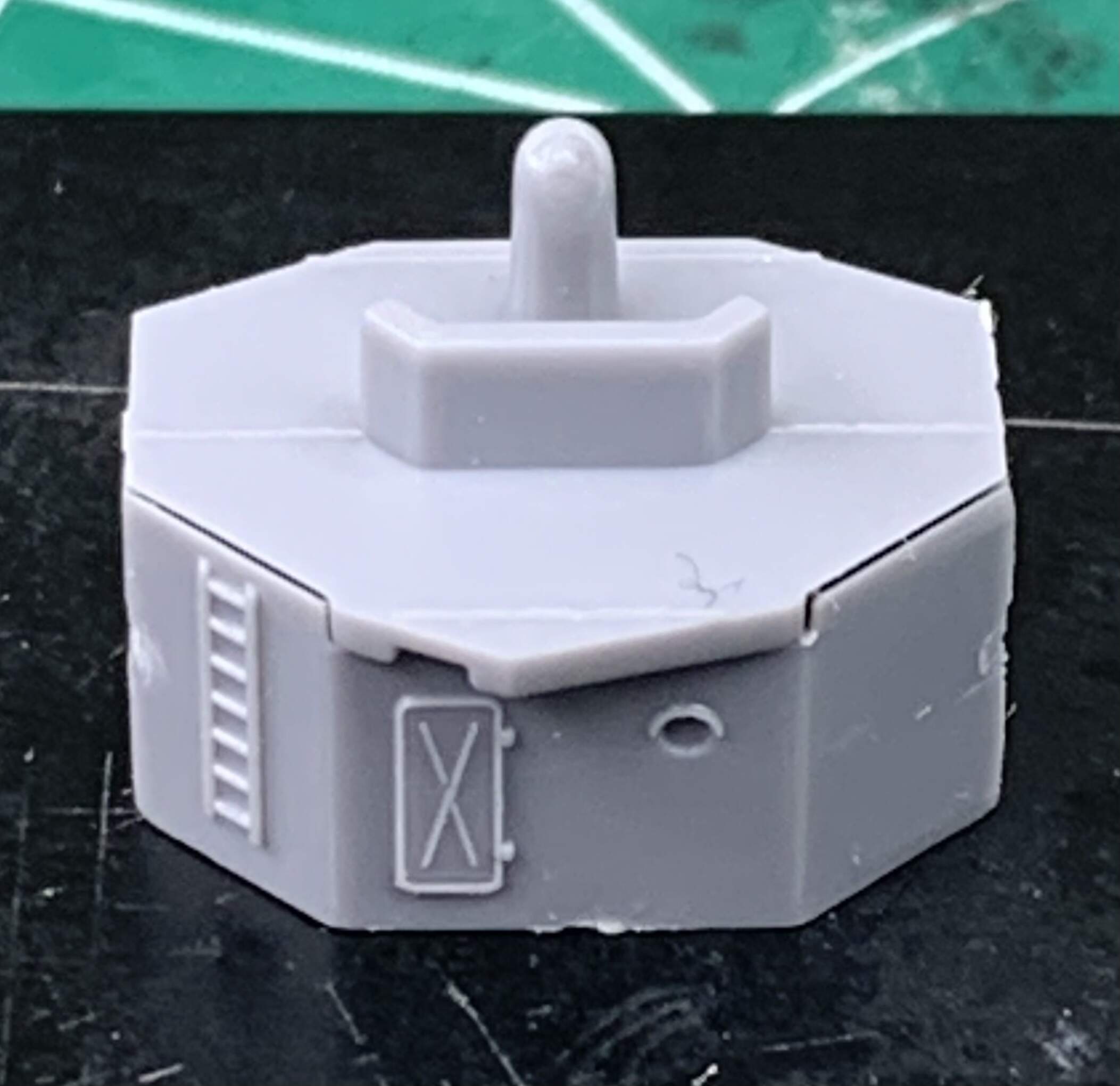

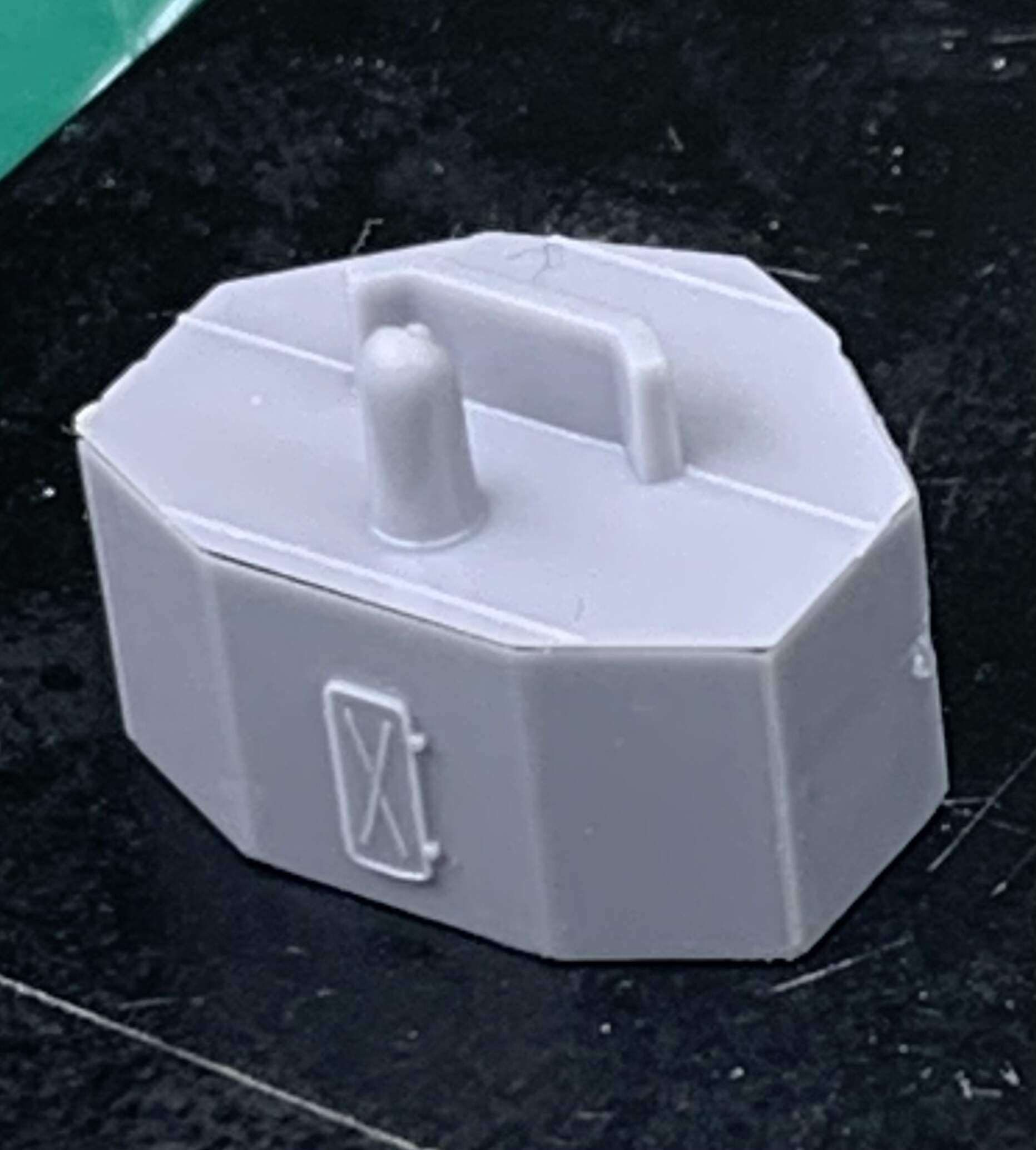

The next part is the aft bridge - here are the kit parts dry fitted together -
This will be my next task to tackle once i find sufficient time - just wait for the upgrade on this part!!!

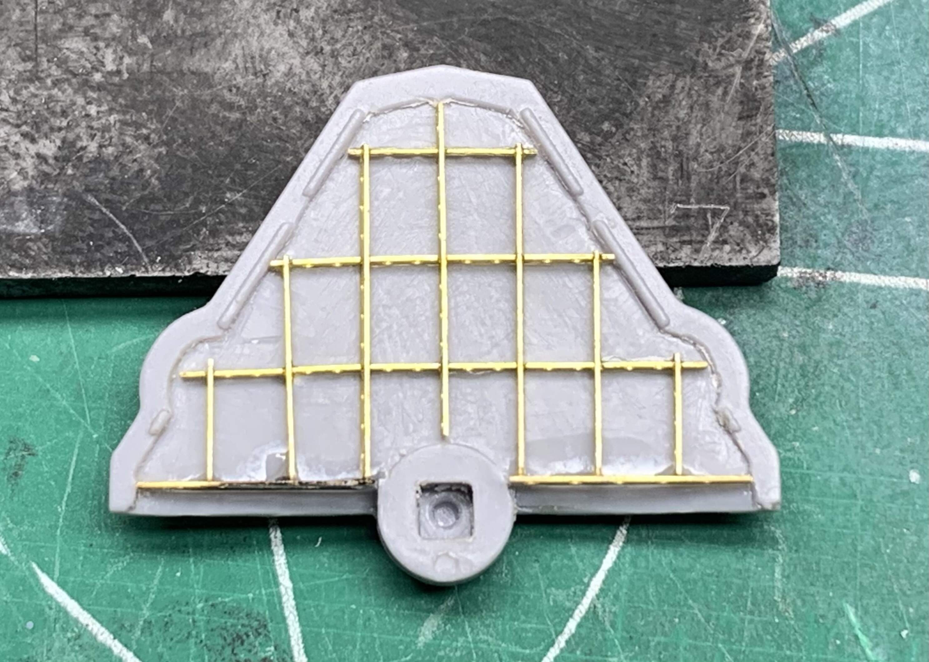

In either case, I was able to get a day off yesterday and spent some quality time in the dockyard. The workers finished off adding to overhead girders to the bridge.

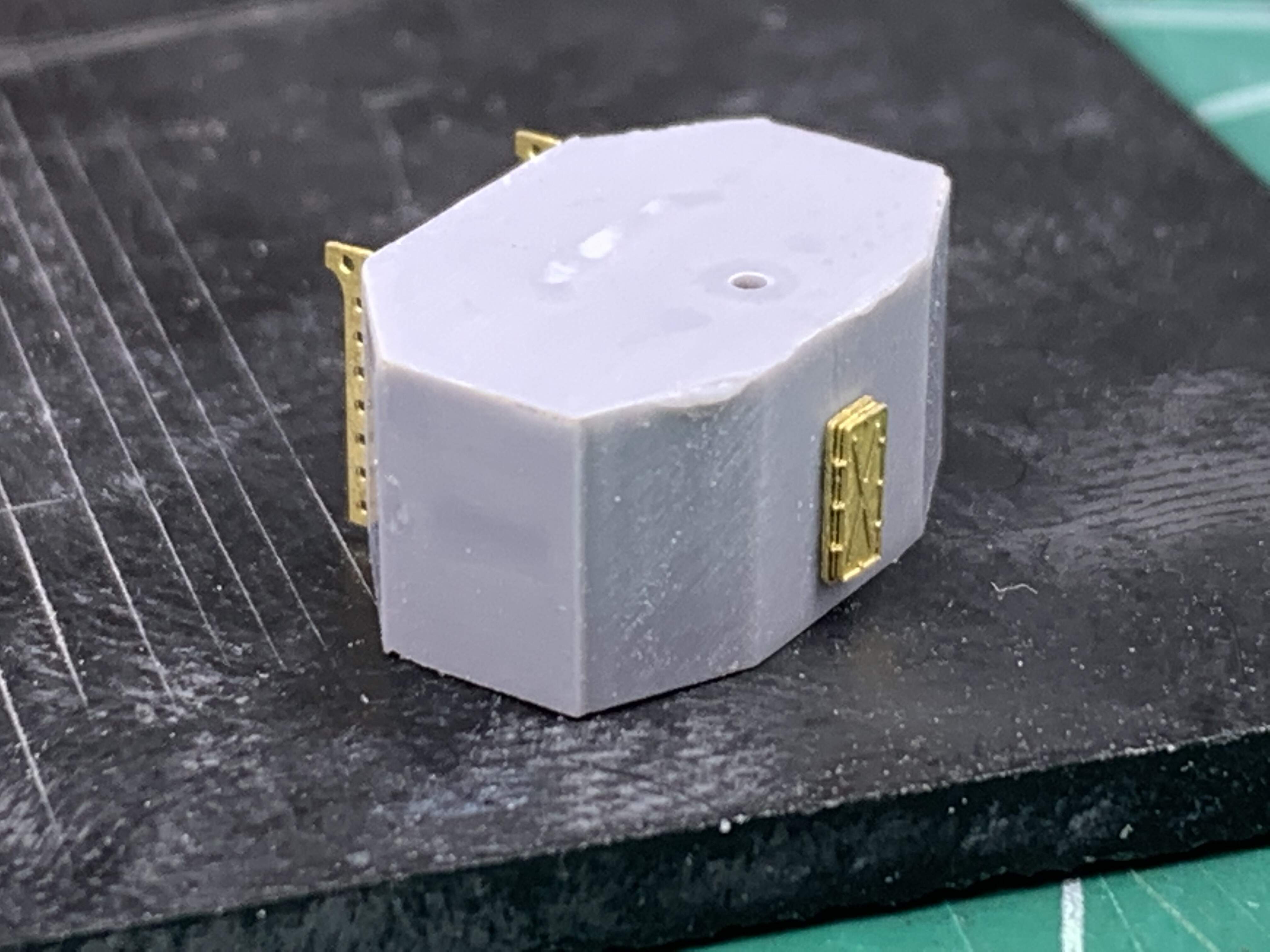

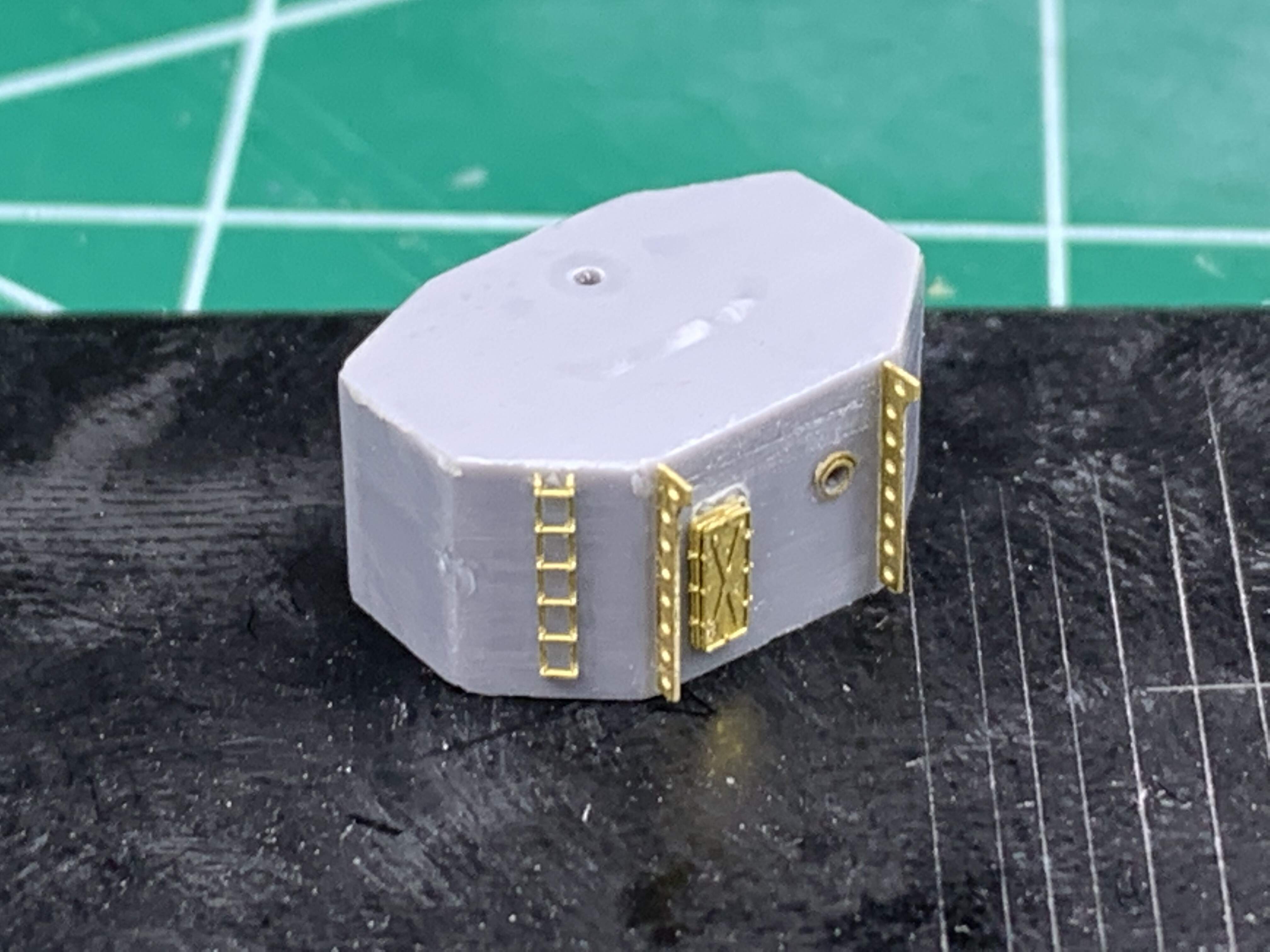

Keeping with the bridge work they moved aft and began working on the aft bridge. After much destruction of the existing detail they added the water tight doors, ladder and support beams for the overhanging deck.

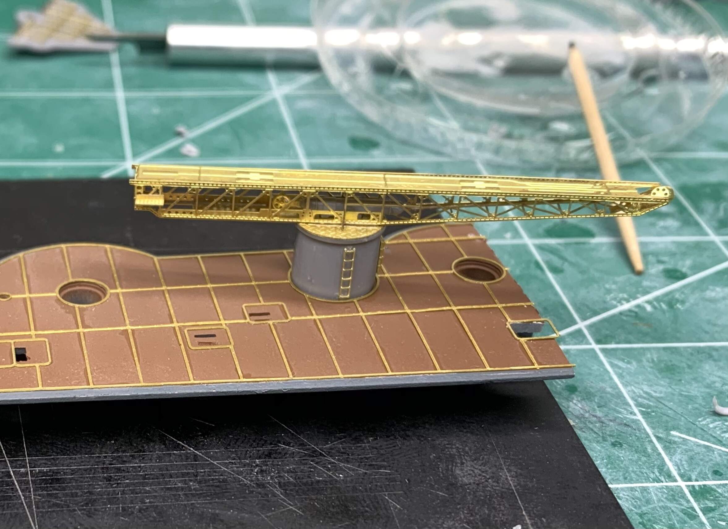

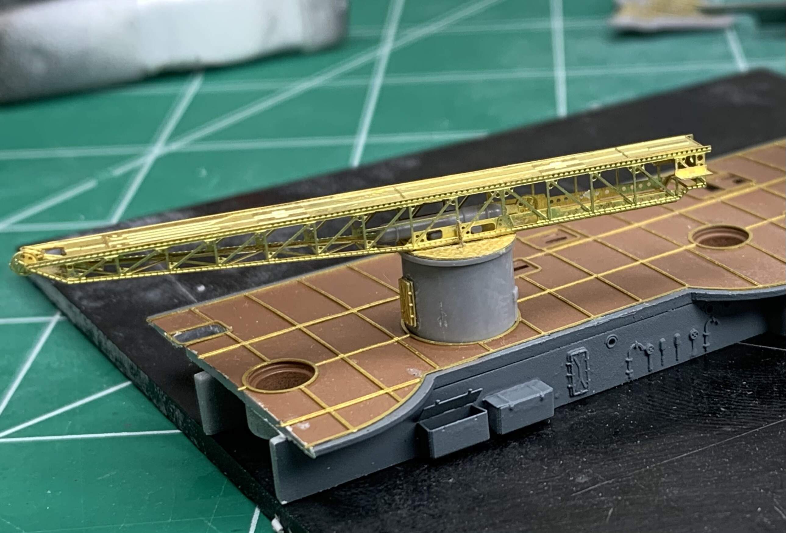

After that they decided to finish off the minor details on the aircraft catapult and mounted it to the turn table. The minor details included a couple triangle gussets and the standing platforms near the rear of the catapult.
Here is the aircraft deck with the rear bridge and catapult dry-fitted

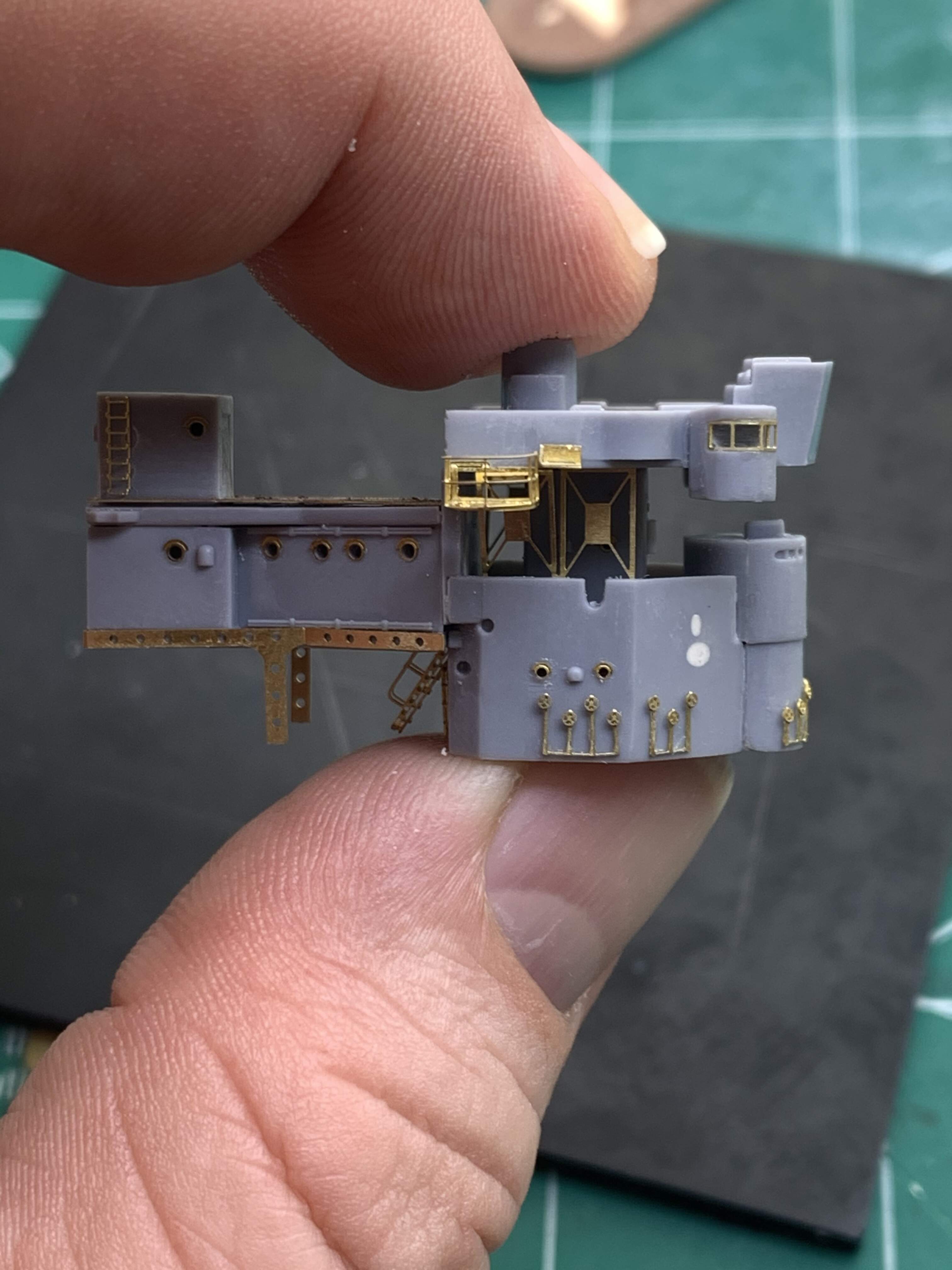

Hey everyone,
So yesterday I got a couple hours in the dockyard, but due to minor complications very little was completed, but in the end it is still another step towards completion.

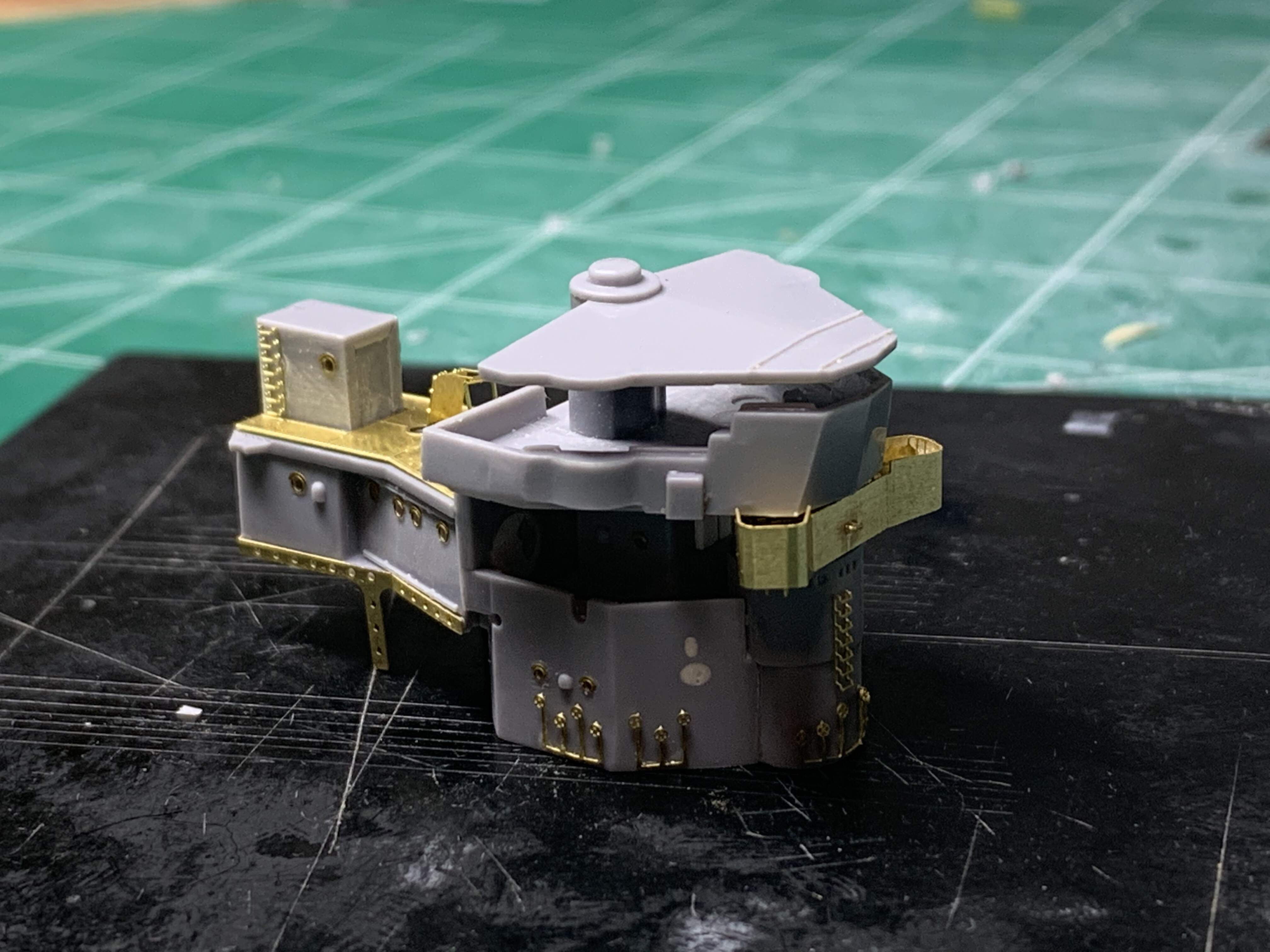

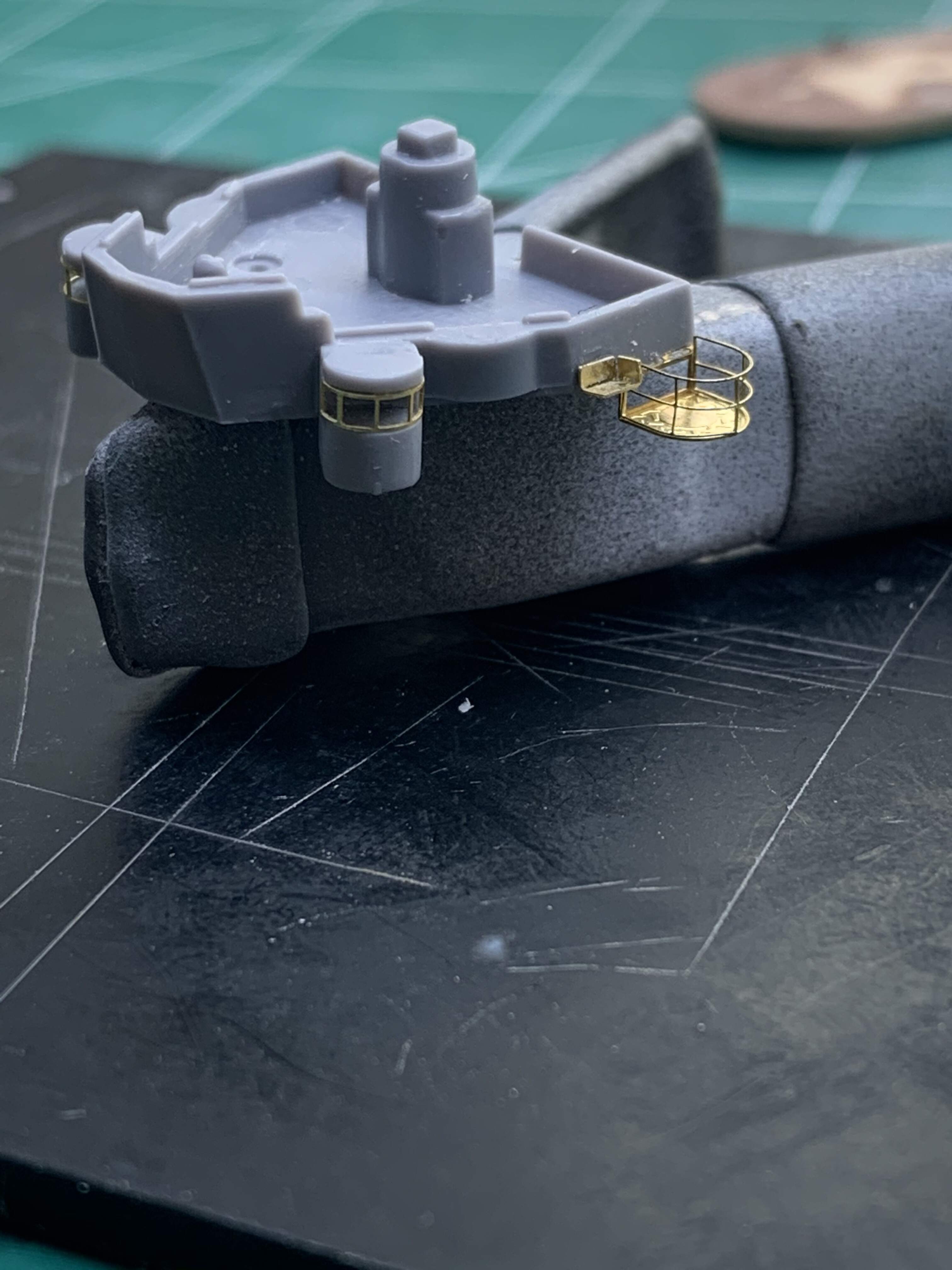

Anyway, continuing with the bridge I worked on the signal platforms. The original part had them molded on. I had originally removed them early but it wasn’t until i finally folded the PE replacements that I realized that that it required a little more attention to get them to sit flush. To make a long story short I glued, removed, glued and removed a gain a few times before they were correct.

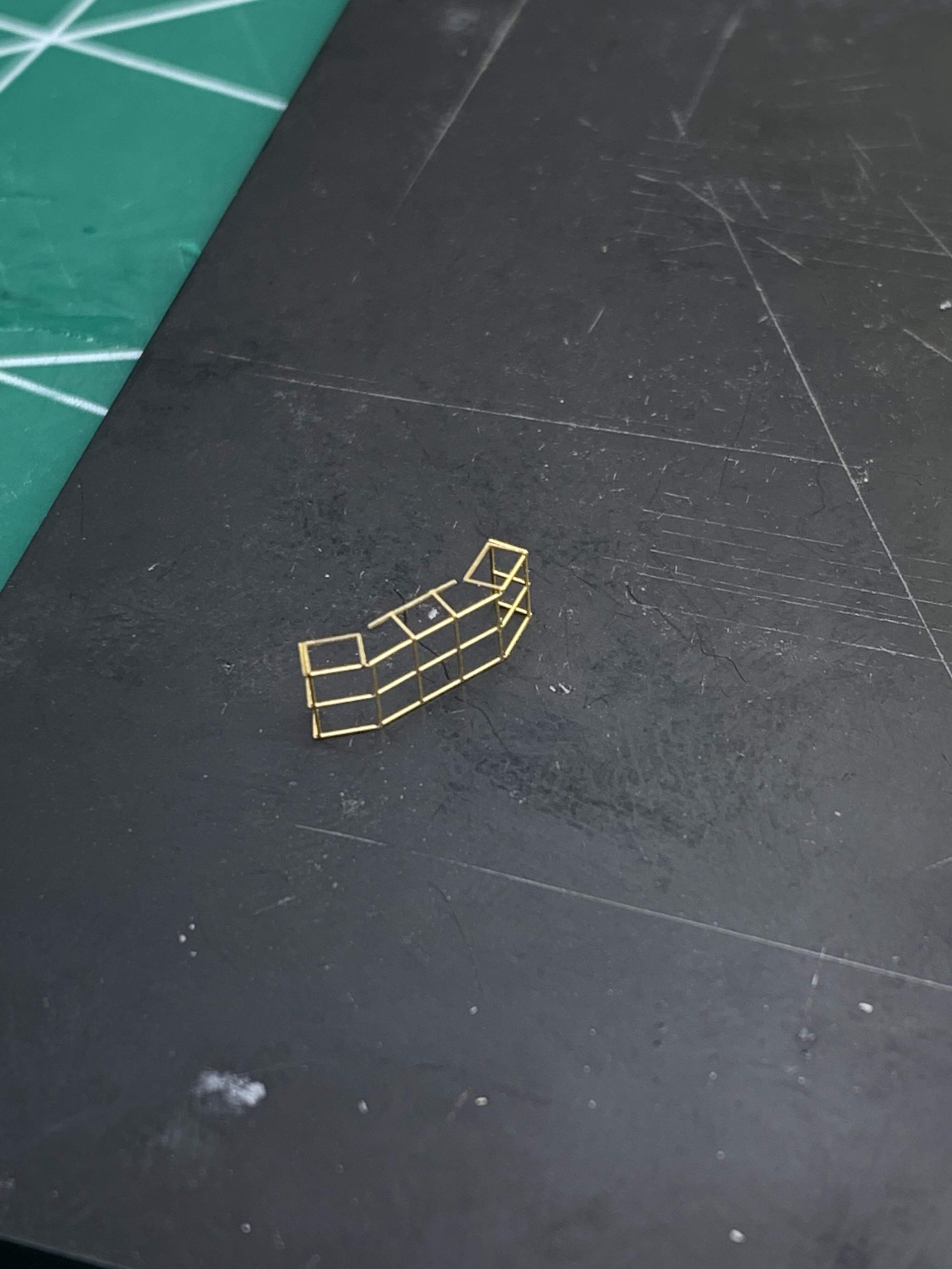

I also worked a small PE piece for the aft bridge, not 100% sure what the purpose of this cage like item was but due to the aft bridge deck having a channel for this to fit into there was little room for error.
I’ll provide a picture of the aft bridge decking to highlight what I am referring to a bit later.
Here are some pics with the compass bridge dry fitted.
That is about it, as I mentioned not a whole lot accomplished but it is one step closer.

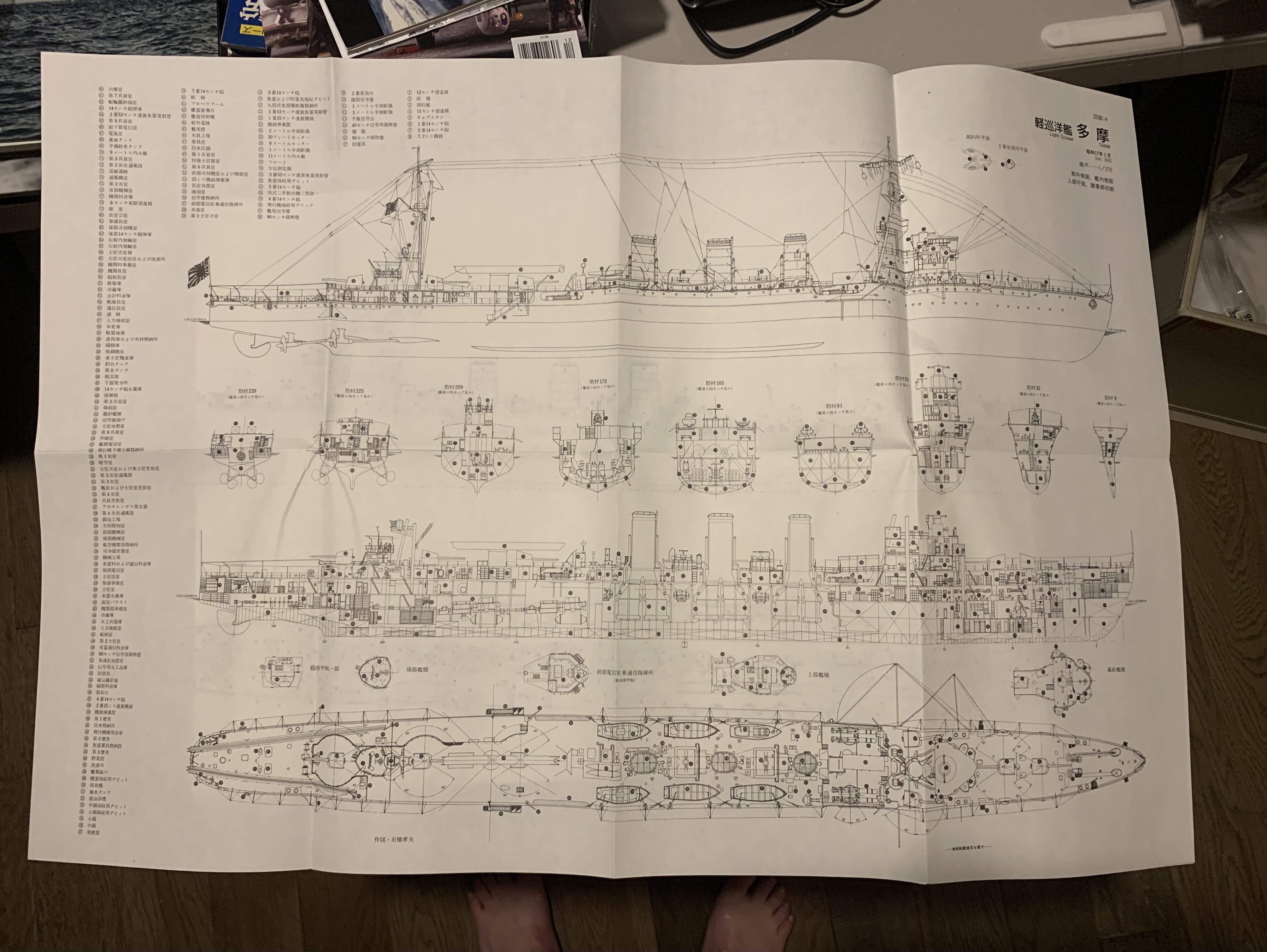

A couple of months ago I stumbles across an Ebay posting for a set of IJN plans. Since I primarily build IJN i thought it was a great opportunity to maybe gather some plans that I have been unable to finds, low and behold it contained a set of plans for the Tama.

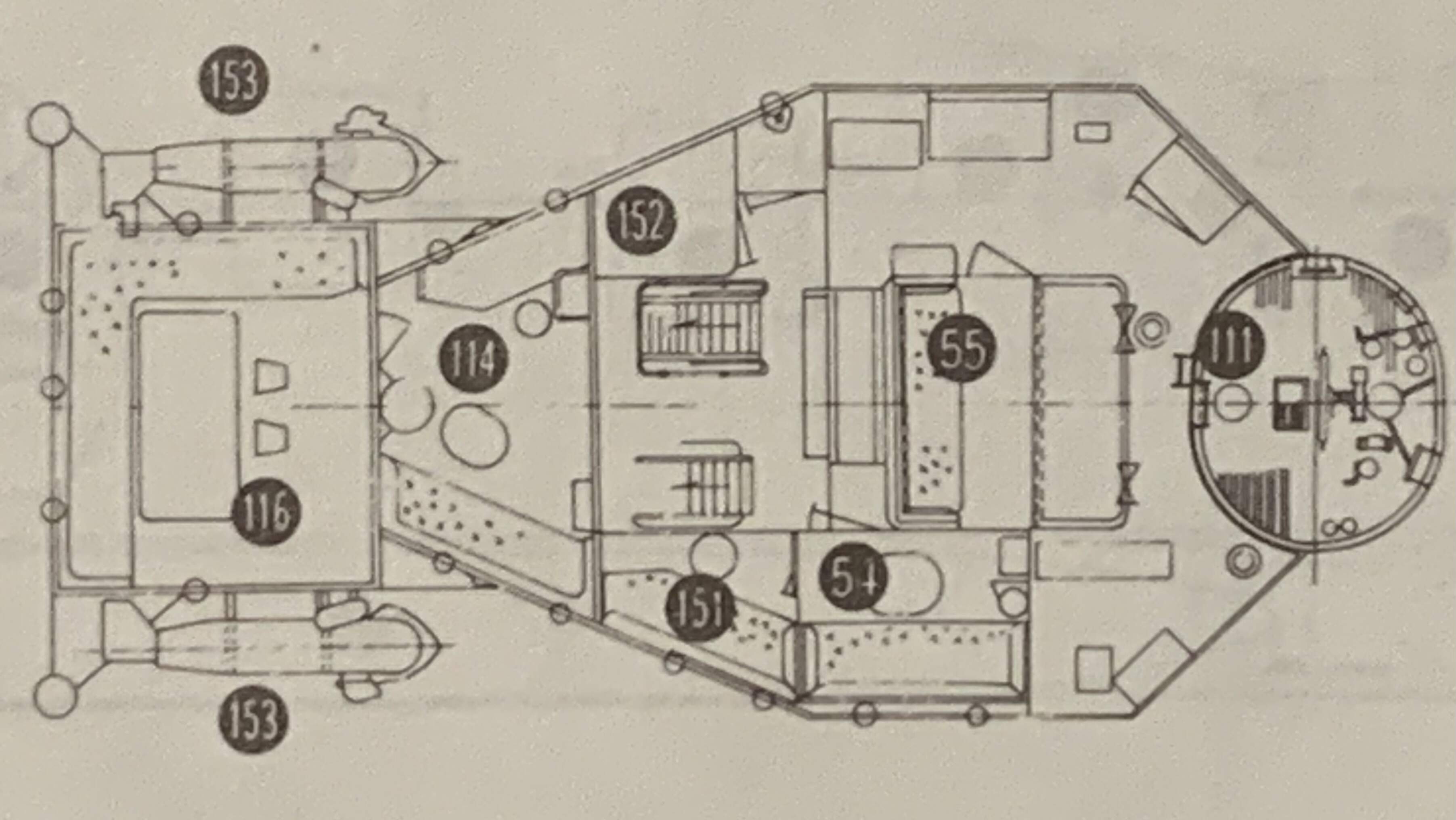

Luckily for me cause the Aoshima kit has some errors (shocker). One of the errors is that the instructions call for adding two binoculars to the compass bridge but according to the plans they are supposed to be 1.5m range finders. Luckily I have the Veteran IJN Observation set that will provide the correct parts.
The plans also highlight that Aoshima left some structures off the aircraft handling deck that I will have to scratch build, something I am honestly not looking forward to… :cry: :cry:
The plans are written in Japanese but I have found that using the Google Translate AP allows me to get the English translations. It’s not perfect but it’s better than trying to guess!!
I apologize for rambling on regarding the plans but I got excited when i finally took a closer look at what I was able to acquire!!

It is always nice to have detail drawings of the ship you are modeling. Goggle translate would have been nice to have when I used to install Fujitsu telecommunications equipment and their manuals written in Japanese.
