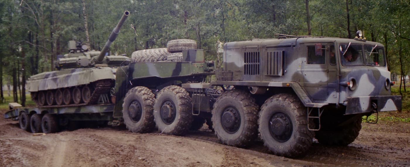

My inspiration came from a few sources. One was this urban pattern of camo that I’m sure most of you have seen.
(And if not go immediately and watch a Sabaton music vid!)
Looking at some color scenes on Russian tanks and vehicles also helped, notably the scheme pictured below which has a kind of duck egg blue color in it. I found a T-80UD color instruction sheet on scalemates that had this scheme and that helped me map out the camo a bit.

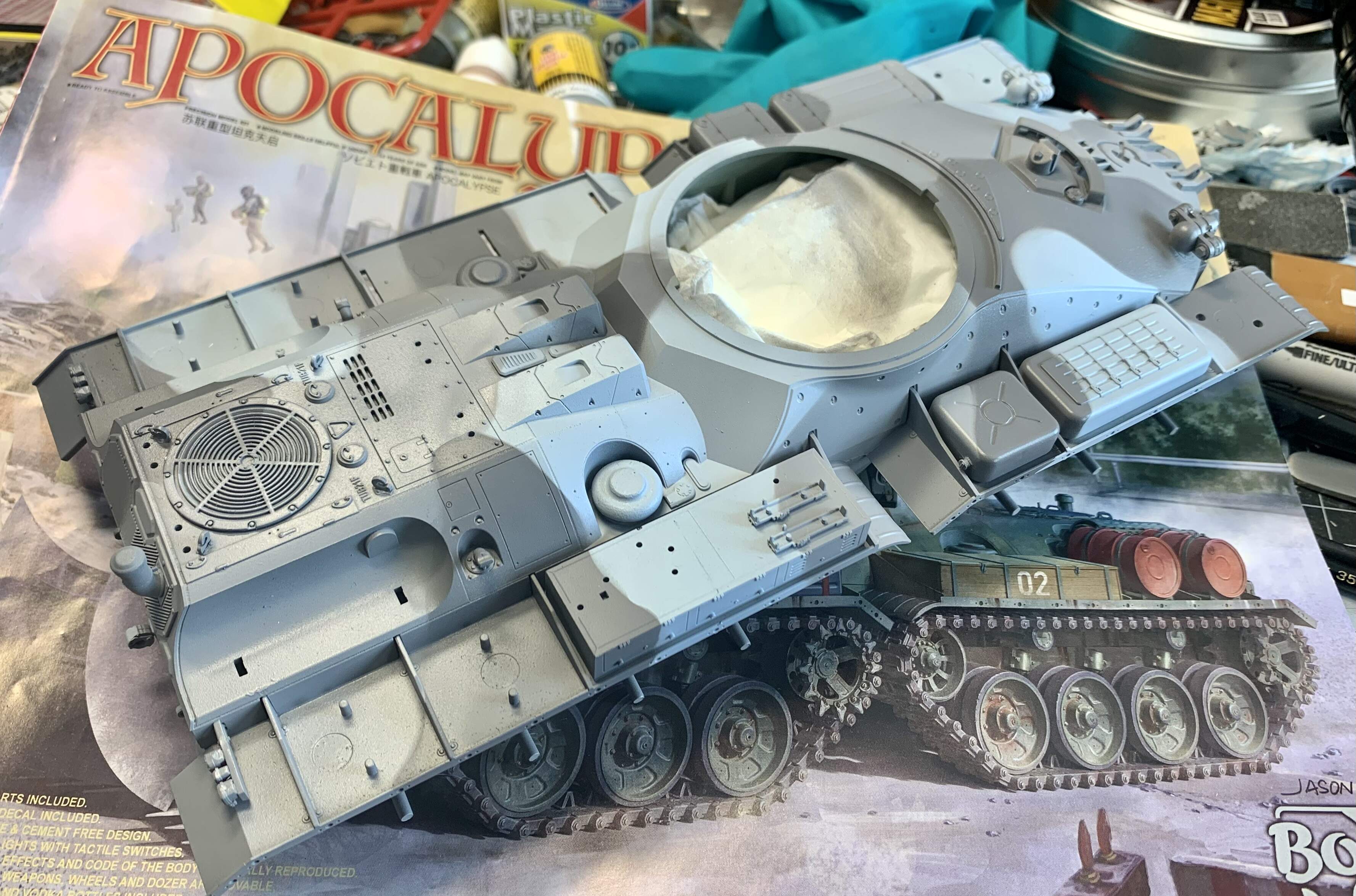

Mig AMMO colors were my choice for this with Light Ghost Grey, FS36293 and Dark Grey AMT-12 being the chosen three tones.
That was the easy part. Border have no color/markings guide in the box- having the usual front/sides/rear/top you find in most kits these days would have been nice as I could have drawn my scheme over it, helping me plan it.
As it was there is a top view on the red back page of the instructions which I did a bit of doodling on for a rough idea and then just got out the silly putty/panzer putty and got down to business.
As it stands now there are a few areas to tidy and finesse. There is also a decent amount of detail painting to be done. And that is not including the various other sub-assemblies in various stages of painting. So progress is definitely a bit slow at the minute!
