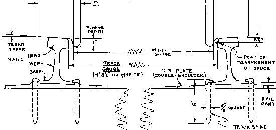

Russian gauge is 1520 mm → 43.3 mm
Standard gauge is 1435 mm → 41 mm
The gauge is measured between the rails, inside to inside, i.e. the surfaces that the flanges shall not quite rub against.
