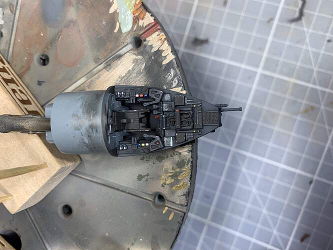

Have most of the cockpit painted now. A couple of more wee things to do on it, like the side panels and seat cushions, but happy so far.
Oh, and it started extra dark sea grey, then black, then German grey, then Tamiya light grey before I was happy with the base colour! Back panel is just a thicker coat of said light grey with silver chipping.

Looks really good Jim. Love the subtle changes in the grey theme throughout the cockpit. Gives it a genuine used look and the various little additions of colours just add to the look. Very well done

Thanks very much John, I’ve already added some more but going to stop now, don’t want to make it too busy. I think the original was fairly plain, but I think some extra detail helps at this scale.

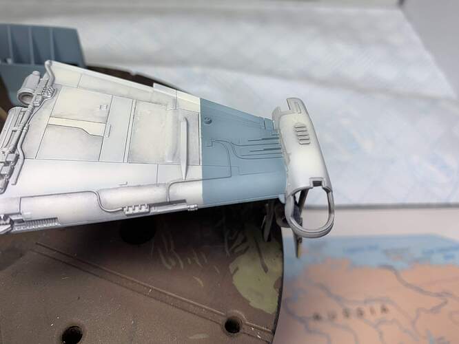

Well, that’s the mist coat on. AK RC white and Barley Grey, 6:1 white to grey, with plenty of gloss then thinned 4:1 thinner to paint.
After being very apprehensive about this step I am pretty happy with the result. The previous steps are showing through, and the colour is just about where I want it. Master Moore’s process once again delivers!
Cockpit also done. Couple of touch ups I notice from the pics but nothing major.
Now to conjure up a nice blue…
Thanks all, Jim.
Edit, tones of grey look slightly different left to right but that’s just my two lamps being different.

So, now we have the blue on. Tamiya xf23 light blue, and xf18 medium blue, mixed about 4:1 respectively. Then used AK RC 002 cream white to lighten the colour for highlights. As always the pics don’t show the shading very well. Also, those Tamiya paints must be well over a decade old, and sprayed just fine! I used mr color levelling thinner and a little clear gloss too.
Next step will be to use the overall mist colour, which I still have some of, to further highlight the blue and tie it in with the rest of the paint.
The rear cockpit part could have been masked more accurately but it’s sunny outside and I want to go enjoy it!

That’s a very nice shade of blue Jim. The whole thing is looking terrific. :+1:
Thanks John, I’ve now highlighted the blue with the mist colour, which is about 6 parts white to 1 part Barley grey. I think it brings the tones together quite well. Also painted the wing guns with some of the same mix on sections indicated in the instructions.
