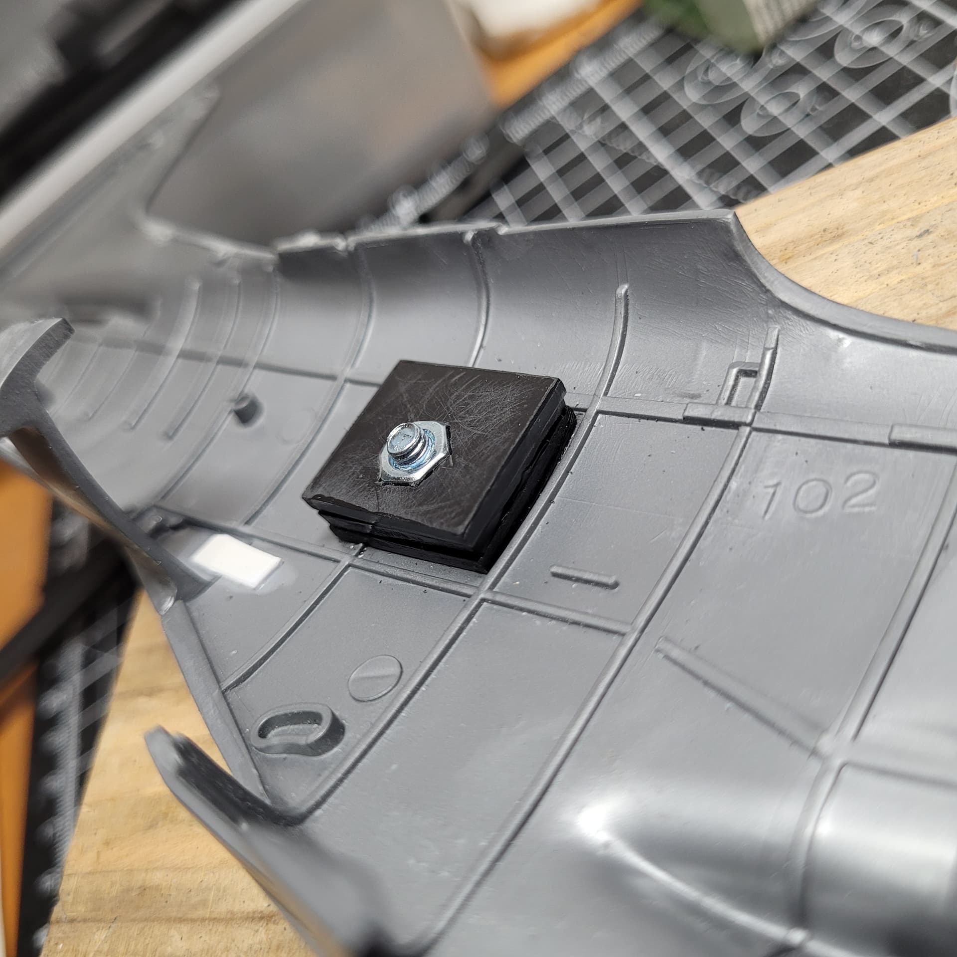

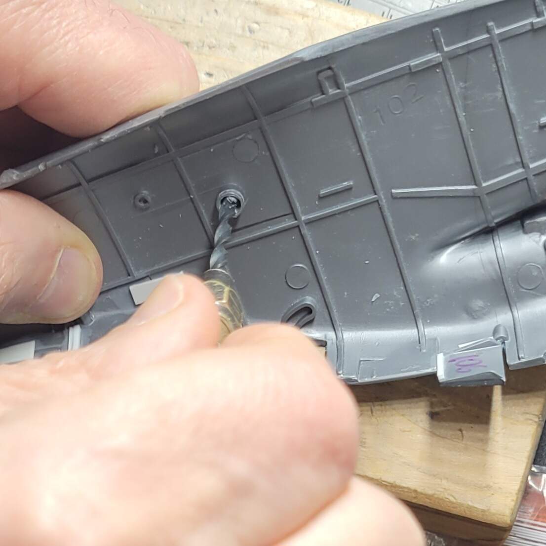

Not very purist I know, but I’ve drilled through the location socket behind the cockpit on one side so that a 4mm threaded rod can be fitted. I’ve mounted a pair of M4 nuts on each side, kind of floating a little so that the rod will definitely screw in place.
At the moment that’s just a bolt, but I have a 200mm rod on order. The other end will screw into a 10mm steel ball which can then be clamped into one of those mini photography multipositional rigging clamps, like this:
The other end of the clamp will receive a 6mm threaded rod which, hopefully will connect to an M6 ball end bolt (the type used for connecting car tailgate stuts) via a threaded collar.
That M6 rod should then be able to be screwed straight into an M6 wall anchor. Hopefully.
