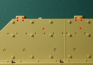

Pawel’s article is indeed a nice starting pint, Still - it is not complete. The Tamiya kit suffers from a glaring error - there are welds between the armor plates. Those are not present in reality. They’re easy to remove. Then you just scribe the separation line. You might as well do it on the interior as well. There are builds on this site that overlook this.

The rest of the “fixes” have to do with small details, such as adding bolts to the inside face of the armor. Most folks don’t bother with them but they are very prominent.

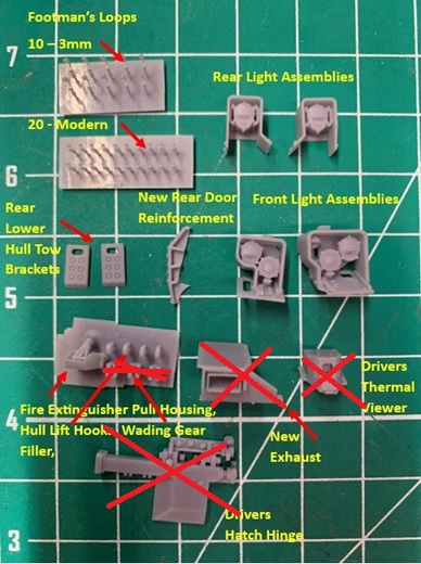

On his Upper Hull set, don’t use the parts I Xed out below.

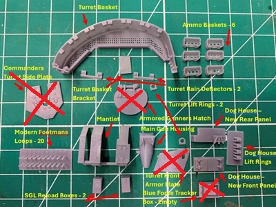

On his Turret set, don’t use the parts I Xed out below.
