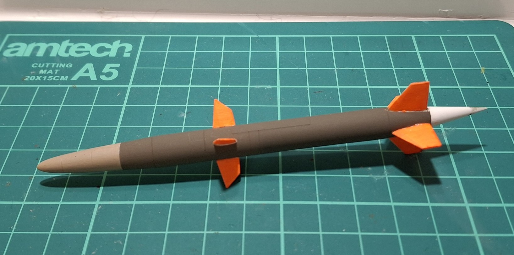

I always understood that white was the Go-To advice - although that may have been for a Day-Glo effect as seen on my Blu Water (air-launched version):
Still a work in progress I hasten to add.
