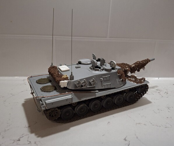

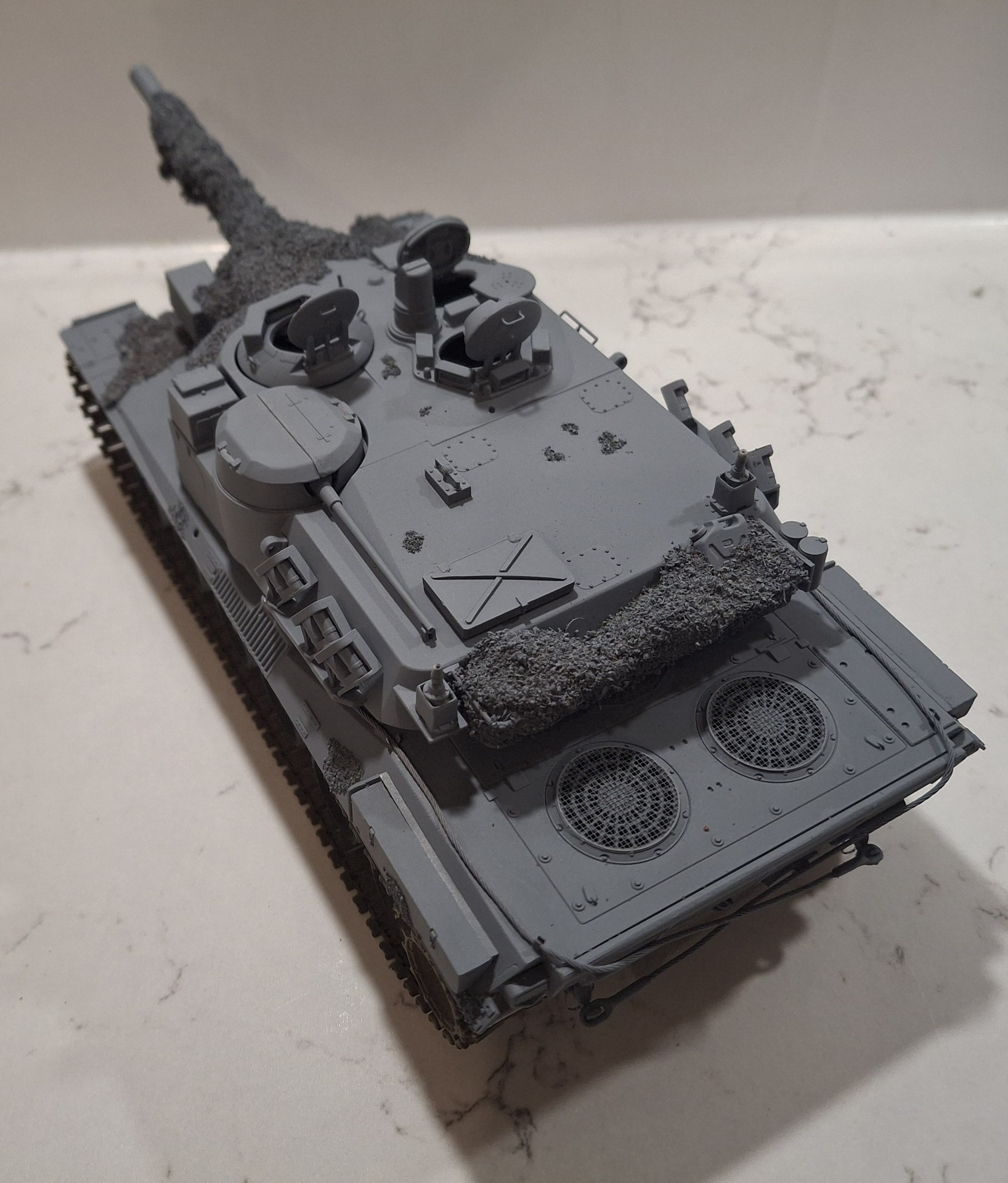

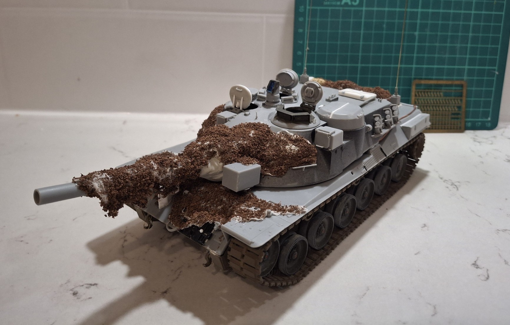

Upon reflection, I don’t think I’ll add any other tools other than a crowbar probably along the hull side or rear; anything else will spoil the lines, and against the Dutch method of stowing stuff in boxes. The trouble one creates when over-thinking things!

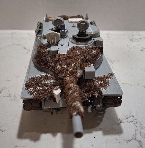

With a fair wind I might be able to get it in primer soon, and I’ll let it rest for a bit. Of course, having re-read this, I’m aware that I have said there’s a danger of “spoiling the lines” yet I’ve gone and swamped the frontal arc in cam nets!
Brian it’s beautiful. And I’m waiting to hear how you paint the camo nets as I’d be tempted to do similar.
I’d say it doesn’t not make sense, which IMHO is good enough :slight_smile:

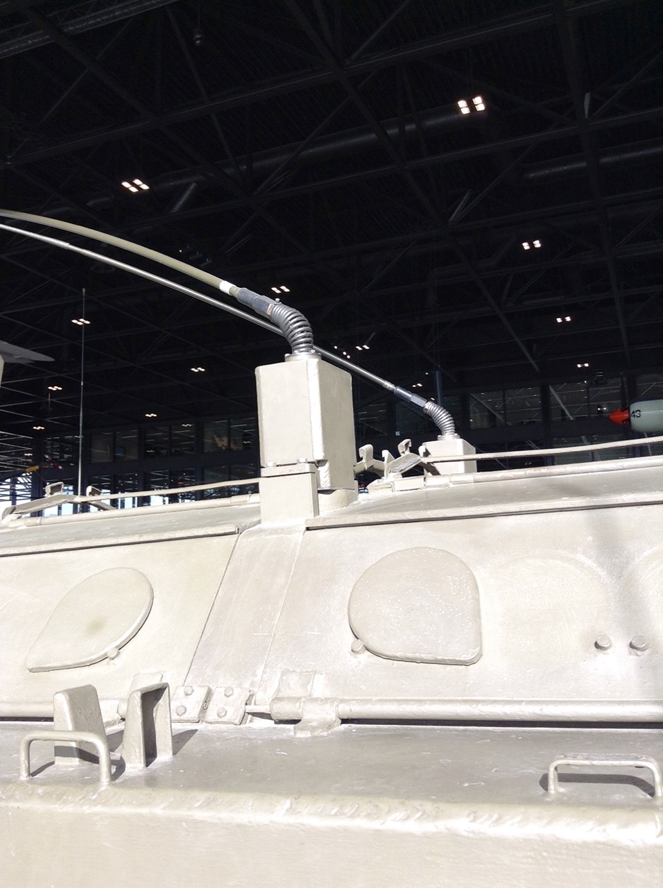

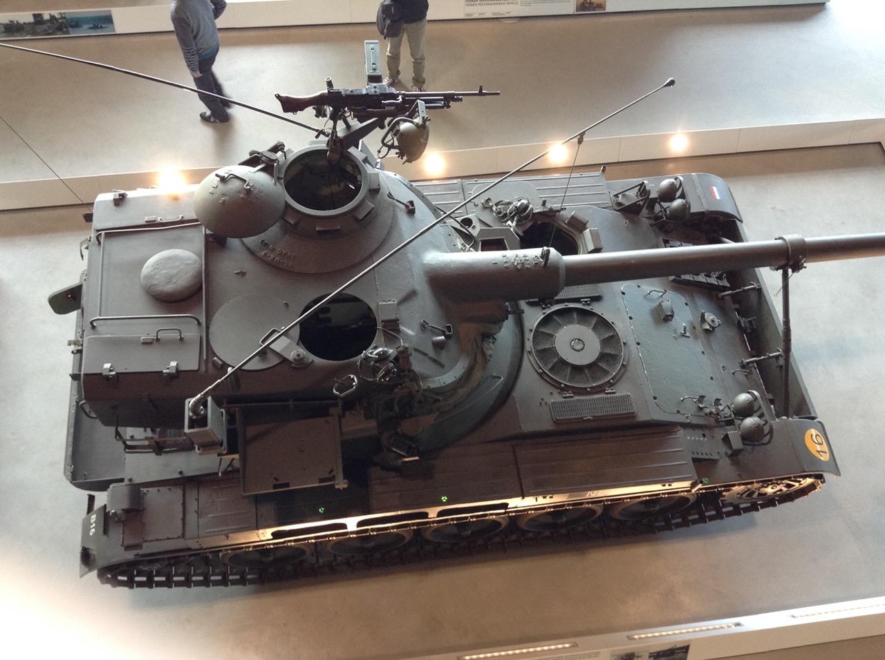

You have it sitting on top of the tuning box, though, when the antenna base should be inside of that with really only the spring part above it. Compare to the ones on this AMX 13 and AMX PRI:
indeed, but I went by this Leopard version:
which will also enable a splash of colour when it’s painting time - I know it’s only a dull red but that still might be interesting.
As you’ve probably noticed, I’ve binned the idea of any further tool installation.
That should be exactly the same type of antenna as in my photos :slight_smile: (And the same location, going by the window in the background: the National Military Museum at Soesterberg.)
So, to protrude, or not to protrude? That is the question. I think mine might just have to stay where they are!

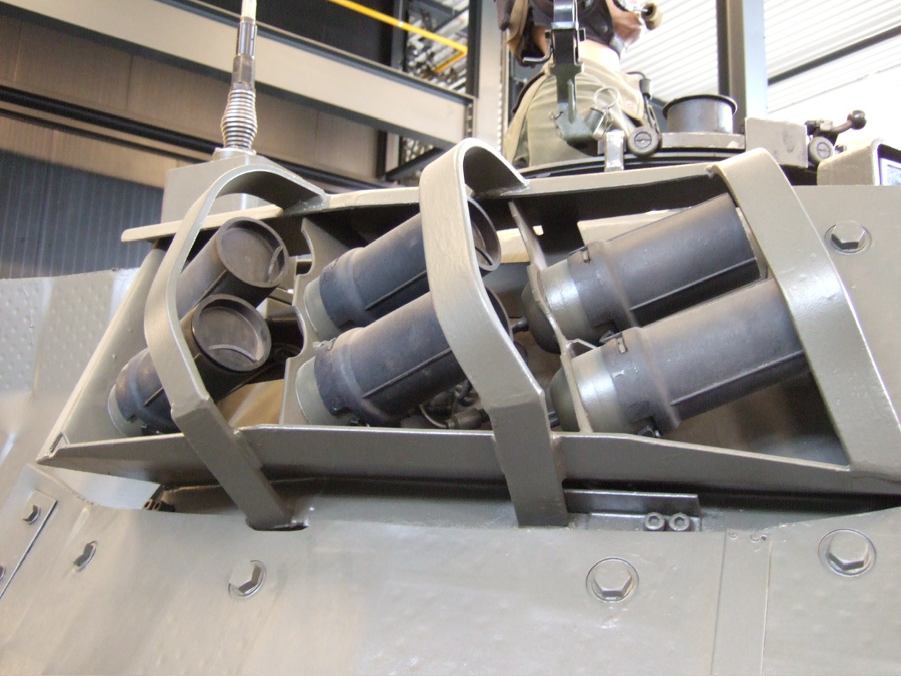

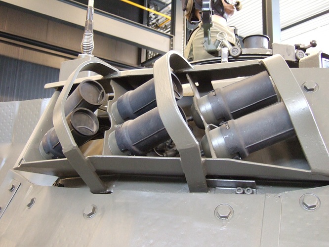

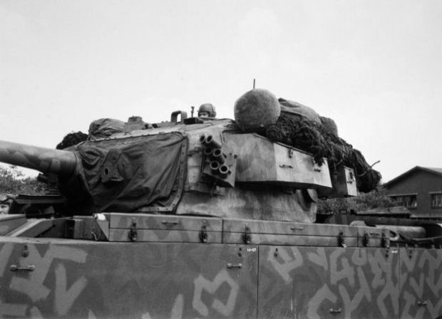

Talking of details, it looks to me that the smoke dischargers - or at least the “barrel” piece - are coloured black/dark grey. I’m assuming that this is the case for such set in 1974?

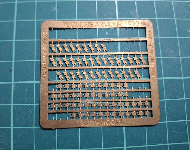

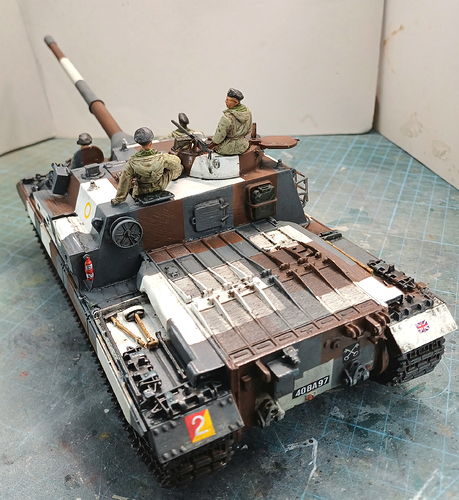

Right Folks - that’s about it: the build anyway. Antennae just lodged in position for the photo, and padlocks yet to be added - as I just know I’ll knock them off during painting.
I will probably add a little more flock on the rear hull and sides. Next stop primer, but I’m not too sure when that will be.
The barrels would be dark grey, but slightly lighter than the black plastic caps in the ends:
This is a Leopard 1-V but the launchers are the same on all Dutch vehicles.
It could be they were painted in the 1970s, but I don’t think they were.
Roger that; thanks very much.

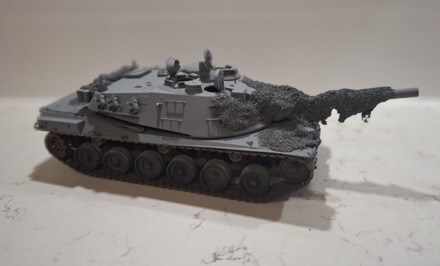

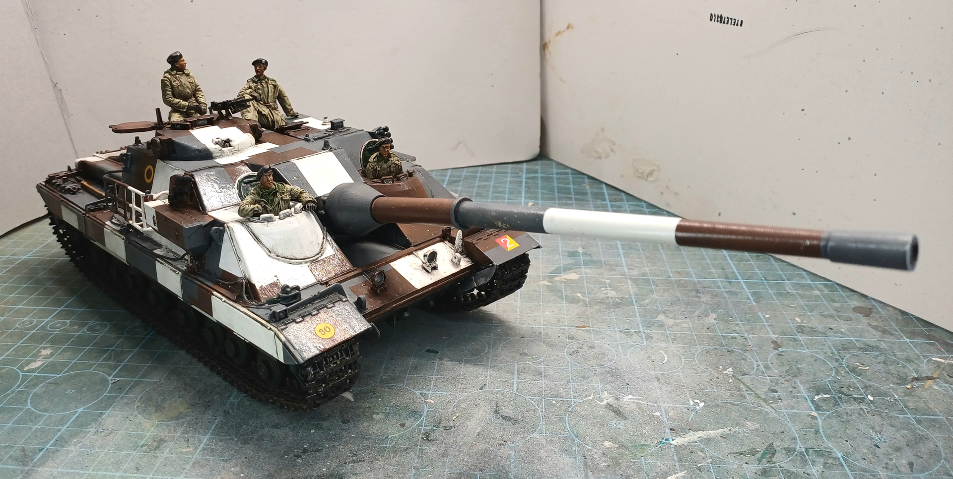

In between aforementioned medical bother, I managed to get the beast in primer; other issues such as final finish will be addressed when I am able. In the meantime:
Antennae only temporarily installed; and I’ve also made some mud flaps which I will add later - I just know I’ll only knock them off otherwise:
It’s coming along nicely! And hope the medical issue is nothing serious…
Heading splendidly in the right direction, Brian.
As @barkingdigger suggests, fingers crossed that the medical issue is not serious, and resolvable over time. Keeping everything crossed for you!

Calling my contribution to this campaign done..
Ooh I like it! But I hate to think of it turning corners with that long barrel…
Fantastic job Bert. The Berlin Camo looks great.
