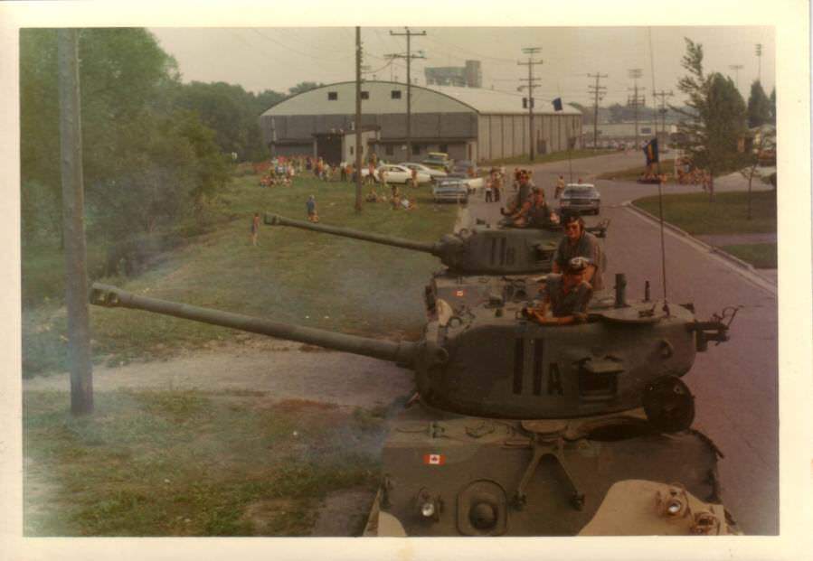

I will be doing this photo of a Sherman from the Ontario Regiment in the '70s
I will be using the nice Tamiya 1/35 M4E8.

Check your references. There is a good chance the Sherman’s in the photo are M4A2E8’s so will have a different engine deck. I also suspect they would have the T-84 rubber tracks on since they appear to be driving on asphalt but that’s just a guess.
Darn, I just checked your right they are M4a2E8 with rubber tracks…
I had to dig pretty deep to find that info so I bet I can throw some rubber tracks on and no one would tell the difference as the only photos show the fronts.
I will know … lol

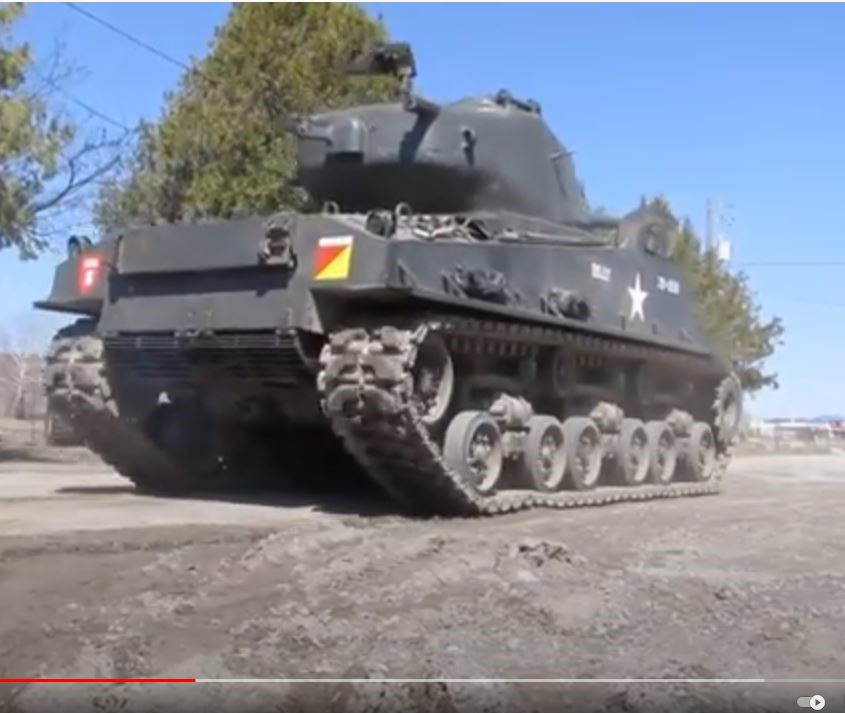

I have some more bad news, wont just be the engine deck you will need to fiddle with. The back plate and exhausts are different too.

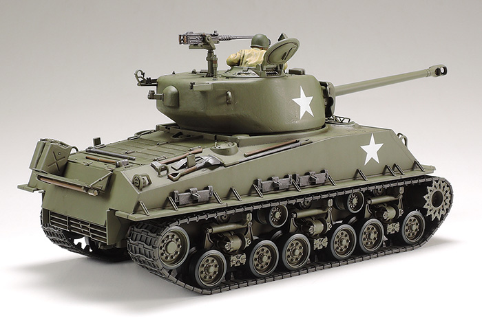

Here is the Tamiya M4A3E8 (from the tamiya website)
And here is a screengrab from youtube of one of the Ontario Regiment Museums M4A2E8’s
