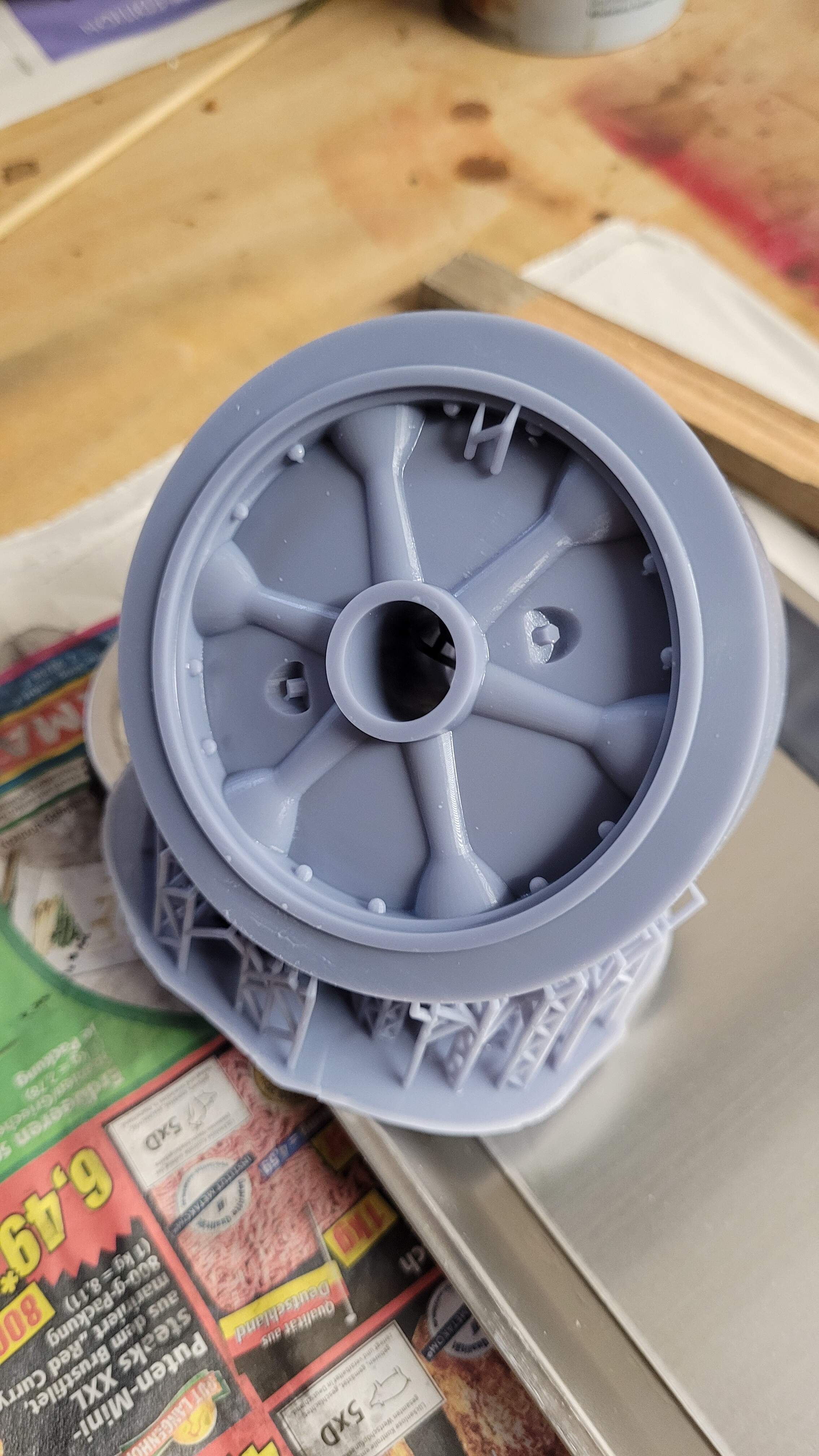

Okay here is the spare wheel fresh from the printer :slight_smile:
Now we have a spare wheel:

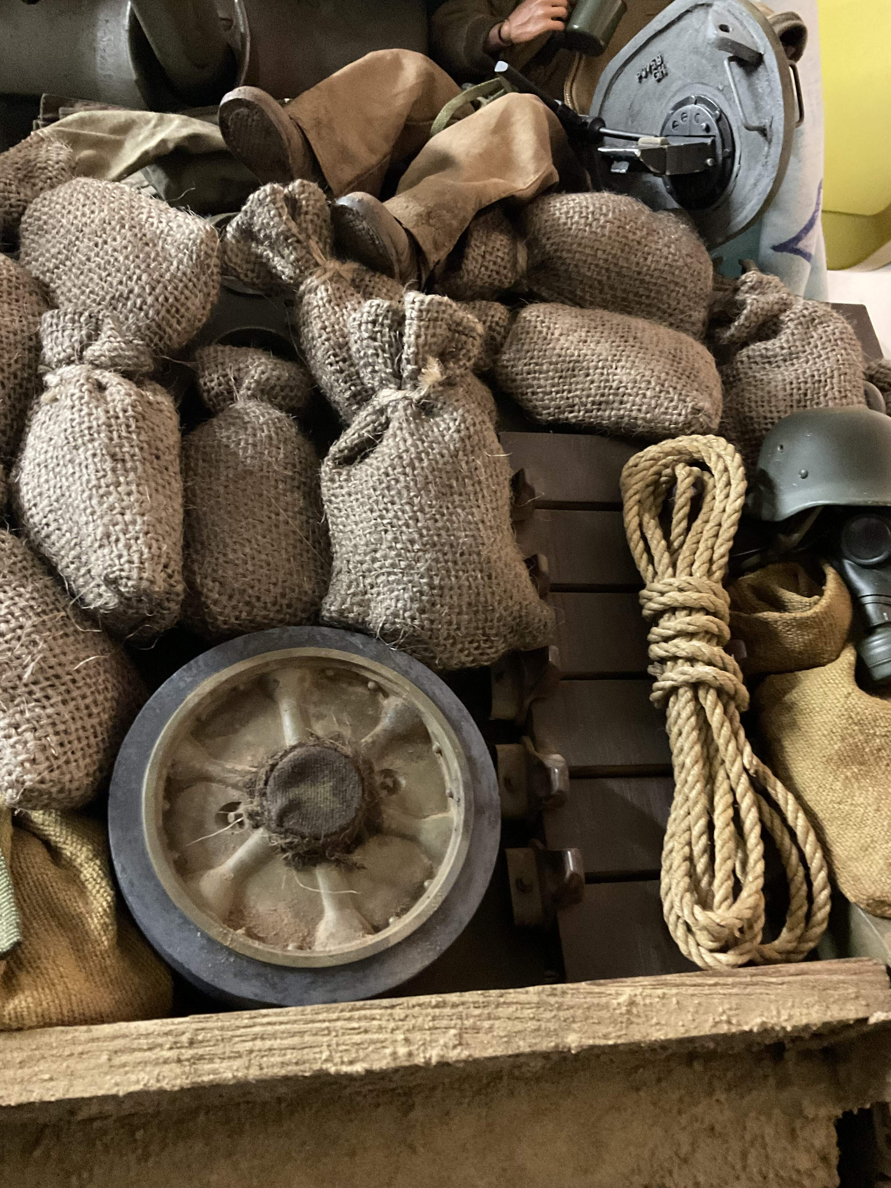

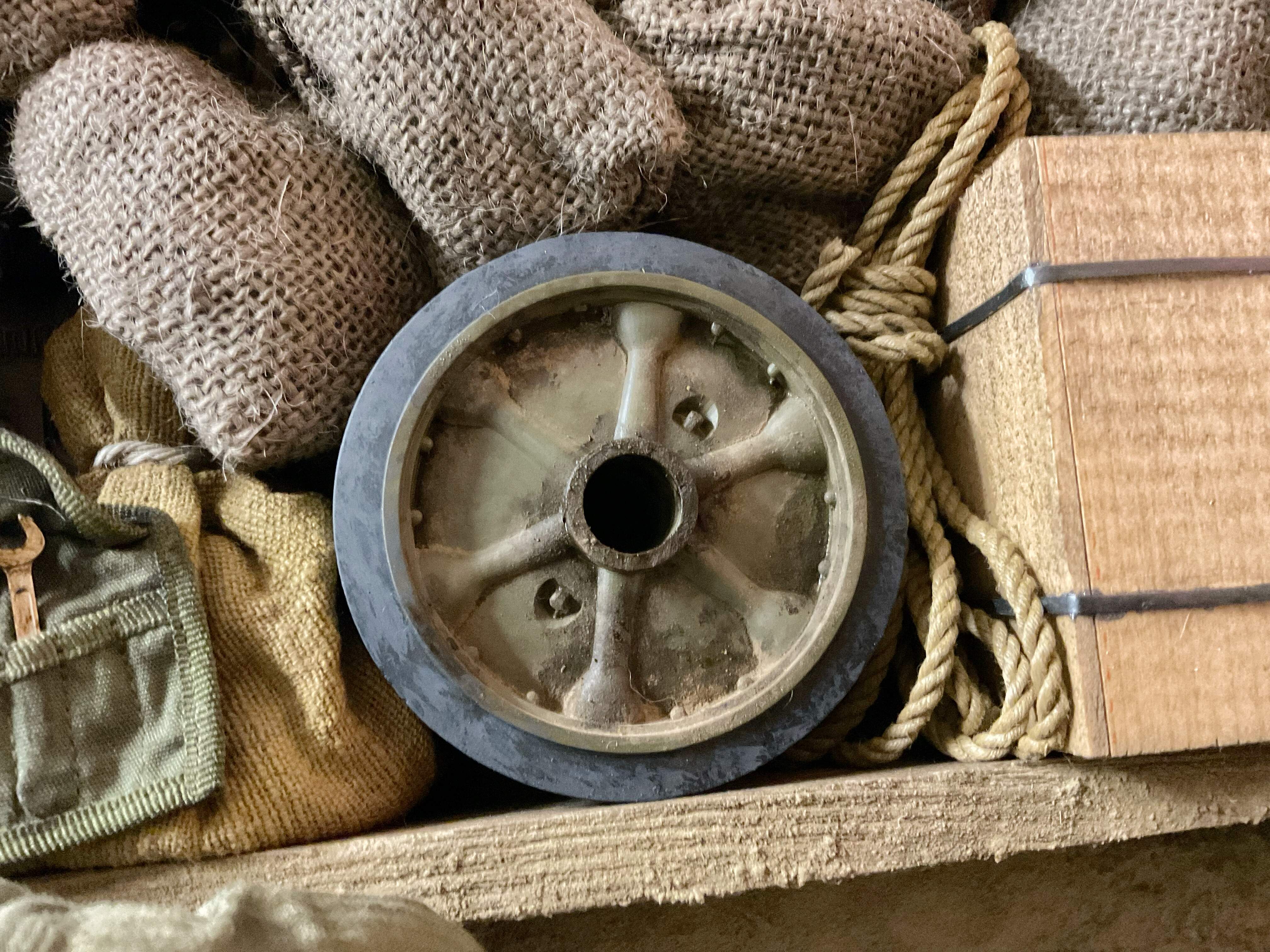

Just looked at your spare, and noticed it lacks the inner bearing! That big hole had a sleeve inside to form the inner part of the bearing race. Fortunately a wheel stowed for later use would most likely have a circular dust cover over the hole, so easy to fix!
https://www.theshermantank.com/tag/road-wheels/
As my tankers lost the cover they helped themselves with this:

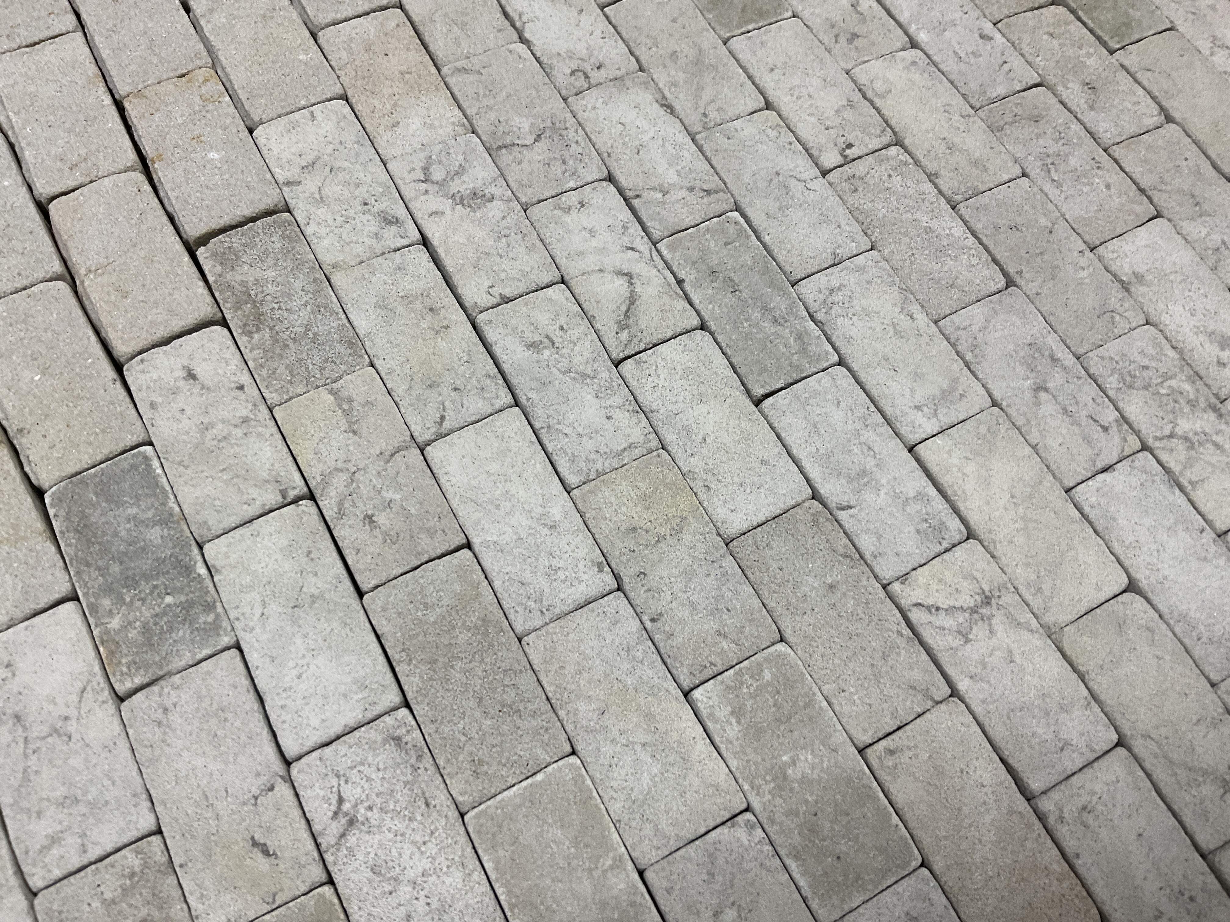

I really should start working on the base but I am not sure how it gone look like, i think maybe the tank should be half on some cobblestone road, what do you think?
That would look cool, maye have the Sherman at an angle (I’d give you my sketch but my email is down and I can’t get the picture). Also, be sure to blend the edge of the road and the dirt well and have the small rocks that usually are thrown to the side of the road by passing vehicles.
He angle will be difficult because the base Platte is too small, and a don’t want to get bigger. I need the rest of the free space for more figures. I have a bunch of real sandstones left from my model train, maybe I can use them here.

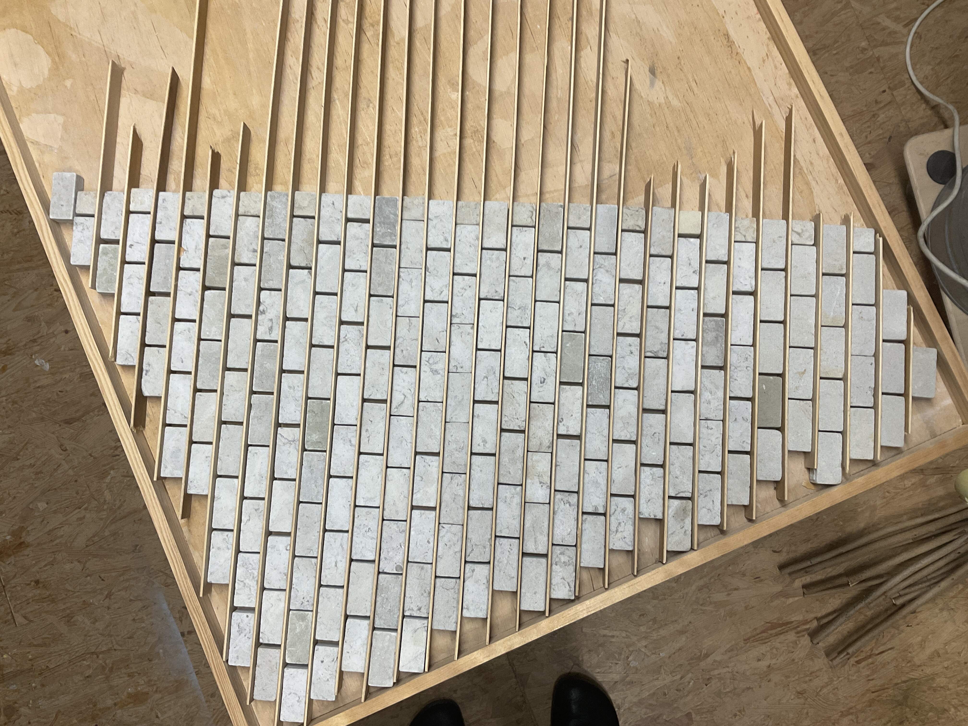

I tried this but it seems to thin:
Hm, the surface needs to be more rough but they are soft so this should be no problem:
This looks much more realistic now:

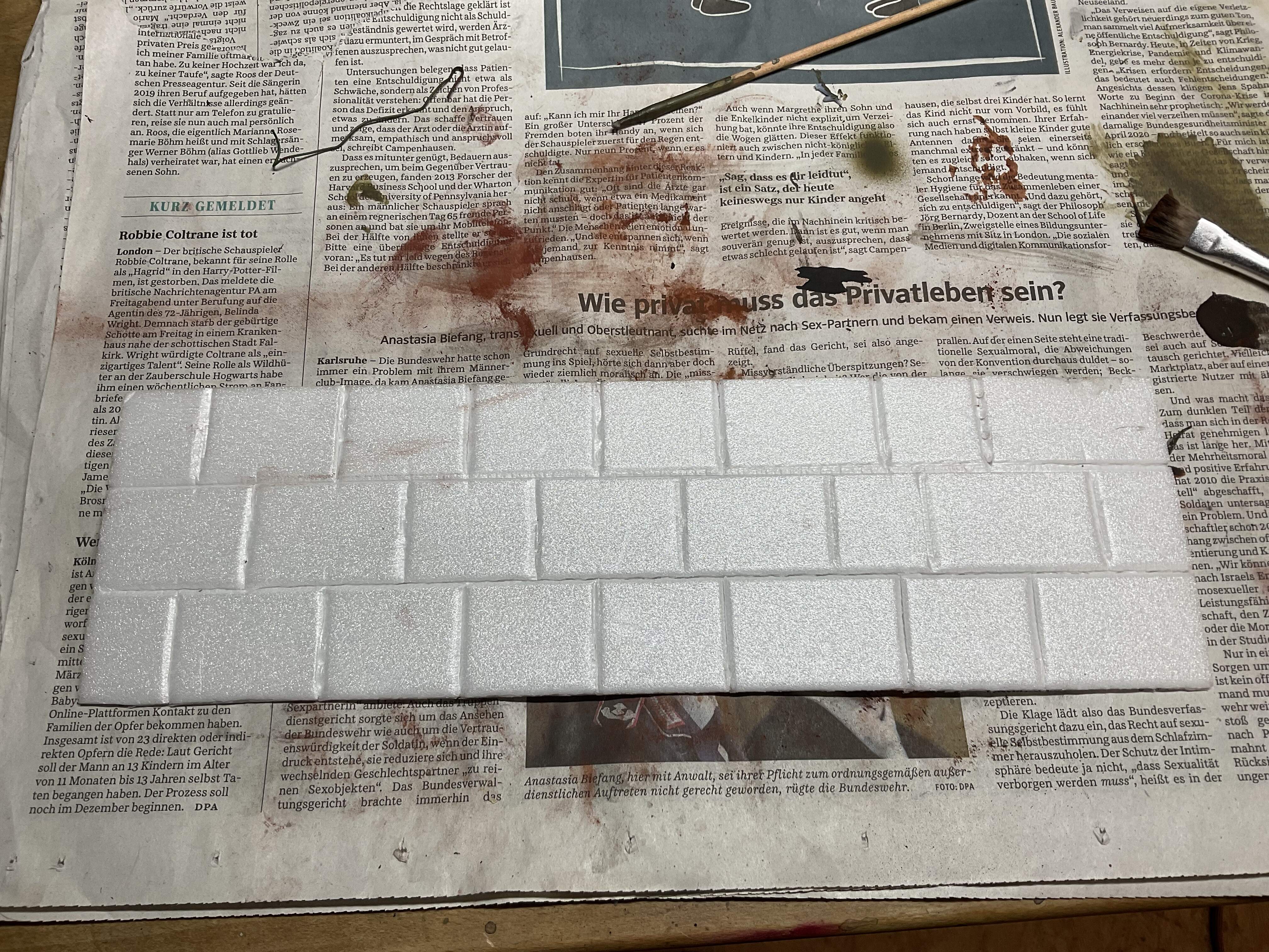

Okay, now only some sand to fill the gaps and we can start to colour it:
looks great :+1:
Okay so I cracked every stone from hand so they look more real and sanded them:
