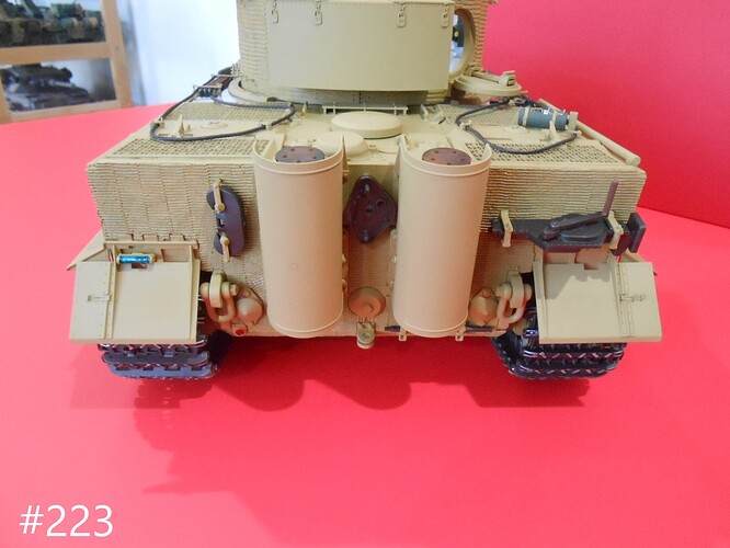

The Exhaust is installed.
I tried to remove 1 link on each side, it wasn’t easy but I managed by cutting the links to be removed where the pin is inserted. It worked and here’s howit looks now.
I think it looks a lot better and has a little sag instead of just lying on the tops of the Wheels.
Regards
Donald

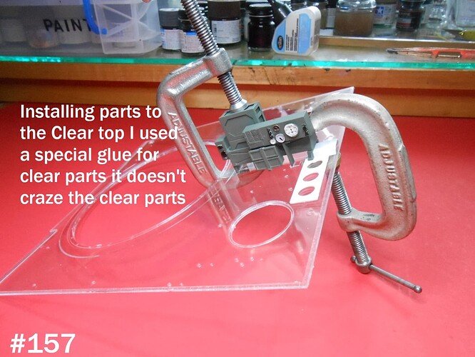

I started working on the parts that go on top. I glued the Radio and a few other parts to the top plate. I used a glue from Testors that I had laying around, it 's not suposed to craze the clear parts. I’m clamping it over night the glue takes a while to set up.

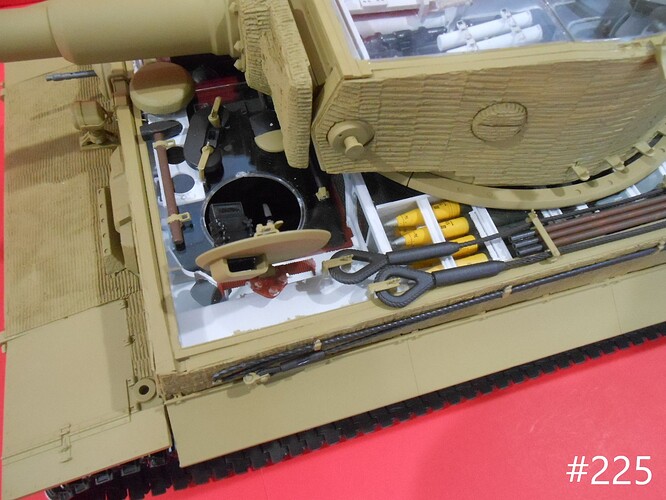

I have just finished installing the tools and cables to the top.
Starting work on the Turret next.

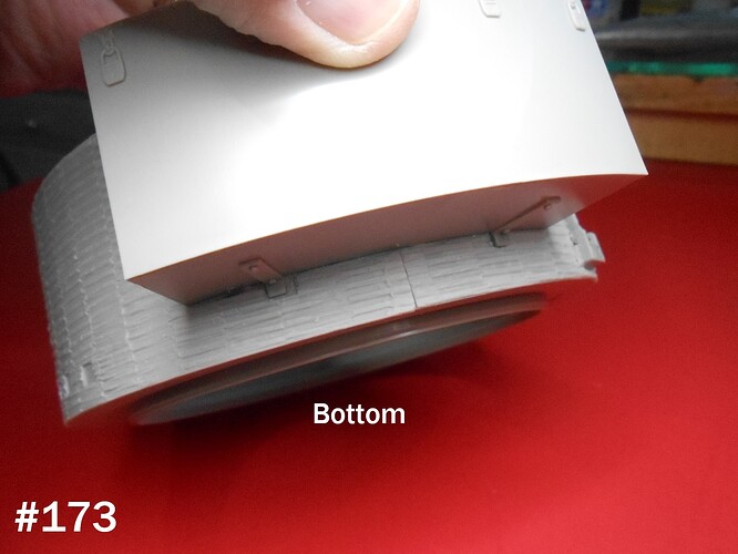

Some work on the Turret.
I had to remove some of the Zimmerit, the Stowage Box wouldn’t fit. Not a real big problem.

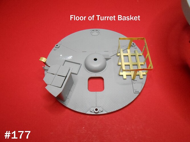

I’m doing the Turret Basket in two sections to ease painting.
That’s all for today
Donald

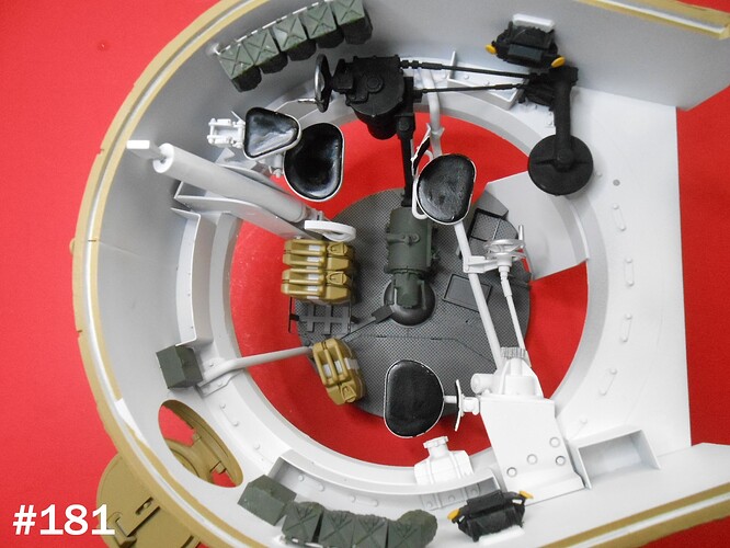

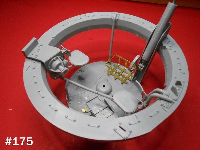

More inside the Turret.
Finished for now.
Donald

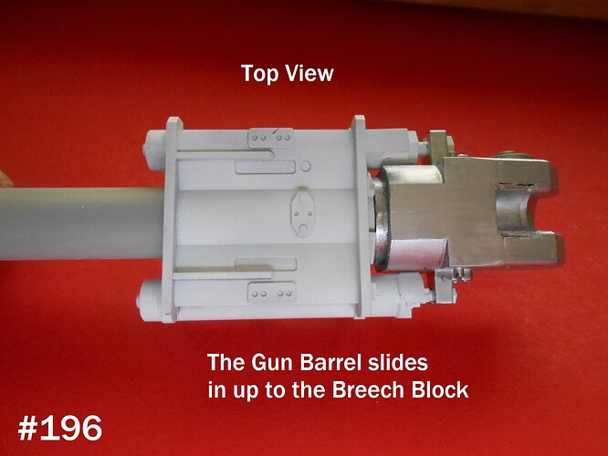

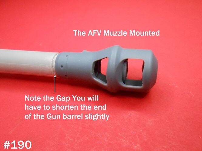

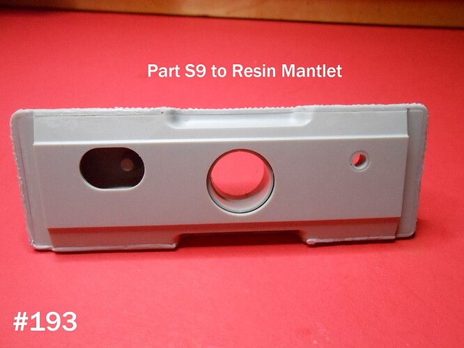

I almost ruined this build, wasn’t paying close enough attention and put the Mantlet on upside down. Luckily the glue wasn’t set and I could correct it.
First the Muzzle Breaks, here are the Kit part and the one from AFV Model.
They are pretty similar
If you use the AFV Model part you will need to shorten the end of the Barrel slightly.
I installed the Gun Barrel from the Back
Now to paint it and install it on the Turret.
Regards
Donald
