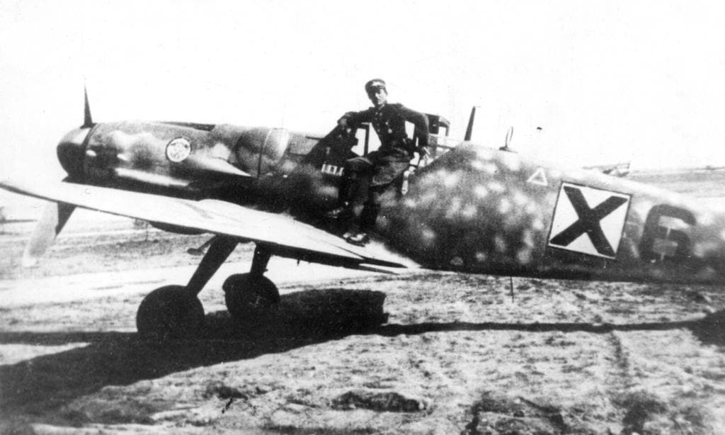

Angel, thank you for all the info on the Bf 109G and the Praha tank.
I am not sure which Praha tank to do. It seems they had whitewash on them based on the pictures from the November 1944 parade? Or is the paint work just very scruffy looking?
I have a good feeling of how the Bf 109Gs looked. What is interesting is the light white/grey mottling used on the fuselage of a number of Bulgarian Gs.
Also it seems both white and yellow tail bands and wing tips recognition markings were used.
Once I receive my decals I will reach out to hear if others have pictures of the exact machine I am building.
You’re welcome, Jesper!
No whitewash was applied in the Armored Brigade during Autumn 1944 battles in nowadays Serbia and Kosovo- the autumn was warm and rainy.
The picture you posted of Praga 62(reg.no В 60262) was taken during Dec. 2nd 1944 parade in Sofia- the day was sunny and windy.
What you see as a scruffy paint is the flaking Dunkelgelb, that the tanks were delivered in- obviously a result of lacklustre painting at the overhauling factory in the Reich.The dark spots are either underlying Panzergrau or dirt.
I think you have several pictures of Praga 62(incl. one from the rear)- the young TC is of help to recognize that parricular tank.Or you can choose any from the other on the group photo in front of Sofia Cathedral.
With regard to Bulgarian Bf-109 collors-they were delivered in the standard Luftwaffe collor scheme at any particular time.
The yellow tail band and wing tips AFAIR were South Europe and Mediterranian theatre collors, so their presence on Bulgarian Bf-109 has an explanation.
White tips and tail band were recognition for North Europe and Scandinavian theatre and normally they should not have been present on Bulgarian fighters.Yet they are…
There are 2 possible explanations:
-either Bulgaria received some Bf-109, that were originally destined for North Europe/Scandinavian theatre,
-or the maintenance and overhaul factory, set up by the German near Bucuresti, that took over repairs of Bulgarian Bf-109, used whatever parts they had at hand, not taking theatre collor paint into account(the Bucuresti factory was also responsible for the Eastern front).
Mix of both is also possible- Allied bombing campaign on Ploesti forced the Germans to scrammble whatever assets they could find and the main volume of Bf-109’s were delivered to Bulgaria especially to counter that threat(Allied bomber routes from both Foggia and Alexandria to Ploesti/Pitesti crossed Bulgaria).
I assume “Getting The Job Done” prevailed over theatre collors and markings.

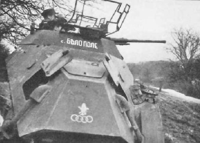

So, with slightly more than 2 weeks remaining till Bulgarian WWII Campaign kick-off day I have finally chosen my Campaign build:
Called Horch M.222 in Bulgarian service, the Sd.Kfz.222 equiped the Recce Platoon of the Armored Brigade.
I will use the ex-Tristar/nowadays HobbyBoss kit 80149, that comes with decals for the Bulgarian version.
