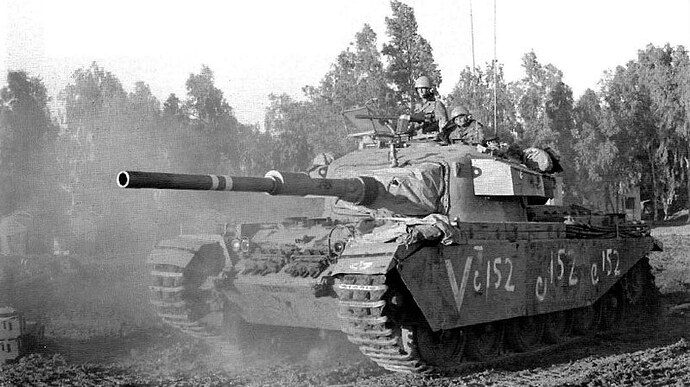

I see an uncanny resemlance…
:smiley: :smiley: :joy: :joy:
Lol … True and one of my fav films as well :grin:
