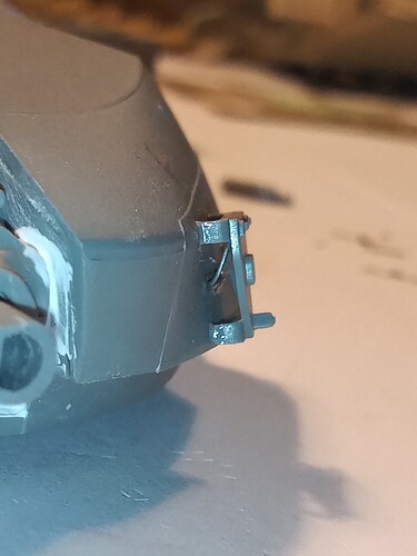

Started the mounting brackets on top of the NBC pack
Although the PE needs some work, it’s unavoidable as there isn’t a kit option, and this was fitted to Mk11’s.
Where the indents are for the poles, they should have more of a pronounced lip.
So I cut some PE fret and annealed that , then bent it into the rough shape and CA’d it into the 4 recesses.
Then with the upper locking plate fitted.
Cut 2 different sizes of rod, and added those for the securing knob on both and also a length of rod on the inside as the threaded rod.
