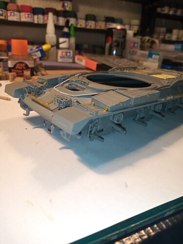

Oakey doke… Some chieftain time …
Going to get the rest of the smaller delicate PE onto the hull, deck handles etc, then make a start on the turret. That will need some fettling so the access door handles and tie down loops look better than the moulded on stuff …

Only got to do a few bits… A couple of the hull hooks on either side, plus the gearbox deck handles.
Used the kit PE for this, but was time consuming as I added the small pivot mounts with cut down wire, and glueing those all in place…
Engine deck handles tomorrow, then the turret phase…
Engine deck handles and the fragile PE hooks…

Thanks Brian.,… I’m not over enamored with the deck lifting handles. On first glance they look nice, but then they look to flat … They lack that 3 dimensional roundness of the real ones . I may try and delicately add some quick drying CA glue the visible surface on the flat handles to try and add some substance to them…
If you want to thicken them up, and I use the same for my 2D foliage branches, try Mr Dissolved Putty; that said, PVA glue may also do the trick.
Another option would be lead wire, bent to the same pattern.
I think this is a good option.
