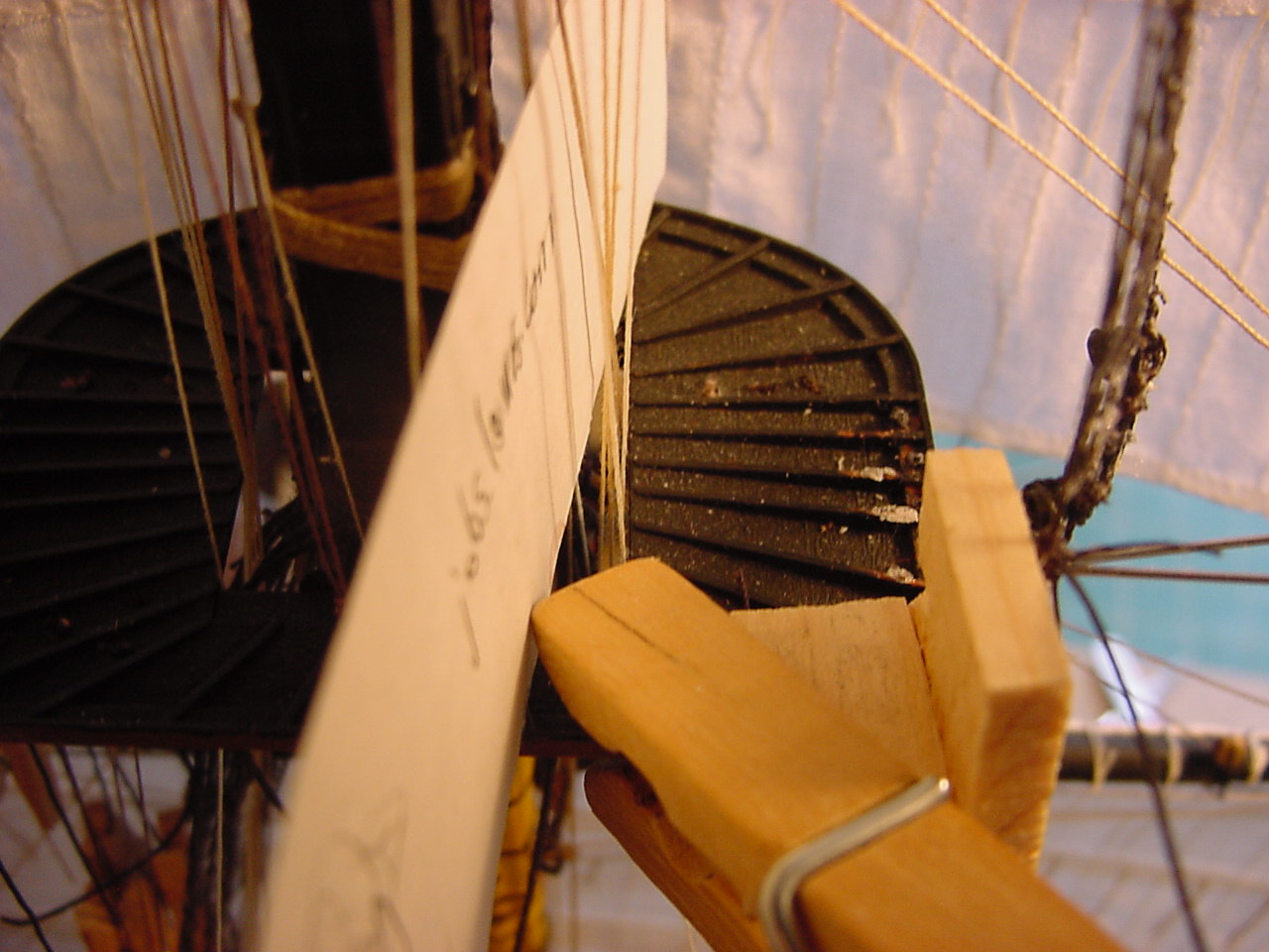

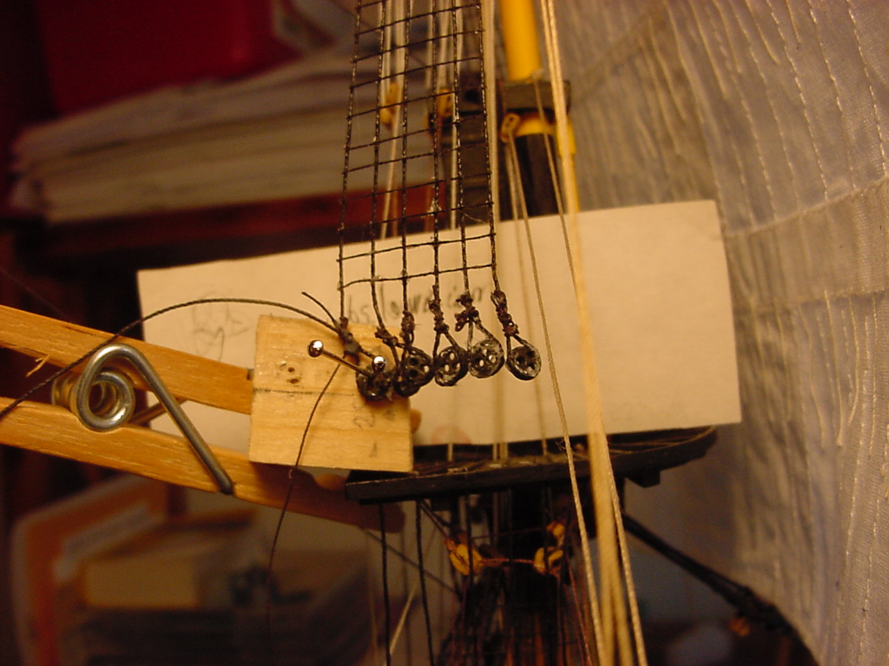

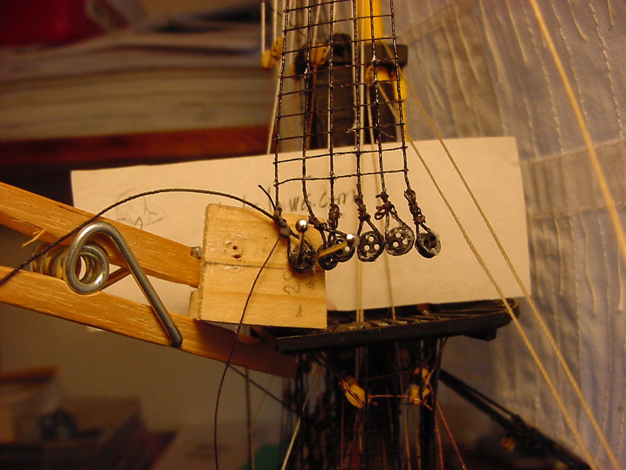

So anyway, a couple few pictures. The pics were taken after I finished lashing the shroud around the last deadeye; I think, in both the first and second pictures, the second shroud/deadeye combination (counting from the right), the lashing looks pretty ugly. I’m thinking of maybe removing as much of the old lashing as I can, and give it a do-over.
You’ll also note, that my little jig I was using to hold the deadeye in place, is not laying flat along the top of the maintop…that will probably impact the height of that particular deadeye relative to the other deadeyes, but I might be able to minimize that when I start putting in the lanyard between the upper and lower deadeyes.
This last picture, is more about the top than anything. What I want to point out, are the white spots on the top, just beyond the jig. This is where I glued the jig to the top when I was working on the middle shrouds; I couldn’t find a clamp or anything to hold the jig in place, so I went with the glue. So now, I’ll have to figure out a way to scrape/sand that excess glue, before I put another coat of paint on it to hide everything.

Timmyp,
I have had that avatar for years and used it on other forums, but it wasn’t until a few weeks ago I forgot to add it to this forum. I use this one because when people first meet me they think I am some kind of grinch do to my looks, but I am really a nice guy as the grinch did at the end of the story.
Your rigging work is looking good. Sorry but I don’t have a solution on removing the glue, mayby us a scapper very gently and it will pop off.
Mark :beer:
Hey Mark,
Yeah, I’ve thought about scraping the excess glue off - unfortunately, the glue residue is too small to sort of pop off, but too big to ignore. I guess I’ll use a combination of scraping & sanding to try and clear it.
Do you happen to be using a PVA type wood glue? If so you can just brush some water on it and in a minute or two it will soften enough to be gently scraped away without damaging your beautiful work.
Hey Tim,
No, I used good ol’ Testor’s cement, so I think this will be a scraping/sanding job.
