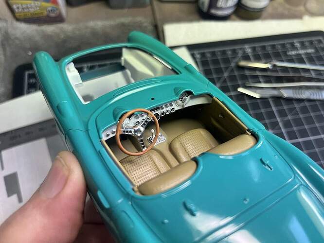

It’s been a couple of weeks but I’ve had a little time to chip away at this one. Progress on the interior tub and dashboard detailing, and test fitting the shell on the rolling chassis to see how things look.
Cheers, D
Whoa HO HO!!! Looky what we’ve got here!!! Astonishing finish and great look so far Damian!!!
What a SHINE!!!
D,
I’ll 2nd what Joseph said. You’ve out done yourself on the finish, and the interior has the perfect shading for those seats to really standout, as well as the dashboard. All the instrument faces and bezels look dead on perfect.
For my money the amount of work completed isn’t what’s important to us modelers, it’s the quality of the work that’s #1.
joel
Amazing finish D. Most likely your best paint job to date.
