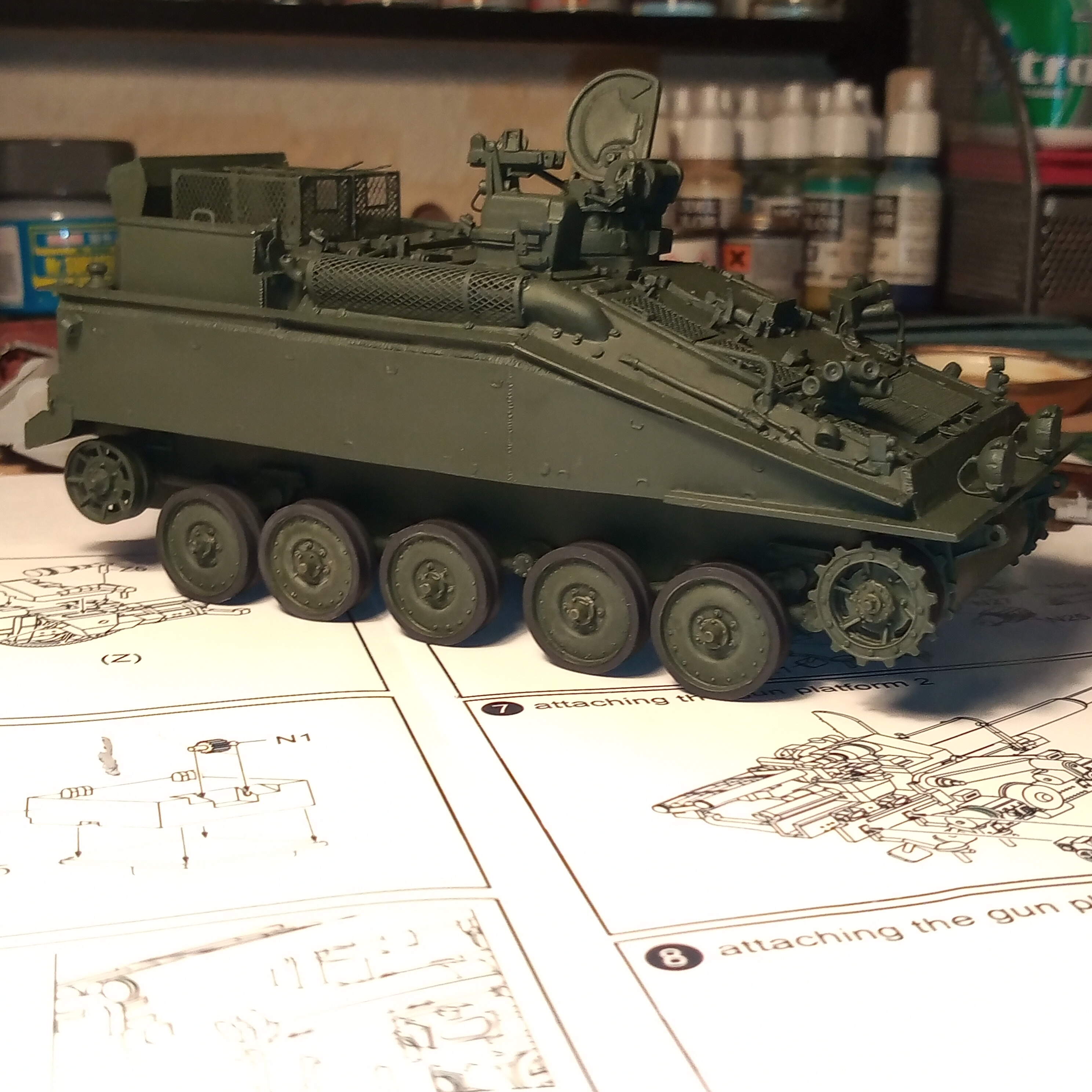

Thanks guys for continuing to look in and your kind words, always nice to see you here. :+1::+1:
Hi John,
Your build was already looking amazing prior to priming and painting, but now it has its ā€˜green-sheen’ it’s starting to really zing as a build, simply stunning, :+1: :slightly_smiling_face:.
Cheers, :beer:,
G
Thanks G, its in the last stages now … then it will be onto the Mk 10 Chieftain Stillbrew … Only thing I will have to sus out is the small black C Sqn Tac signs for the Striker, I only have the Accurate Armour ones in yellow, and I really dont want to have to buy the black set just for 2 circles lol…

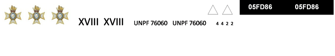

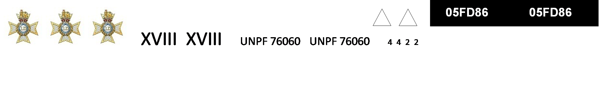

Have you tried printing your own? I printed the tac/callsigns, UNPF numbers, number plates and LD cap badge for my UN Scimitar to match my C/S. I used white decal paper for the number plates so the white letters show and clear for everything else. Fairly simple to do, just a bit of trial and error to get the size right and that’s just printing a series of decals at differing sizes on normal paper and then printing the relevant one on the decal paper. I got my decal paper off E-bay.
and what they look like on, you can see the XVIII and callsigns on the pictures I posted earlier in your thread.

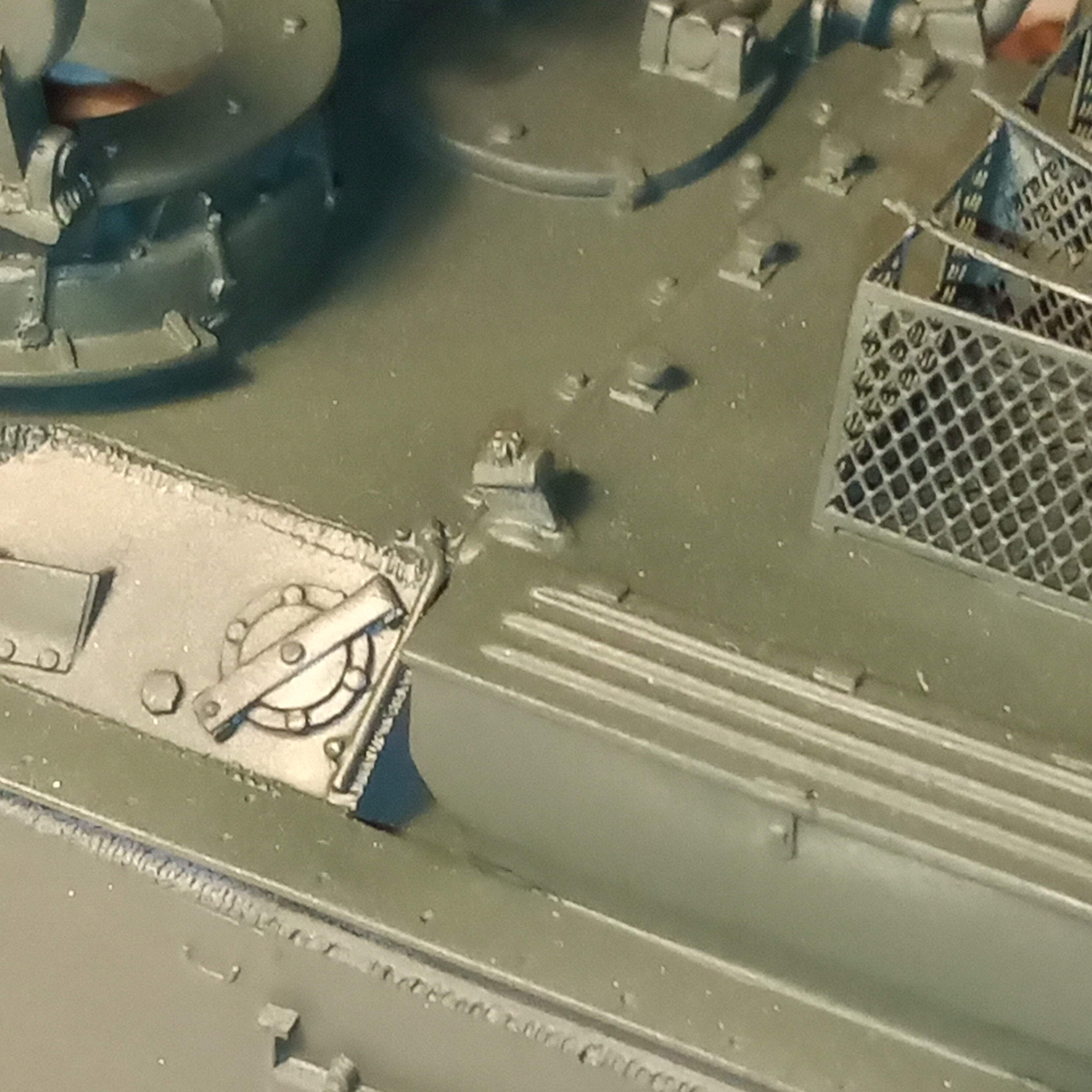

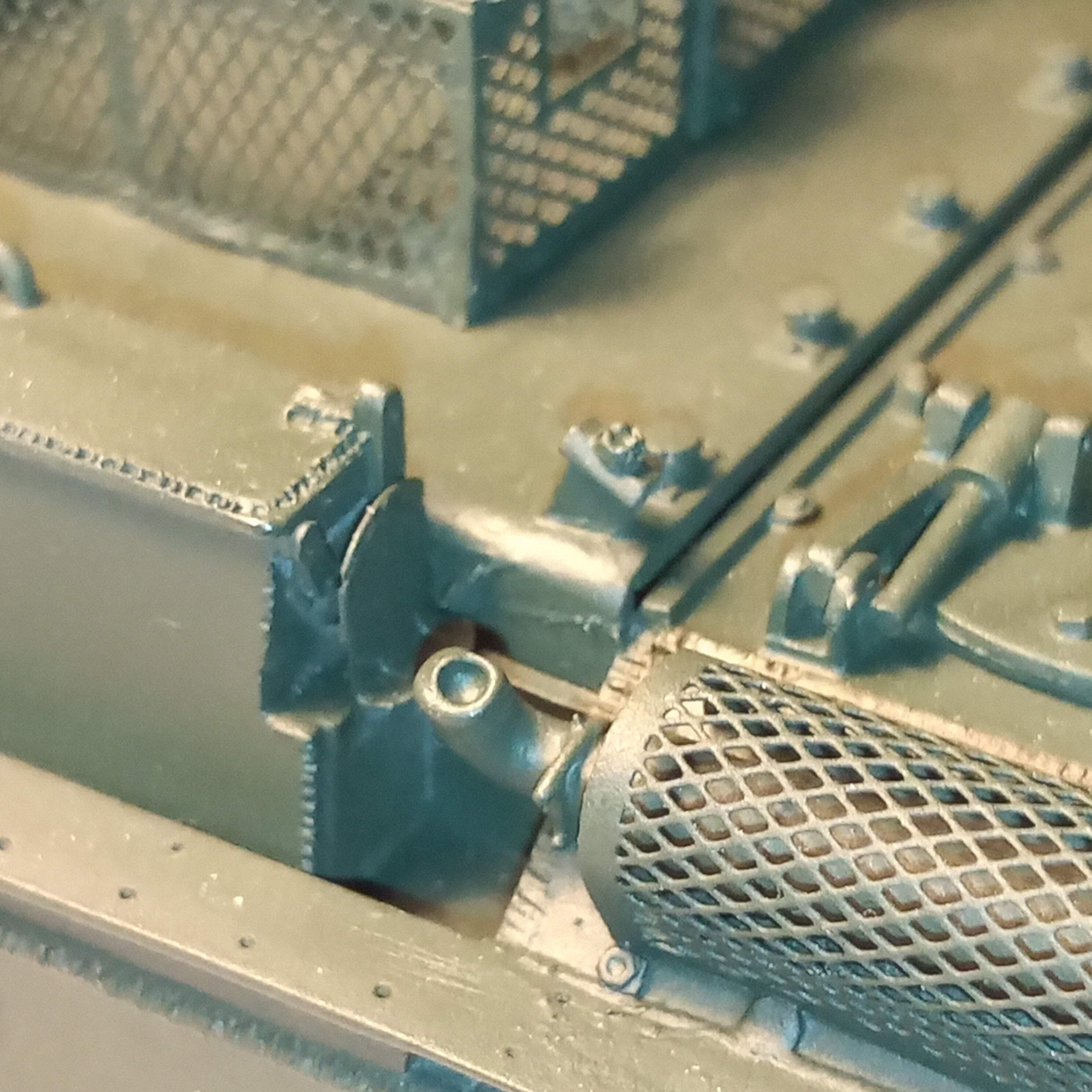

A couple of the little bits I like… It may not seem like much but I do love the little SAG mounts. Especially this one as it had broken off when I got the kit.
Also the heat shield mounted on the front of the air bottle bin… If I hadn’t of added it… It would of bugged me lol

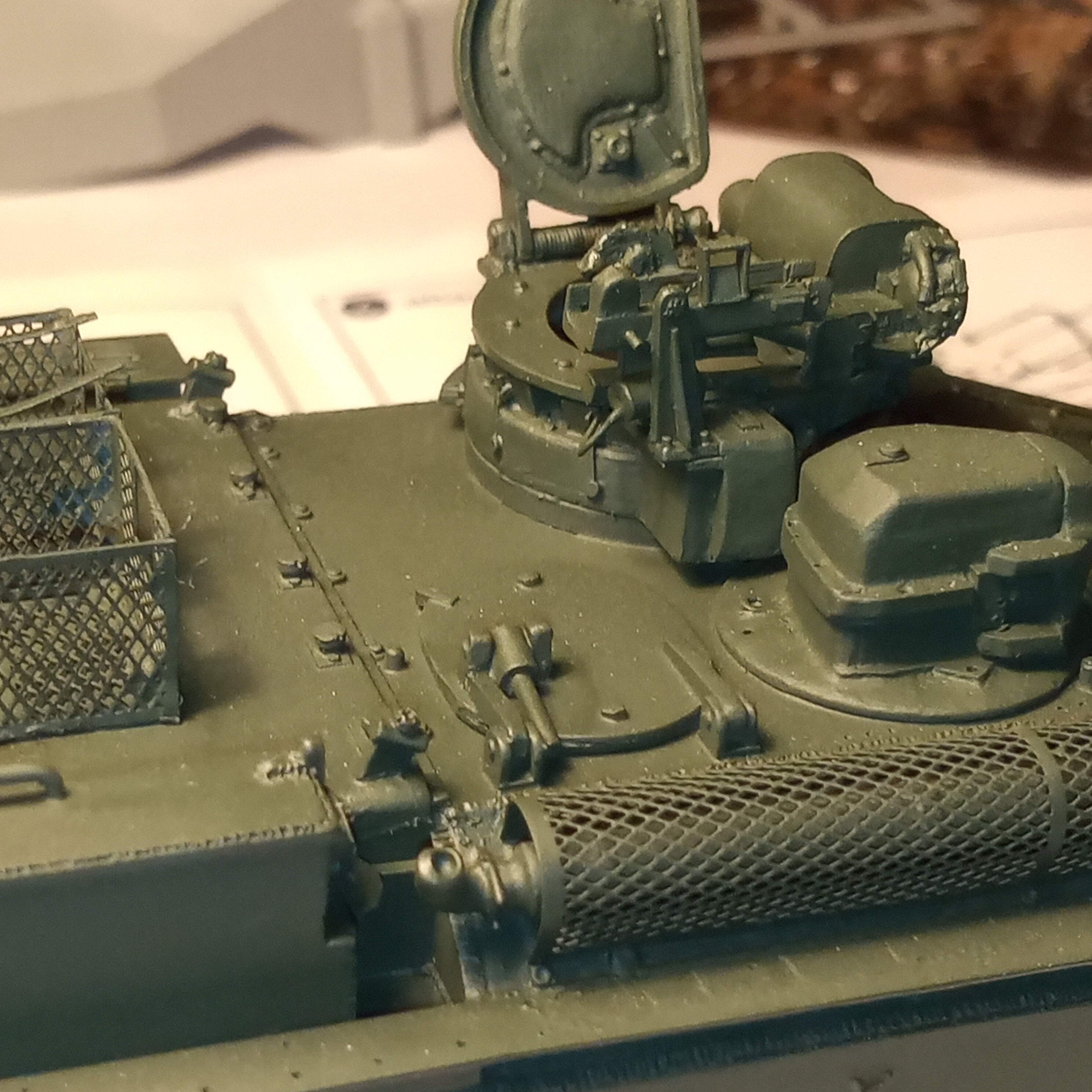

And close up of the top of the hull/cupola

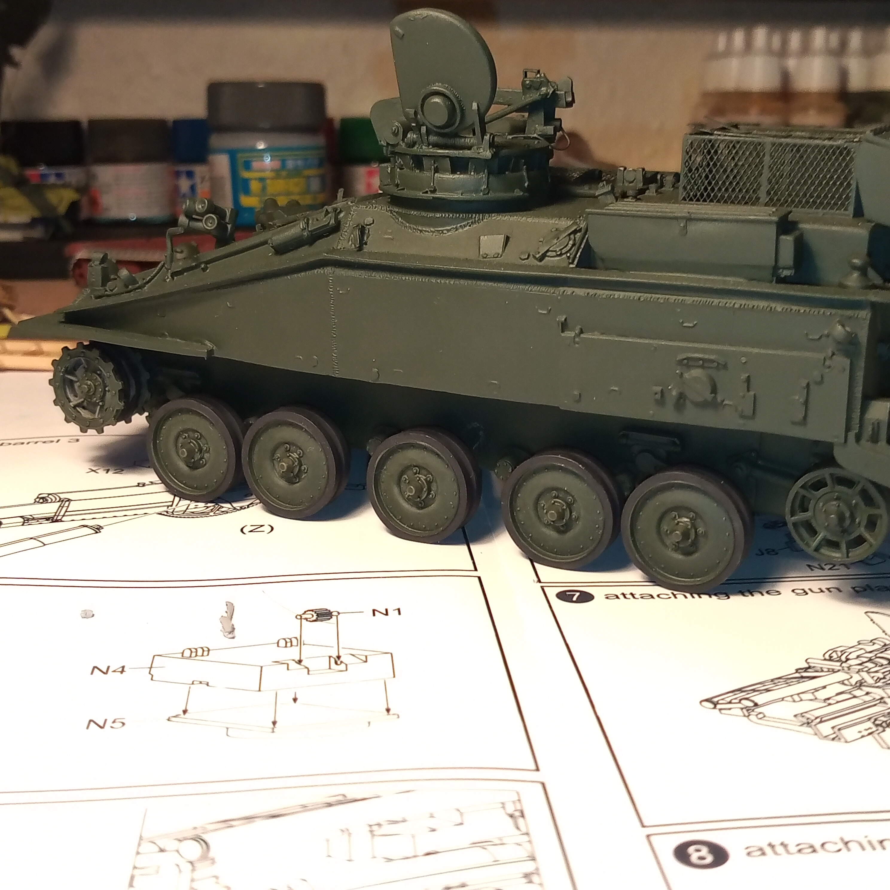

I have also got all the wheels on now, however I have noticed that some touch up paint is required in a few areas, so will do that tomorrow.

It’s looking really good there Johnny, the small details make all the difference. As you say the folks who haven’t crewed them wouldn’t know but it would bug the rest of us. Look forward to seeing the detail painting.
Looking really great John!
Great details. The only good detail coverage I’ve found is of the Belgian Striker and it’s a little bit different. What is SAG?
Thanks guys @SSGToms , @Maximus8425 , @petbat & @ptruhe .
Paul, the SAG is the sight Alignment Gauge, with the launch bin raised and the SAG fitted it basically allows you level and as the name says, align the remote sighting and firing unit to the main firing system so you can fire the missiles with the vehicle in complete cover from view.
