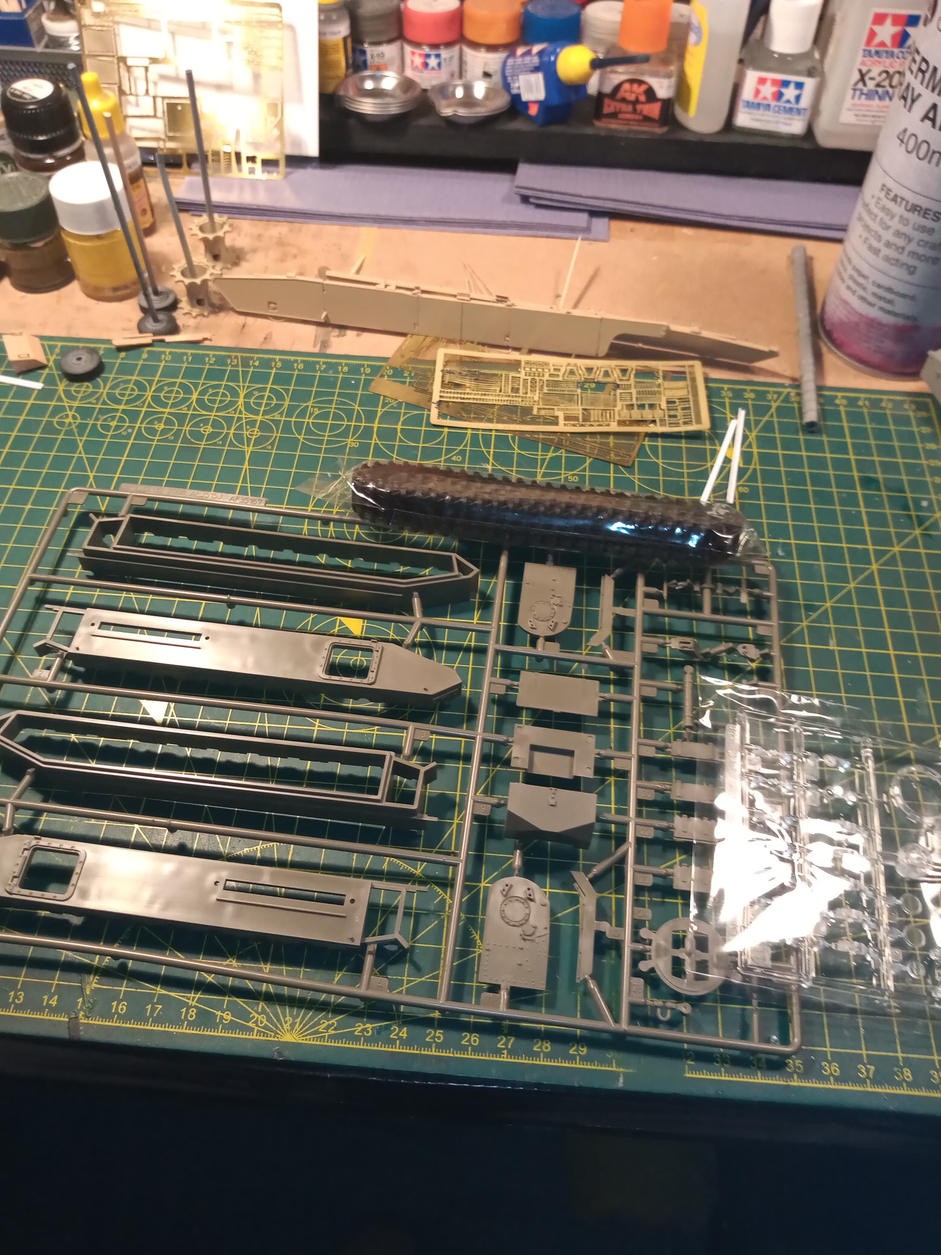

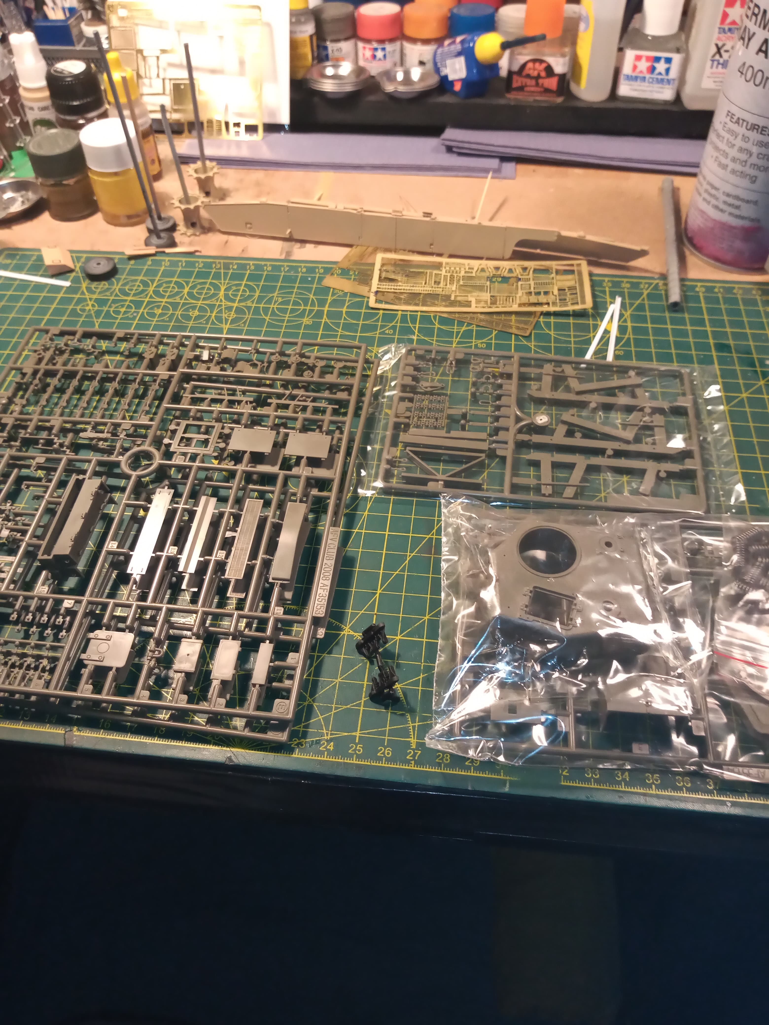

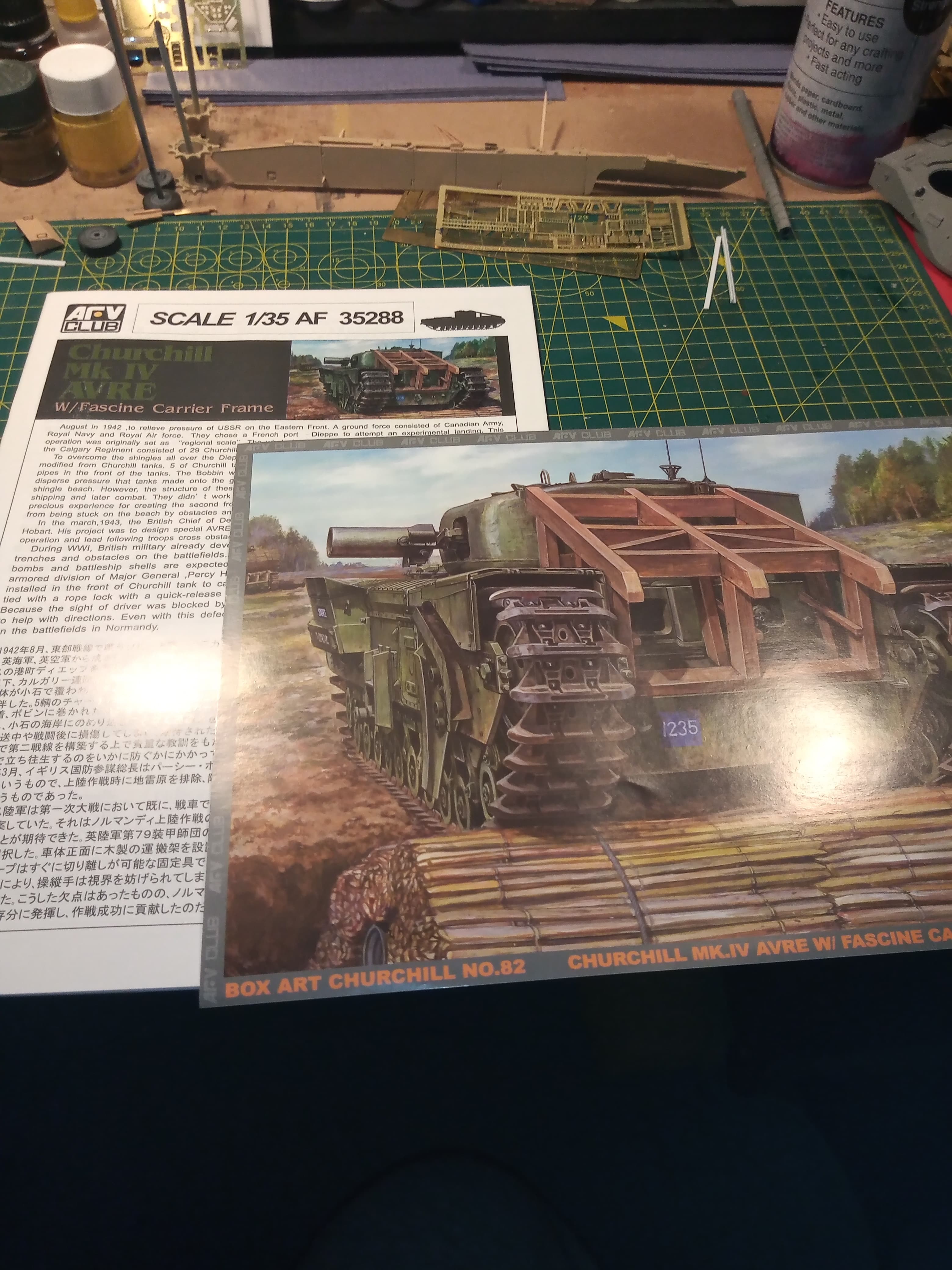

Although I won’t be starting yet, I can reshow what I will be building to start with…
AFV Club Churchill Mk IV AVRE with fascine.
Box
Instructions and printed image
Various sprues
Normal clear sprue, PE fret, vinyl tracks, turret looks nice, and the fascine carrier looks ok with some wood grain texture … Might consider making a really wood one as I can use the kit as a template…will look into that… And I have a plan for the fascine.

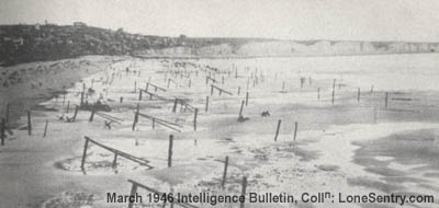

No, I believe that Ron is correct, they were not meant to block the landing craft, but tip them over in the higher tides.
Rommels Asparagus
vrfig5_rommels_asparagus_atlantic_wall
440px-Bundesarchiv_Bild_101I-719-0243-33,_Atlantikwall,_Inspektion_Erwin_Rommel_mit_Offizieren-1809370332
Thank you! So I did do my homework all those years ago. :wink:

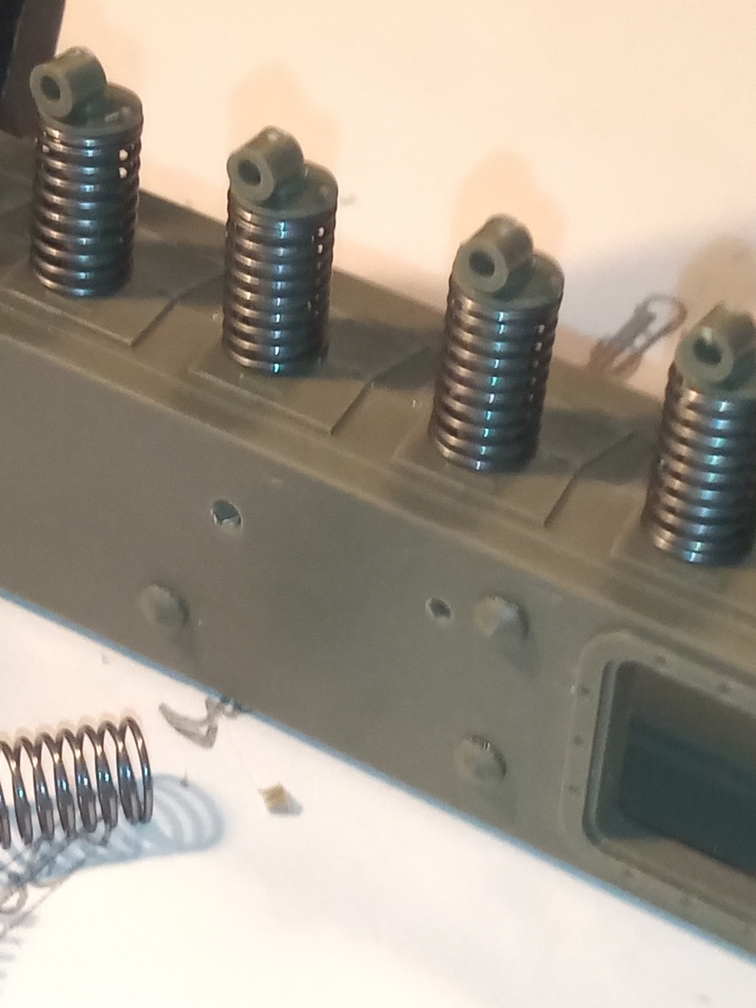

Started off on the running gear housings. They consist of the metal springs over plastic struts with moulded on inner springs …
Not really sure about the springs needing to be metal… Not something that floats my boat, but that’s the only option so hey ho.
It did all go together nice and easy with practically no clean up needed.
Will get the other done tomorrow and see how far I can get… This will hopefully be a nice easy OOB build, only major add on will be the fascine that needs to be made, which I have a plan for :+1:
On the plus side metal springs can be made to scale more easily than plastic, don’t have seam lines to clean up, and are already a metal color.
They just have to be weak enough to not launch parts of the kits later on.

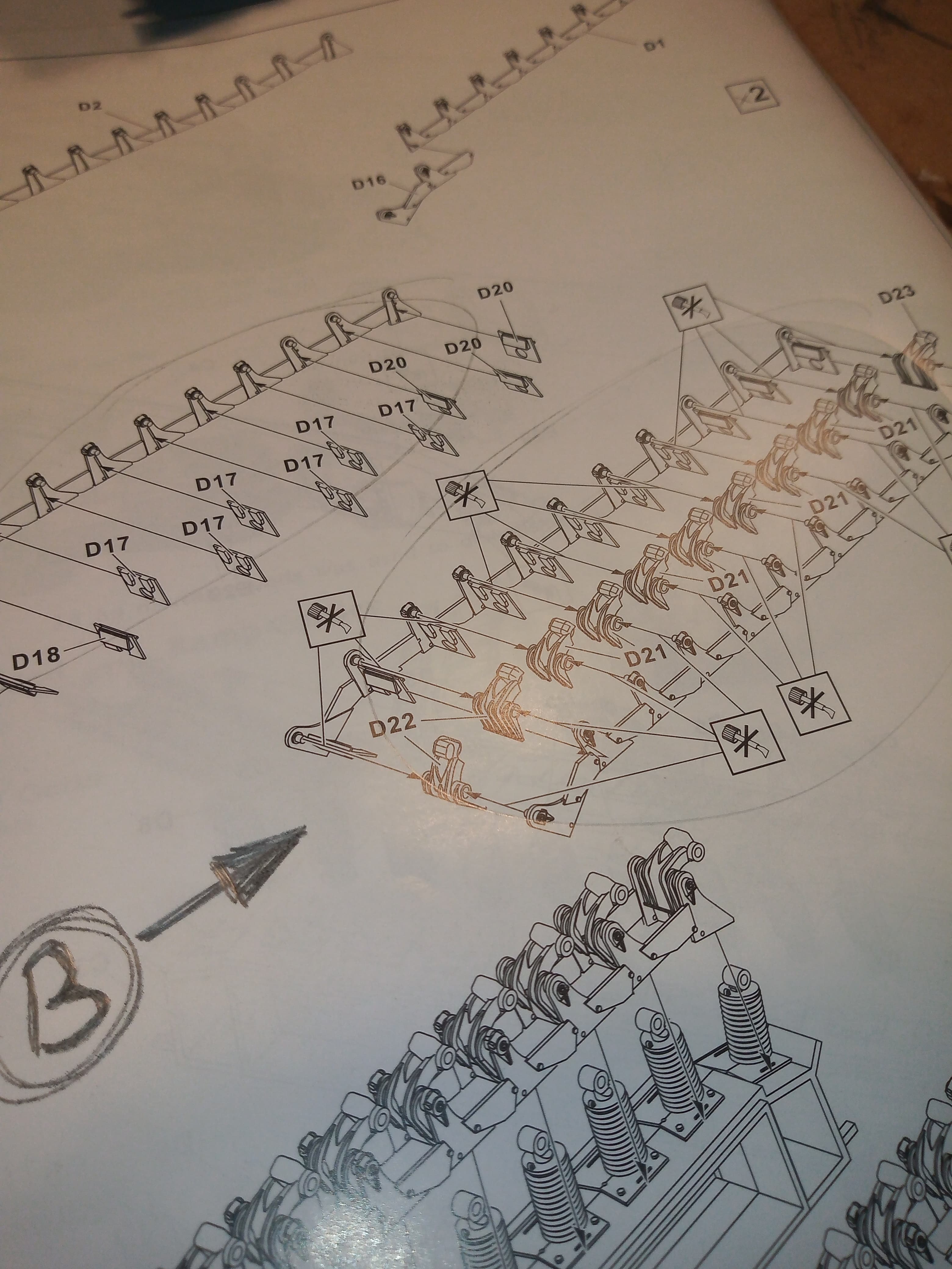

Ok, now some people may like the AFV club Churchill, but to me it’s horrible … Well the last 2.5 hours have been… And I only got one side partially done…

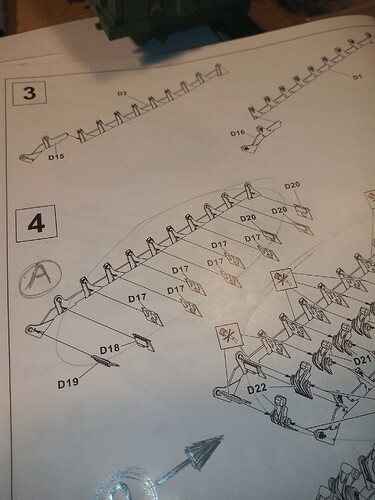

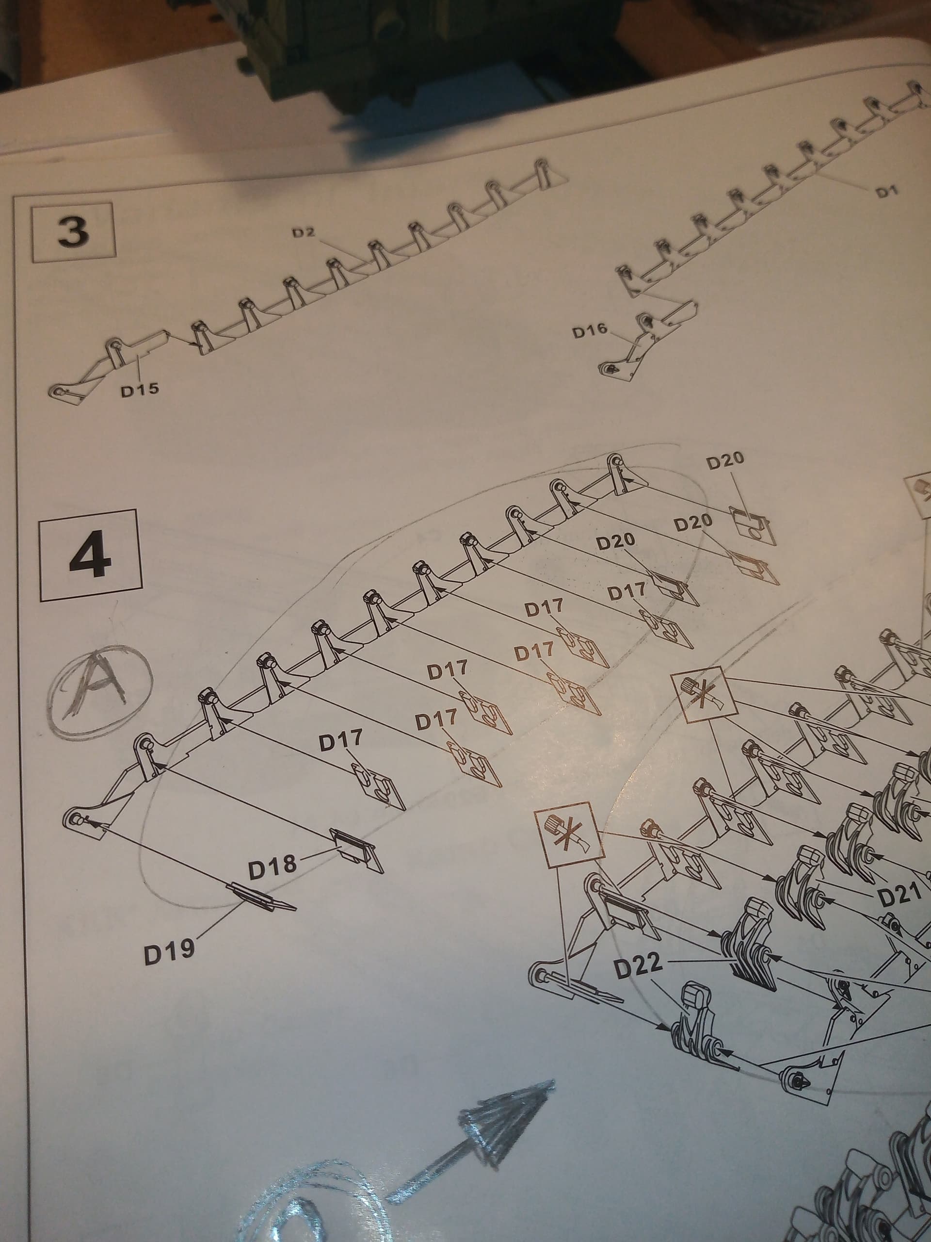

The pain really starts in section 4. Adding dividing slats between D1 & D2. We’ll call this 4a which wasn’t to bad …
The real real pain starts at 4b…
You have to get D22, 21 & 23 inserted above the dividers, between the sides D1 and D2 … The holes in them allow them to flop around, so it’s impossible to fit D21-23 above the dividers and then join the other side… Everything moves to much … This was so frustrating… And I almost 1. Binned the entire build, or 2. Shelved it and built something else…
In the end I had to do one insertion at a time, which took ages… Mate the holes up , get the dividers lined up, liquid glue and force apart , insert the wheel holding bit, and push back together quick, then rinse and repeat… Soul destroying…

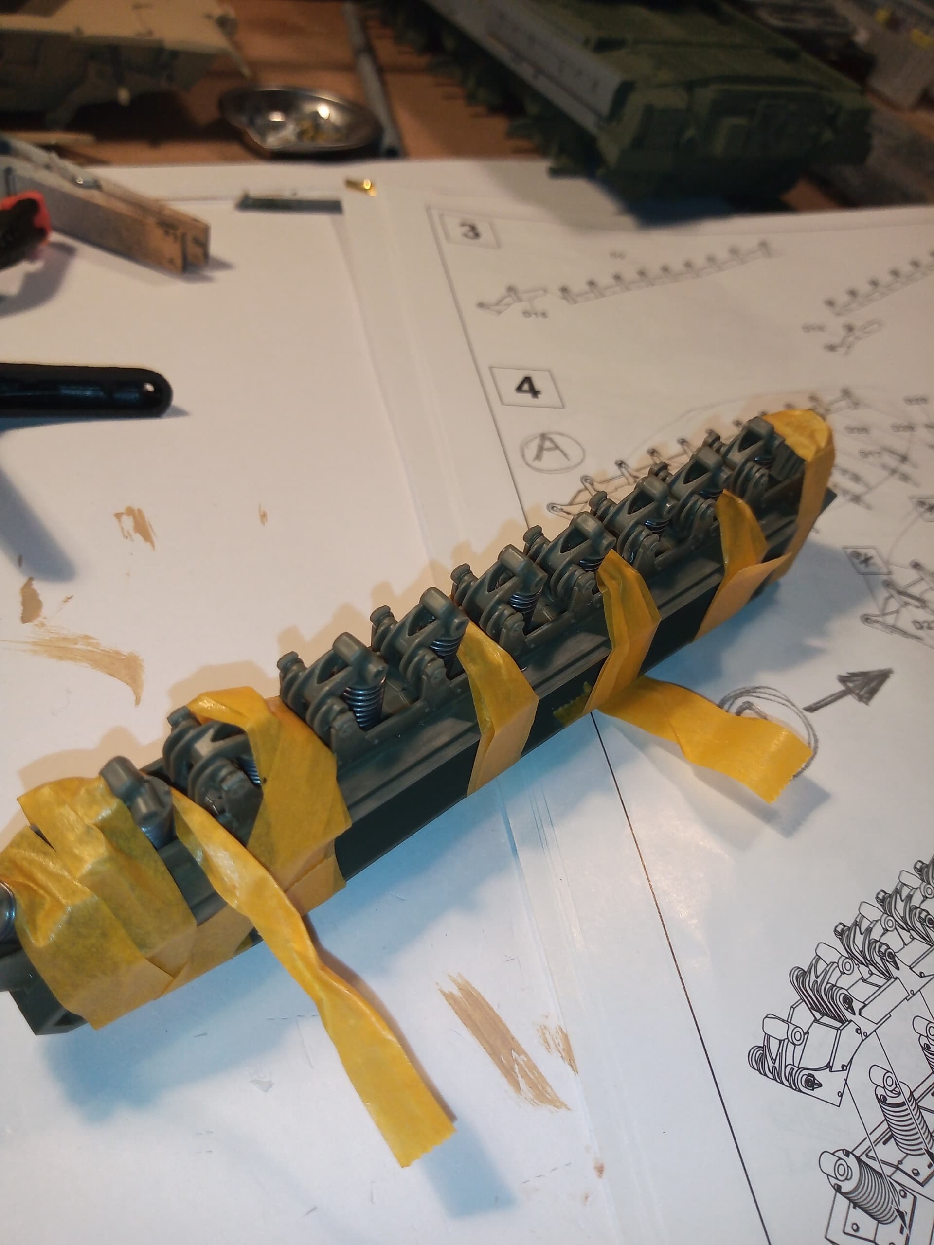

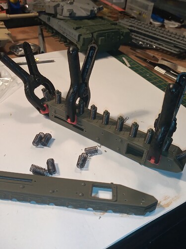

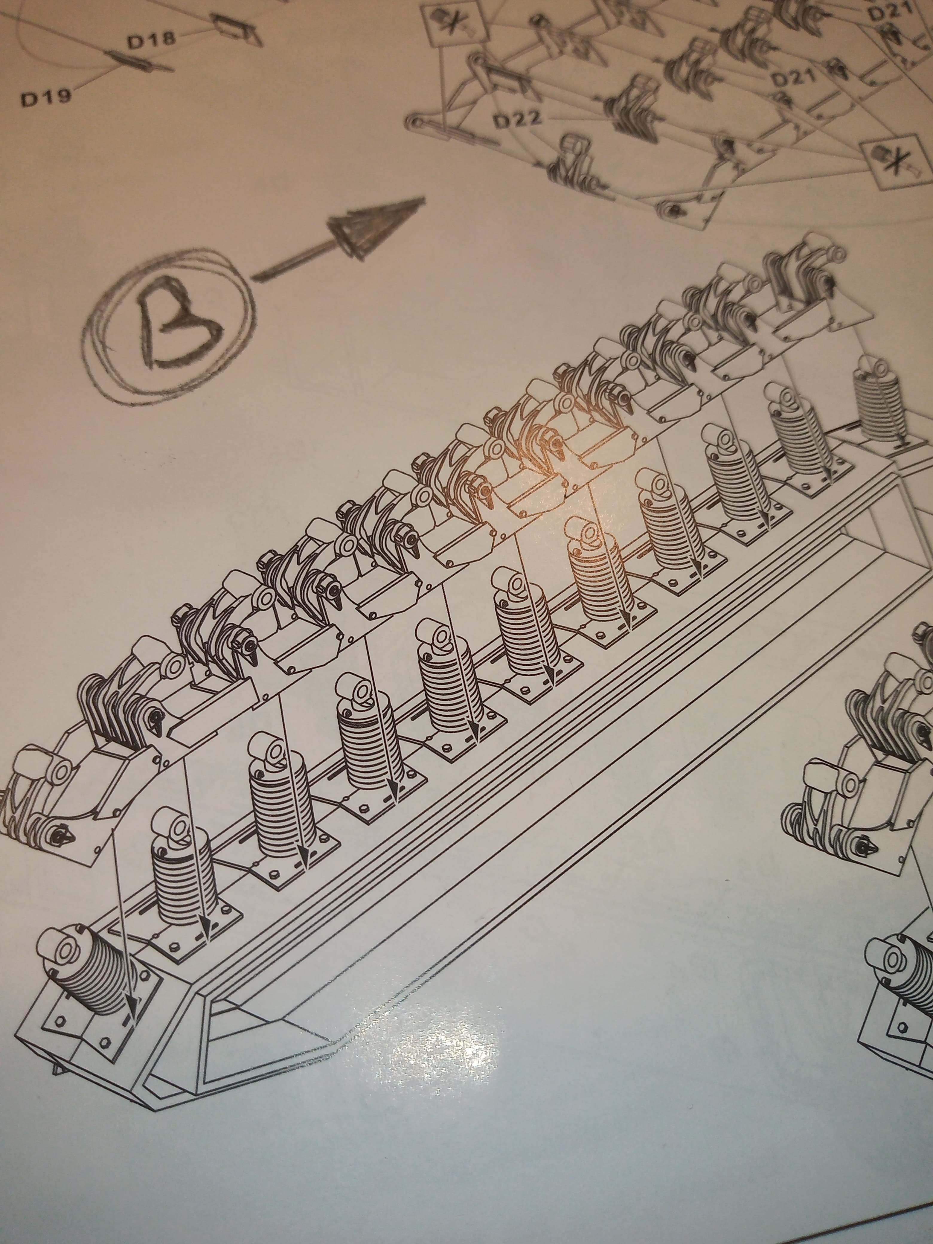

Now for even more pain and tears… Once you have done all that, you then have to get that section fitted to the spring section that’s already been built.
Springs … What happens to a spring when you compress it … Yeah, it wants to get back to it’s original shape immediately…
So when you try and get the top piece on and pushed down to mate up with the spring section, the springs which you have just slightly forced down want to reassert themselves straight away … And bear in mind this is happening on all 11 stations …so the glue never gets a second to even begin to set.
So I had to start at the rear station, join the 2 parts together with tape, then apply glue externally…
Then a station towards the middle, same process, then the front station and then all the rest individually…
Complete and utter PITA… No joy at all, and I still have to do the other side.
All that work (2.5 hrs to do) and this is where it’s at …
