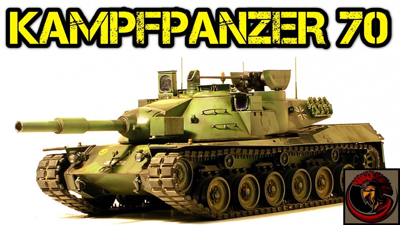

Hi Johnny, so many questions, take a look at this informative documentary. This guy tells the story way better than I could.
edit to add, many thanks Boots DMS
