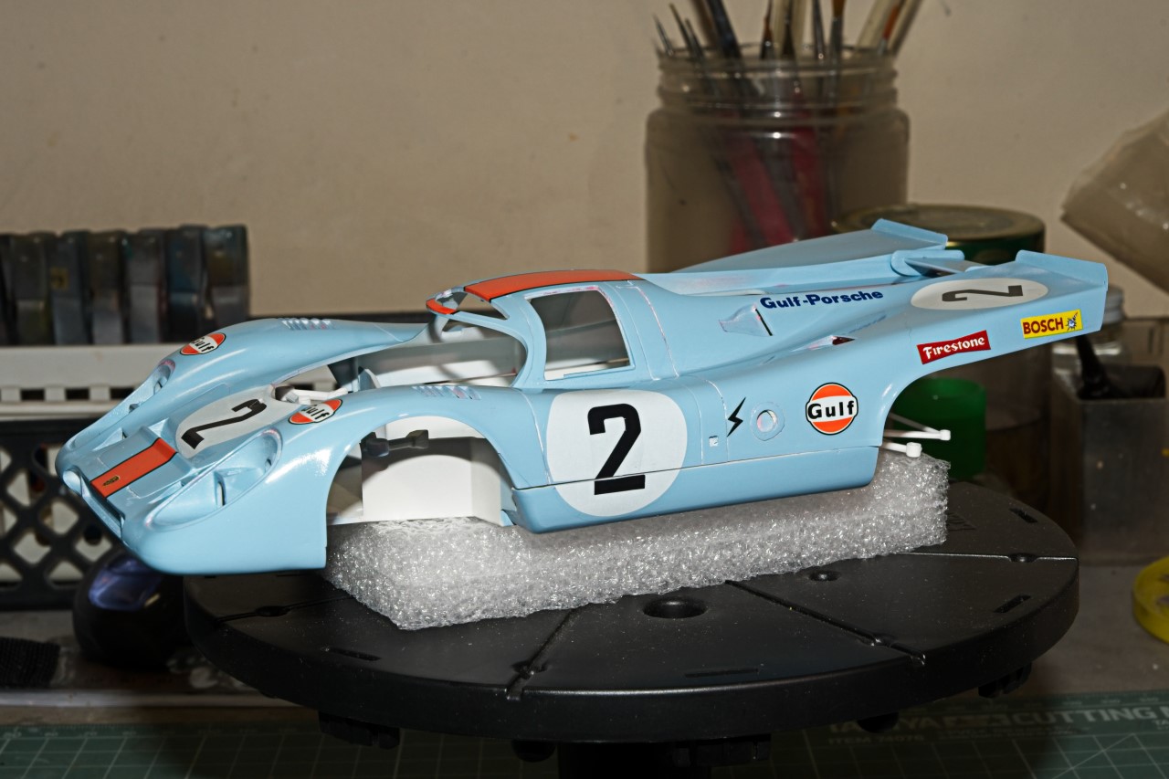

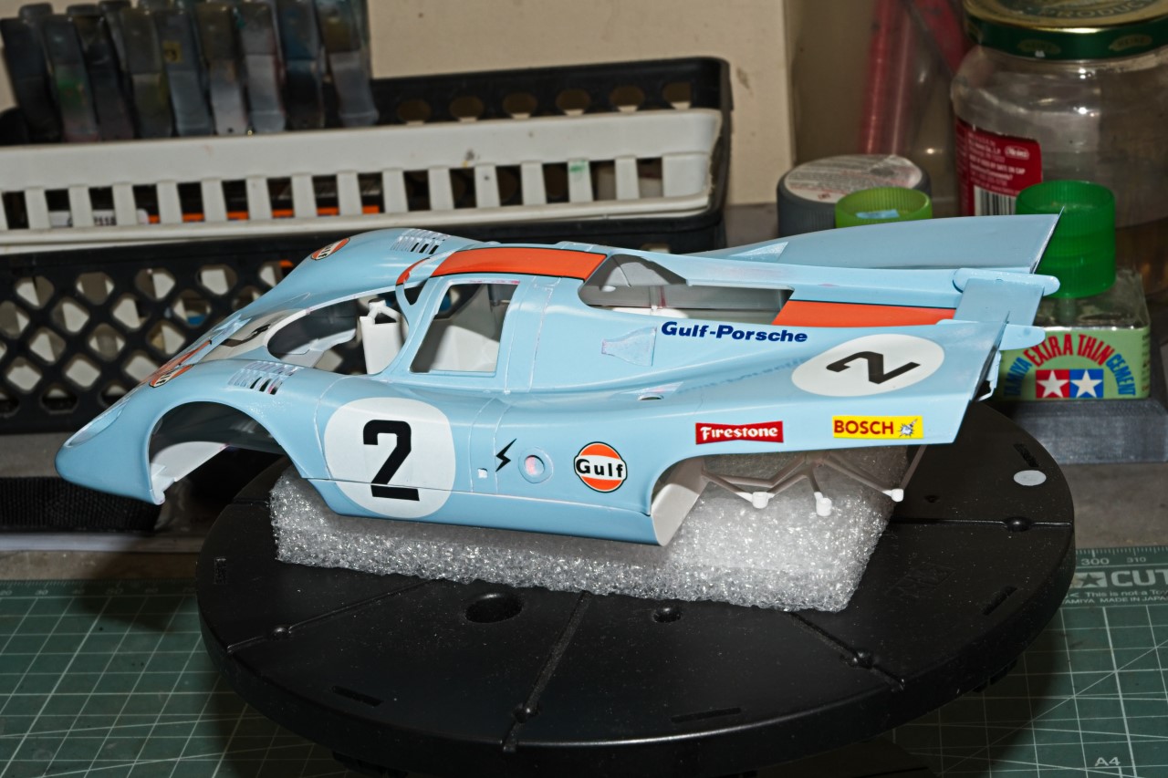

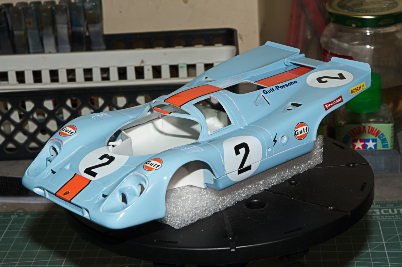

Well, I finished up the decaling of the numbers, gloss coated the two body shell sections with my now new favorite: Tamiya Lacquer LP-9 Clear Gloss. I’m still looking for a supplier of Gunze
Super Gloss III in a bottle and Finisher’s, neither of which I’ve ever been able to get a hold of. But the Tamiya LP-9 is the best I’ve tried to date. Gave the lacquer a full week to dry and cure, then just a very lite wet polishing with Micro Mesh 12,000, followed by the Gravity 3 part polishing paste system, and finally their excellent liquid wax. One more coat of wax will be applied once the build is at its final stage. As you can see from the pictures, the two shells still align and fit nearly perfectly. No major twist/warp issues this time.
Next up is the cockpit.
Thanks to all for stopping by and checking out the 917K’s progress to date. As always it’s greatly appreciated.
joel
