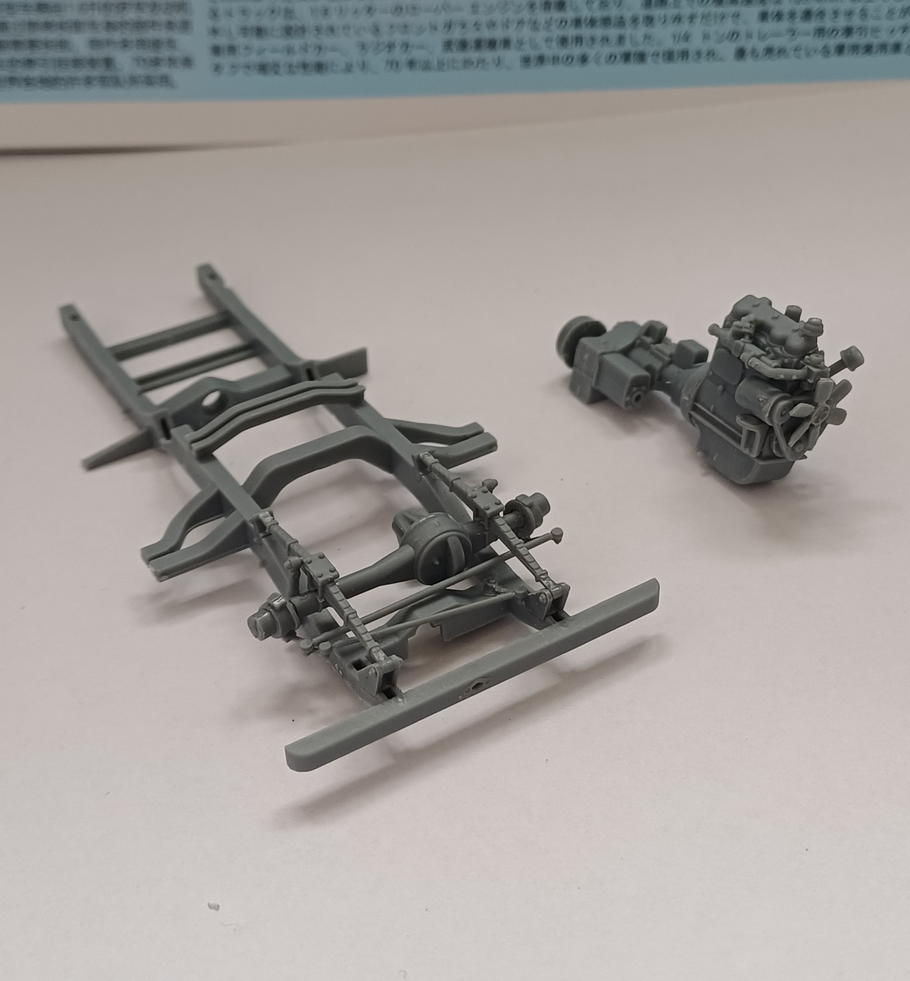

Chassis started with the front axle and leaf springs being built and fitted. Although the kit has moveable front wheel bearings the rest of the parts are not workable and so you basically decide which direction you want the wheels to point and by how much and then glue the parts in. I would imagine it would be possible to make it workable but for me the effort would outweigh the results.

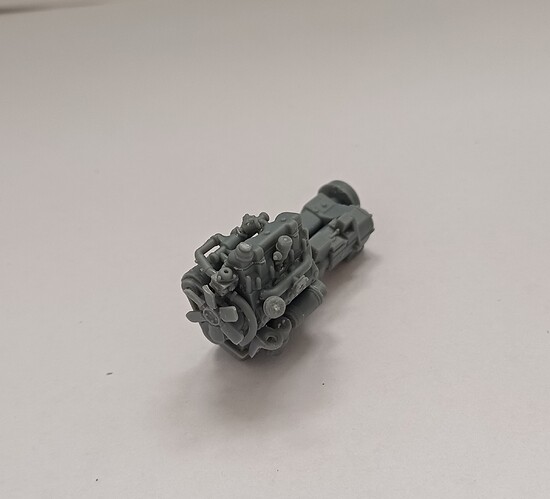

Then did the engine and transmission and to be honest it’s a lovely little kit in itself. As I said there is scope for extra detailing on the engine itself with wiring from the distributor to the plugs and pipe work to the oil filter etc. Apart from the battery and air cleaner there is very little other detail in the engine bay which is a shame as the fuel pump, fuel filter, coil and associated pipes and wires are all very prominent. Something to add later if I feel like it. I’ll also have to look into engine block colour as I’ve seen dark grey, light grey, deep bronze green and eau de nile versions. If anyone has any info on that I would gratefully accept it.

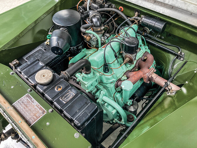

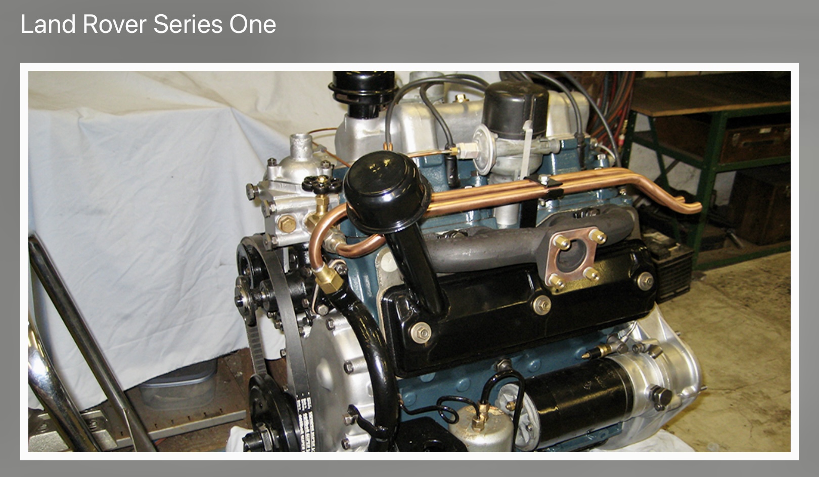

After having checked some references it would appear that the kit is a bit of a mish mash. It has behind grill headlights which were superseded by the protruding lights in 1950 but the engine depicts a 1952 onwards 2 litre unit and not a 1.6 litre. It’s an easy fix in that the rocker cover breather needs to be removed and the oil filler pipe with its breather needs changing for a vertical pipe with a simple screw on cap. There are other small things but they’re not really noticeable. You can see what I mean in the pictures below. Now I’ll never say there wasn’t a wagon with behind grill lights and a 2 litre engine but I personally very much doubt it.

Another issue I have found is with the chassis. It would seem that Gecko have aimed off at possibly reusing molds. The straight outriggers are found on 80 inch chassis while the curved ones are found on 86 & 88 inch chassis. I can’t find anything which says a chassis would have both but I’ll keep looking. Once I know they’re both not needed to secure bodywork etc. I might cut the curved outriggers off, then again if they’re not seen I might not.

This matches the Gecko engine ?

Yes that’s a 2 litre engine, which is what is in the kit. As it’s an early production version with behind grill headlights it should be a 1. 6litre

Chassis is indeed an 88/86 chassis it scales out as an 80 but the bent outriggers are for a later and longer Land Rover .
The engine is not an early Land Rover engine..the sump is wrong as well as various parts of the engine .the engine supplied in the kit is lovely but the later Siamese bore version
Engine colour boring bit the engine colours were painted the same as the vehicles initially..same a the chassis which were painted the same as the body .

Early engines were green then blue grey then light grey
Chassis started as silver along with fuel tanks then they were painted the same colour as the vehicle and eventually black
Morning Barny, I was putting the cab together last night and noticed the overdrive callout in the instructions and did think why one would be fitted bearing in mind what they’re for. A little bit of digging and sure enough they weren’t fitted to military vehicles and were an option on civi variants. Looking at engine colours I came across Land Rover Engine Blue so might go down that route but didn’t know about the sump differences. I don’t think I will interfere with that as it is out of the way but you just have to do the rear dampers, would it even fit correctly if you didn’t? I unfortunately snapped the range transfer lever off so will have to sort that. Probably use the overdrive lever, at least then there’s a use for it. Parts are just dry fit at this point as I will put it all together as assemblies after painting.
