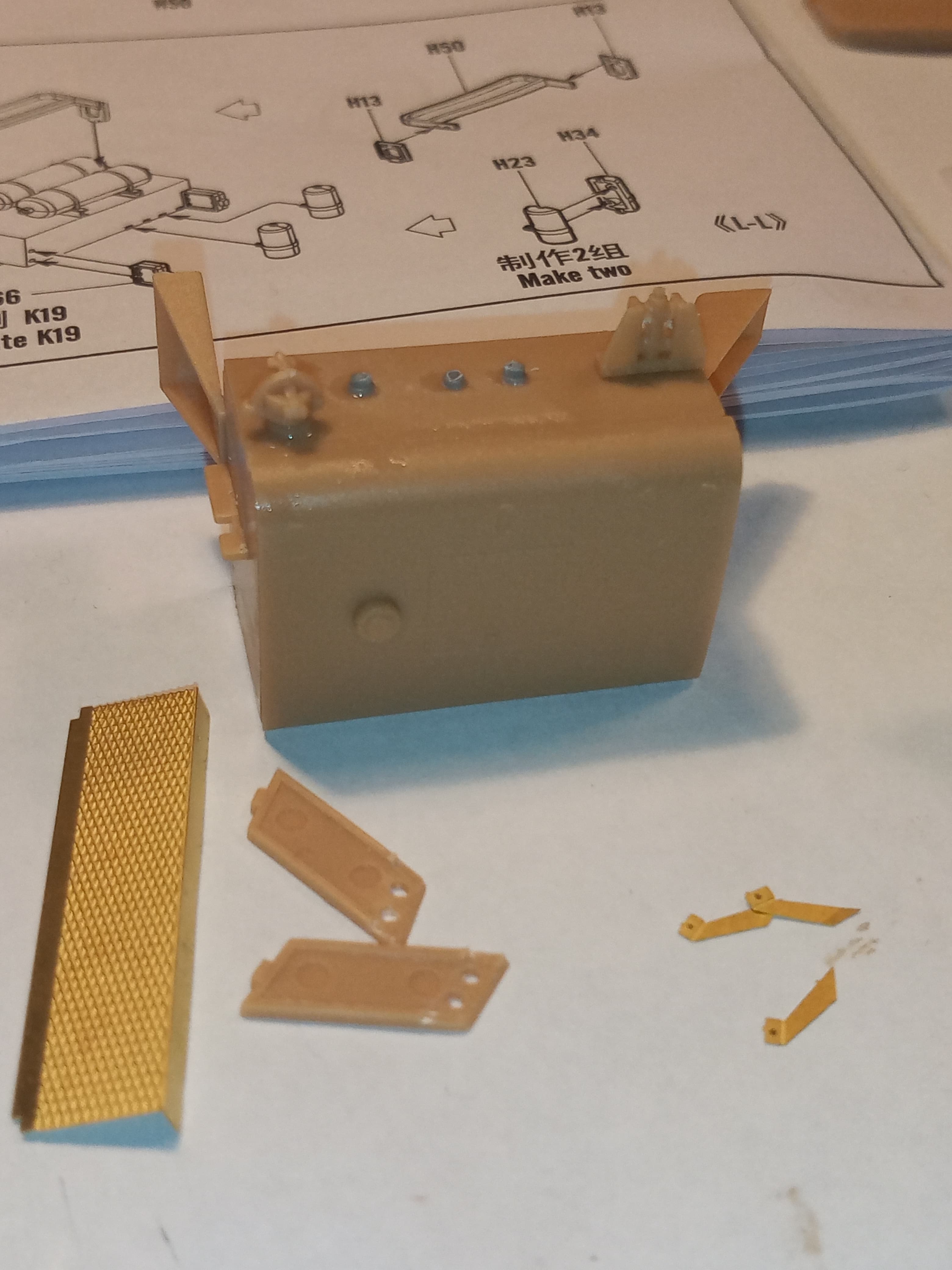

More pipework and cables in bound … Namely both fuel tanks and an air tank mounting box.
The before shot …
The left and right hand fuel tanks both differ slightly, although the instructions would have you make them identical.
The right hand tank.
After the fuel filler, you have 3 fuel ports, 1st has a transfer pipe from the left hand tank, and the next 2 go into the fuel union at the front (all holes drilled) and that has 2 further pipes coming out of it…the ports are MENG bolt heads drilled out.
Left hand tank.
On the this one, the filler is towards the front, then the next 2 ports have pipes that go in towards the engine area. The rear port has the transfer pipe across to the RH tank.
This does not have a fuel union, but just a plate and 2 raised sides which I cut from spare PE strips.
Both tanks will have the PE step plates and brackets added on top and the foot step at the bottom.

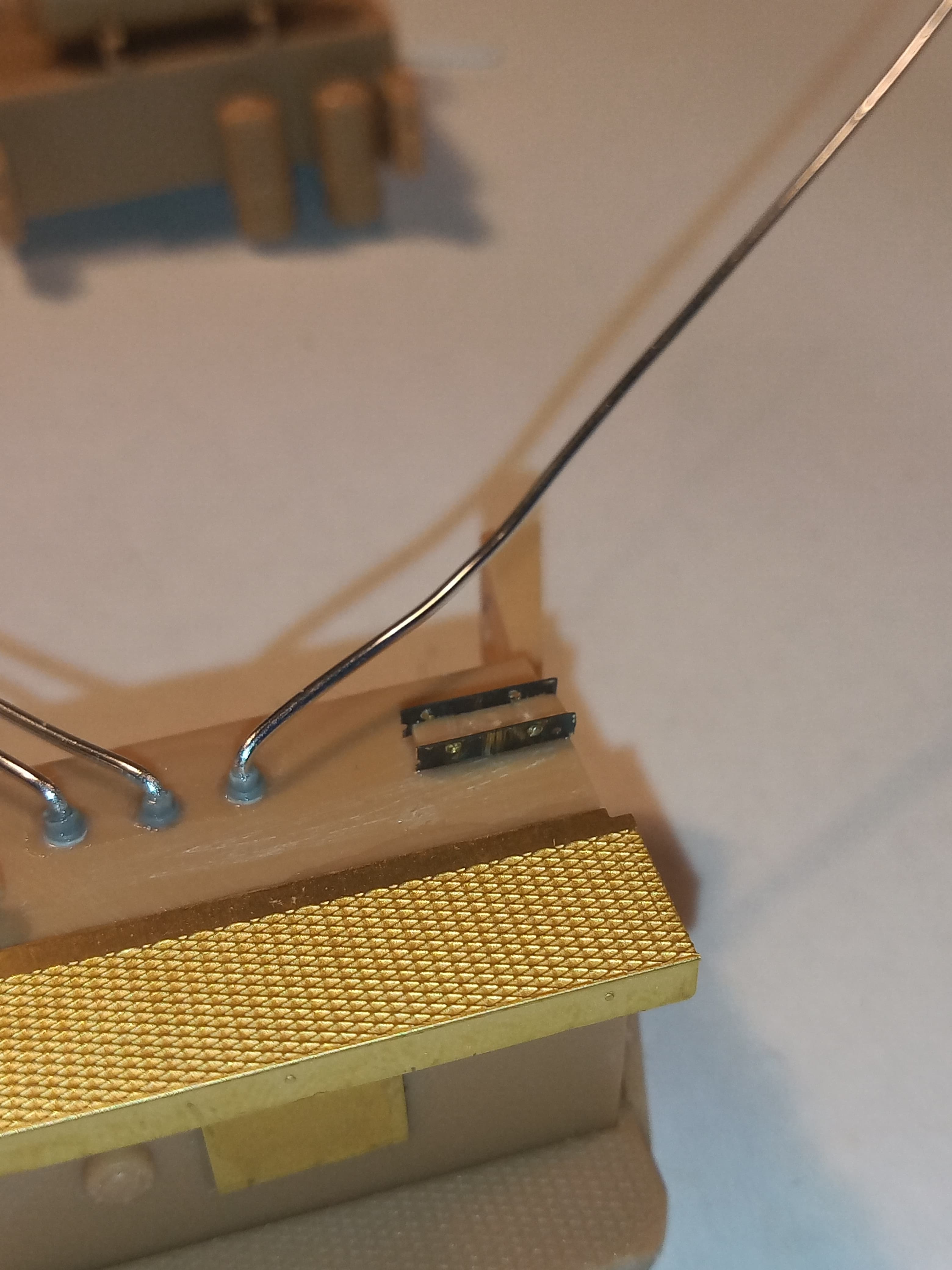

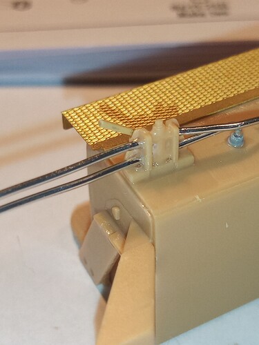

And the fuel tanks after …
RH tank.
rear pipe is the transfer pipe. Front 2 pipes go onto the union and then onto filters and engine area.
Rear of RH tank showing pipes going into the union.
And the tank change over lever … Just some bent plastic rod.
LH tank.
Front 2 pipes go to filters, rear pipe is the transfer pipe which will be cut down and hidden under the cab.
And the area where the 2 pipe union would go …
Both tanks have the PE foot boards fitted on top, and the step fitted at the bottom.

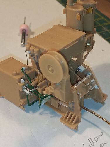

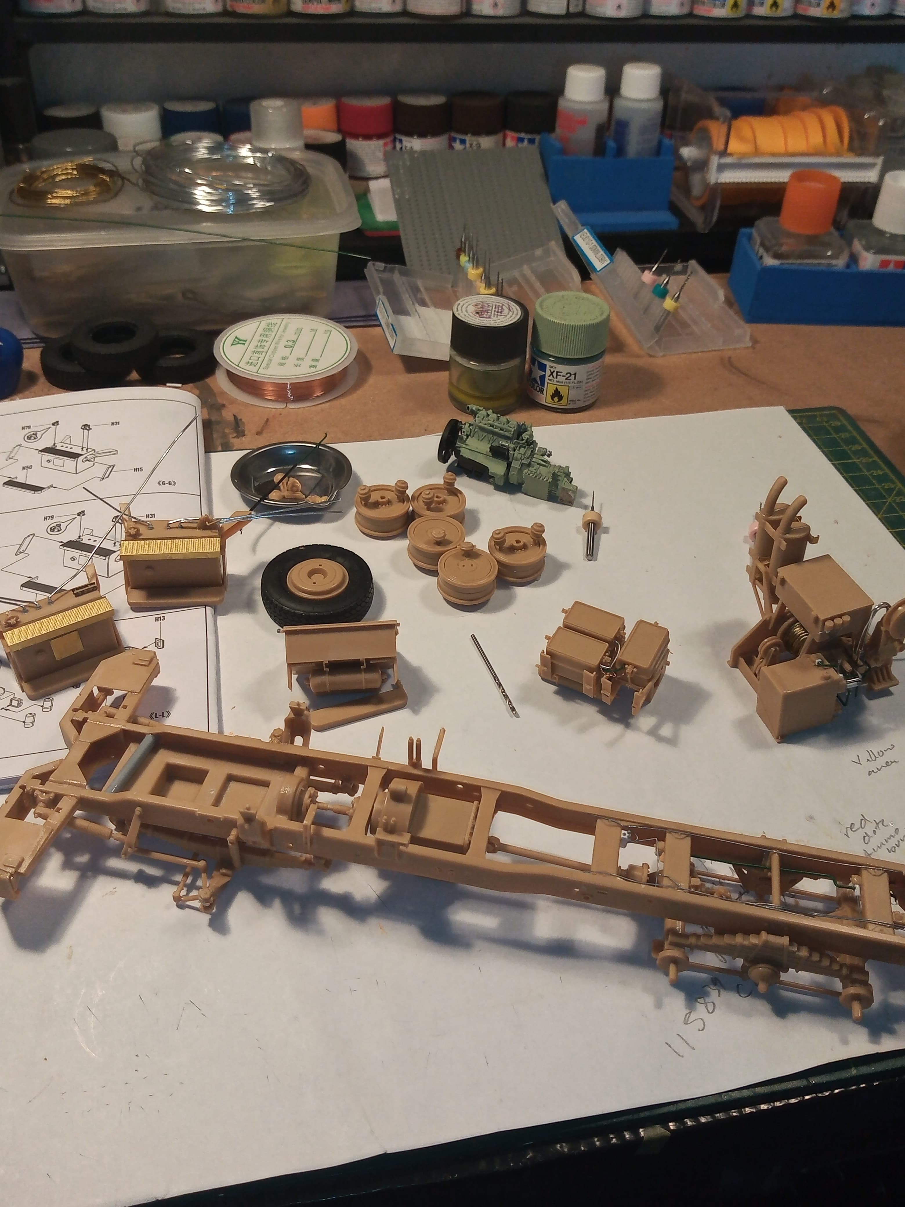

Over view of what I’ve done and where I am…
Winch housing and exhaust stacks (if it’s not sand colour plastic then it’s detail I’ve added.
Battery boxes.

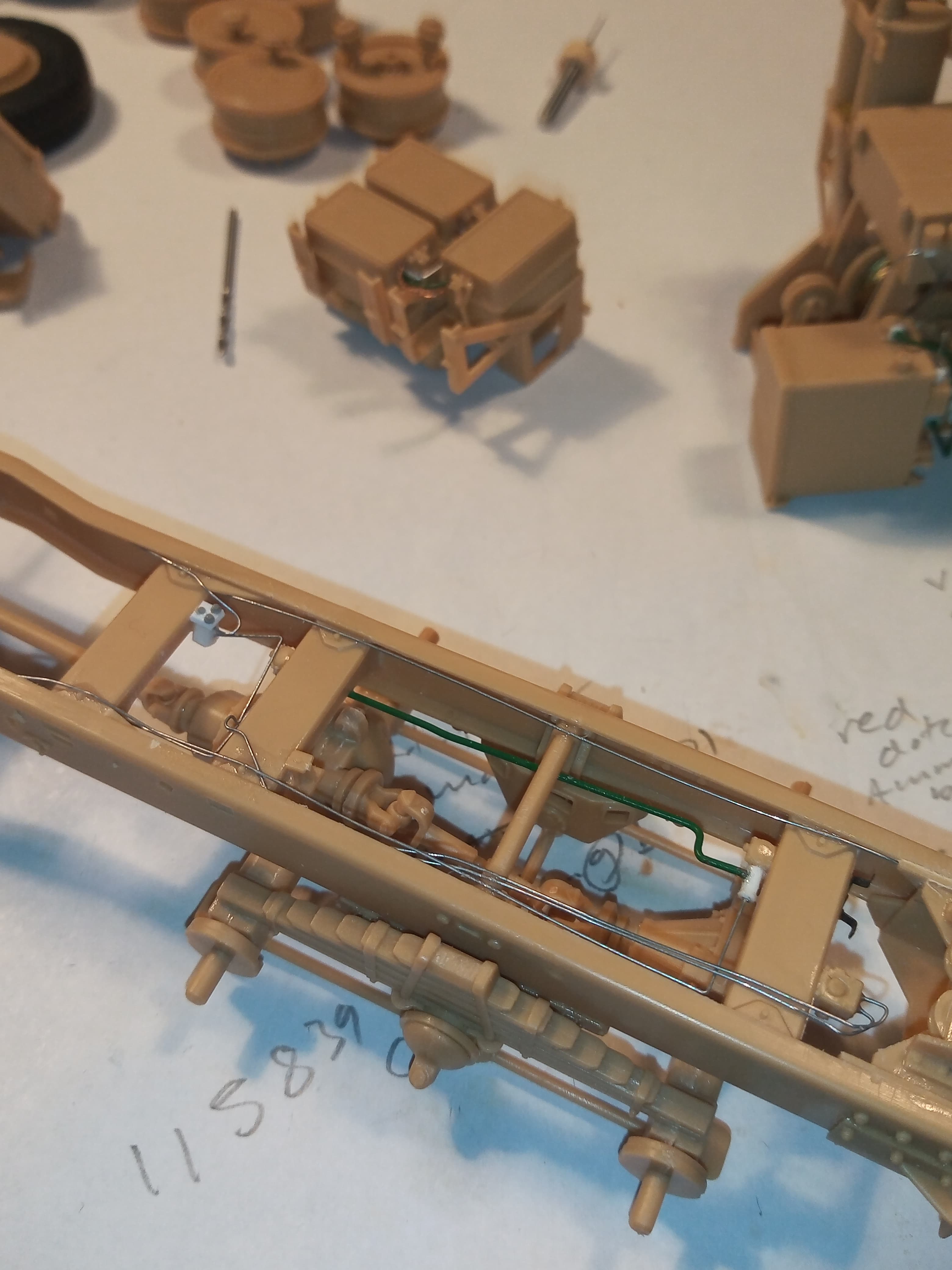

Chassis (added pipes and cables at rest) and fuel tanks
You can see there’s a lot of detail missing. Luckily I received an awful lot of walk around images not usually available from a friend here which has allowed me to go to this level.
It’s not perfect, but it’s the closest representation I can get to. And with the images available generally on line, you wouldn’t (and probably Hobby Boss either) know the detail was missing.
Onwards and upwards :+1:

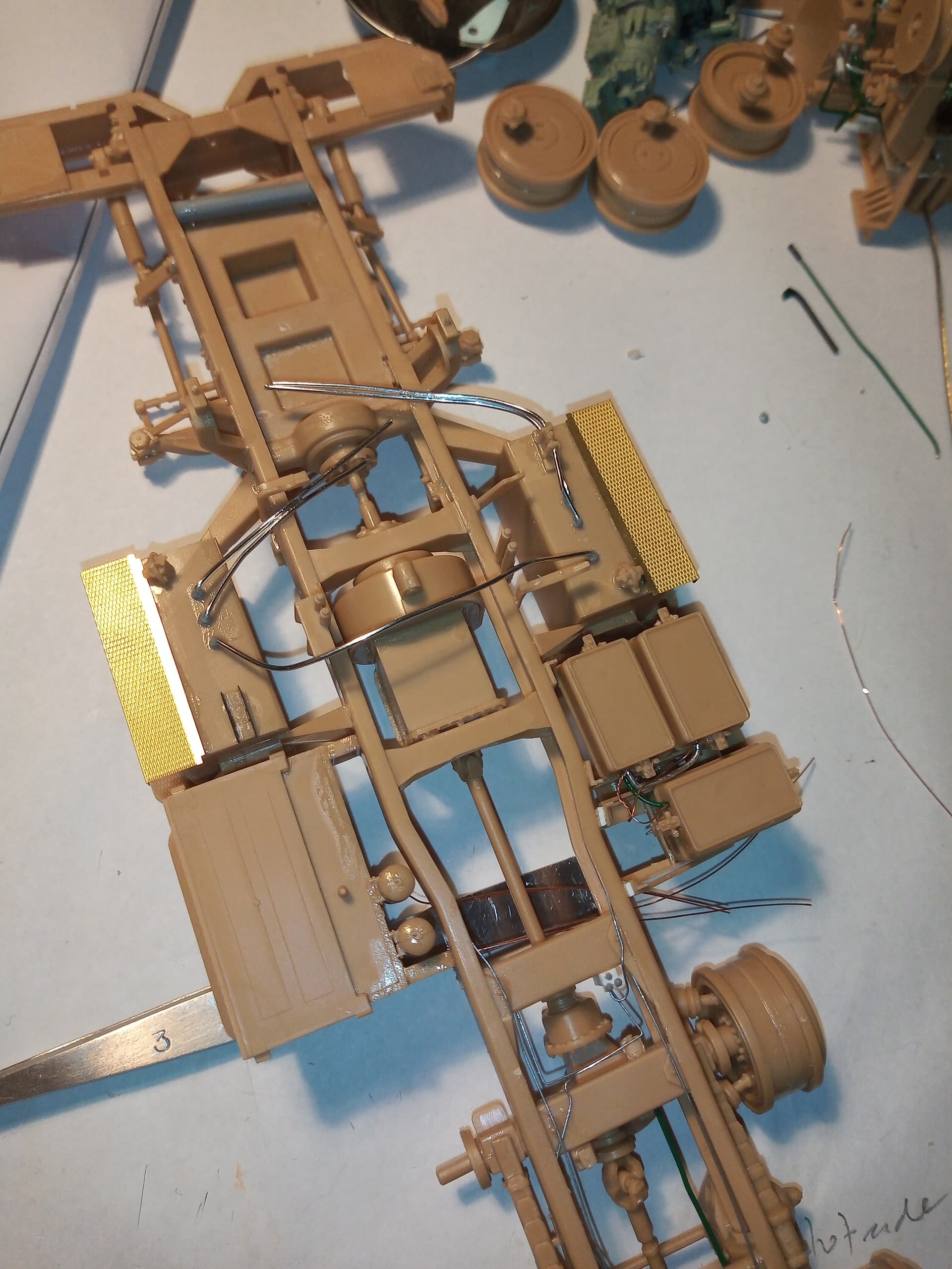

Used .3mm copper wire for the pipework on the air tanks…
All the wires will be shaped and cut to size once secured to the chassis
Point to note, the air tank box is upside down in these pics …

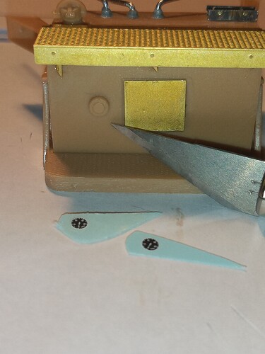

Another thing I noticed were the fuel tank side gauge’s…
No detail, just raised plastic lumps where the blade is pointing…
Was thinking of painting the details on the gauge fronts, but I looked through some old decals and found the 2 dial decals (I think they are from the Tamiya king tiger Ardennes set) which I’m going to use with some clear varnish dripped on top…
Beginning to get the built sub assemblies onto the chassis …
Both fuel tanks, the battery boxes and air tank housing.
The cables/pipes will either be cut back, or bent and hidden on the inside of the chassis overhang.
