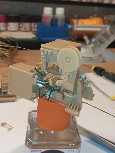

Most of the cable/ pipework is on now, and once the winch wire is set I will get the whole winch housing assembled then I will have a bit of a firmer base to work on for when I finish off the LH side, with handles, smaller cables etc …
Assembly of the winch housing is done … Still various smaller details to add …

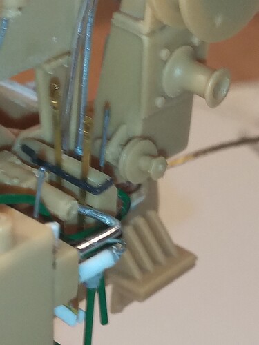

Few more bits of detailing … Added this box and bit of PE strips to the inside of the edge of the winch drum.
It’s not 100% correct for size and not exactly in the correct place (out by a few mm) but that’s down to the parts not being the correct size or lining up as per the images I have.

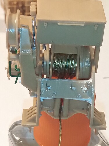

Also, added these 2 springs on the insides…
The springs are a bit over scale but it’s as close as I could get them… Made with very thin electrical copper core wire wrapped around a .4mm bit of hard wire… On the wagon I think they are some sort of self adjusting spring for a plate over the winch drum… And painted blue in my images.
