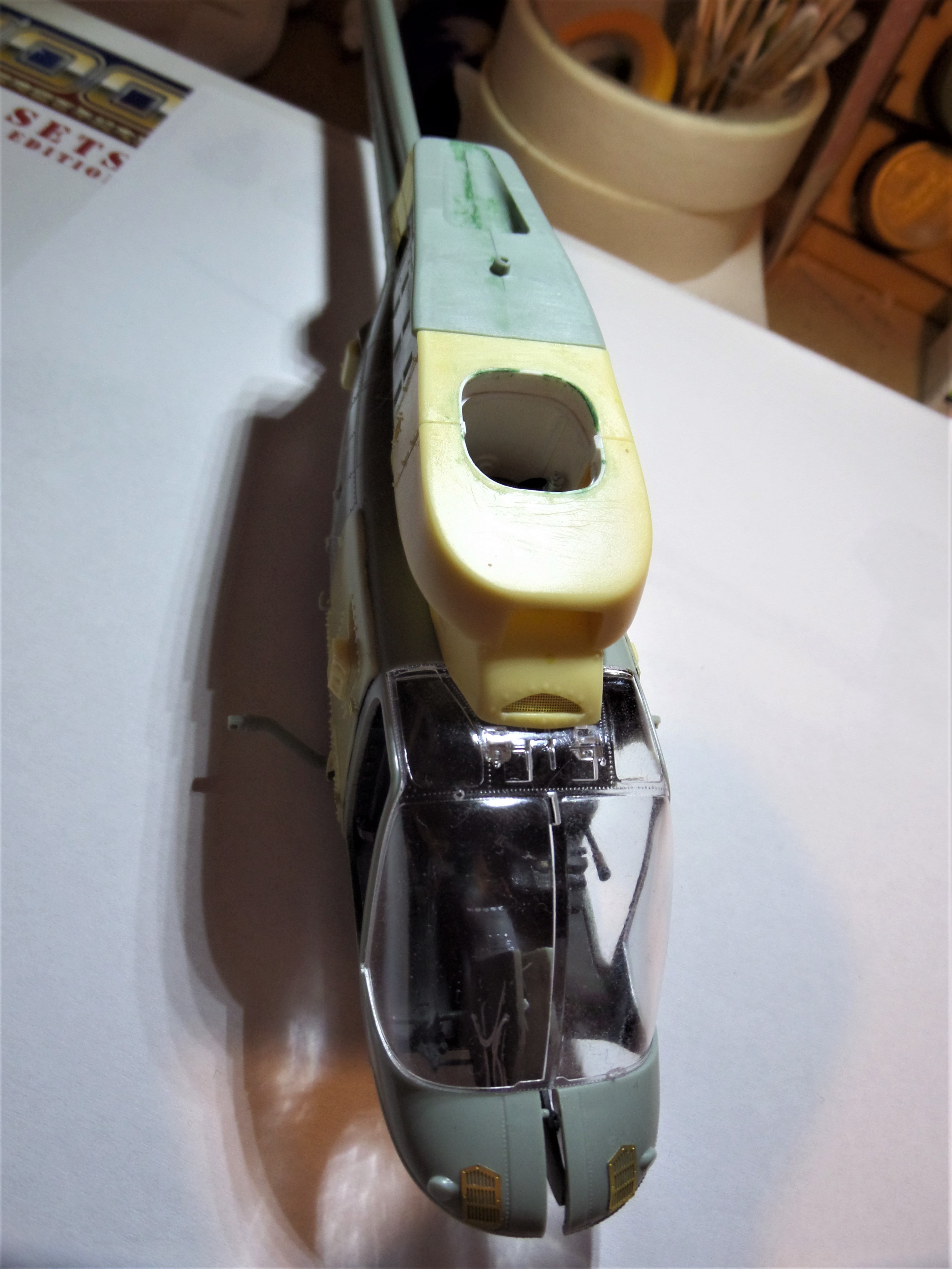

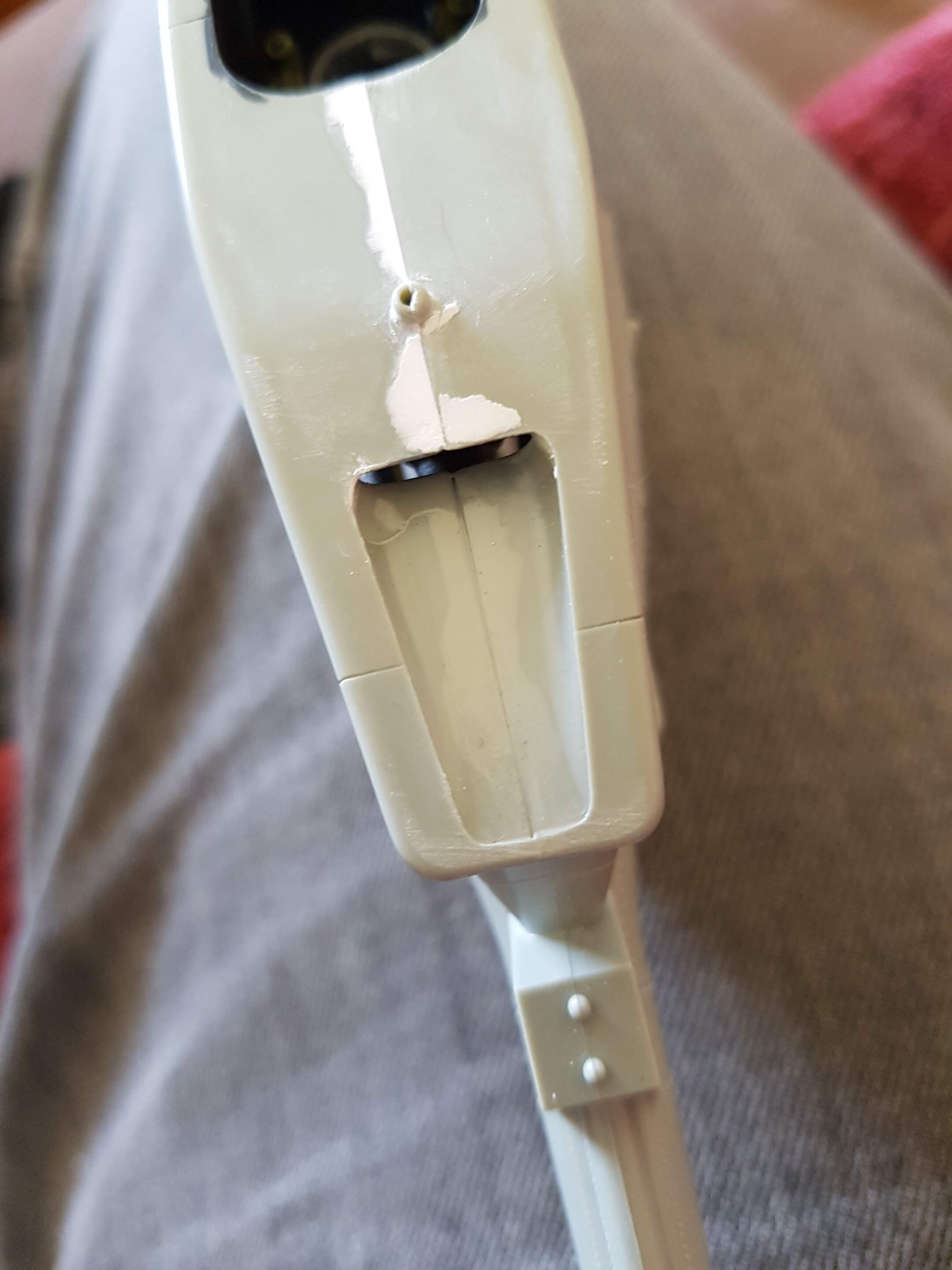

A question for those in the know, is there a panel line running across the doghouse on the real thing where the resin meets the plastic on the pic below or is it one panel? I know the front of the doghouse comes off for maintenance on the rotorhead etc but can’t find anything for further back. Everything is dry fit at the moment just want to be sure before I glue everything in place.
There is a panel line there. It is an area that is hard to find in pics since it is the top of the helo. You can sort of see it in the below pic. You can see the latches (dots and squares) that disconnect the two panels.
Yes I can see it, it’s very faint. Thanks very much for pointing it out. Hopefully when I finally join the sections the line won’t be as pronounced as it is now, if it is a little filler and scribing will do it. Cheers Gino.

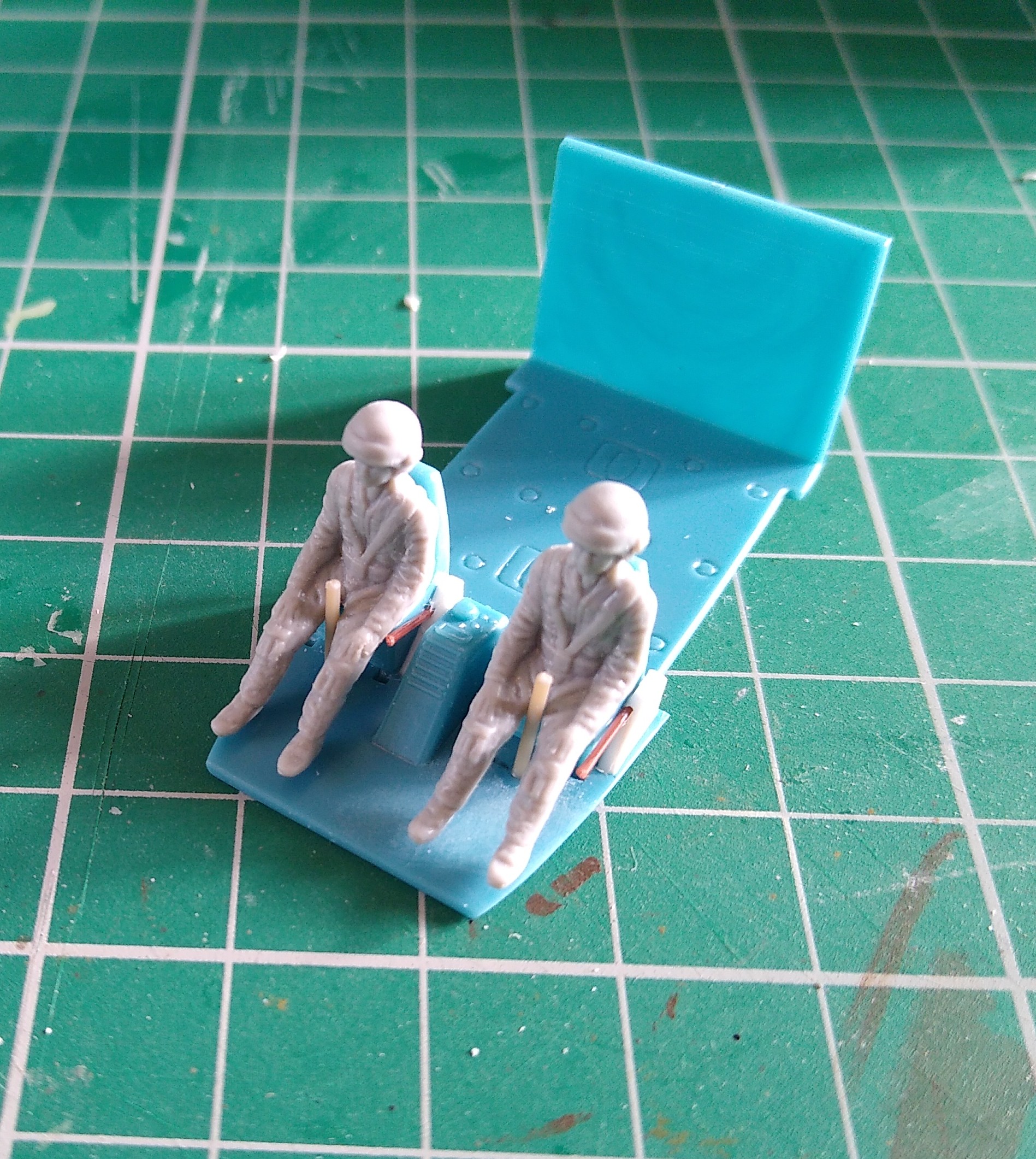

Added a simple set of flight controls this afternoon and test fitted the crew.
I had to swap these for another pair from the spares box. The Buccaneers crew were more suitable for jets looking at their suits and helmets. These two look better for helicopters. Still needed oxygen masks trimming off, but they were smaller and just under the left shoulder rather than in the middle of the chest on the others.
I’m not going to go mad here as little will be clearly visible through the thick canopy.

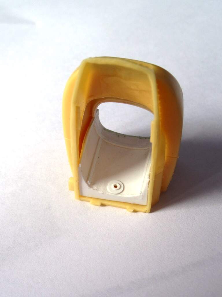

@Maximus8425 the recessed section directly behind where the rotor mast goes.
If you mean within the doghouse itself the resin part is just a big empty casting. This isn’t noticeable at the front but at the back it really sticks out so I built up the inside to more resemble how it is on the aircraft. By no means perfect, it is enough once the rotor mast, head and blades are attached and the MMS goes on.
nope this bit here:

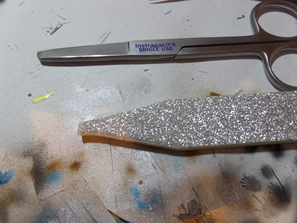

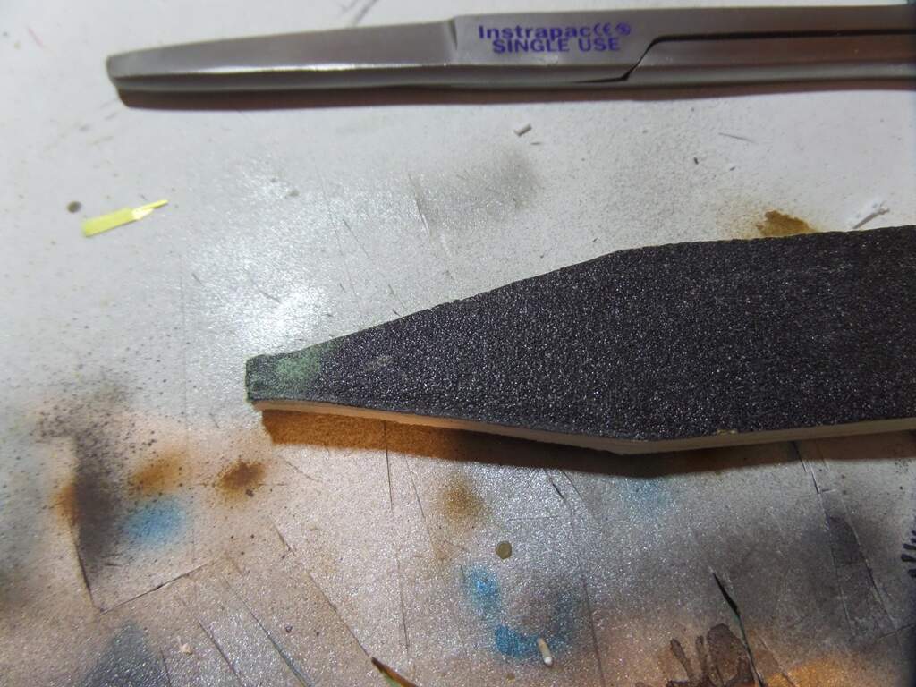

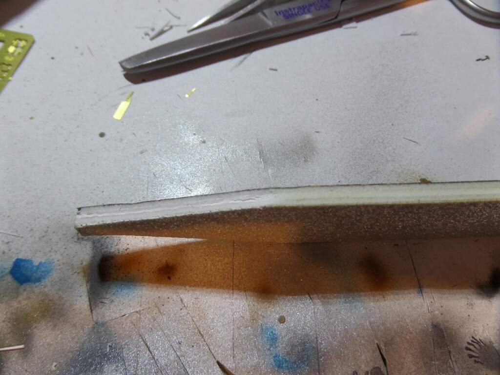

I filled it and then sanded it using a nail sanding stick from the the pound shop, actually stolen off my daughter. The sanding surface is the outer layer of a sandwich made up of high density foam which means it conforms to shallow curves making it ideal for sanding that section.
@Maximus8425 can you take a picture of said sand stick so that I can see if the wife has one I can ahem “borrow”
Here you go, a little bit more flamboyant than a Squadron sanding stick but just as effective and available in many different grades from rough to polishing. Typically you get 2 or 3 for a £1. This one I cut to shape just so it would fit and you can see it has a semi rigid centre with two high density foam layers and then the sanding surface.
For anyone that’s interested the scissors in one of the pictures are brilliant, single use medical scissors I got from a medic friend when I was serving. They literally throw these away by the ton after use so I got a few pairs. You can buy them on e-bay.
@Maximus8425 thanks for the pictures, i can’t believe you managed cut through those improvised sanding sticks with those scissors as they don’t look strong enough.
