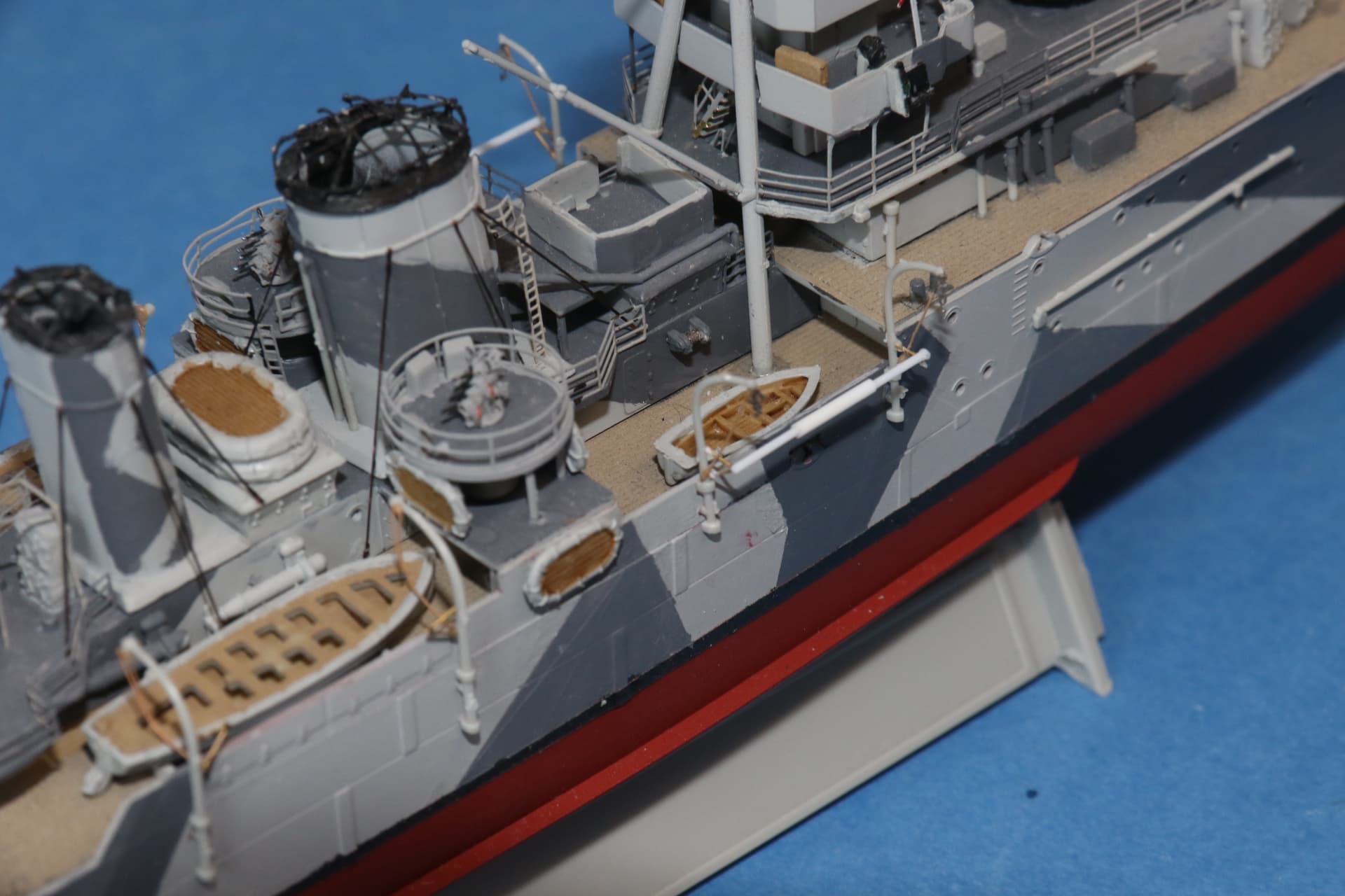

The pole (cannot remember the correct name) that stops the boat swining back into the davits was made from a couple of peices of plastic rod, and the triangular supports came from an etched sheet from Albion Alloys, designed for connecting sections of brass tube.
All painted, Some standing rigging has been added to the two derrick booms, and a couple of ladders, one on each side, keading from the compass platform to the foretop.
I didn’t know the name of that davit bumper-thing either - you got me curious, so I did a search:
Apparently it was called a “griping spar” with “pudding” pads. Hilarious!
Anyway, with your progress with the boats the build is really coming together. As a pathetically slow builder myself, I’ve always admired the velocity of your construcions. Carry on!
I haven’t seen that drawing before, very useful, thankyou for sharing it. I should be ablfe to find some mesh to maje the jumping net. Griping spar makes sense, as the gripes hold the boat from the other side to keep it secure.
Thanks Jan, apart from finish of the boats and a few details, I have some oars from the spares box to sit in swung out boats. then just the rigging, which fortunately is fairly straight forward,
