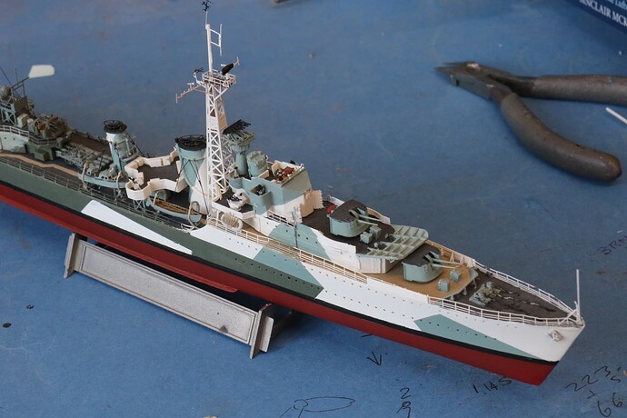

Boat lashings being fitted.
Done, they are bit heavy, and do need tidying up. The boot topping added, still have fore topmast to add, jack & ensign staff, screws, rigging, and a few other bits and peices.
More before too long.
Cheers, Si
It has been a while since I posted any progress, finally getting close to commissioning.
The fore topmast, the unpainted bit of etch is a bit low, so it was tweeked.
modified and fitted, also the correct type 293 radar installed at the fore end of the platform. The jack and ensign staffs have als been fitted, the actual staff has been replaced with brass rod.
The rigging is nearly done, just that to finish, the pennant numbers to add and the Ensign to hoist.

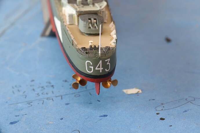

I’ve only got one gripe, Si: ideally there should be three of each colour group, as the ships wore the pennant numbers on the stern also. To represent the vessels correctly we need to buy 2 sheets… Unless that’s part of a cunning plan ![]()
Hi Russ,
I will admit I handnt realised the small letters / numbers were too small for the stern of a tribal, may be ok for a corvette. The only thing is the normal sized ones are a bit big. I will learn for next time. Have a look on Atlantic Models, they do a sheet that appears to be more comprehensive.
Apologies for giving you poor advise.
Si
Not your fault mate… Just need to expand my budget when I hit the order button ![]()

HMS Tartar has commissioned, the rigging touched up and painted in. the insulators in the main aerial runs were made from daps of rather white paint, the forward set ovet the funnel were given a black wash.
The two tone pennant numbers on. (Dark grey and white)
On the stern, white.
The finished ship ready to join the fleet.
The Atlantic models Tribals are good kits, the Black Cat upgrade is not totally needed, but plenty of spare lockers, single 20s, carley floats and a few other bits and peices.Always useful
