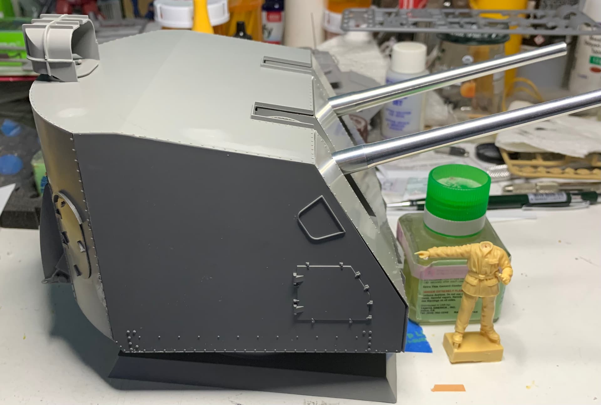

I got the AK-130 cause it looked cool but really this was the only one I had been waiting for.
I like this kit. Super easy to build.
A few little issues and maybe a slight complaint. Some type of internal bracing would help with that 3rd to help place the bigger pieces to help avoid gaps and I admit it might all be builder error.
I have to replace the bar as it broke before I got to it on the left side. I have to make the door hinges as one broke removing and if all are the same no one is the wiser.
Attached the gun travel mechanisms (?) to the front plate. The front plate and barrels are not glued in.
Fixed the front area with two 1/16” evergreen rods.
More progress on the last bits needed.
Evergreen (102) .01x .04 strips chopped to length. Using the existing part on the sprue from the alignment.
Strips attached
Only thing left before attaching is to add either styrene or Archer Fine Transfer rivet heads to the arm base and pivot point.
Stuck inside on a snow day and made some more progress.
Finished door mechanisms with a 1.0 mm punch and ATF rivet.
Used Tamiya putty on both rear corners
And attached the front plate.
Need to putty the front, glue in the barrels and add the rails before painting.
It is really coming together nicely, Ryan
Thanks. Except for some putty which could be user error, I really like the kit and it falls together.
Takom did me dirty on this kit and left off the raised location points on one side.
Not going to do a hot take that the B team was on this one but it makes me wonder if the other issues where really me or less then perfect design. Anyway on to my fix.
I tried to give me some location points
Not great but not horrible execution. Good enough for me.
Here is what the other side looks like.
Here she is really for the paint shop. Only the barrels and dome in back are not attached for easier painting.
