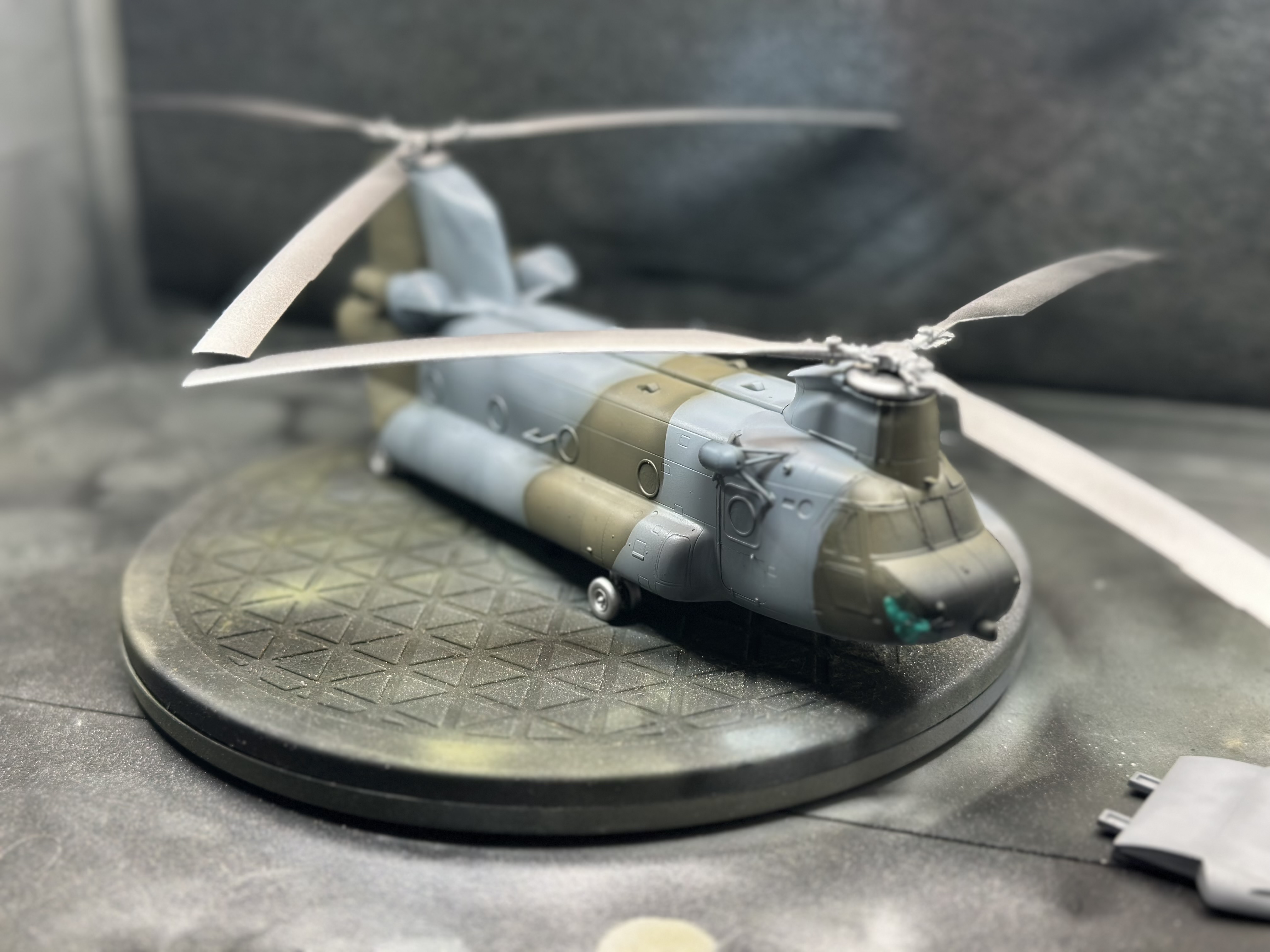

Chinook camo is painted. Need to do some additional details before decals and weathering
Nice job on the camo, Alex :+1:t2::slightly_smiling_face:

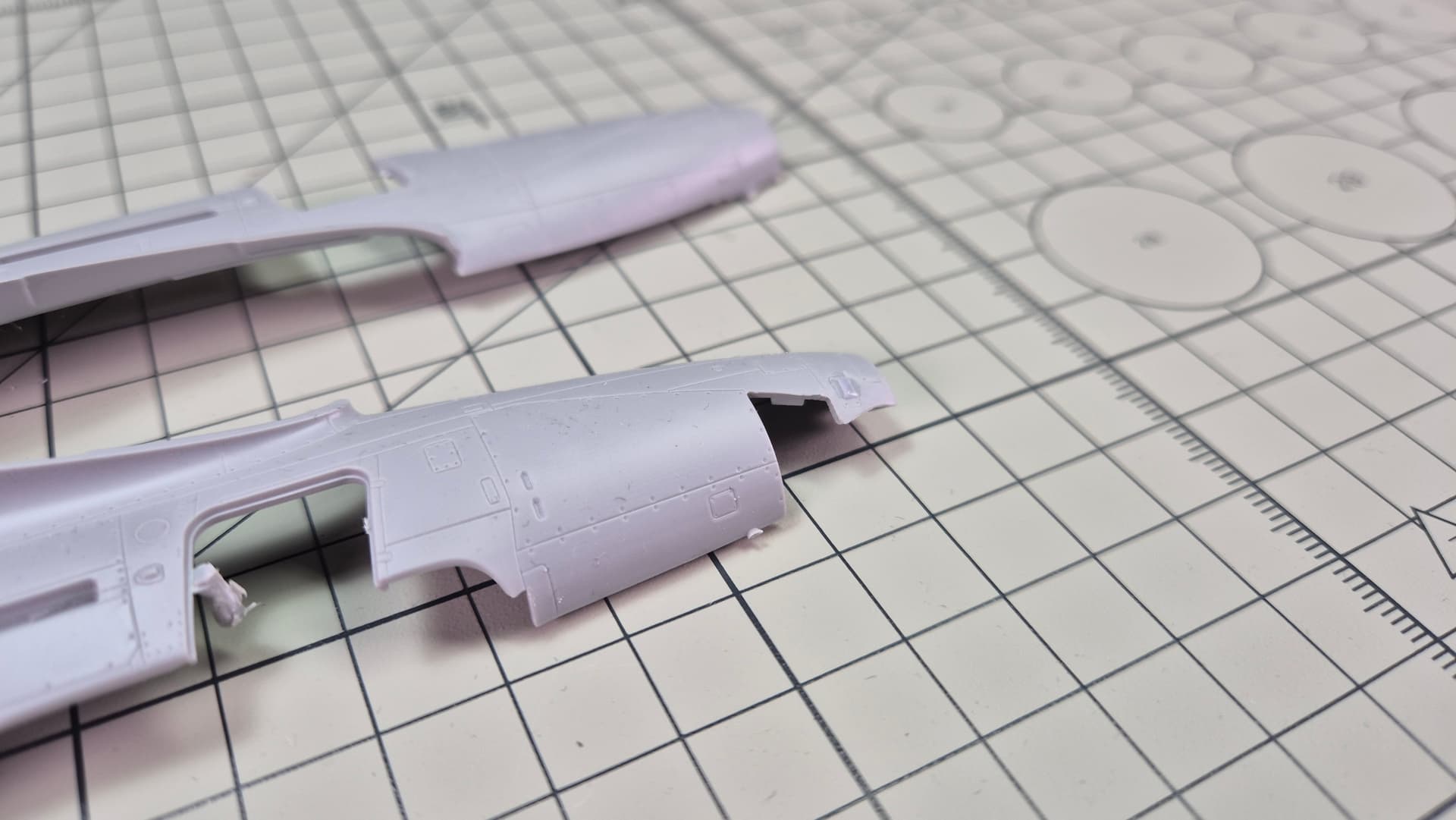

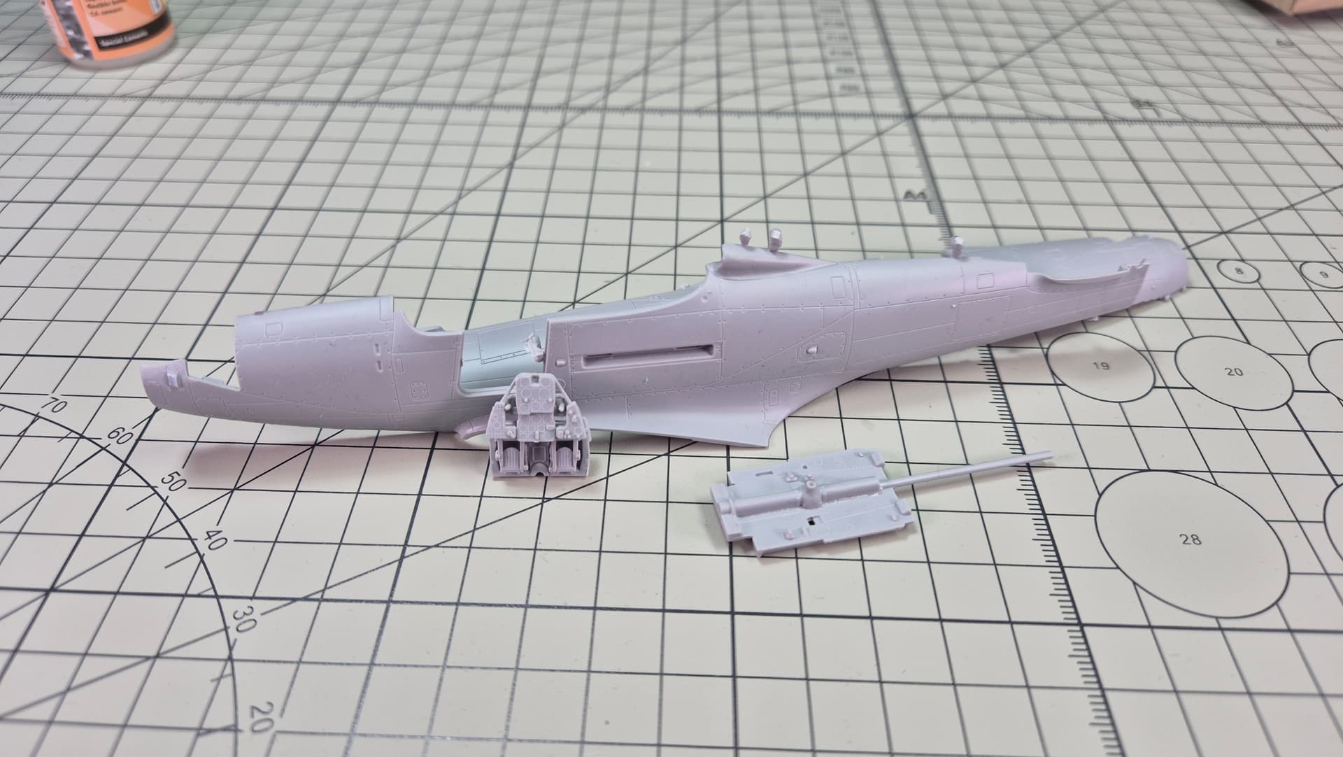

Before starting my Airacobra I made some investments and bought some Eduard Big package for this kit:
I don’t know if I will be able to use them or I’ll just destroy them i attempt to glue them together instead of my fingers… But we need to go bold sometimes to fail miserably :rofl:
So first cuts are after me. First I made cockpit parts
And tried to replace wrongly moulded air vents. That wasn’t the easy task and good that Arma Hobby decided to include double package of printed replacemed … I used them all :sweat_smile:

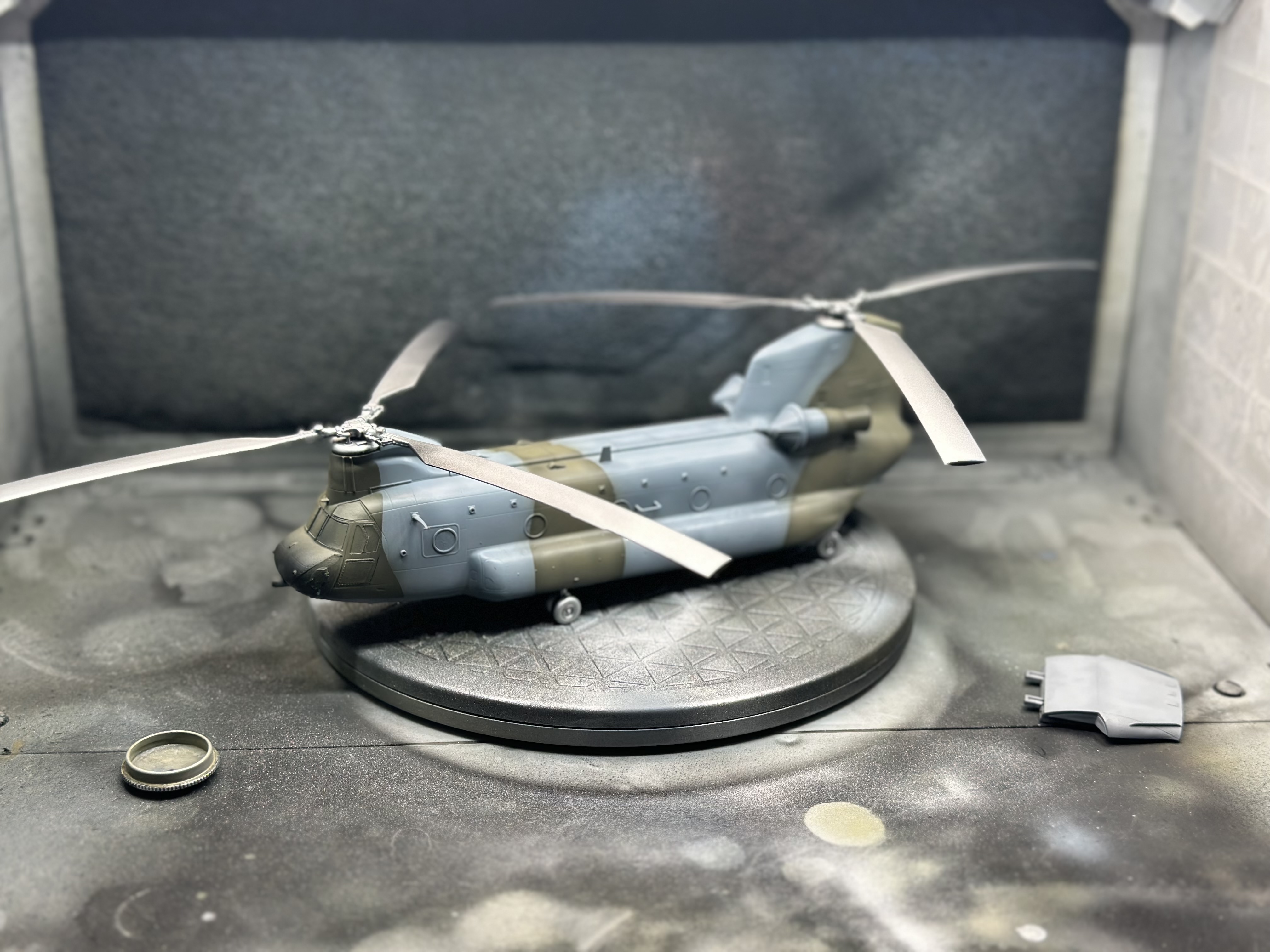

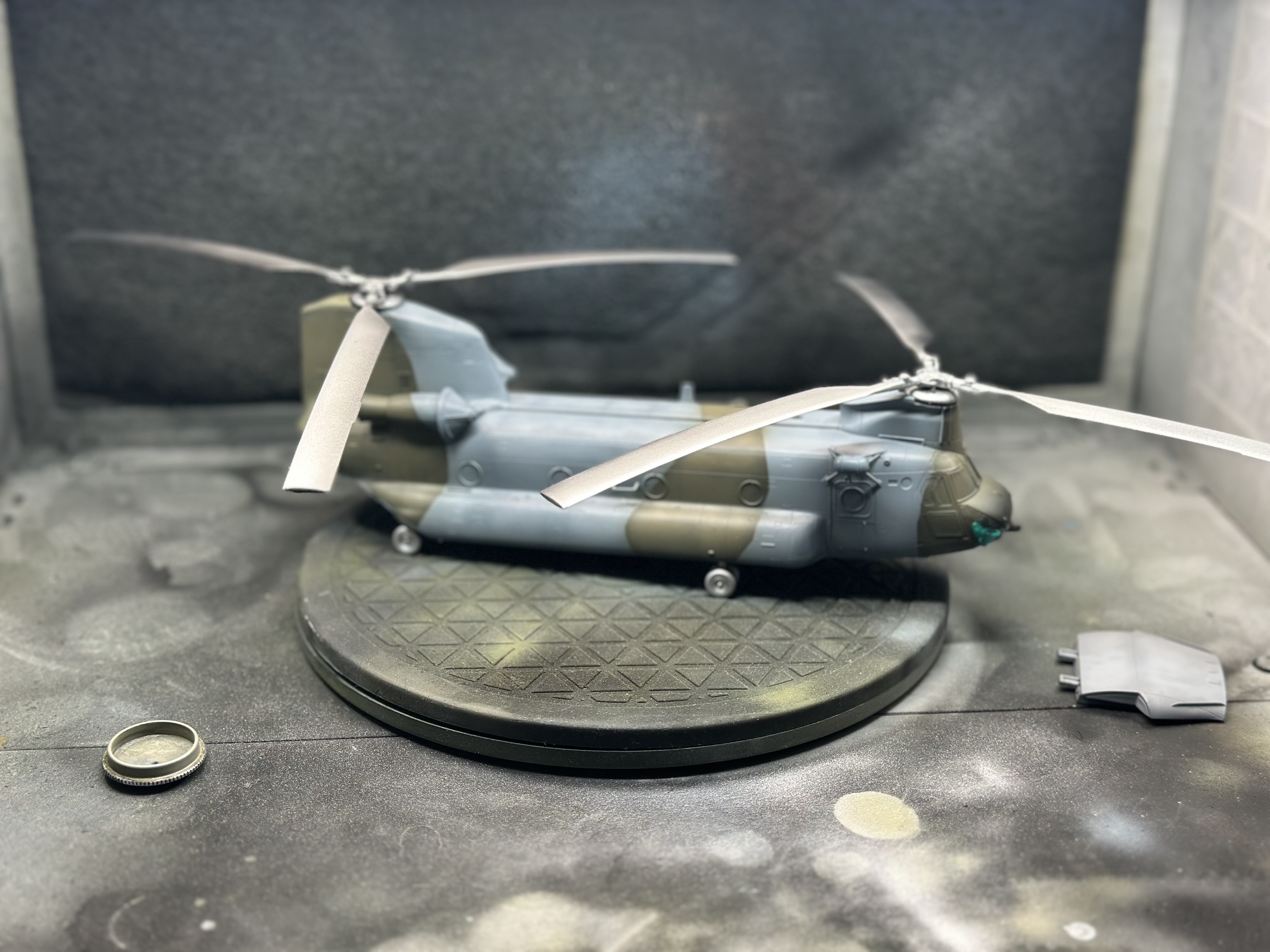

Calling this one done. Once I get my light box setup I’ll get some better photos.
Looking good, Alex! :+1:t2:
Congrats on finishing :slightly_smiling_face:

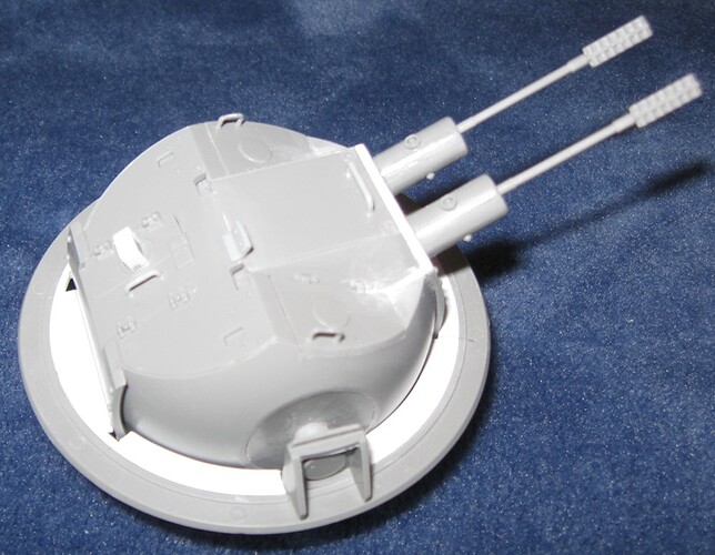

As with every Takom model I have built so far, everything goes great…until it doesn’t. The parts comprising the front face of the turret do not fit. I ended up scraping away plastic until the three problem panels sat in a fairly nice line. With some filling, sanding, and shimming, it should look okay.

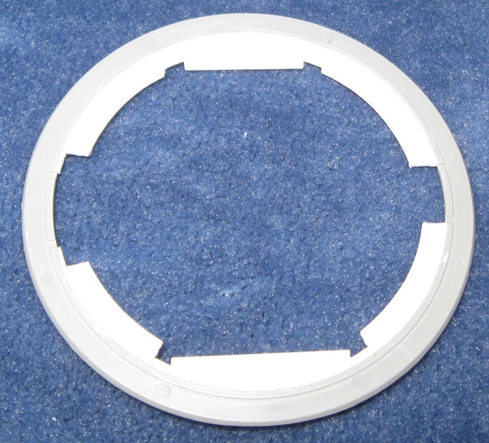

The turret base is a half tailed design that leaves large gaps, allowing a viewer to see into the guts of the model. Fixing that will take some effort.
I really dislike the design of the engine air intake grill. To keep a viewer from seeing into the guts of the model, I added a backing plate below the grill. Paint will probably not get down in there, leaving an ugly white plate visible. I may try to rip that out and replace it with a black plate.

Link and length tracks are easy sailing. Ball turret is mostly cleaned up but needs some sanding. I recommend spraying primer on all major turret parts before assembly. The gap between the upper and lower turret parts is big enough to see down but small enough to confound an airbrush.

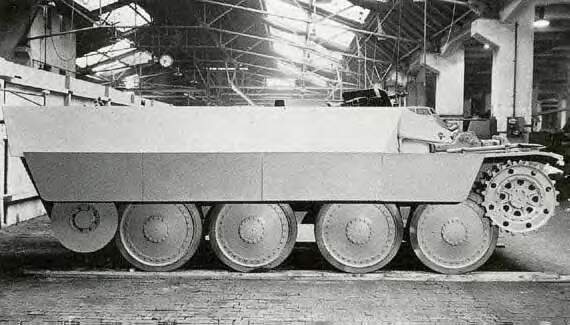

Doug, the 38t WAS made into the world’s first tracked APC - the German Katzchen, 1944.
Unfortunately only built as a working prototype.

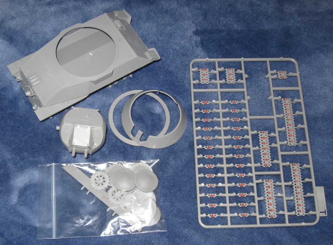

Ball turret is all fixed up. It should look decent under a coat of primer. Most detail parts are installed. (The turret can still be pulled apart for painting.) I added some factory unauthorized modifications that void the warranty–two periscopes, two pistol ports, grab handles, smoke grenade launchers, a tow hitch, and a bunch of lifting hooks.
If I had a spare set of Panzer 38 road wheels and tracks they would become an ammunition trailer. Unfortunately, my spare parts bins are running low so that idea may need to get the axe.

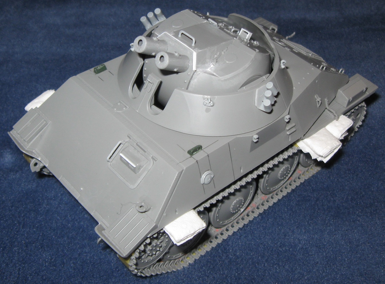

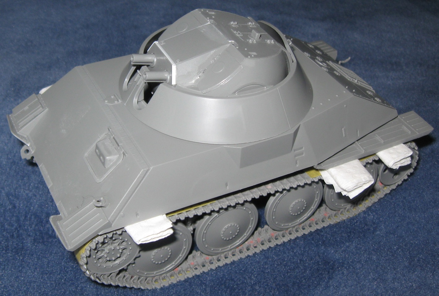

Takom Flakpanzer 38 Kugelblitz

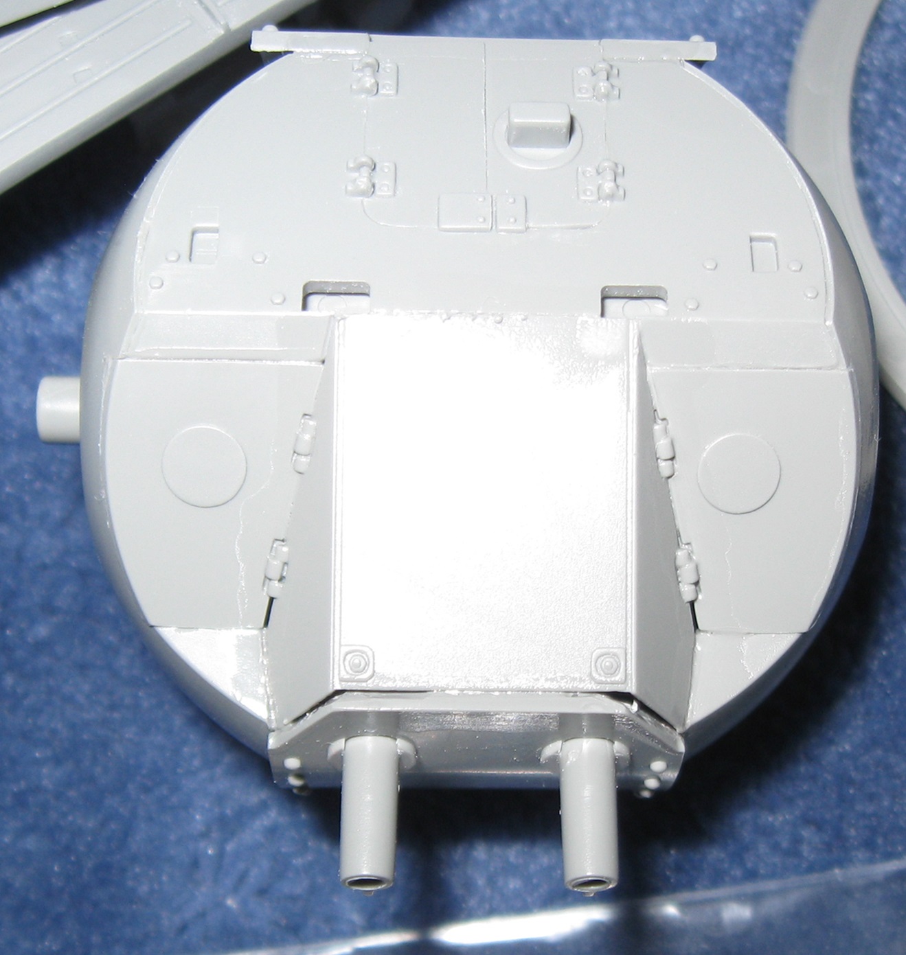

My solution to the, “I can see inside the model”, problem.
Fits pretty good!

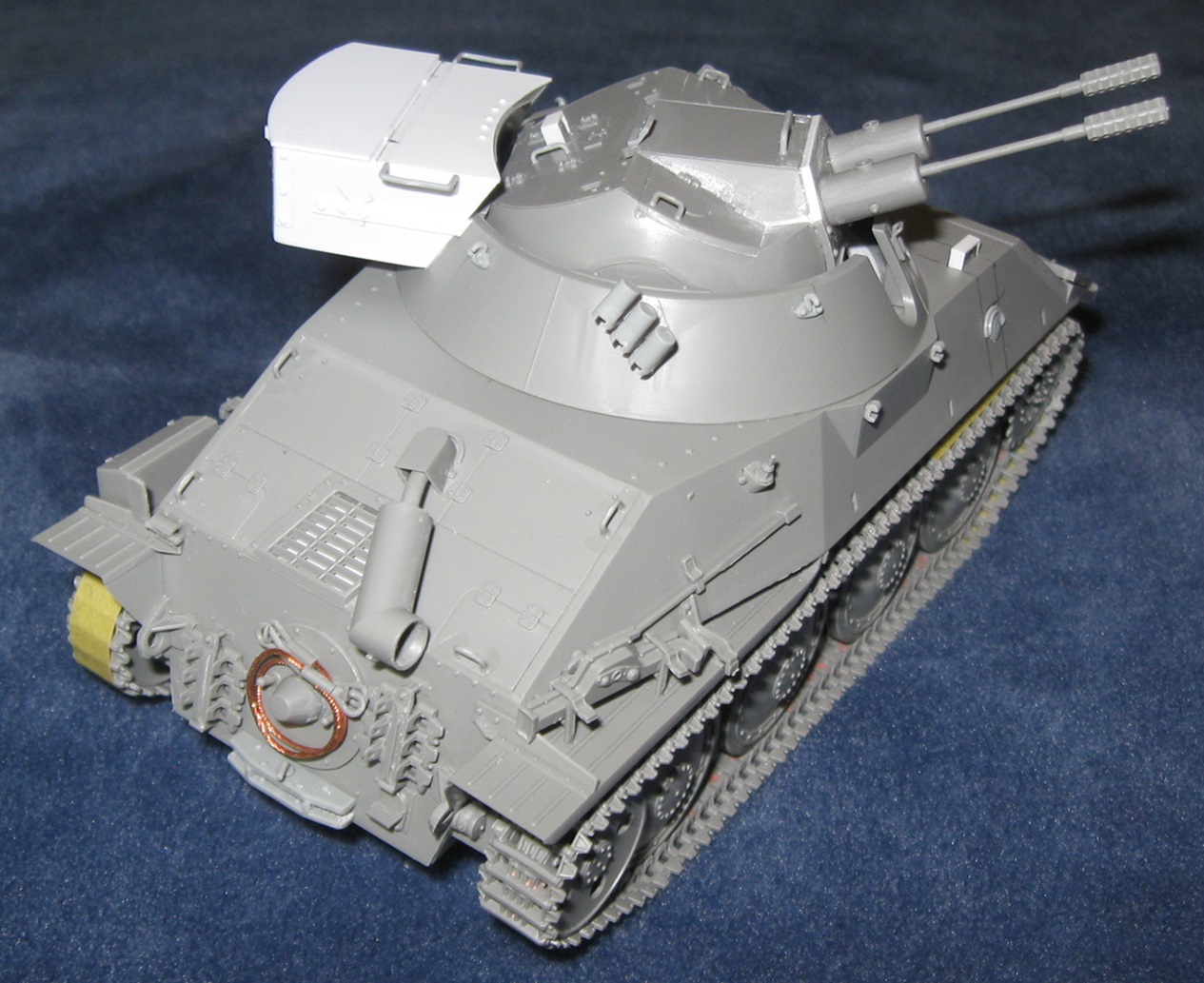

Gonna call this ready for paint. I usually put side stowage bins on everything so…not gonna do that this time. Gave it a turret bin instead.
@SGTJKJ Completely agree. Conjectural vehicles are my very favorite things to build precisely because there are no limits. Now I need to decide how to paint this thing.

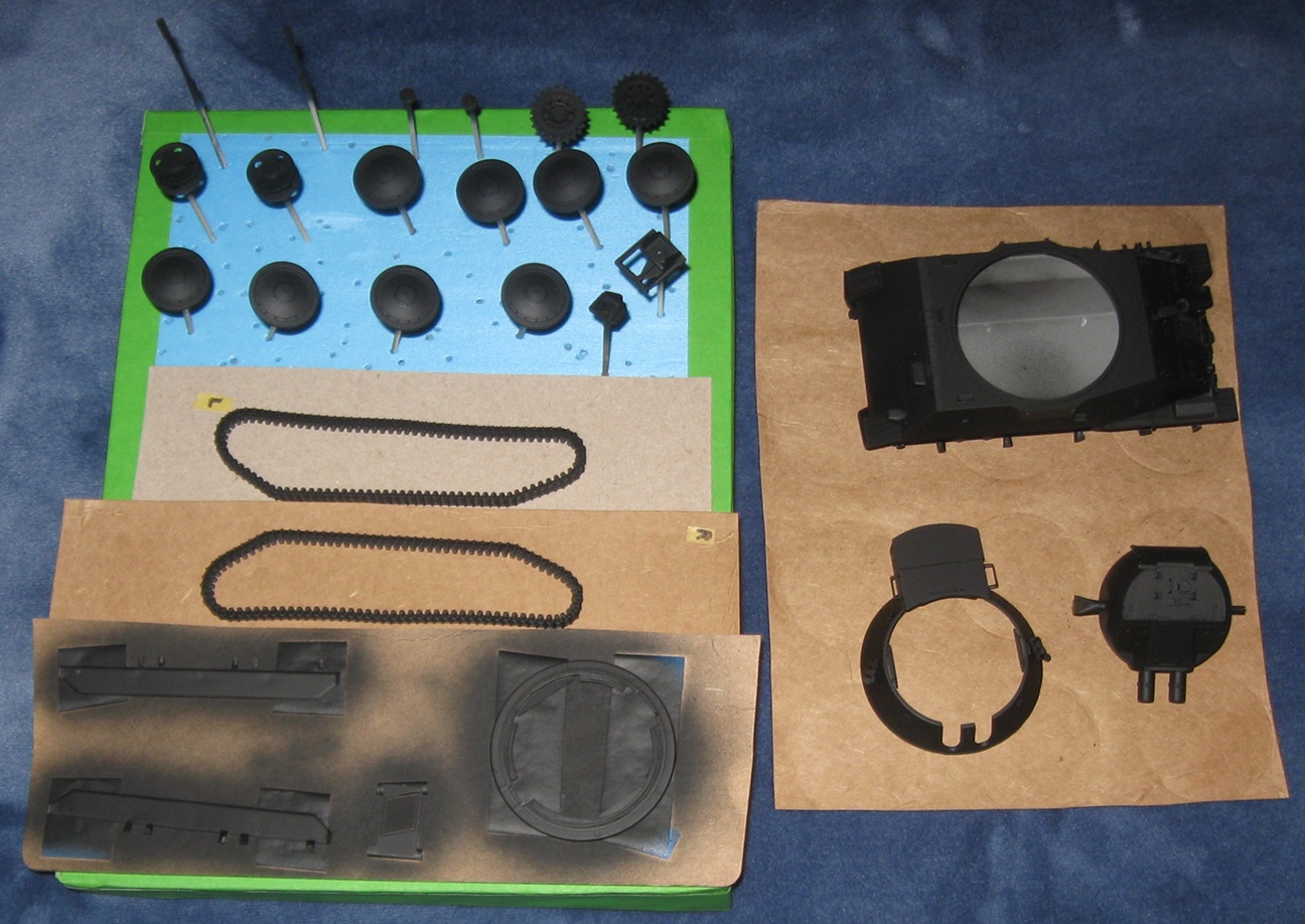

For the first time in 3.5 months I actually sprayed some paint. This could happen.

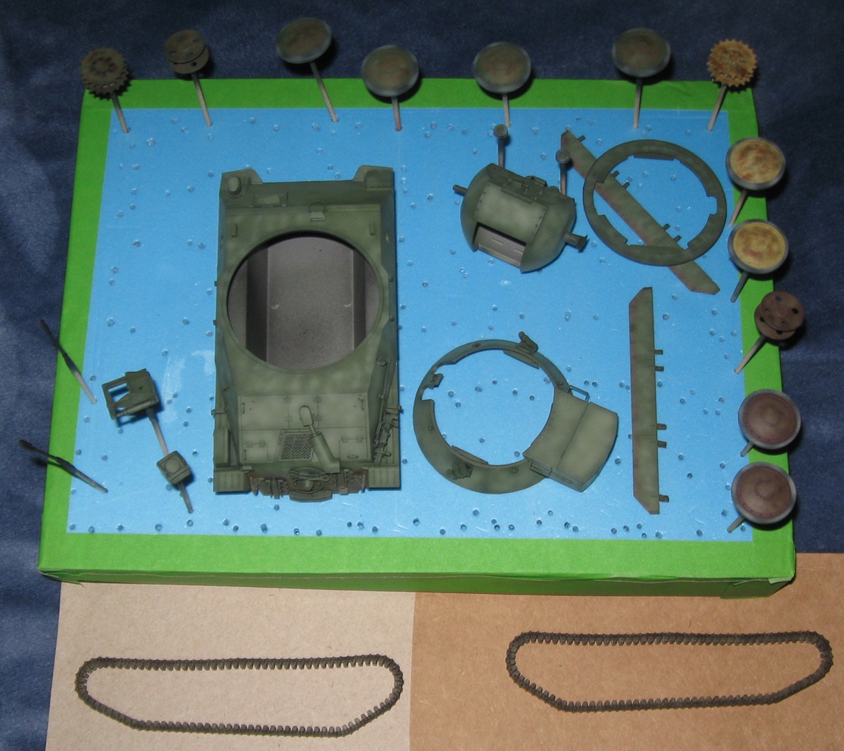

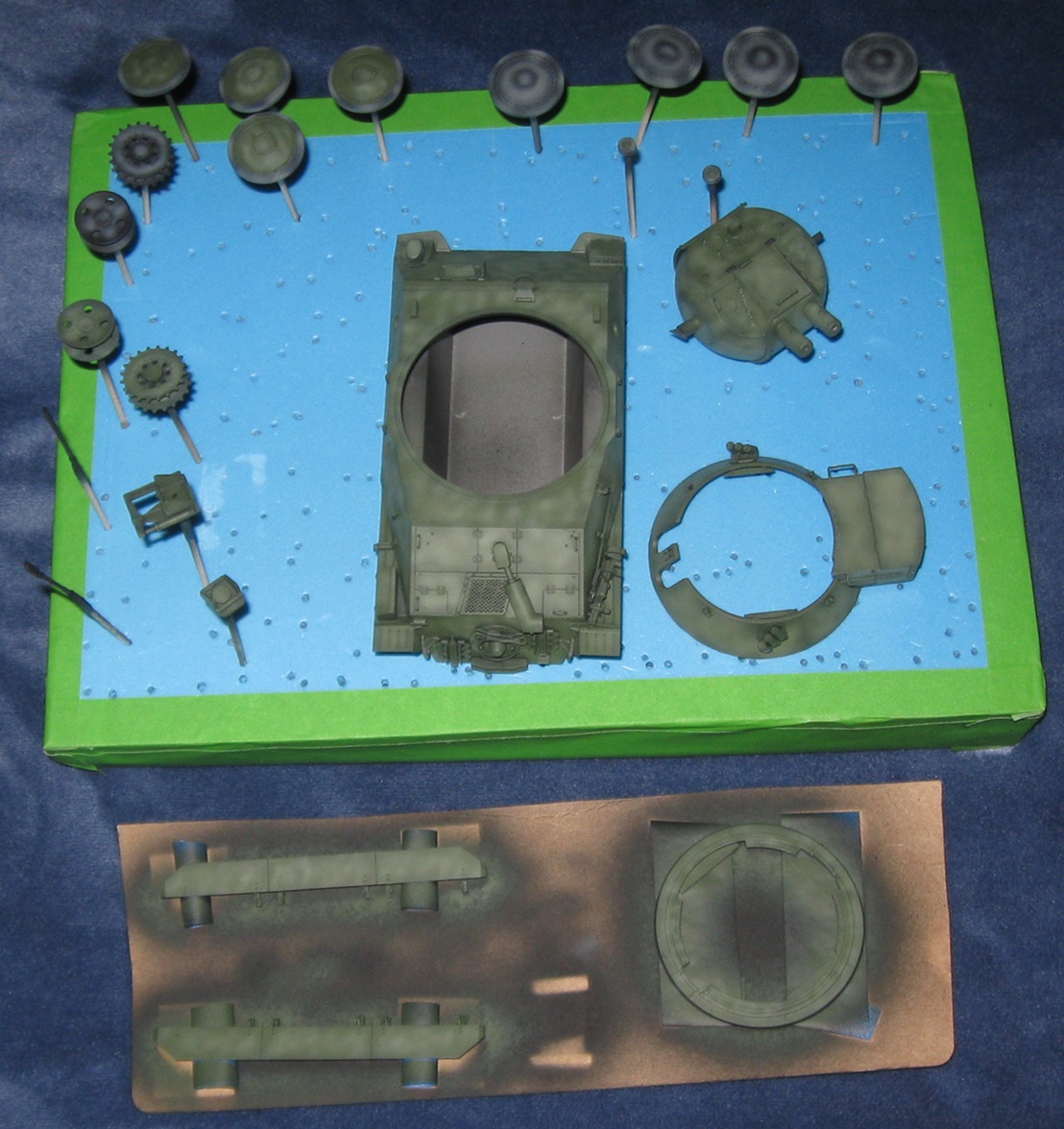

I decided to try a new technique and made some camouflage stencils. That experiment failed fairly badly. Next, I tried to spray soft edge camouflage. That also failed badly. Since I do not want this project to stall, I repainted everything accept the wheels green and sprayed some mud. Unfortunately, I was unable to finish that step and will need to spray again tomorrow.
Looking good, Doug. I have also tried stencils on tanks and I also could not make it work. I had good results on big bunkers with straight walls, but not tanks.
Looking good so far - looking forward to see more. :slightly_smiling_face:
