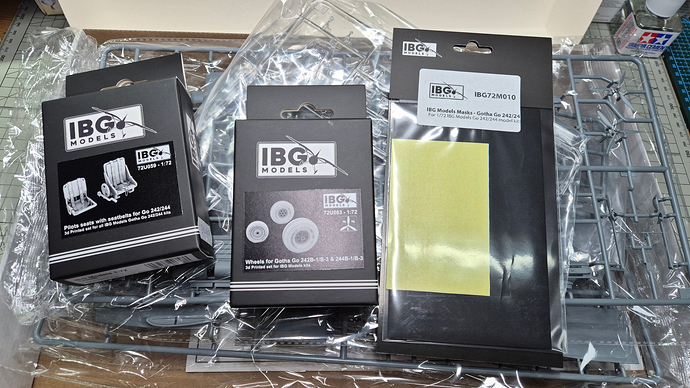

As promised it will be Gotha Go 244B-1 German transport plane, kit from IBG Models in 1:72nd scale. I also bought 3D printed pilots seats and wheels and plan to use. I’m going to help myself also with masks set also from IBG.
Here’s a kit in unspoiled condition… lot’s of parts there…
Looking great, Radek. I would also go with extras - especially the masks for these big framed cockpits.

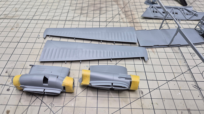

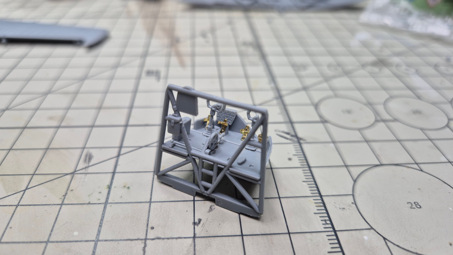

First few steps completed. Cockpit, main floor, engine nacelles + wings glued all together.
Unfortunately I missed the fact that 3d cockpit set includes 2 seats and trim wheel section and glued original kit’s trim wheel. I’ll try to remove it, but if it’s too hard I’ll leave it as is… It’s tight 1/72 scale stuff afterall :smiley:

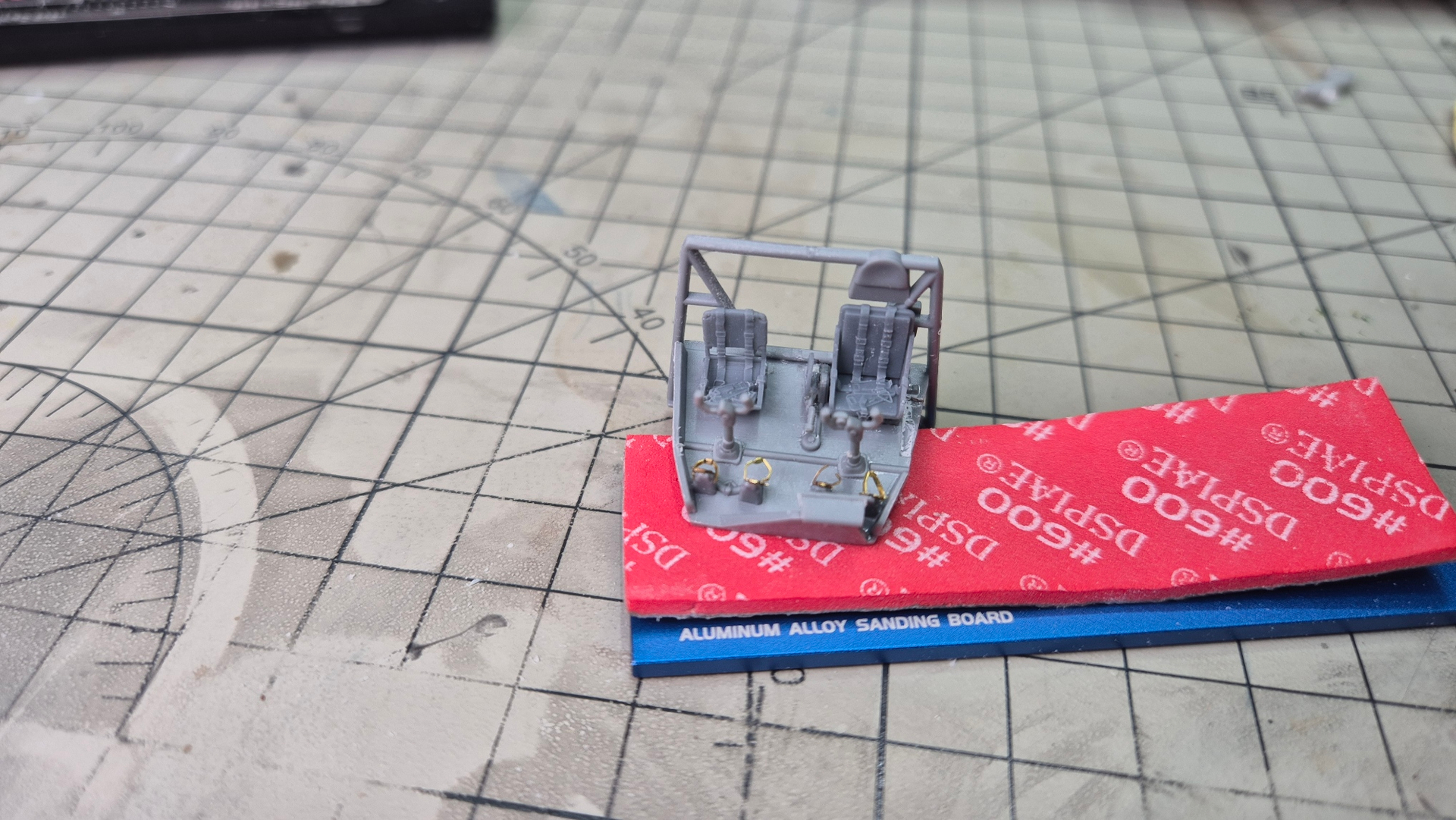

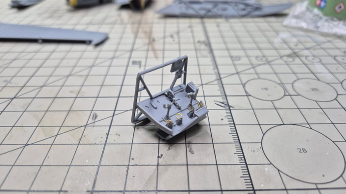

First 3D printed parts installed - pilot’s and co-pilot’s seats. I had to detach leftside panel, because pilot’s seat wouldn’t fit in.
The parts are extremely thin and brittle, so there were some losses… both seats lost 1 leg each and the trimming wheel part lost some tiny gauges - I had to replace them with kit’s parts.
I have question - maybe someone is familiar with this - instruction from IBG calls for RLM23 (Red) for all all impregnated fabric parts - so basically all interior (except metal/wood parts that should get RLM02). To me it looks like RLM23 is close to red primer colour for tanks used by Germans during war.
So my concerns are:
  1. should this really be RLM23 for interiors and not RLM02 everywhere?
  2. is red primer a good choice for RLM23 ?
And here are the seats installed:
Keep in mind that red oxide primer is a true red -
Not the red brown that a lot of armor modelers have used over the past few years.
