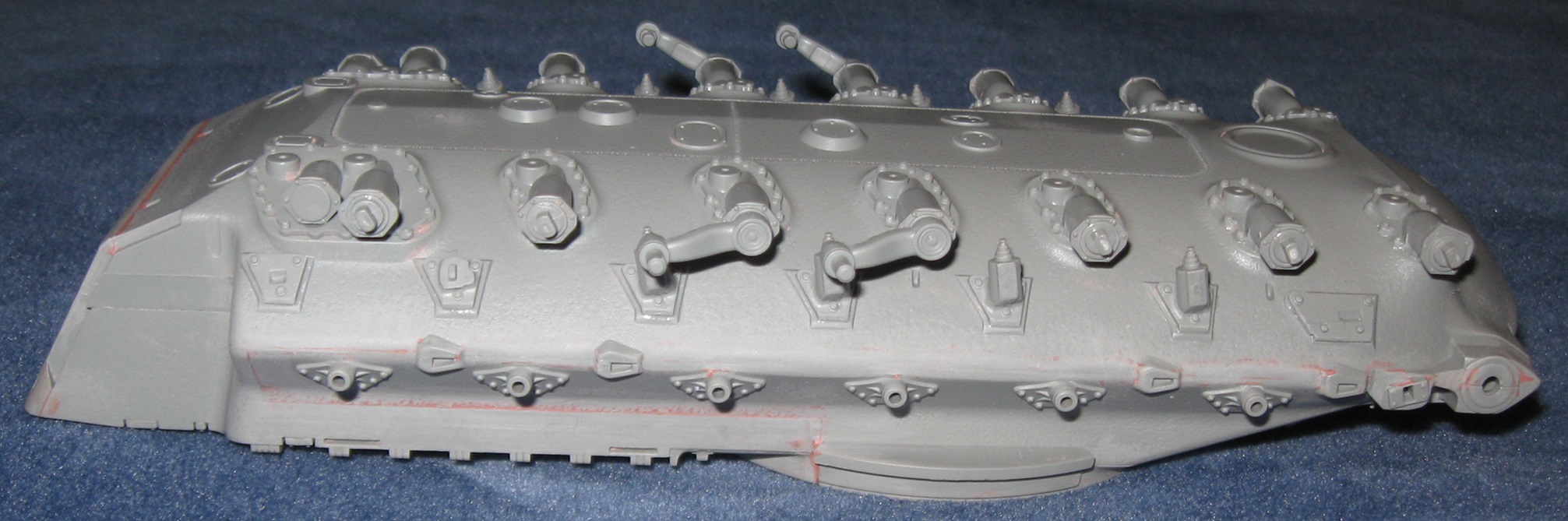

Fit between upper and lower hull is okay. Fit of engine deck parts is okay. Fit of the turret ring is not so great. This model needs filler. The worst part is the torsion bars. The people at Takom chose to make the suspension workable but did not include adequate keys to lock out the suspension components in the neutral position. Even worse, this feature means the model is much less sturdy than it could be. The road wheels also use poly caps, something I despise.

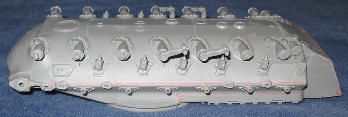

Takom T58 Heavy Tank

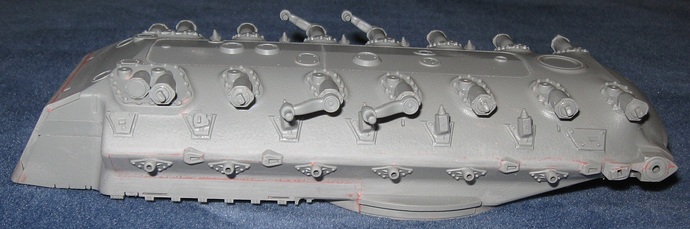

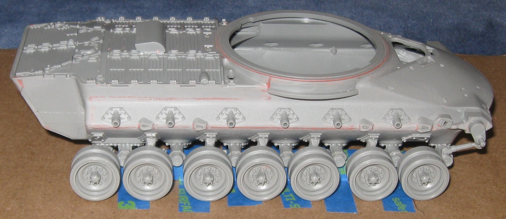

I cannot catch a break and pick a decent model to build.
Takom models always have at least one problem. Of the 5 Takom models I have built, this is the worst problem yet. I have no idea how to fix this one.
Edit: I figured it out!

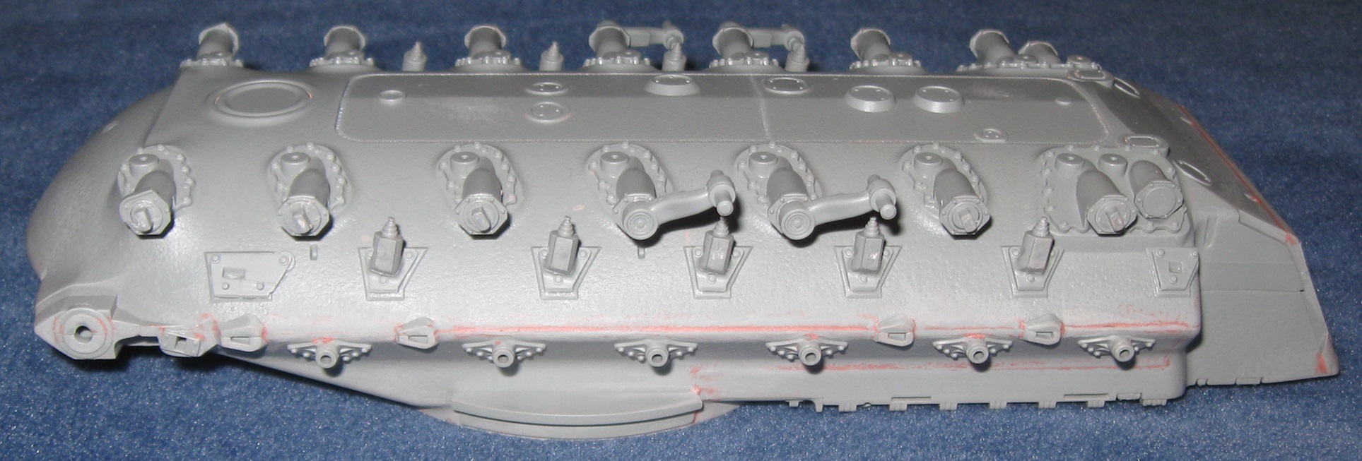

Each swing arm connects to the hull via a tab. When the upper left and lower right corners of a tab are shaved off, it allows the swing arm to swing through a wider arc, into the correct position. If I stuff some sheet stock into the resulting void space inside each swing arm, it should result in a fairly strong suspension.
One problem remains. I have no idea what the correct ride height should be for this vehicle. If I presume the right side swing arms are correct, I can set the left side swing arms to that height. I will probably go with that.
There is a lot of filling on the lower hull so I better add back some texture with Mr. Surfacer.

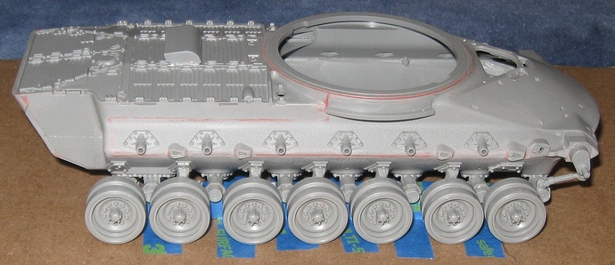

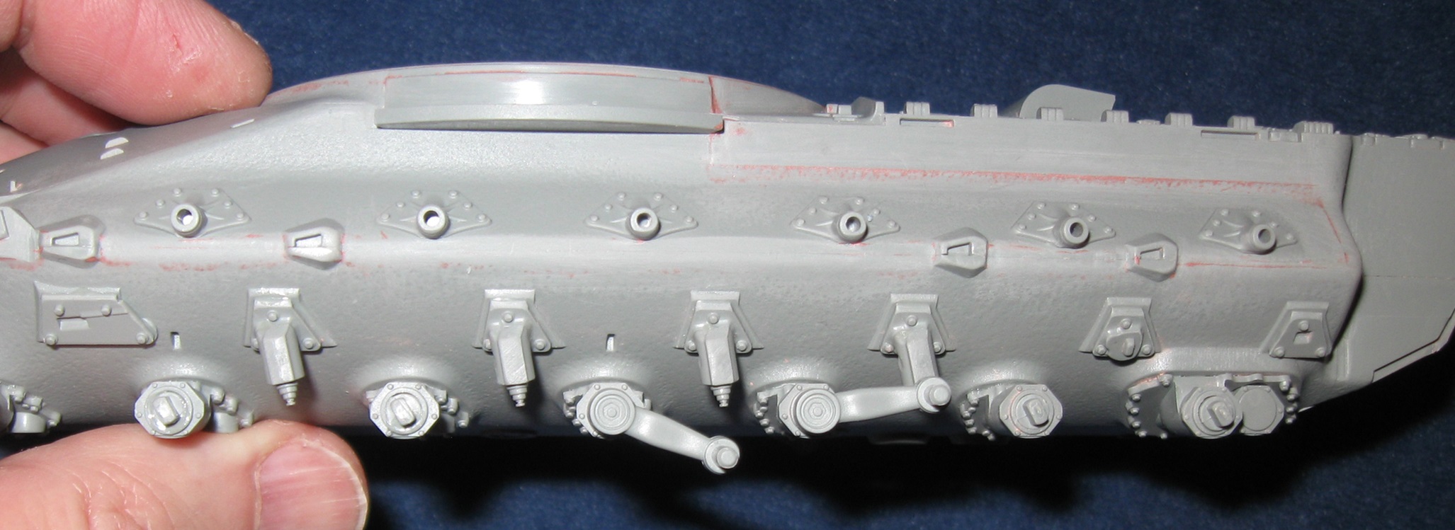

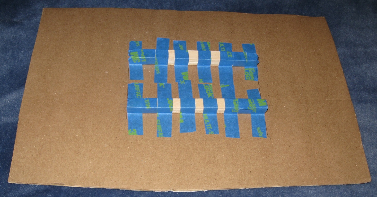

I made a little jig using some popsicle sticks and a thick piece of cardboard.
I then shaved corners off all the mounting tabs and installed the swing arms. It is not perfect but should look okay with the tracks installed. For ride height, I used a side view illustration in the instruction book. It turned out one side was way too high and the other way too low.
I plan to build a Takom T57, M103A1, and M103A2 so the jig will get lots of use. Next time, I will cut off the thin portion of each torsion bar then glue the fat torsion bars directly to the swing arms. That will result in a much stronger suspension.

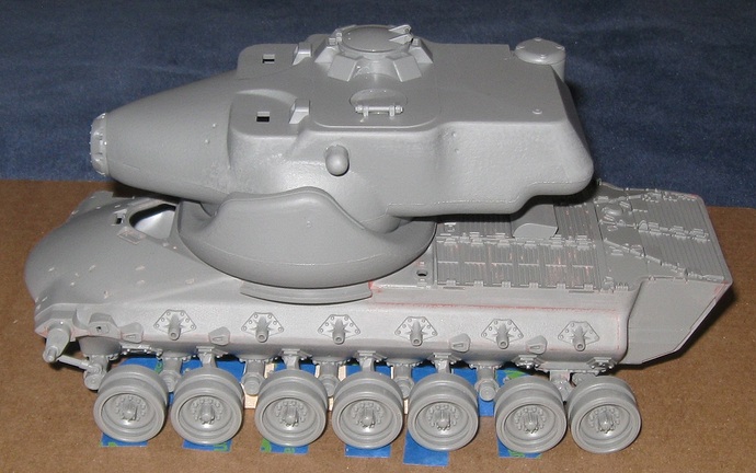

Edit: Takom T58 Heavy Tank

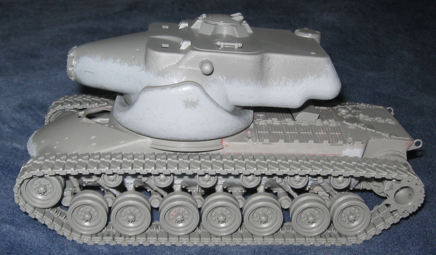

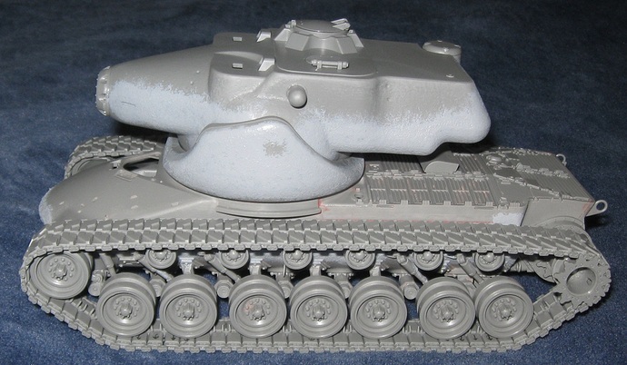

Hopefully, all the suspension problems are behind me. The completed suspension looks really nice. The question is, can it take the tension and weight of the tracks?
Fit of turret parts is good but will require some filling and texturing. Make sure to remove the mold lines on the upper turret part. This model does not have the same problem as the Takom Panzer 38 Kugelblitz. The turret fits so snugly in the collar it is difficult to look past the collar into the model.
The T58 turret is an idealized version of the real thing. The model does not include rails added to the real T58 turret. (I have two pictures without the rails and one picture with the rails.)
To my eyes, the model designers at Takom did not get the turret shape right. It is not just a little off. It is way off.
The hull is only slightly longer than an M48 or M60 but the turret is huge! It reminds me of a Panther with an 88 stuck on top. This vehicle should have featured in Godzilla movies from the 1960s.

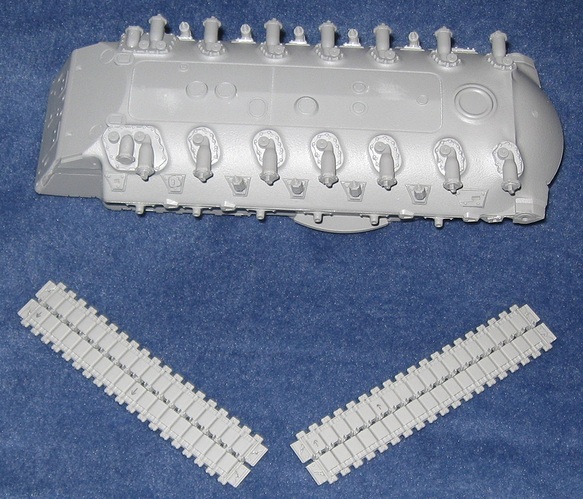

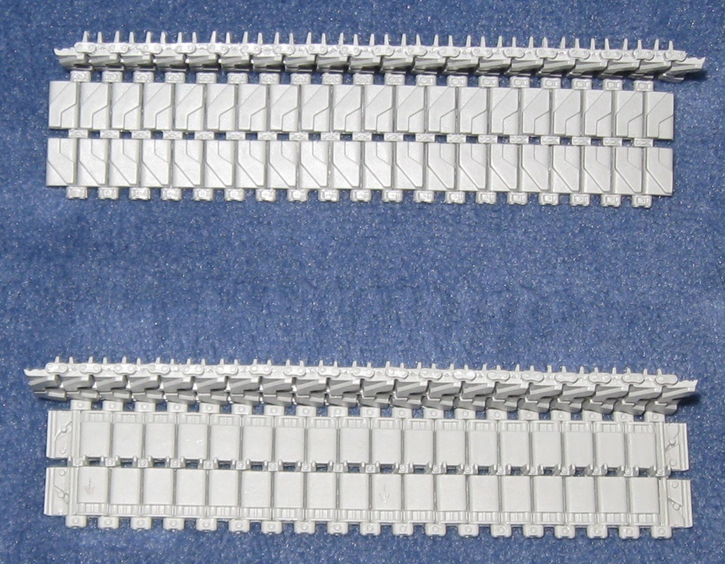

I still cannot paint but continue to cut out parts and occasionally assemble them as circumstances and time allow.
Four built up sections of track. They are fairly sturdy. Picture shows top, bottom, and inside track faces. I now realize one track run was flipped in the wrong direction so the outside face is hidden.

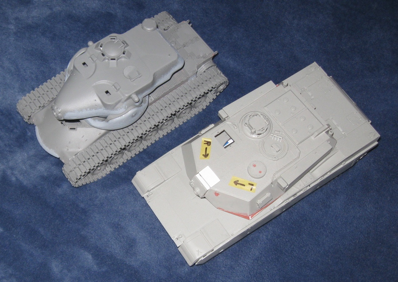

The T58/M103 is surprisingly small when compared to a certain modern tank.

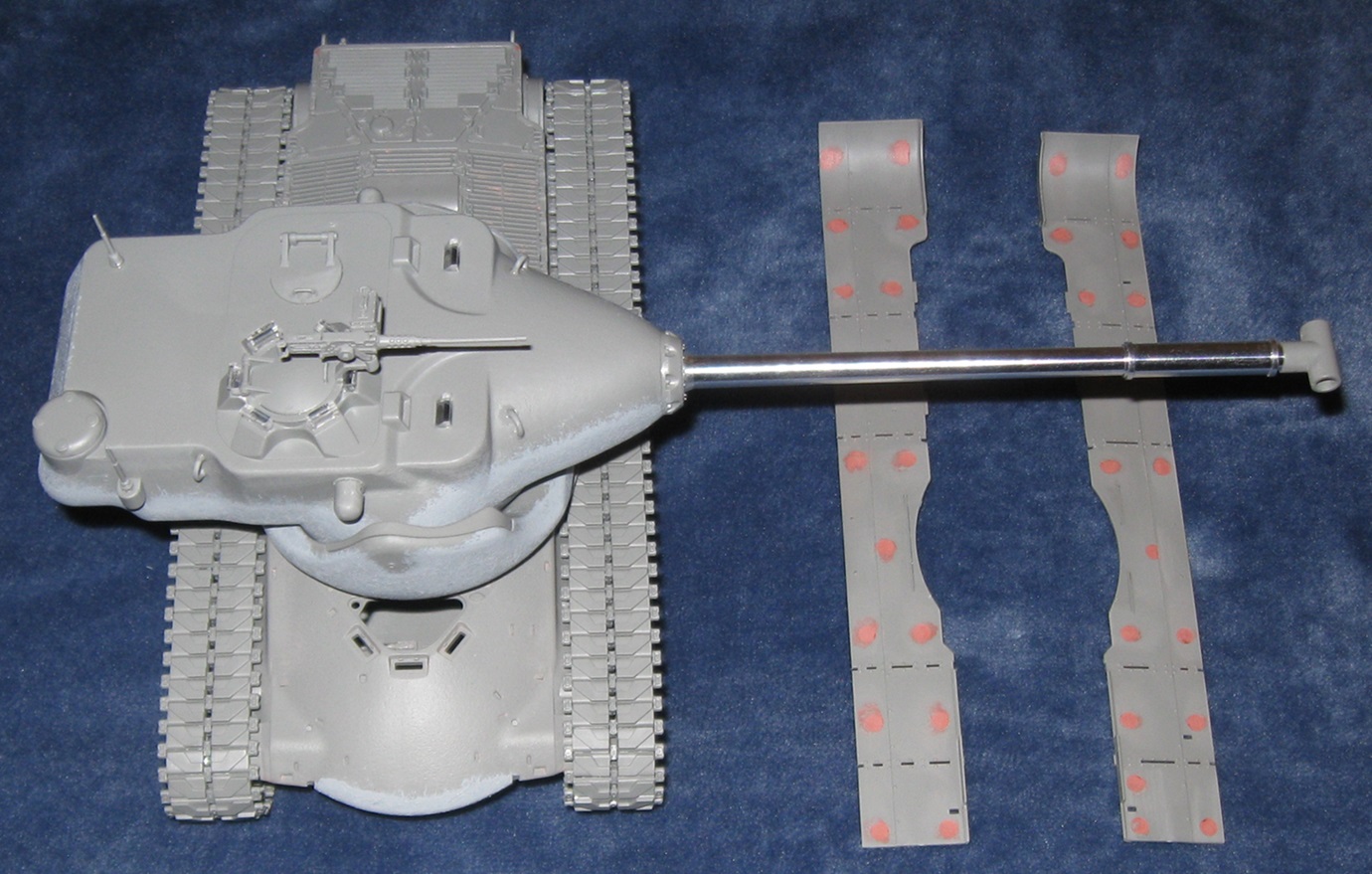

Turret is finished. Undersides of the fenders have a lot of nice detail but also a bazillion ejector pin holes to fill. Fenders fit very snug to the tracks but I want to do a good job of it. The turned aluminum gun barrel that came with the model is a very good fit. The light gray stuff is Mr. Surfacer 1000.
