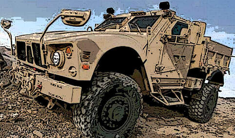

Oshkosh played around with the idea of an MATV pickup truck some years back (2015) but apparently the military was not interested at the time.
a.k.a. The M1266A1 (Note this version does not require the lengthened wheelbase.)
matv_utility

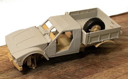

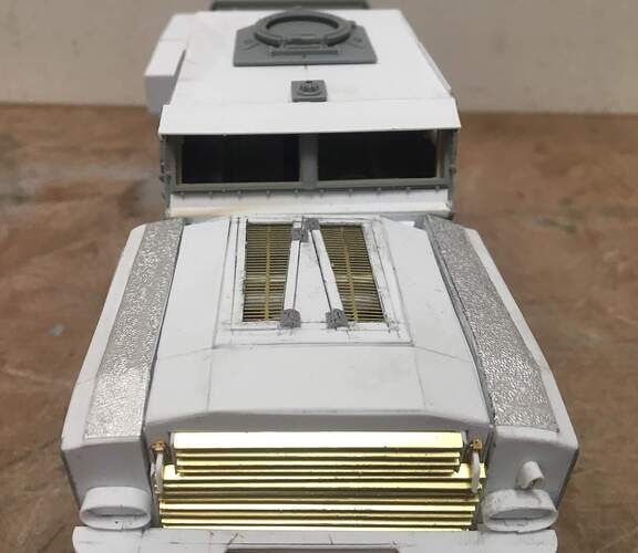

@Dioramartin, hi Tim, back to your question about the hood/bonnet - well, it seems to be just about fine, but wrong…perfect. If you look at the photo above, you might note, that the “end” of the highest point of the fender on the right side (in this view, but left side of truck) is well, lower than the other side - :thinking: So - it’s not anymore:
A guy went ahead and rebuilt the top of the right (in this view, left on the truck) so that it is now flush!

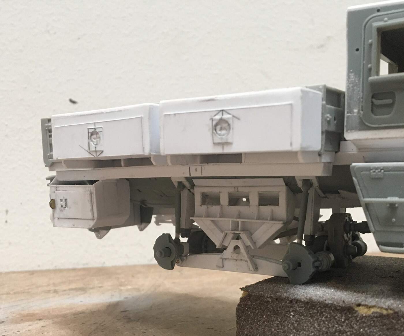

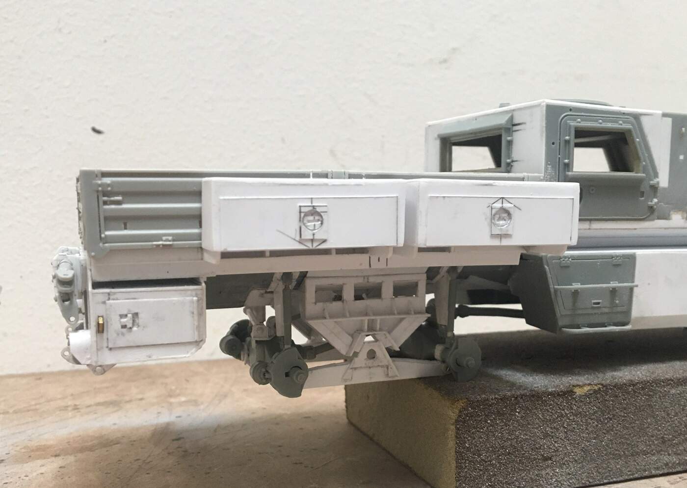

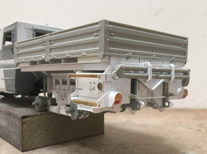

Other exciting activities focused on the right rear and rear end of this brute:
This truck has these two tool boxes that rest on metal bar that projects outward from the bed, so now the model does too!

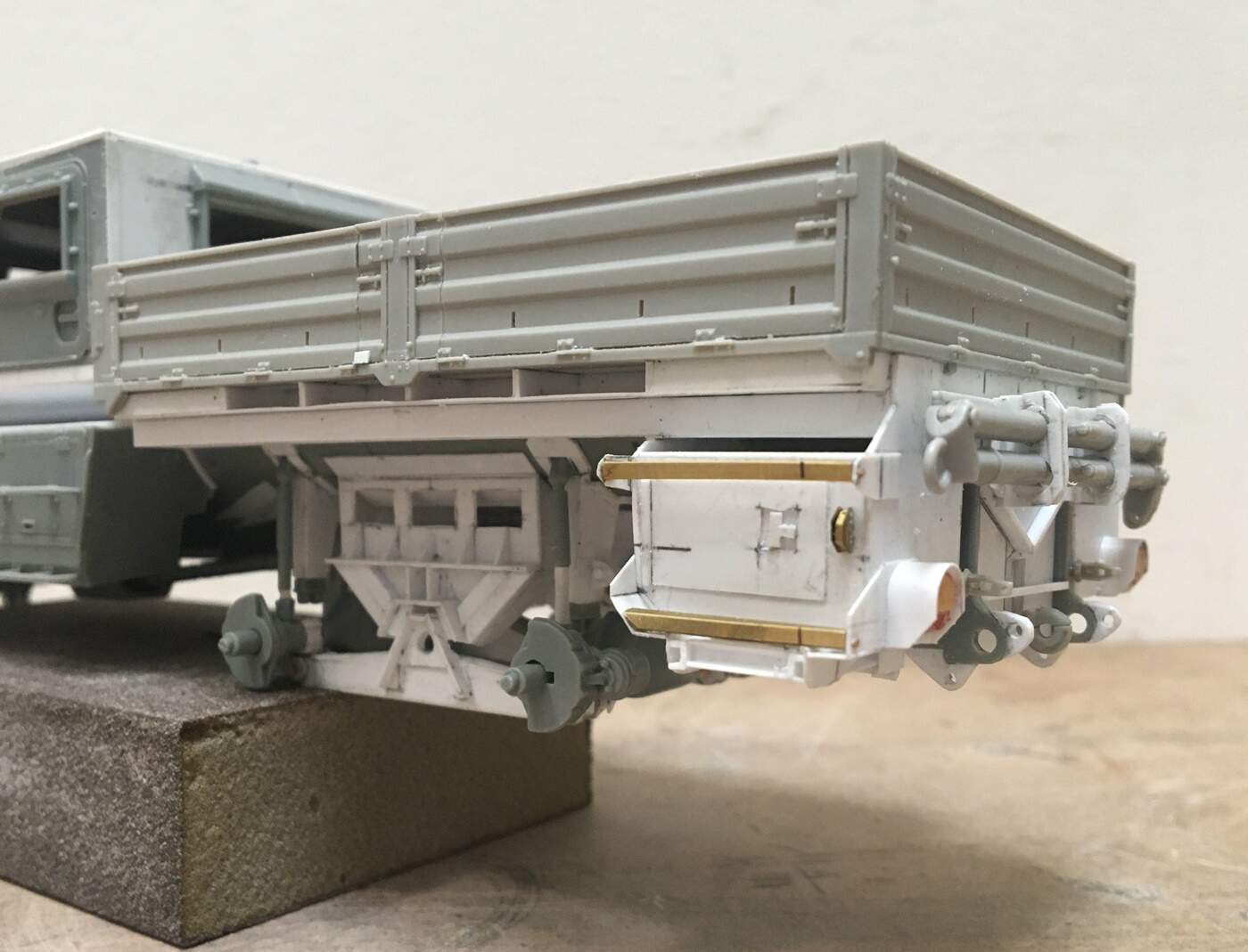

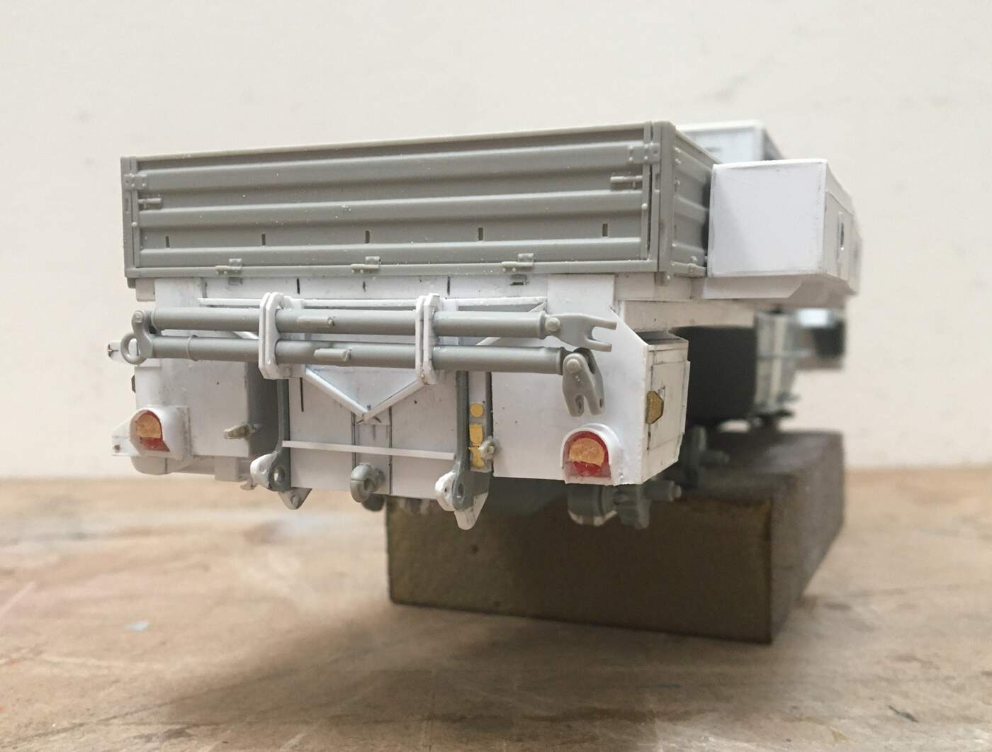

And, on to the rear end:
There’s a lot going on back here. The towbars are from the old Trumpeter kit, the tail lights and glad hands from the M1083, and obviously, plenty of styrene! I still need to add a few bits, but nothing major.
As always, unpredictable tasks were a challenge - like getting the shields around the tail lights on - took forever, same with the brackets used to hold on the towbar. You can also see the small connecting points were added to the chassis horns. None of these look all that hard to do, which I guess they’re not, but a fair amount of patience was required to get them in place.

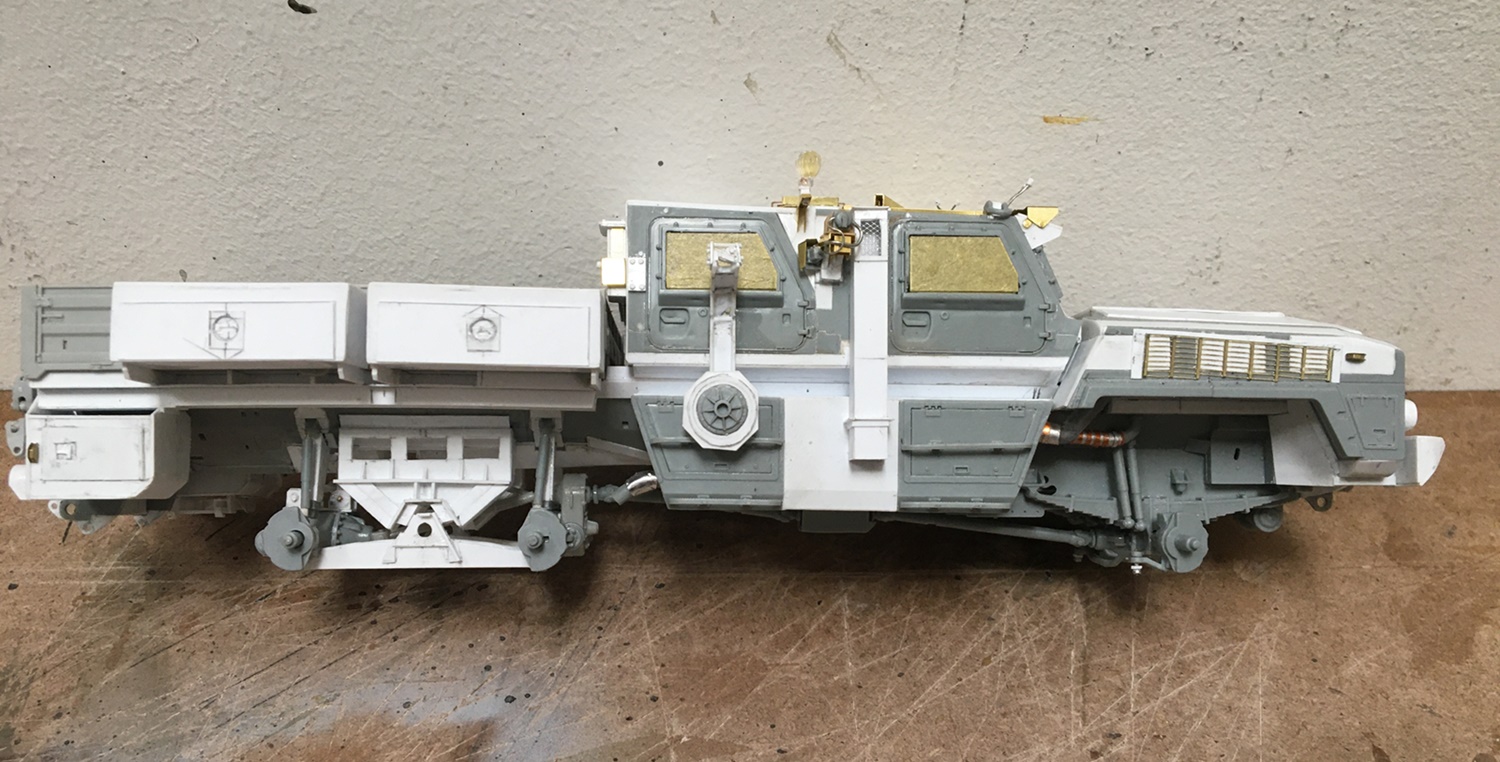

And that’s where it sits right now. I’ve started adding detail, but plenty more to go. Oh, and boltheads, lots of them are needed, as I haven’t added any yet.

Nice hood correction, of course I noticed it but didn’t want to upset you further after Glenn mentioned the “M” word :smirk: One day I’ll rumble your magic trick of making vehicles look like they weigh several tons before you’ve even painted them - current theory being you’ve scratch-built some kinda Gravity Amplifier under your workbench. (How’s that for a scratch-built compliment?) :beers:

@Dioramartin , well Tim, despite it being a “miniature”, it still weighs several tons! :grinning:

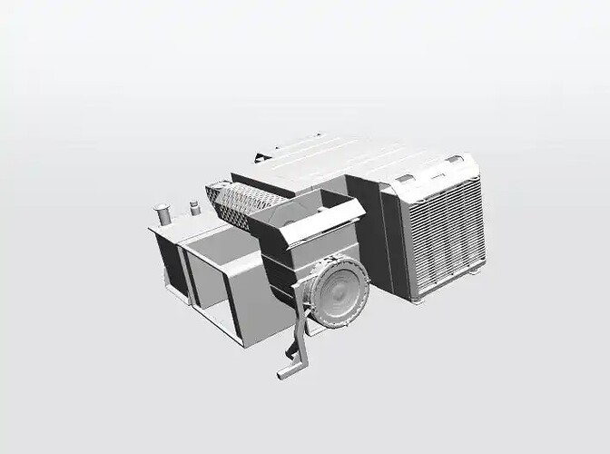

Unfortunately, no one makes the current HEMTT A4. I may be converting one soon, so we will see. There are some HEMTT A4 3D printed parts available on Shapeways, but they are not cheap. There is a suspension set, which is only half correct. It has 4 of the rear suspension units and none of the front suspension parts. There is also an engine module piece, but it is crazy expensive. I plan to use the suspension units on the rear, scratch the front suspension, and scratch the engine cover/radiators.
Shapeways parts.
1/35 Scale HEMTT A4 Piggy Back Engine Pack - $108
1/35 Scale HEMTT A4 Suspension Kit full set - $37
1
Correct A4 front suspension.

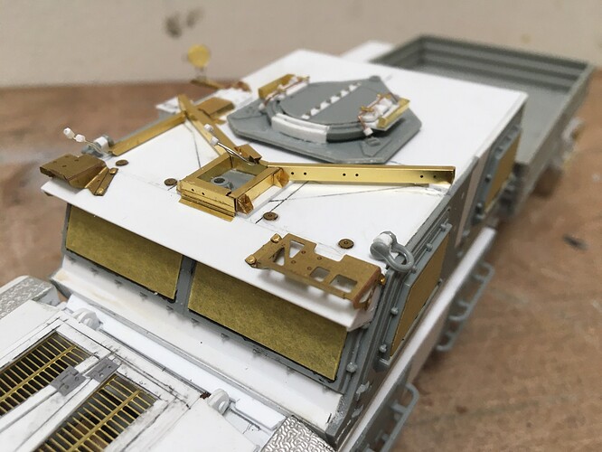

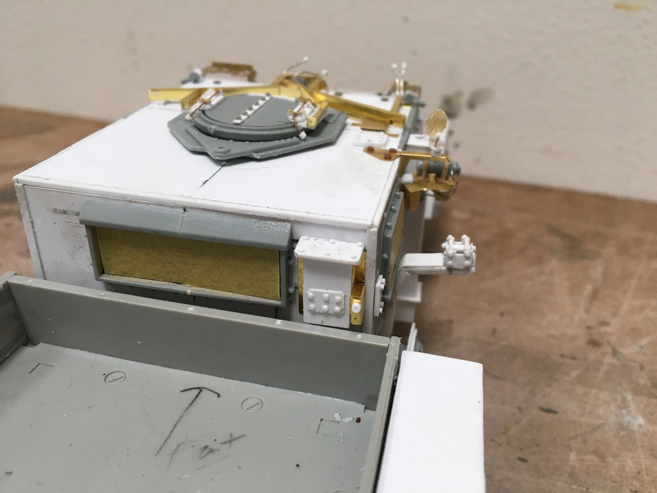

Only time for brief update on the big truck. Have spent some time in the last few days adding details to the exterior of the cab. This has required many visits to the junkbox for remnant etch parts and evergreen. OK, here we go:
There’s a spare tire mount and winch, and air intake on this side.
Turns out, there’s plenty happening on the roof. The gunner’s position is not like what my donor kits offers, so, I made the changes to make it look right. The hatch has two halves, split in the middle.
And, the CROWS has a structural base - well…there you go - had to figure that out.
I don’t know what is in that box next to the rear window, but it is vented, and now on my build.
The roof is now about half way done.

As for things, personal life and real work have been keeping me busy, but, yesterday, while watching the Warriors game, well I also got after this, and kept doing so well into the night - the plan - to more or less finish what’s going on, on the roof!
You’ll once again see the results of repurposing remnant etch sprues, and evergreen. This was all pretty interesting, as there are several oddly shaped brackets that attach to each other.
In general, I don’t like making fragile models, as I can just about guarantee that I will eventually knock parts off. So, when I could, I used resin bolts going through the etch and into something solid, and like real life, they do a great job holding things in place. Also, if possible, I’d pin etch to etch, or add some reinforcing to the inside, with lead foil - as in, right off the top of a wine bottle - you can’t see it, and it works just fine. Finally, got after adding on bolt heads.
Ok, enough rambling, and on we go:
It doesn’t seem the designers of this truck wasted much space!
For this, I used a lot of .010" styrene too - while not as strong as etch or thin sheet brass, it’s easier to cut and get good connections. There’s also a lot of .020" styrene.
