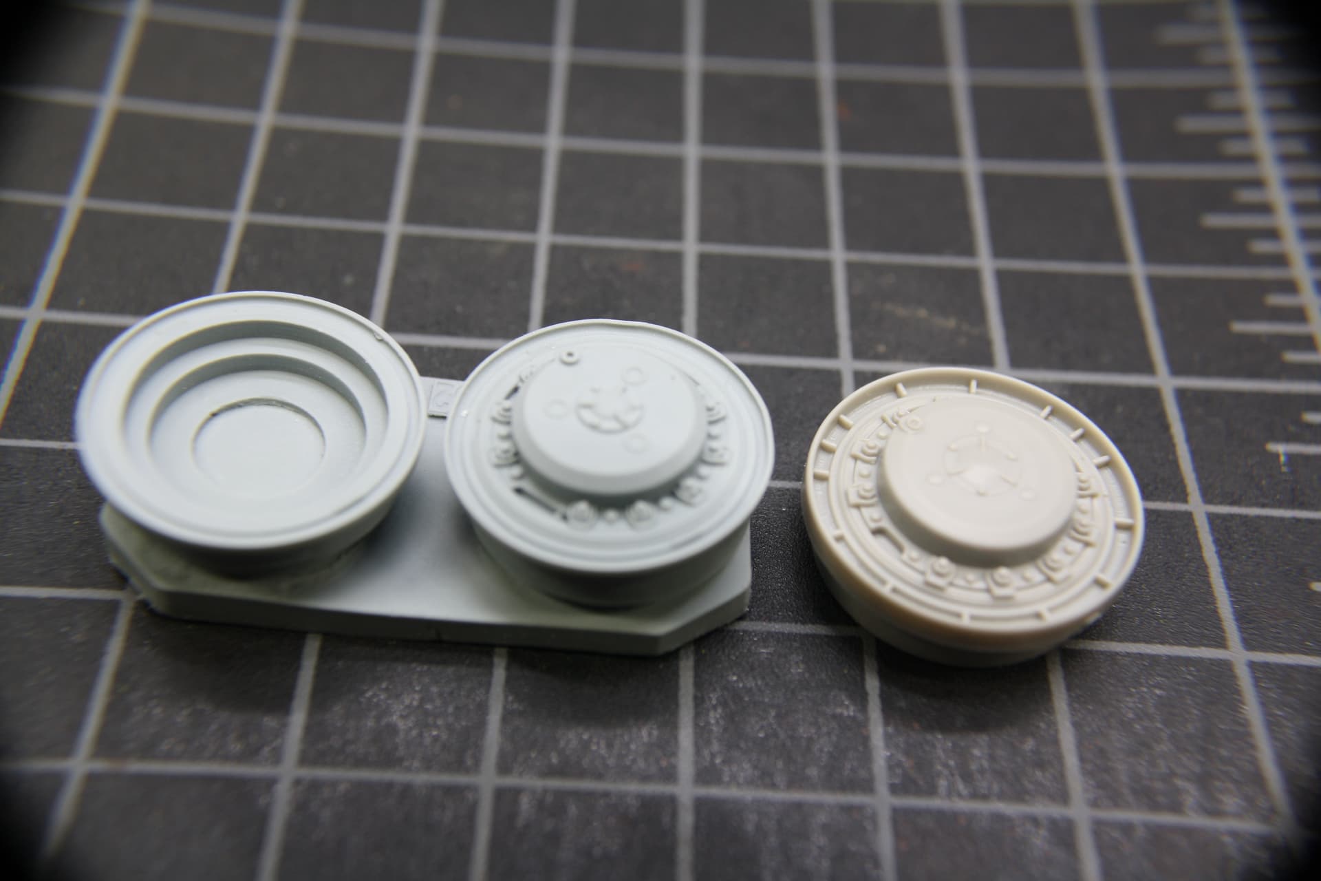

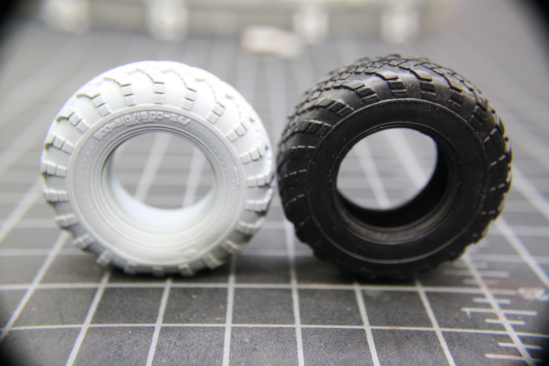

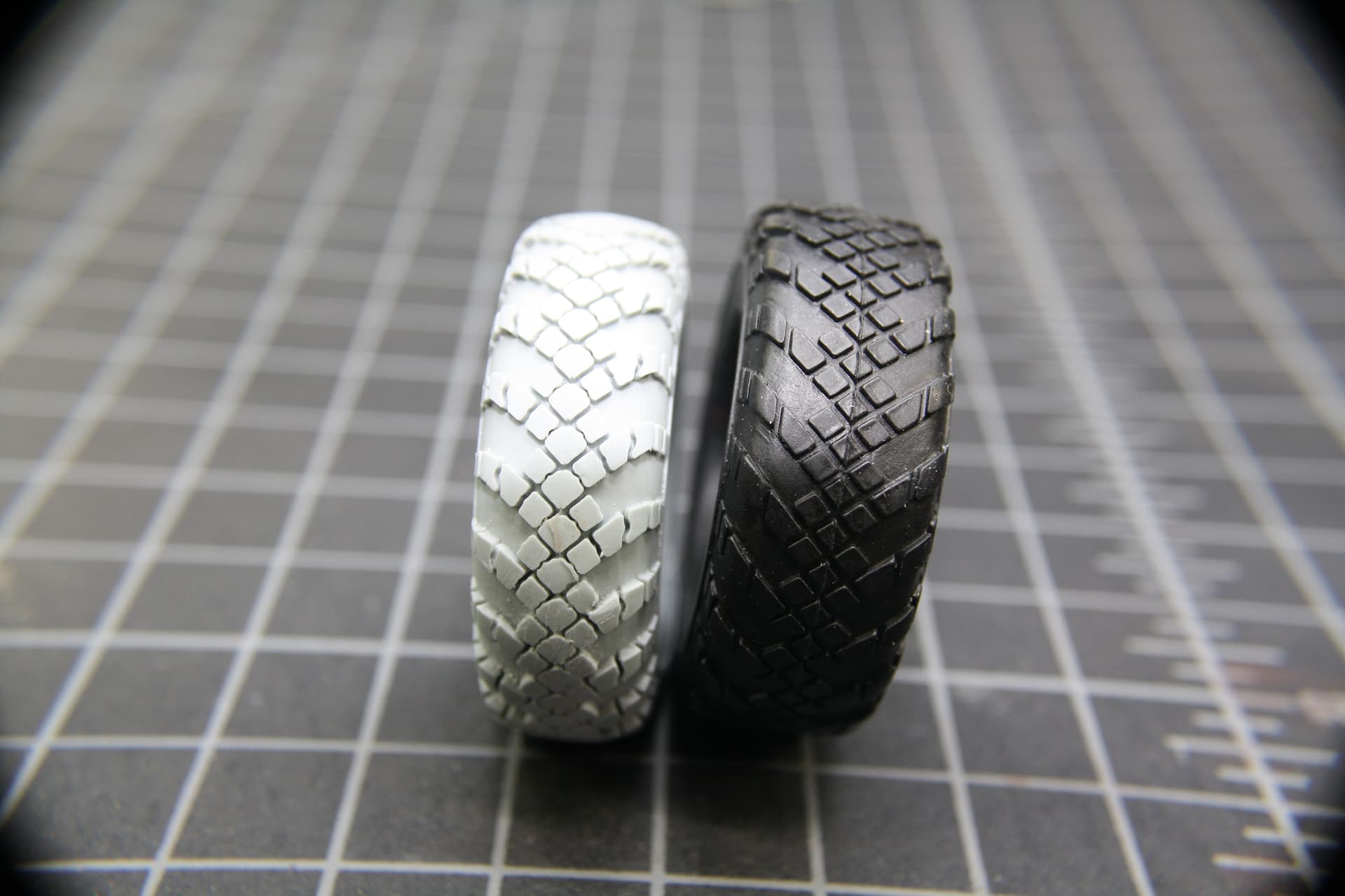

@Chris_Bryan Chris the wheels were from ebay and set me back $37, not bad for this much resin, although they only give you 8, no spare. The spare figures prominently on the truck so now I don’t know what to do. I guess I will ask a club buddy if he can cast me one tire. As for quality and detail, the resin ones are leagues ahead of the kit pieces. The kit tires are bulbous, have soft tread detail, and a mold seam running around the center of the tire, with no lettering on the sides. The Miniarm tires correct all of this, plus give a nominal bulge. Hubs are also included, which are crisper in detail than the kit parts. But I would be remiss without providing some cool comparison photos -

Wow! Miniarm really kicked butt.
It’s like a set GOODRIDE tires by Zhongce vs a set of MICHELIN Pilot Sport Cup 2 on a racetrack…its only going to end in tears for Goodride.

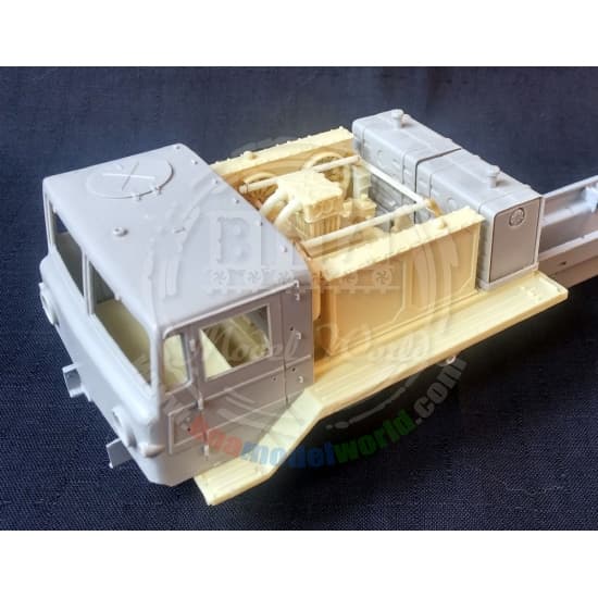

Okay, you guys are either going to hate me or love me. I did some more research and googling and found out the engine bay looks nothing like that. The V 12 engine is there, but there are double radiators on both sides, and a conventional transmission behind the engine. So, the T-55 engine and transmission idea are out. My googling also revealed that Panzershop does a full engine bay with transmission for this kit. So, I’ve decided to take the deep dive. I’ve now shifted this build from OOB to full blown. I ordered a Voyager PE set and the Panzershop engine set.

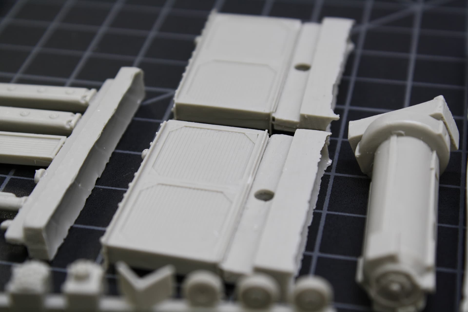

I am running into a big problem with this kit and that is why progress has been so slow. The base kit, the MAZ-537, is a Trumpeter veteran kit and Trumpeter has gotten at least a dozen variants off of this one truck model. Good for them, but I can tell you the molds are just done wore out. So, a warning for all of you looking at a Trumpeter MAZ-537 based truck kit with that gleam in your eye - There are heavy seam lines on every part, requiring hours of scraping and sanding before any glue can be applied. Parts fit is loose and sloppy. Mating surfaces have rounded corner edges, requiring putty and sanding - more down time. All this is kind of taking the fun out of it and I am anxious to finish the MAZ-537 components and get to the 5 KET-T sprues, which are brand new and appear worry free.

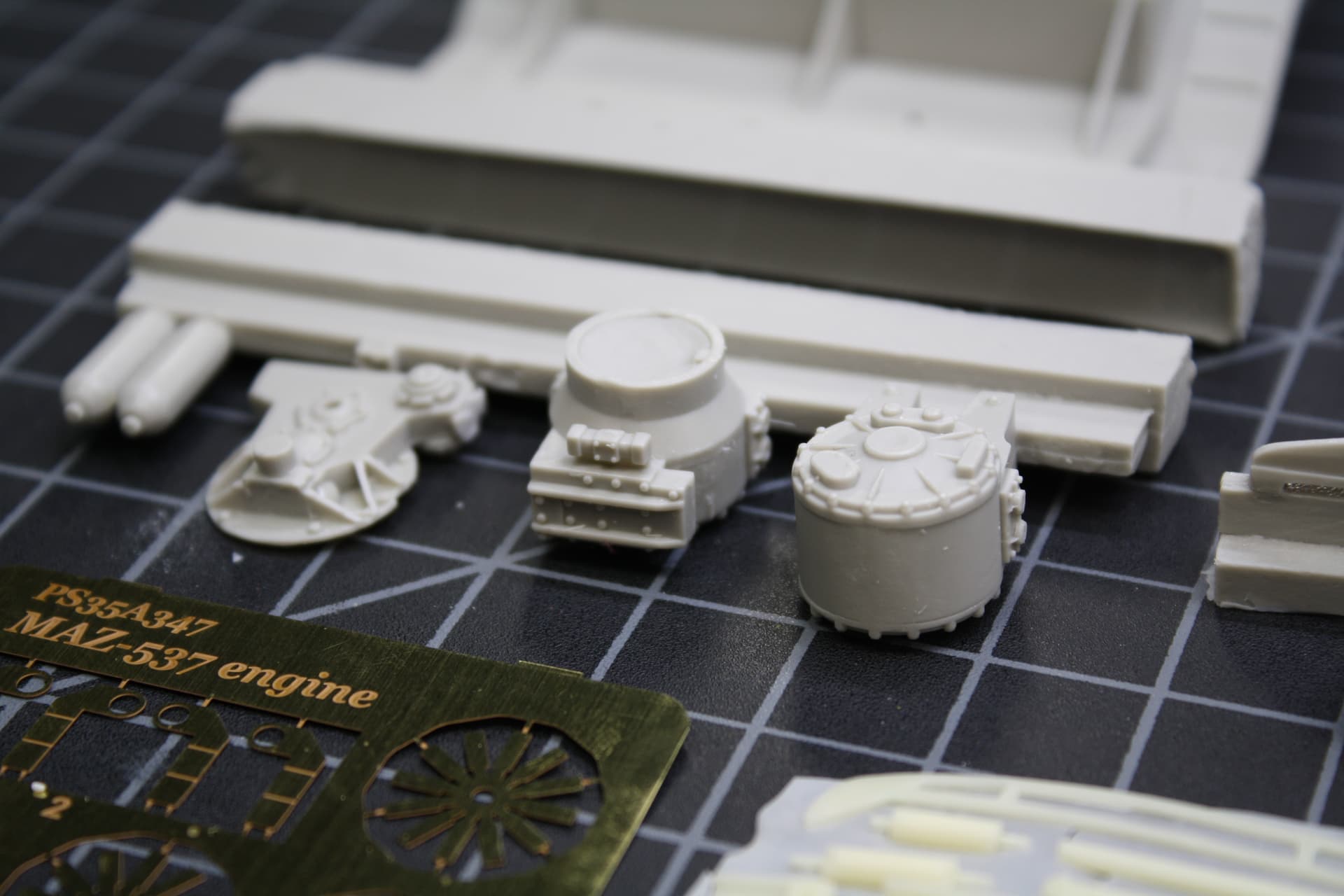

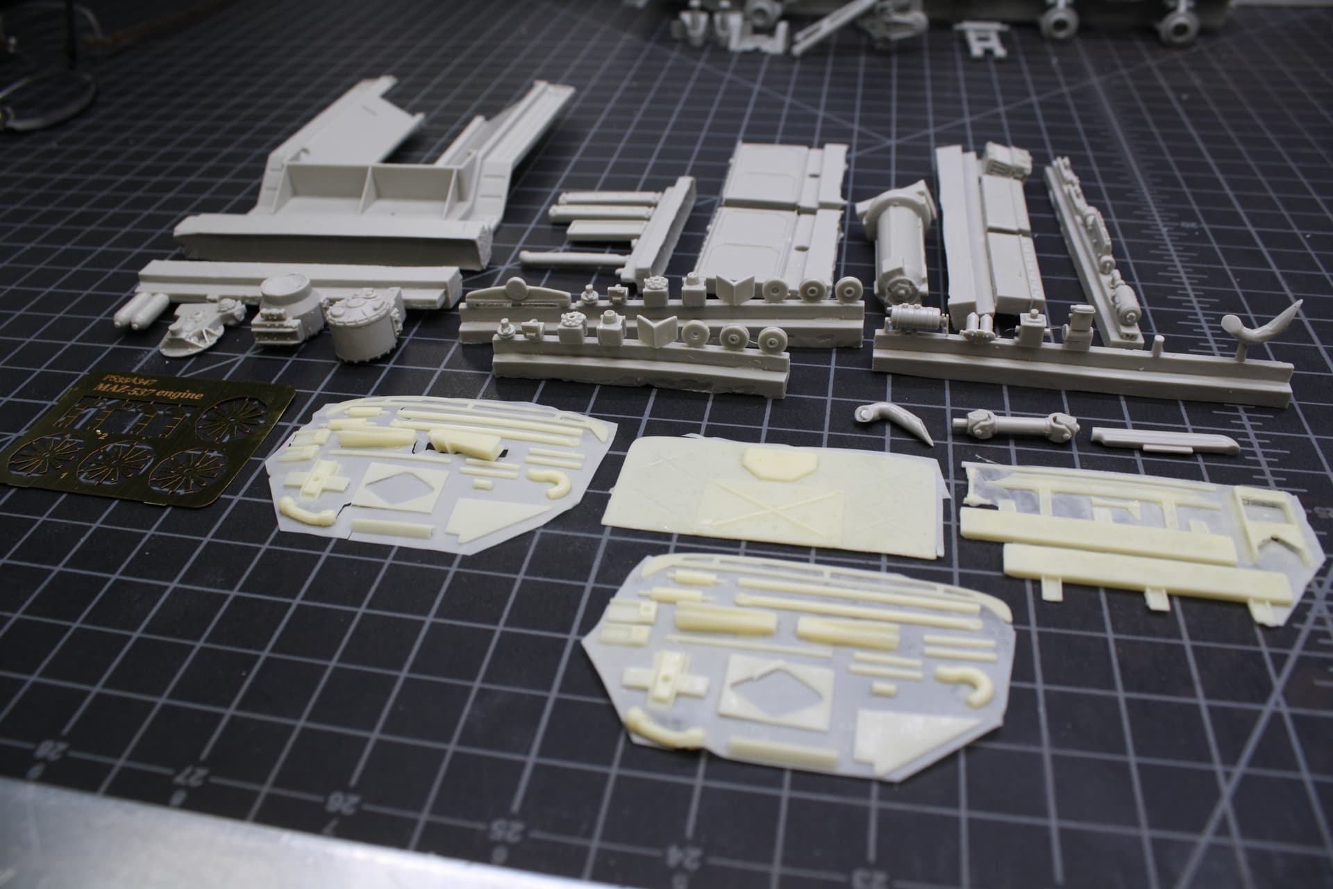

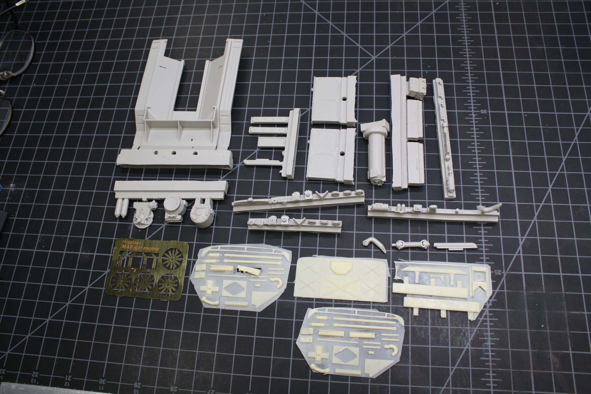

A wonderful surprise as the postman delivered the Panzershop MAZ-537 engine bay resin kit this morning. This will complicate assembly and planning painting but will look so cool when complete. I intend to wire and plumb the compartment. This ought to slow me down some but at least I know that these parts will fit together.
The casting and detail are beautiful and they provide the full transmission, which Trumpeter failed to do. I’ll be working on this while I wait for the Voyager full PE set for this kit from HK, which is allegedly somewhere over the Pacific right now. I can’t get too far ahead into the kit until I see what’s being replaced by the PE set! Build-wise, I’m almost ready to shoot a coat of black on the frame, wheel hubs, and black recovery gear. This will be a modular final assembly to make building/painting straightforward.
