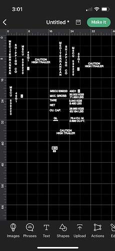

Got the letters all made up! Just need container dimensions and/or font size so I can scale them and cut them
Can I get these to you tomorrow morning?

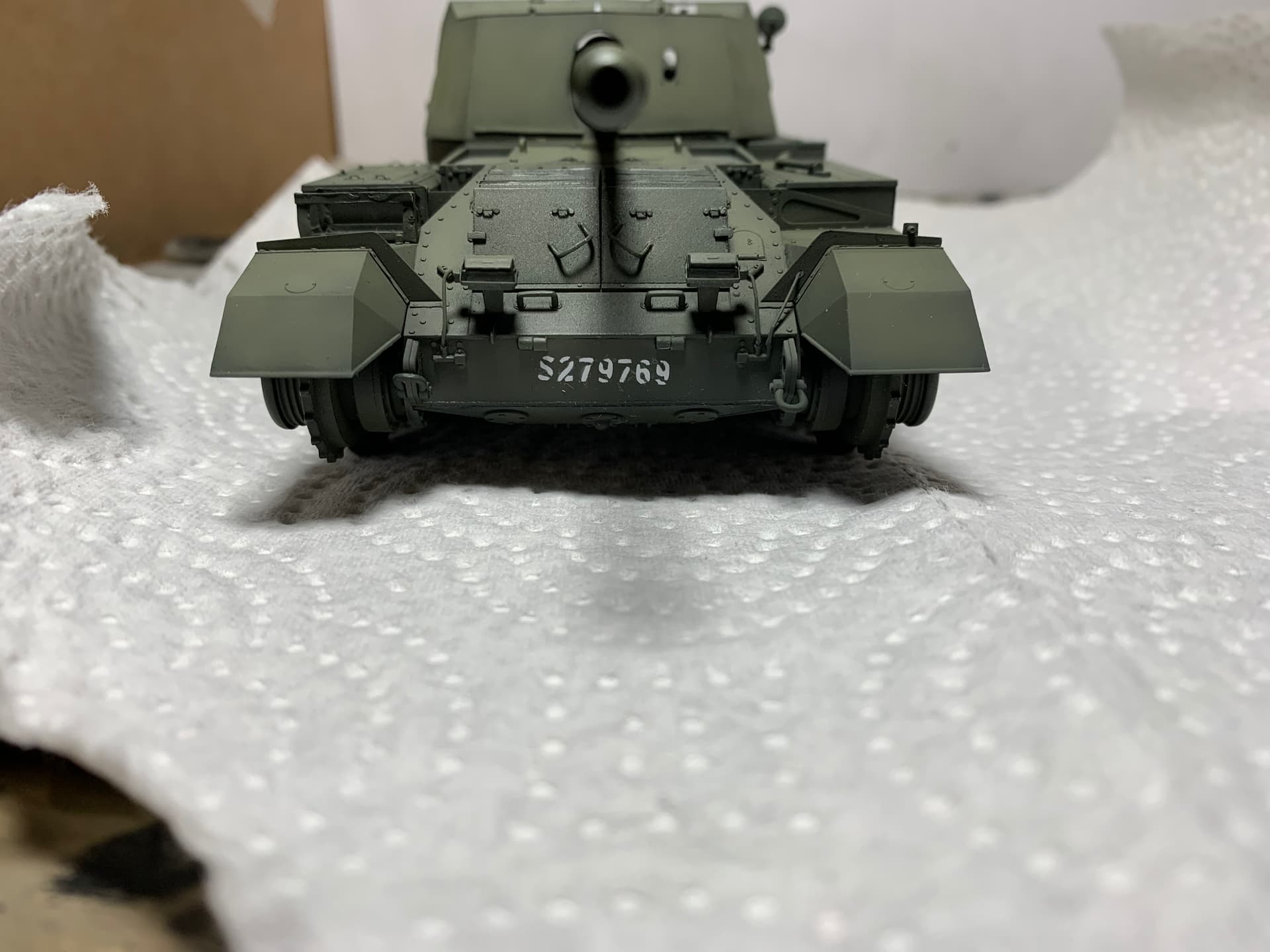

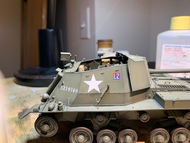

You have two options here. One you spray the whole container black and then place the masking tape stencil letters where you want them. You then spray the container color and when done remove the stencils. That’s what I did here for the chevrons so you can have an idea of the process
Ever since this route was pointed out to me it’s my preferred route. You don’t have to mask around the marking and you are less likely to get a lip around the marking and base
Option two you spray the base color, then you use the “negative” of the stencil (or what is left after cutting the letters) and spray the marking color. That is what I did here for the stars, serials and battery marking
I’ll send a few sets of both the letters and negatives, so you can do it either way and have spares

Tainer dims:
L 345 mm
W 70 mm
H 73 mm
Distance between ribs on sides 1.89 mm

I plan on cutting the letters today. Just need to scale them down.
Could you confirm the size of the letters and or container? If I am reading the link correctly the letters are 50 mm which in 1/35 scale makes them just over 1mm high. I fear this will be too small for the cricut to cut
If you check the post above the M1A1 pic, you’ll see the dimensions I provided.
Sorry, don’t know how I missed that. Let me do some math tonight and see what scale the letters need to be.
