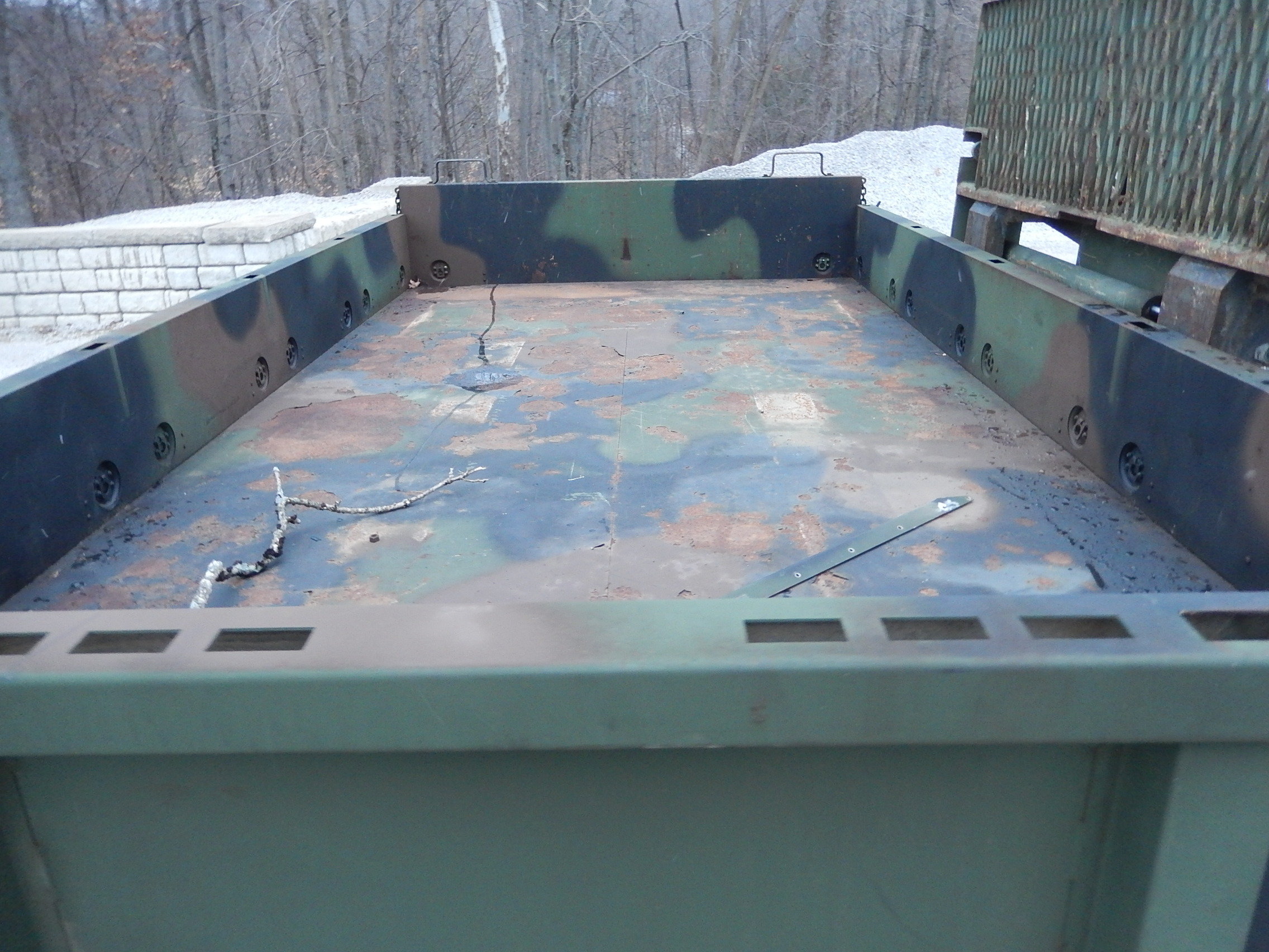

Can anybody please explain what that circular object in the last pic is, between the tiedown and the last upright of the side wall? Its four small protrusions might be rivets, but the larger “pimple” above isn’t self-explaining (to me).

That is a damn good question! All my time in the Army, and I still don’t know. Gino might know, he pretty much knows everything!
Ken
I don’t know everything, but I do know what they are. It is the outer part of a tie down that is on the inside of the bad. You can see them below on an M923 bed as well.
Internal tie-down side.
External reverse side.
Now we all know that we need to drill out those holes and fill them with tie-downs on the inside and the fancy cover on the outside.

The bed in the AFV kit doesn’t have those tie downs, and to be honest, I don’t know whether the M35 always had those or whether those were added in later models. That said, since this vehicle will have a mounted shelter, which is secured to the bed by a mounted wooden brace in the front, and almost certainly had mounting bolts under the bed as well, I’m going to choose NOT to add those tie downs since they would serve no purpose. Could I and should I add bolts underneath. Yes and probably. Am I?

No, M35A1/A2s did not have them. They were added on M35A3s, which were only used by the Army National Guard.

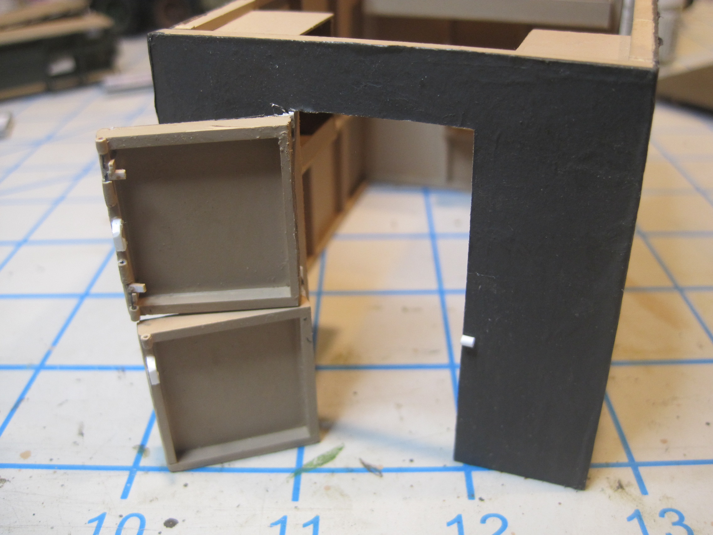

Today’s installment is the assembly of the shelter. At the front end of the bed is the attachment brace.
Next shows how the completed shelter will look:
I’ve added a few shelves for storage.
This is just a tease to show how the inside will be laid out once I’ve completed things.

Fantastic scratching there Tom; I can’t seem to manage even a straight edge when I try and cut plastic card.
Indeed a fantastic scratch build. Is it a wooden box that was used in the past? Sorry fo asking, I didn’t have the complete blog in mind.
No it’s all scratch built from either sheet or strip styrene plastic. Once cut out and assembled, I painted the inside to resemble plywood, which is what the original was made from. The exterior is covered in airplane fabric which I had pre-painted on both sides with Tamiya Khaki Drab and then glued on to the outside, to simulate the canvas covering on the original. For glue, I took regular white glue and diluted it with water until it was the consistency of skim milk and then brushed it on the surface much like you would with wall paper.
